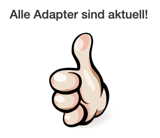

                          @AlCalzone said in Fehler bei Update diverser Adapter.:
                          /opt/iobroker/package.json
                          You made my day. Vielen Dank! Läuft wieder. 👍 🙏
                          298
