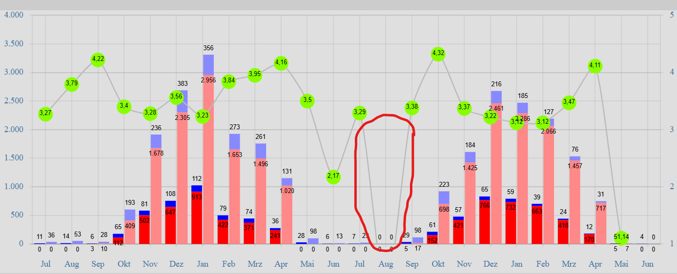

                                        Ich habe ein chart aus einer Json.
                                        Beim Linien Teil ist eine Lücke (null) vorhanden.
                                        Obwohl line_spanGaps auf true steht, wird keine Lücke angezeigt.
                                        Ich habe auch line_spanGaps auf false probiert, macht aber keinen Unterschied.
                                        JSON Data:
                                          "axisLabels": [

                                          "graphs": [
                                              "type": "bar",
                                              "legendText": "Heizung Verbrauch",
                                              "barIsStacked": true,
                                              "barStackId": 1,
                                              "data": [

                                              "type": "bar",
                                              "legendText": "Wasser Erzeugung",
                                              "barStackId": 2,
                                              "data": [
                                                36,
                                                53,
                                                28,
                                                193,
                                                236,
                                                383,
                                                356,
                                                273,
                                                261,
                                                131,
                                                98,
                                                13,
                                                23,
                                                0,
                                                98,
                                                223,
                                                184,
                                                216,
                                                185,
                                                127,
                                                76,
                                                31,
                                                4,
                                              "yAxis_id": 0,
                                              "displayOrder": 2,
                                              "yAxis_step": 500,
                                              "yAxis_min": 0,
                                              "yAxis_max": 4000,
                                              "color": "#8888ff",
                                              "datalabel_color": "#000000",
                                              "datalabel_align": "end",
                                              "datalabel_fontSize": 10,
                                              "tooltip_title": "Erzeugung gesamt:",
                                              "tooltip_text": [
                                                "Jul 2023: 36 kWh",
                                                "Aug 2023: 53 kWh",
                                                "Sep 2023: 38 kWh",
                                                "Okt 2023: 602 kWh",
                                                "Nov 2023: 1914 kWh",
                                                "Dez 2023: 2688 kWh",
                                                "Jan 2024: 3312 kWh",
                                                "Feb 2024: 1926 kWh",
                                                "Mrz 2024: 1757 kWh",
                                                "Apr 2024: 1151 kWh",
                                                "Mai 2024: 98 kWh",
                                                "Jun 2024: 13 kWh",
                                                "Jul 2024: 23 kWh",
                                                "Aug 2024: 0 kWh",
                                                "Sep 2024: 115 kWh",
                                                "Okt 2024: 921 kWh",
                                                "Nov 2024: 1609 kWh",
                                                "Dez 2024: 2677 kWh",
                                                "Jan 2025: 2471 kWh",
                                                "Feb 2025: 2193 kWh",
                                                "Mrz 2025: 1533 kWh",
                                                "Apr 2025: 748 kWh",
                                                "Mai 2025: 11 kWh",
                                                "Jun 2025: 0 kWh"
                                              "type": "line",
                                              "legendText": "MAZ total",
                                              "yAxis_step": 1,
                                              "yAxis_min": 1,
                                              "yAxis_max": 5,
                                              "line_PointColor": "#88FF00",
                                              "line_Tension": 0.2,
                                              "line_spanGaps": true,
                                              "line_pointSize": 11,
                                              "displayOrder": 1,
                                              "data": [
                                                3.27,
                                                3.79,
                                                4.22,
                                                3.4,
                                                3.28,
                                                3.56,
                                                3.23,
                                                3.84,
                                                3.95,
                                                4.16,
                                                3.5,
                                                2.17,
                                                3.29,
                                                null,
                                                3.38,
                                                4.32,
                                                3.37,
                                                3.22,
                                                3.12,
                                                3.12,
                                                3.47,
                                                4.11,
                                                1.1,
                                              "yAxis_id": 1,
                                              "yAxis_position": "right",
                                              "color": "#bbbbbb",
                                              "datalabel_align": "bottom",
                                              "line_PointColorHover": "#88FF00",
                                              "tooltip_title": "MAZ:",
                                              "tooltip_text": [
                                                "Jul 2023:  Heizung: 0, Wasser:3.27",
                                                "Aug 2023:  Heizung: 0, Wasser:3.79",
                                                "Sep 2023:  Heizung: 3.33, Wasser:4.67",
                                                "Okt 2023:  Heizung: 3.65, Wasser:2.97",
                                                "Nov 2023:  Heizung: 3.34, Wasser:2.91",
                                                "Dez 2023:  Heizung: 3.56, Wasser:3.55",
                                                "Jan 2024:  Heizung: 3.24, Wasser:3.18",
                                                "Feb 2024:  Heizung: 3.92, Wasser:3.46",
                                                "Mrz 2024:  Heizung: 4.03, Wasser:3.53",
                                                "Apr 2024:  Heizung: 4.23, Wasser:3.64",
                                                "Mai 2024:  Heizung: 0, Wasser:3.5",
                                                "Jun 2024:  Heizung: 0, Wasser:2.17",
                                                "Jul 2024:  Heizung: 0, Wasser:3.29",
                                                "Aug 2024:  Heizung: 0, Wasser:0",
                                                "Sep 2024:  Heizung: 3.4, Wasser:3.38",
                                                "Okt 2024:  Heizung: 4.59, Wasser:3.66",
                                                "Nov 2024:  Heizung: 3.38, Wasser:3.23",
                                                "Dez 2024:  Heizung: 3.21, Wasser:3.32",
                                                "Jan 2025:  Heizung: 3.12, Wasser:3.14",
                                                "Feb 2025:  Heizung: 3.12, Wasser:3.26",
                                                "Mrz 2025:  Heizung: 3.49, Wasser:3.17",
                                                "Apr 2025:  Heizung: 4.22, Wasser:2.58",
                                                "Mai 2025:  Heizung: 1.4, Wasser:0.8",
                                                "Jun 2025:  Heizung: 0, Wasser:0"
                                        Vielleicht weiß einer die Lösung.
