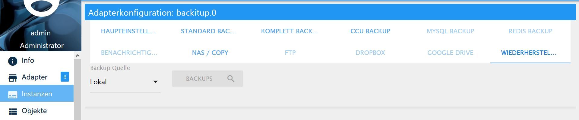

    Habe Backitup unter Windows 10 Pro laufen.
    Backups werden regelmäßig angelegt
    Jetzt habe ich versucht ein Backup wieder einzuspielen. Bei der Auswahl "lokal" wird die Suche ausgegraut
    Gleichzeitig gibt es einen Satz Fehlermeldungen im Log
    backitup.0	2019-10-25 07:29:30.815	error	at Manager.Emitter.emit (C:\Program Files\iobroker\ioBrMain2\node_modules\socket.io-client\node_modules\component-emitter\index.js:133:20)
    backitup.0	2019-10-25 07:29:30.815	error	at Manager.<anonymous> (C:\Program Files\iobroker\ioBrMain2\node_modules\component-bind\index.js:21:15)
    backitup.0	2019-10-25 07:29:30.815	error	at Socket.onpacket (C:\Program Files\iobroker\ioBrMain2\node_modules\socket.io-client\lib\socket.js:228:12)
    backitup.0	2019-10-25 07:29:30.815	error	at Socket.onevent (C:\Program Files\iobroker\ioBrMain2\node_modules\socket.io-client\lib\socket.js:270:10)
    backitup.0	2019-10-25 07:29:30.815	error	at Socket.Emitter.emit (C:\Program Files\iobroker\ioBrMain2\node_modules\socket.io-client\node_modules\component-emitter\index.js:133:20)
    backitup.0	2019-10-25 07:29:30.815	error	at Socket.<anonymous> (C:\Program Files\iobroker\ioBrMain2\node_modules\iobroker.js-controller\lib\states\statesInMemClient.js:52:30)
    backitup.0	2019-10-25 07:29:30.815	error	at Object.change (C:\Program Files\iobroker\ioBrMain2\node_modules\iobroker.js-controller\lib\adapter.js:3681:34)
    backitup.0	2019-10-25 07:29:30.815	error	at Adapter.emit (events.js:198:13)
    backitup.0	2019-10-25 07:29:30.815	error	at Adapter.adapter.on.obj (C:\Program Files\iobroker\ioBrMain2\node_modules\iobroker.backitup\main.js:101:21)
    backitup.0	2019-10-25 07:29:30.815	error	at module.exports (C:\Program Files\iobroker\ioBrMain2\node_modules\iobroker.backitup\lib\list.js:22:40)
    backitup.0	2019-10-25 07:29:30.815	error	TypeError: Cannot read property 'type' of null
    backitup.0	2019-10-25 07:29:30.813	error	message messagebox.system.adapter.backitup.0 [object Object] Cannot read property 'type' of null
    Was kann ich tun?
    • simatecS simatec
      @klassisch
      Bitte stelle mal auf lokal bei restore um und speichere im Anschluss die Einstellungen in backitup.
      Falls das nicht hilft, scheint irgendwas an deinem Pfad zum backup Ordner nicht zu stimmen.
      Bitte prüfe das mal, in dem du ein backup manuell erstellst.
      Im Debug Log siehst du dann, welcher Pfad der Standard Backup-Pfad ist.

      @simatec prima, das Auswählen von local und Abspeichern der Settings hat geholfen! Jetzt sind alle Backups zu sehen. Auch die, die zuvor angelegt wurden:

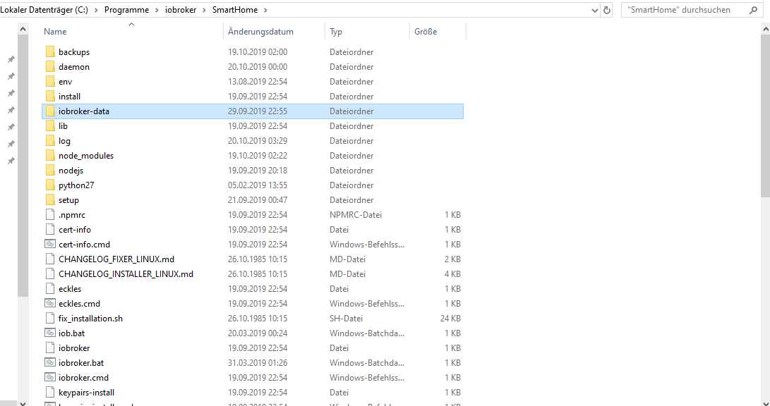

        Entpacke das Backup in ein Verzeichnis deiner Wahl. Schaue dort nach ob du im Backup Verzeichnis den Ordner iobroker-data hast.
        Führe das Setup von @Stabilostick aus ( anderen Name nehmen) und migriere es.

          Ordner iobroker-data gibt es nicht im Backup nach dem Backitup-Schema. Das sieht so aus:
          backup\
          -> backup.json
          -> files\
          Das automatische Kopieren von local zur Synology-NAS habe ich mit Backitup-Mitteln nicht hinbekommen. Wahrscheinlich irgendeine Einstellung auf der NAS nicht passend. Ich habe NTFS dort laufen und vielleicht geht da irgendwas nicht.
          Aber ich kopiere die Backups wie auch die History-Files per RoboMirror täglich automatisiert auf die NAS.

            Geh in deinen Host, dort suchst du iobroker-data , den in ein Verzeichnis kopieren.
            Oder du suchst diesen Ordner im Nas.
            Führe das Setup von @Stabilostick aus ( anderen Name nehmen) und migriere es mit dem kopierten iobroker-data
