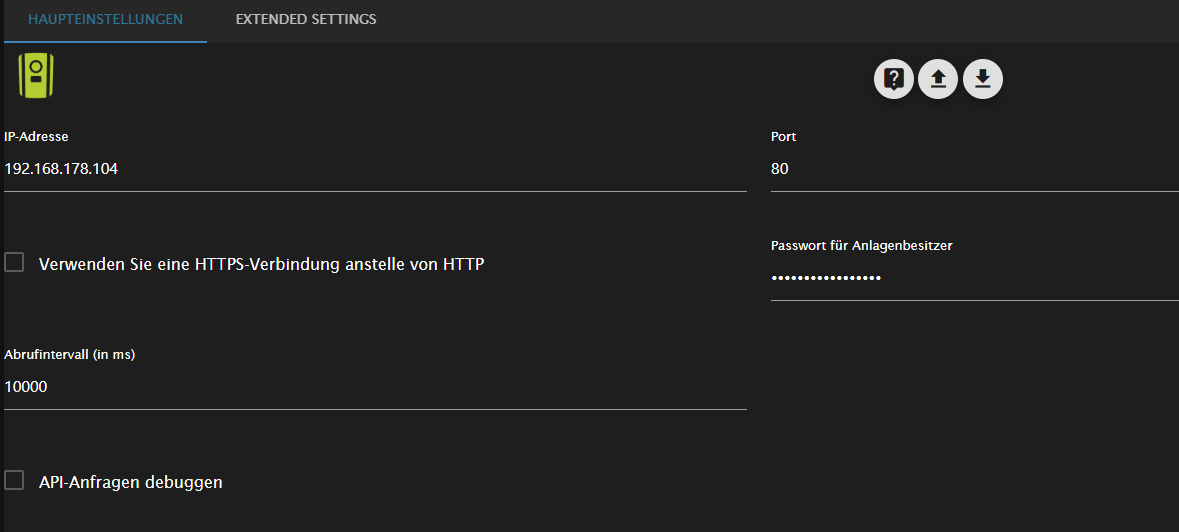

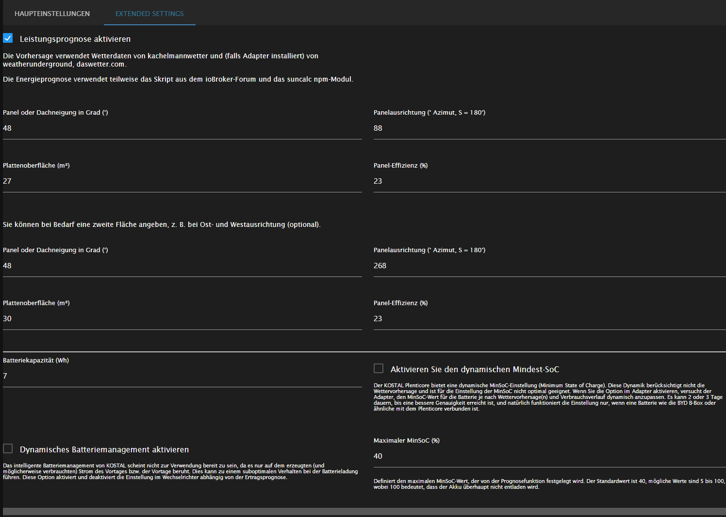

                          paradoxe Situation @mule last edited by paradoxe Situation
                          Hallo zusammen, was muss ich hir ändern, damit ich diese Warnmeldung nicht mehr im Log von ioB sehen?
                          Daten sehe und bekomme ich.
                          Requesting settings - [{"moduleid":"devices:local","processdataids":["Dc_P","DigitalIn","EM_State","HomeBat_P","HomeGrid_P","HomeOwn_P","HomePv_P","Home_P","Inverter:State","LimitEvuAbs"]},{"moduleid":"devices:local:ac","processdataids":["CosPhi","Frequency","L1_I","L1_P","L1_U","L2_I","L2_P","L2_U","L3_I","L3_P","L3_U","P","Q","S"]},{"moduleid":"devices:local:battery","processdataids":["Cycles","SoC","I","U","P"]},{"moduleid":"devices:local:pv1","processdataids":["I","U","P"]},{"moduleid":"devices:local:pv2","processdataids":["I","U","P"]},{"moduleid":"scb:export","processdataids":["PortalConActive"]},{"moduleid":"scb:statistic:EnergyFlow","processdataids":["Statistic:Autarky:Day","Statistic:Autarky:Month","Statistic:Autarky:Total","Statistic:Autarky:Year","Statistic:EnergyHome:Day","Statistic:EnergyHome:Month","Statistic:EnergyHome:Total","Statistic:EnergyHome:Year","Statistic:EnergyHomeBat:Day","Statistic:EnergyHomeBat:Month","Statistic:EnergyHomeBat:Total","Statistic:EnergyHomeBat:Year","Statistic:EnergyHomeGrid:Day","Statistic:EnergyHomeGrid:Month","Statistic:EnergyHomeGrid:Total","Statistic:EnergyHomeGrid:Year","Statistic:EnergyHomePv:Day","Statistic:EnergyHomePv:Month","Statistic:EnergyHomePv:Total","Statistic:EnergyHomePv:Year","Statistic:OwnConsumptionRate:Day","Statistic:OwnConsumptionRate:Month","Statistic:OwnConsumptionRate:Total","Statistic:OwnConsumptionRate:Year","Statistic:Yield:Day","Statistic:Yield:Month","Statistic:Yield:Total","Statistic:Yield:Year","Statistic:CO2Saving:Day","Statistic:CO2Saving:Month","Statistic:CO2Saving:Year","Statistic:CO2Saving:Total"]}]) failed with code 503: {"message":"internal communication error, try again later"}

                            FernetMenta @paradoxe Situation last edited by
                            @paradoxe-situation kannst du nicht ändern, da dieser Adapter nicht mehr gepflegt wird und Fehler hat. Ich habe aus diesem Grund einen neuen geschrieben: plenticore-g3
