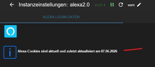

                                          Hatte das jeztz auch.
                                          alexa2.0
                                          	2026-06-07 09:48:25.466	error	e1df299748c640aeb08d443fabe9fb77 Error getting aux controller state: Error: Cookie invalid, Renew unsuccessful
                                          alexa2.0
                                          	2026-06-07 09:48:25.459	error	b8030b47b2f74af19a07c33c0ca8ebd1 Error getting aux controller state: Error: Cookie invalid, Renew unsuccessful
                                          alexa2.0
                                          	2026-06-07 09:48:25.455	error	b9574c8e8f5040b88a204e0983c0c521 Error getting aux controller state: Error: Cookie invalid, Renew unsuccessful
                                          alexa2.0
                                          	2026-06-07 09:48:25.451	error	78df689eaded4c179ad9e5ca6154d2cc Error getting aux controller state: Error: Cookie invalid, Renew unsuccessful
                                          alexa2.0
                                          	2026-06-07 09:48:25.446	error	6a0770db88724b9e84a5476b518858b5 Error getting aux controller state: Error: Cookie invalid, Renew unsuccessful
                                          alexa2.0
                                          	2026-06-07 09:48:25.442	error	c8e4a6e5a8c146df8260afd48c48de8d Error getting aux controller state: Error: Cookie invalid, Renew unsuccessful
                                          alexa2.0
                                          	2026-06-07 09:48:25.431	error	G090XG1221930SM7 Error getting aux controller state: Error: Cookie invalid, Renew unsuccessful
                                          alexa2.0
                                          	2026-06-07 09:48:25.427	error	G090XG1221930SM7 Error getting equalizer enabled: Error: Cookie invalid, Renew unsuccessful
                                          alexa2.0
                                          	2026-06-07 09:48:25.419	error	G090XG1221930SP5 Error getting aux controller state: Error: Cookie invalid, Renew unsuccessful
                                          alexa2.0
                                          	2026-06-07 09:48:25.414	error	G090XG1221930SP5 Error getting equalizer enabled: Error: Cookie invalid, Renew unsuccessful
                                          alexa2.0
                                          	2026-06-07 09:48:25.404	error	G090XG1212240SFV Error getting aux controller state: Error: Cookie invalid, Renew unsuccessful
                                          alexa2.0
                                          	2026-06-07 09:48:25.398	error	G090XG1212240SFV Error getting equalizer enabled: Error: Cookie invalid, Renew unsuccessful
                                          alexa2.0
                                          	2026-06-07 09:48:25.392	error	8f4c86fdebb44d70a584545891993f92 Error getting aux controller state: Error: Cookie invalid, Renew unsuccessful
                                          alexa2.0
                                          	2026-06-07 09:48:25.384	error	G090XG1211930CAW Error getting aux controller state: Error: Cookie invalid, Renew unsuccessful
                                          alexa2.0
                                          	2026-06-07 09:48:25.380	error	G090XG1211930CAW Error getting equalizer enabled: Error: Cookie invalid, Renew unsuccessful
                                          alexa2.0
                                          	2026-06-07 09:48:25.370	error	G091ET10110404WR Error getting display adaptive brightness setting: Error: Cookie invalid, Renew unsuccessful
                                          alexa2.0
                                          	2026-06-07 09:48:25.363	error	G091ET10110404WR Error getting display brightness setting: Error: Cookie invalid, Renew unsuccessful
                                          alexa2.0
                                          	2026-06-07 09:48:25.357	error	G091ET10110404WR Error getting display enabled setting: Error: Cookie invalid, Renew unsuccessful
                                          alexa2.0
                                          	2026-06-07 09:48:25.351	error	G091ET10110404WR Error getting aux controller state: Error: Cookie invalid, Renew unsuccessful
                                          alexa2.0
                                          	2026-06-07 09:48:25.347	error	G091ET10110404WR Error getting equalizer enabled: Error: Cookie invalid, Renew unsuccessful
                                          alexa2.0
                                          	2026-06-07 09:48:25.332	error	G0911B05951410SG Error getting aux controller state: Error: Cookie invalid, Renew unsuccessful
                                          alexa2.0
                                          	2026-06-07 09:48:25.327	error	G0911B05951410SG Error getting equalizer enabled: Error: Cookie invalid, Renew unsuccessful
                                          alexa2.0
                                          	2026-06-07 09:48:25.316	error	G070VM1703350M62 Error getting aux controller state: Error: Cookie invalid, Renew unsuccessful
                                          alexa2.0
                                          	2026-06-07 09:48:25.306	error	G070VM160285025K Error getting aux controller state: Error: Cookie invalid, Renew unsuccessful
                                          alexa2.0
                                          	2026-06-07 09:40:32.463	error	Error: Please open http://192.168.178.42:35869/ with your browser and login to Amazon. The cookie will be output here after successfull login.
                                          alexa2.0
                                          	2026-06-07 09:40:32.446	error	Error:
                                          Link im Log gefolgt und eingegeben mit 2FA
                                          Adapter ist jetzt grün, im Log stand nichts mehr. Hab den Adapter nun dreimal neugestartet und es kam nichts.
