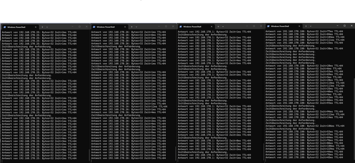

      Die log hat 5 Mega wo kann ich diese hochladen?
      TT-Tom
      #1211
      @welli Sicher mal das Log. Zeige erstmal die letzen 20 Zeilen vor dem Reset.

            Hier mal ein Auszug wo vorher alles das selbe ist für NSpanel 1+2 dann hat NSpanel 1 ein problem.
            2026-05-30 20:21:15.015 - debug: nspanel-lovelace-ui.0 (20751) [NSPanel_2-SendClass] send payload: {"topic":"NSPanel_2/cmnd/CustomSend","payload":"weatherUpdate~~3806625,6°C~~63488~Leistung~15.45 kWh~侀~65222~Solar 11KW~3.15 kWh~侀~2016~Solar 800W~30.4 W~~64800~Sonne~21:33~~64512~Wind~2,6m/s~~64512~Böen~4,6m/s~~65535~Windr.~SSW~~65093~Feuchte~50%~~65222~UV~1,110?10~~31~Wasser~10?11~~2016~Zeichpumpe~10?12~~65504~UV-Licht~10?13~~35921~Teischspill~00?14~~35921~Luftpumpe~0"} to panel.
            2026-05-30 20:21:15.483 - debug: nspanel-lovelace-ui.0 (20751) [NSPanel_2-SendClass] send payload: {"topic":"NSPanel_2/cmnd/CustomSend","payload":"color~6371~65535~65363~54938~65535~54938~54938~54938~54938~54938~54938~54938~54938~54938~65363~1374"} to panel.
            2026-05-30 20:21:15.707 - debug: nspanel-lovelace-ui.0 (20751) [NSPanel_2-SendClass] send payload: {"topic":"NSPanel_2/cmnd/CustomSend","payload":"statusUpdate~~17299~~17299~~"} to panel.
            2026-05-30 20:21:15.857 - debug: nspanel-lovelace-ui.0 (20751) [NSPanel_2-SendClass] send payload: {"topic":"NSPanel_2/cmnd/CustomSend","payload":"weatherUpdate~~3806625,6°C~~63488~Leistung~15.45 kWh~侀~65222~Solar 11KW~3.15 kWh~侀~2016~Solar 800W~3.15 kWh~~64800~Sonne~21:33~~64512~Wind~2,6m/s~~64512~Böen~4,6m/s~~65535~Windr.~SSW~~65093~Feuchte~50%~~65222~UV~1,110?10~~31~Wasser~10?11~~2016~Zeichpumpe~10?12~~65504~UV-Licht~10?13~~35921~Teischspill~00?14~~35921~Luftpumpe~0"} to panel.
            2026-05-30 20:21:20.024 - debug: nspanel-lovelace-ui.0 (20751) [NSPanel_2-SendClass] send payload: {"topic":"NSPanel_2/cmnd/CustomSend","payload":"weatherUpdate~~3806625,6°C~~63488~Leistung~15.45 kWh~侀~65222~Solar 11KW~3.15 kWh~侀~2016~Solar 800W~3.15 kWh~~64800~Sonne~21:33~~64512~Wind~2,6m/s~~64512~Böen~4,6m/s~~65535~Windr.~SSW~~65093~Feuchte~50%~~65222~UV~1,110?10~~31~Wasser~10?11~~2016~Zeichpumpe~10?12~~65504~UV-Licht~10?13~~35921~Teischspill~00?14~~35921~Luftpumpe~0"} to panel.
            2026-05-30 20:21:20.399 - debug: nspanel-lovelace-ui.0 (20751) [NSPanel_2-SendClass] send payload: {"topic":"NSPanel_2/cmnd/CustomSend","payload":"color~6371~65535~65363~54938~65535~54938~54938~54938~54938~54938~54938~54938~54938~54938~65363~1374"} to panel.
            2026-05-30 20:21:20.624 - debug: nspanel-lovelace-ui.0 (20751) [NSPanel_2-SendClass] send payload: {"topic":"NSPanel_2/cmnd/CustomSend","payload":"statusUpdate~~17299~~17299~~"} to panel.
            2026-05-30 20:21:20.824 - debug: nspanel-lovelace-ui.0 (20751) [NSPanel_2-SendClass] send payload: {"topic":"NSPanel_2/cmnd/CustomSend","payload":"weatherUpdate~~3806625,6°C~~63488~Leistung~2694.18 W~侀~65222~Solar 11KW~29.6 W~侀~2016~Solar 800W~29.6 W~~64800~Sonne~21:33~~64512~Wind~2,6m/s~~64512~Böen~4,6m/s~~65535~Windr.~SSW~~65093~Feuchte~50%~~65222~UV~1,110?10~~31~Wasser~10?11~~2016~Zeichpumpe~10?12~~65504~UV-Licht~10?13~~35921~Teischspill~00?14~~35921~Luftpumpe~0"} to panel.
            2026-05-30 20:21:23.019 - debug: nspanel-lovelace-ui.0 (20751) [#scr] [NSPanel_1] Switch page to invisible!
            2026-05-30 20:21:23.019 - warn: nspanel-lovelace-ui.0 (20751) [NSPanel_1] is offline!
            2026-05-30 20:21:23.219 - debug: nspanel-lovelace-ui.0 (20751) [NSPanel_1-SendClass] send payload: {"topic":"NSPanel_1/cmnd/CustomSend","payload":"pageType~pageStartup","opt":{"retain":true}} to panel.
            2026-05-30 20:21:24.633 - debug: nspanel-lovelace-ui.0 (20751) [mqttServer] Client "NSPanel_1-7E1E20" login successful (user="seRPHbcwAkkSRlb").
            2026-05-30 20:21:25.014 - debug: nspanel-lovelace-ui.0 (20751) [NSPanel_2-SendClass] send payload: {"topic":"NSPanel_2/cmnd/CustomSend","payload":"weatherUpdate~~3806625,6°C~~63488~Leistung~15.45 kWh~侀~65222~Solar 11KW~29.6 W~侀~2016~Solar 800W~29.6 W~~64800~Sonne~21:33~~64512~Wind~2,6m/s~~64512~Böen~4,6m/s~~65535~Windr.~SSW~~65093~Feuchte~50%~~65222~UV~1,110?10~~31~Wasser~10?11~~2016~Zeichpumpe~10?12~~65504~UV-Licht~10?13~~35921~Teischspill~00?14~~35921~Luftpumpe~0"} to panel.
            2026-05-30 20:21:25.350 - debug: nspanel-lovelace-ui.0 (20751) [NSPanel_1] Receive message:{"type":"event","method":"startup","id":"61","action":"eu","opt":"5.1.1"}
            2026-05-30 20:21:25.350 - info: nspanel-lovelace-ui.0 (20751) [NSPanel_1] is online!
            2026-05-30 20:21:25.351 - debug: nspanel-lovelace-ui.0 (20751) [NSPanel_1-SendClass] send payload: {"topic":"NSPanel_1/cmnd/tempOffset","payload":"0"} to panel.
            2026-05-30 20:21:25.362 - debug: nspanel-lovelace-ui.0 (20751) [NSPanel_1-SendClass] send payload: {"topic":"NSPanel_1/cmnd/STATUS0","payload":""} to panel.
            2026-05-30 20:21:25.373 - debug: nspanel-lovelace-ui.0 (20751) [NSPanel_1-SendClass] send payload: {"topic":"NSPanel_1/cmnd/POWER1","payload":""} to panel.
            2026-05-30 20:21:25.385 - debug: nspanel-lovelace-ui.0 (20751) [NSPanel_1-SendClass] send payload: {"topic":"NSPanel_1/cmnd/POWER2","payload":""} to panel.
            2026-05-30 20:21:25.397 - debug: nspanel-lovelace-ui.0 (20751) [NSPanel_1-SendClass] send payload: {"topic":"NSPanel_1/cmnd/GetDriverVersion","payload":""} to panel.
            2026-05-30 20:21:25.411 - debug: nspanel-lovelace-ui.0 (20751) [NSPanel_2-SendClass] send payload: {"topic":"NSPanel_2/cmnd/CustomSend","payload":"color~6371~65535~65363~54938~65535~54938~54938~54938~54938~54938~54938~54938~54938~54938~65363~1374"} to panel.
            2026-05-30 20:21:25.421 - debug: nspanel-lovelace-ui.0 (20751) [NSPanel_1-SendClass] send payload: {"topic":"NSPanel_1/cmnd/Rule3","payload":"ON CustomSend DO RuleTimer3 140 ENDON ON Rules#Timer=3 DO CustomSend pageType~pageStartup ENDON"} to panel.
            2026-05-30 20:21:25.476 - debug: nspanel-lovelace-ui.0 (20751) [NSPanel_1-SendClass] send payload: {"topic":"NSPanel_1/cmnd/Rule3","payload":"1"} to panel.
            2026-05-30 20:21:25.598 - debug: nspanel-lovelace-ui.0 (20751) [NSPanel_1] set color to RGB {"r":255,"g":255,"b":255} -> 65535
            2026-05-30 20:21:25.598 - debug: nspanel-lovelace-ui.0 (20751) [NSPanel_1-SendClass] send payload: {"topic":"NSPanel_1/cmnd/CustomSend","payload":"dimmode~15~59~0~65535"} to panel.
            2026-05-30 20:21:25.598 - debug: nspanel-lovelace-ui.0 (20751) [main] [NSPanel_1] Switch page to visible!
            2026-05-30 20:21:25.635 - debug: nspanel-lovelace-ui.0 (20751) [mqttServer] Client NSPanel_1-7E1E20 connected.
            2026-05-30 20:21:25.679 - debug: nspanel-lovelace-ui.0 (20751) [NSPanel_2-SendClass] send payload: {"topic":"NSPanel_2/cmnd/CustomSend","payload":"statusUpdate~~17299~~17299~~"} to panel.
            2026-05-30 20:21:25.732 - debug: nspanel-lovelace-ui.0 (20751) [main] Register last send type 44_17_93_7E_1E_20-cardGrid block for 200ms
            2026-05-30 20:21:25.779 - debug: nspanel-lovelace-ui.0 (20751) [NSPanel_1] Set screeensaver timeout to 15s.
            2026-05-30 20:21:25.780 - debug: nspanel-lovelace-ui.0 (20751) [NSPanel_1] Set screeensaver timeout to 2s.
            2026-05-30 20:21:25.823 - info: nspanel-lovelace-ui.0 (20751) [NSPanel_1] Panel startup finished!

                        • W Offline
                          W Offline
                          welli
                          #1221
                          @TT-Tom
                          Habe mir eine Popup Page eingebaut.
                          Diese meldet auch , aber nach einer gewissen Zeit starten die NSpanels neu und die Seite verschwindet bevor mann Sie bestätigen kann.
                          Ist dies normal?
                          Hier noch die info die ich bekomme.
                          2026-06-03 10:59:21.165 info [NSPanel_1] Panel startup finished!
                          2026-06-03 10:59:21.120 info [NSPanel_2] Panel startup finished!
                          • T Nicht stören
                            T Nicht stören
                            ticaki
                            #1222
                            nein es ist nicht normal das ein panel häufig neustartet - das passiert bei schlechtem wlan oder einem adapter bug - aktuell sieht es nach schlechtem wlan aus (weil das nicht meine schuld wäre) aber einen bug oder Einrichtungsfehler will ich nicht ausschließen.
                            Dein log auszug ist zu kurz - man bräuchte schon mindestens 2-3 x offline drin
                            Spenden
                            W 1 Antwort Letzte Antwort
                            • T ticaki
                              W Offline
                              W Offline
                              welli
                              #1223
                              @ticaki
                              HIer mal ne log, dauert +/- 8 min bis die Panels neu starten

                                        @ticaki
                                        Der Raspberry 5 mit 8GB läuft 3-5% mit 32% Ram.
                                        Habe mal pings auf mein WIFI gemacht und erschreckende Beobachtung gemacht.
                                        Von links nacht rechts : IObroker , NAS , Fritzbox , NSpanel_1
                                        Wo ran könnte dis liegen?

                                          Dafür solltest du einen eigenen Topic öffnen, hier gibt es leute die sich damit besser auskennen. Aber das ist schon etwas ernstes - vielleicht kanal optimieren, zigbee auf dem falschen kana.l
