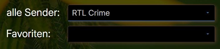

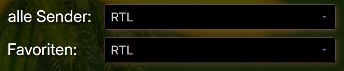

                          Sobald in einem der beiden Auswahl-Felder ein Sender eingestellt wurde. werden die Daten in .edit.xxx kopiert. Die Taste Details öffnet eine View im Popup. Die Widget da drin greifen auf die .edit.xxx zu. Die Taste Speichern triggert einen Datenpunkt (save) der das Rückschreiben auslöst.
                          Ro75.

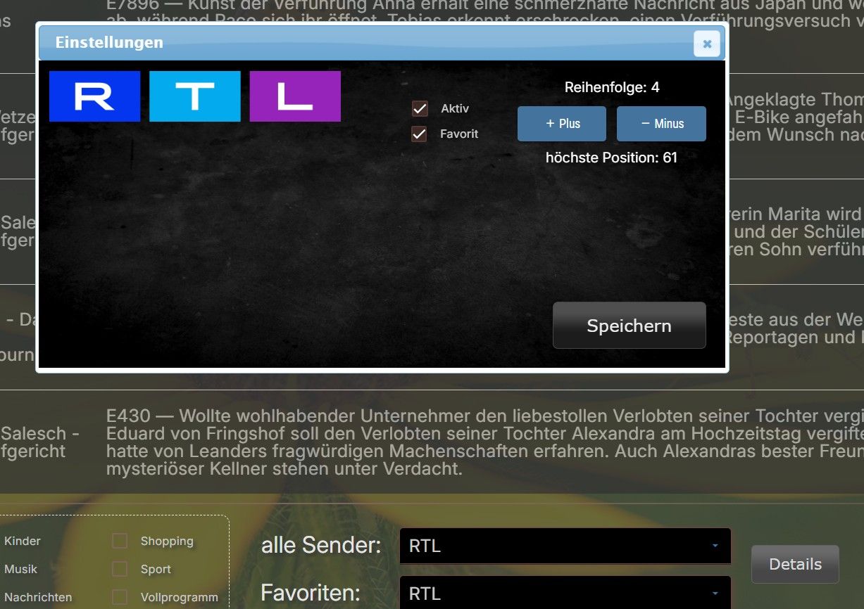

                              Siehe Post #11.
                              Und hier die vom Popup.

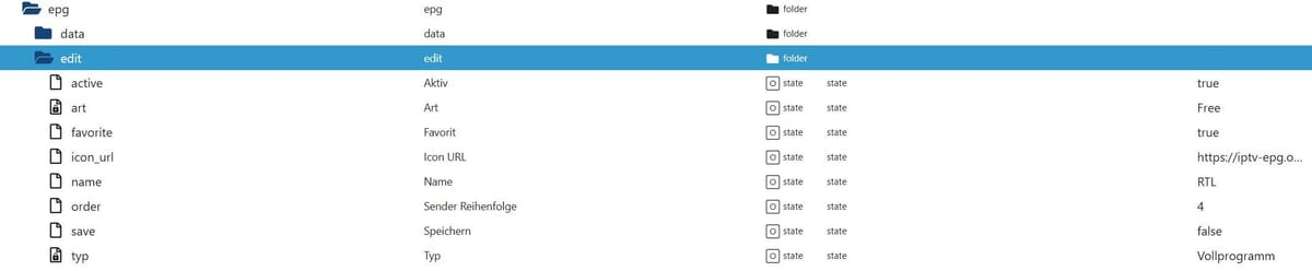

                              [{"tpl":"tplVis-materialdesign-CheckBox","data":{"oid":"0_userdata.0.epg.edit.active","g_fixed":false,"g_visibility":false,"g_css_font_text":true,"g_css_background":false,"g_css_shadow_padding":false,"g_css_border":false,"g_gestures":false,"g_signals":false,"g_last_change":false,"visibility-cond":"==","visibility-val":1,"visibility-groups-action":"hide","toggleType":"boolean","stateIfNotTrueValue":"on","vibrateOnMobilDevices":"50","labelPosition":"right","labelClickActive":true,"valueFontFamily":"InterVariable","valueFontSize":"13","colorCheckBox":"rgba(110, 70, 62, 0.45)","colorCheckBoxBorder":"rgba(110, 70, 62, 1)","colorCheckBoxHover":"#mdwTheme:vis-materialdesign.0.colors.checkbox.hover","labelColorFalse":"rgba(255,255,255,0.8)","labelColorTrue":"rgba(255,255,255,0.8)","signals-cond-0":"==","signals-val-0":true,"signals-icon-0":"/vis/signals/lowbattery.png","signals-icon-size-0":0,"signals-blink-0":false,"signals-horz-0":0,"signals-vert-0":0,"signals-hide-edit-0":false,"signals-cond-1":"==","signals-val-1":true,"signals-icon-1":"/vis/signals/lowbattery.png","signals-icon-size-1":0,"signals-blink-1":false,"signals-horz-1":0,"signals-vert-1":0,"signals-hide-edit-1":false,"signals-cond-2":"==","signals-val-2":true,"signals-icon-2":"/vis/signals/lowbattery.png","signals-icon-size-2":0,"signals-blink-2":false,"signals-horz-2":0,"signals-vert-2":0,"signals-hide-edit-2":false,"lc-type":"last-change","lc-is-interval":true,"lc-is-moment":false,"lc-format":"","lc-position-vert":"top","lc-position-horz":"right","lc-offset-vert":0,"lc-offset-horz":0,"lc-font-size":"12px","lc-font-family":"","lc-font-style":"","lc-bkg-color":"","lc-color":"","lc-border-width":"0","lc-border-style":"","lc-border-color":"","lc-border-radius":10,"lc-zindex":0,"valueOff":"false","valueOn":"true","labelFalse":"Aktiv","labelTrue":"Aktiv","g_lock":false,"autoLockAfter":"10","lockIconTop":"5","lockIconLeft":"5","lockIconColor":"#mdwTheme:vis-materialdesign.0.colors.checkbox.lock_icon","lockFilterGrayscale":"30","clickSoundVolume":"0.5"},"style":{"left":"413px","top":"40px","width":"108px","height":"30px","z-index":"999","text-shadow":"3px 3px 4px #000","font-family":"InterVariable","font-style":"normal","font-variant":"normal","font-weight":"normal","font-size":"12.5px"},"widgetSet":"materialdesign"},{"tpl":"tplImage","data":{"g_fixed":true,"g_visibility":false,"g_css_font_text":false,"g_css_background":false,"g_css_shadow_padding":false,"g_css_border":false,"g_gestures":false,"g_signals":false,"g_last_change":false,"visibility-cond":"==","visibility-val":1,"visibility-groups-action":"hide","refreshInterval":"0","signals-cond-0":"==","signals-val-0":true,"signals-icon-0":"/vis/signals/lowbattery.png","signals-icon-size-0":0,"signals-blink-0":false,"signals-horz-0":0,"signals-vert-0":0,"signals-hide-edit-0":false,"signals-cond-1":"==","signals-val-1":true,"signals-icon-1":"/vis/signals/lowbattery.png","signals-icon-size-1":0,"signals-blink-1":false,"signals-horz-1":0,"signals-vert-1":0,"signals-hide-edit-1":false,"signals-cond-2":"==","signals-val-2":true,"signals-icon-2":"/vis/signals/lowbattery.png","signals-icon-size-2":0,"signals-blink-2":false,"signals-horz-2":0,"signals-vert-2":0,"signals-hide-edit-2":false,"lc-type":"last-change","lc-is-interval":true,"lc-is-moment":false,"lc-format":"","lc-position-vert":"top","lc-position-horz":"right","lc-offset-vert":0,"lc-offset-horz":0,"lc-font-size":"12px","lc-font-family":"","lc-font-style":"","lc-bkg-color":"","lc-color":"","lc-border-width":"0","lc-border-style":"","lc-border-color":"","lc-border-radius":10,"lc-zindex":0,"src":"/vis.0/dashboard/struktur.jpg","stretch":true,"name":"Background","locked":true},"style":{"left":"0px","top":"0px","width":"780px","height":"350px","z-index":"1"},"widgetSet":"basic"},{"tpl":"tplValueStringImg","data":{"oid":"nothing_selected","g_fixed":false,"g_visibility":false,"g_css_font_text":false,"g_css_background":false,"g_css_shadow_padding":false,"g_css_border":false,"g_gestures":false,"g_signals":false,"g_last_change":false,"visibility-cond":"==","visibility-val":1,"visibility-groups-action":"hide","refreshInterval":"0","signals-cond-0":"==","signals-val-0":true,"signals-icon-0":"/vis/signals/lowbattery.png","signals-icon-size-0":0,"signals-blink-0":false,"signals-horz-0":0,"signals-vert-0":0,"signals-hide-edit-0":false,"signals-cond-1":"==","signals-val-1":true,"signals-icon-1":"/vis/signals/lowbattery.png","signals-icon-size-1":0,"signals-blink-1":false,"signals-horz-1":0,"signals-vert-1":0,"signals-hide-edit-1":false,"signals-cond-2":"==","signals-val-2":true,"signals-icon-2":"/vis/signals/lowbattery.png","signals-icon-size-2":0,"signals-blink-2":false,"signals-horz-2":0,"signals-vert-2":0,"signals-hide-edit-2":false,"lc-type":"last-change","lc-is-interval":true,"lc-is-moment":false,"lc-format":"","lc-position-vert":"top","lc-position-horz":"right","lc-offset-vert":0,"lc-offset-horz":0,"lc-font-size":"12px","lc-font-family":"","lc-font-style":"","lc-bkg-color":"","lc-color":"","lc-border-width":"0","lc-border-style":"","lc-border-color":"","lc-border-radius":10,"lc-zindex":0},"style":{"left":"99px","top":"86px"},"widgetSet":"basic"},{"tpl":"tplValueStringImg","data":{"oid":"","g_fixed":false,"g_visibility":false,"g_css_font_text":false,"g_css_background":false,"g_css_shadow_padding":false,"g_css_border":false,"g_gestures":false,"g_signals":false,"g_last_change":false,"visibility-cond":"==","visibility-val":1,"visibility-groups-action":"hide","refreshInterval":"0","signals-cond-0":"==","signals-val-0":true,"signals-icon-0":"/vis/signals/lowbattery.png","signals-icon-size-0":0,"signals-blink-0":false,"signals-horz-0":0,"signals-vert-0":0,"signals-hide-edit-0":false,"signals-cond-1":"==","signals-val-1":true,"signals-icon-1":"/vis/signals/lowbattery.png","signals-icon-size-1":0,"signals-blink-1":false,"signals-horz-1":0,"signals-vert-1":0,"signals-hide-edit-1":false,"signals-cond-2":"==","signals-val-2":true,"signals-icon-2":"/vis/signals/lowbattery.png","signals-icon-size-2":0,"signals-blink-2":false,"signals-horz-2":0,"signals-vert-2":0,"signals-hide-edit-2":false,"lc-type":"last-change","lc-is-interval":true,"lc-is-moment":false,"lc-format":"","lc-position-vert":"top","lc-position-horz":"right","lc-offset-vert":0,"lc-offset-horz":0,"lc-font-size":"12px","lc-font-family":"","lc-font-style":"","lc-bkg-color":"","lc-color":"","lc-border-width":"0","lc-border-style":"","lc-border-color":"","lc-border-radius":10,"lc-zindex":0},"style":{"left":"10px","top":"14px","width":"300px","height":"300px","z-index":"2"},"widgetSet":"basic"},{"tpl":"tplVis-materialdesign-CheckBox","data":{"oid":"0_userdata.0.epg.edit.favorite","g_fixed":false,"g_visibility":false,"g_css_font_text":true,"g_css_background":false,"g_css_shadow_padding":false,"g_css_border":false,"g_gestures":false,"g_signals":false,"g_last_change":false,"visibility-cond":"==","visibility-val":1,"visibility-groups-action":"hide","toggleType":"boolean","stateIfNotTrueValue":"on","vibrateOnMobilDevices":"50","labelPosition":"right","labelClickActive":true,"valueFontFamily":"InterVariable","valueFontSize":"13","colorCheckBox":"rgba(110, 70, 62, 0.45)","colorCheckBoxBorder":"rgba(110, 70, 62, 1)","colorCheckBoxHover":"#mdwTheme:vis-materialdesign.0.colors.checkbox.hover","labelColorFalse":"rgba(255,255,255,0.8)","labelColorTrue":"rgba(255,255,255,0.8)","signals-cond-0":"==","signals-val-0":true,"signals-icon-0":"/vis/signals/lowbattery.png","signals-icon-size-0":0,"signals-blink-0":false,"signals-horz-0":0,"signals-vert-0":0,"signals-hide-edit-0":false,"signals-cond-1":"==","signals-val-1":true,"signals-icon-1":"/vis/signals/lowbattery.png","signals-icon-size-1":0,"signals-blink-1":false,"signals-horz-1":0,"signals-vert-1":0,"signals-hide-edit-1":false,"signals-cond-2":"==","signals-val-2":true,"signals-icon-2":"/vis/signals/lowbattery.png","signals-icon-size-2":0,"signals-blink-2":false,"signals-horz-2":0,"signals-vert-2":0,"signals-hide-edit-2":false,"lc-type":"last-change","lc-is-interval":true,"lc-is-moment":false,"lc-format":"","lc-position-vert":"top","lc-position-horz":"right","lc-offset-vert":0,"lc-offset-horz":0,"lc-font-size":"12px","lc-font-family":"","lc-font-style":"","lc-bkg-color":"","lc-color":"","lc-border-width":"0","lc-border-style":"","lc-border-color":"","lc-border-radius":10,"lc-zindex":0,"valueOff":"false","valueOn":"true","labelFalse":"Favorit","labelTrue":"Favorit","g_lock":false,"autoLockAfter":"10","lockIconTop":"5","lockIconLeft":"5","lockIconColor":"#mdwTheme:vis-materialdesign.0.colors.checkbox.lock_icon","lockFilterGrayscale":"30","clickSoundVolume":"0.5"},"style":{"left":"412px","top":"69px","width":"108px","height":"30px","z-index":"999","text-shadow":"3px 3px 4px #000","font-family":"InterVariable","font-style":"normal","font-variant":"normal","font-weight":"normal","font-size":"12.5px"},"widgetSet":"materialdesign"},{"tpl":"tplVis-materialdesign-Button-Adition","data":{"oid":"0_userdata.0.epg.edit.order","g_fixed":false,"g_visibility":false,"g_css_font_text":true,"g_css_background":false,"g_css_shadow_padding":false,"g_css_border":false,"g_gestures":false,"g_signals":false,"g_last_change":false,"visibility-cond":"==","visibility-val":1,"visibility-groups-action":"hide","buttonStyle":"raised","vibrateOnMobilDevices":"50","clickSoundVolume":"0.5","buttontext":" Plus","textFontFamily":"#mdwTheme:vis-materialdesign.0.fonts.button.default.text","textFontSize":"#mdwTheme:vis-materialdesign.0.fontSizes.button.default.text","mdwButtonPrimaryColor":"var(--materialdesign-widget-theme-color-button-default-primary)","mdwButtonSecondaryColor":"var(--materialdesign-widget-theme-color-button-default-secondary)","image":"plus","iconPosition":"left","signals-cond-0":"==","signals-val-0":true,"signals-icon-0":"/vis/signals/lowbattery.png","signals-icon-size-0":0,"signals-blink-0":false,"signals-horz-0":0,"signals-vert-0":0,"signals-hide-edit-0":false,"signals-cond-1":"==","signals-val-1":true,"signals-icon-1":"/vis/signals/lowbattery.png","signals-icon-size-1":0,"signals-blink-1":false,"signals-horz-1":0,"signals-vert-1":0,"signals-hide-edit-1":false,"signals-cond-2":"==","signals-val-2":true,"signals-icon-2":"/vis/signals/lowbattery.png","signals-icon-size-2":0,"signals-blink-2":false,"signals-horz-2":0,"signals-vert-2":0,"signals-hide-edit-2":false,"lc-type":"last-change","lc-is-interval":true,"lc-is-moment":false,"lc-format":"","lc-position-vert":"top","lc-position-horz":"right","lc-offset-vert":0,"lc-offset-horz":0,"lc-font-size":"12px","lc-font-family":"","lc-font-style":"","lc-bkg-color":"","lc-color":"","lc-border-width":"0","lc-border-style":"","lc-border-color":"","lc-border-radius":10,"lc-zindex":0,"minmax":"100","value":"1"},"style":{"left":"544px","top":"52px","width":"101px","height":"40px","z-index":"3","color":"#ffffff"},"widgetSet":"materialdesign"},{"tpl":"tplVis-materialdesign-Button-Adition","data":{"oid":"0_userdata.0.epg.edit.order","g_fixed":false,"g_visibility":false,"g_css_font_text":true,"g_css_background":false,"g_css_shadow_padding":false,"g_css_border":false,"g_gestures":false,"g_signals":false,"g_last_change":false,"visibility-cond":"==","visibility-val":1,"visibility-groups-action":"hide","buttonStyle":"raised","vibrateOnMobilDevices":"50","clickSoundVolume":"0.5","buttontext":" Minus","textFontFamily":"#mdwTheme:vis-materialdesign.0.fonts.button.default.text","textFontSize":"#mdwTheme:vis-materialdesign.0.fontSizes.button.default.text","mdwButtonPrimaryColor":"var(--materialdesign-widget-theme-color-button-default-primary)","mdwButtonSecondaryColor":"var(--materialdesign-widget-theme-color-button-default-secondary)","image":"minus","iconPosition":"left","signals-cond-0":"==","signals-val-0":true,"signals-icon-0":"/vis/signals/lowbattery.png","signals-icon-size-0":0,"signals-blink-0":false,"signals-horz-0":0,"signals-vert-0":0,"signals-hide-edit-0":false,"signals-cond-1":"==","signals-val-1":true,"signals-icon-1":"/vis/signals/lowbattery.png","signals-icon-size-1":0,"signals-blink-1":false,"signals-horz-1":0,"signals-vert-1":0,"signals-hide-edit-1":false,"signals-cond-2":"==","signals-val-2":true,"signals-icon-2":"/vis/signals/lowbattery.png","signals-icon-size-2":0,"signals-blink-2":false,"signals-horz-2":0,"signals-vert-2":0,"signals-hide-edit-2":false,"lc-type":"last-change","lc-is-interval":true,"lc-is-moment":false,"lc-format":"","lc-position-vert":"top","lc-position-horz":"right","lc-offset-vert":0,"lc-offset-horz":0,"lc-font-size":"12px","lc-font-family":"","lc-font-style":"","lc-bkg-color":"","lc-color":"","lc-border-width":"0","lc-border-style":"","lc-border-color":"","lc-border-radius":10,"lc-zindex":0,"minmax":"{0_userdata.0.epg.max_order_number}","value":"-1"},"style":{"left":"657px","top":"52px","width":"101px","height":"40px","z-index":"3","color":"#ffffff"},"widgetSet":"materialdesign"},{"tpl":"tplValueFloat","data":{"oid":"0_userdata.0.epg.edit.order","g_fixed":false,"g_visibility":false,"g_css_font_text":true,"g_css_background":false,"g_css_shadow_padding":false,"g_css_border":false,"g_gestures":false,"g_signals":false,"g_last_change":false,"visibility-cond":"==","visibility-val":1,"visibility-groups-action":"hide","is_comma":"true","factor":"1","signals-cond-0":"==","signals-val-0":true,"signals-icon-0":"/vis/signals/lowbattery.png","signals-icon-size-0":0,"signals-blink-0":false,"signals-horz-0":0,"signals-vert-0":0,"signals-hide-edit-0":false,"signals-cond-1":"==","signals-val-1":true,"signals-icon-1":"/vis/signals/lowbattery.png","signals-icon-size-1":0,"signals-blink-1":false,"signals-horz-1":0,"signals-vert-1":0,"signals-hide-edit-1":false,"signals-cond-2":"==","signals-val-2":true,"signals-icon-2":"/vis/signals/lowbattery.png","signals-icon-size-2":0,"signals-blink-2":false,"signals-horz-2":0,"signals-vert-2":0,"signals-hide-edit-2":false,"lc-type":"last-change","lc-is-interval":true,"lc-is-moment":false,"lc-format":"","lc-position-vert":"top","lc-position-horz":"right","lc-offset-vert":0,"lc-offset-horz":0,"lc-font-size":"12px","lc-font-family":"","lc-font-style":"","lc-bkg-color":"","lc-color":"","lc-border-width":"0","lc-border-style":"","lc-border-color":"","lc-border-radius":10,"lc-zindex":0,"html_prepend":"Reihenfolge: "},"style":{"left":"544px","top":"21px","z-index":"3","color":"#ffffff","text-align":"center","text-shadow":"3px 3px 4px #000","font-family":"InterVariable","font-style":"normal","font-variant":"normal","font-weight":"normal","font-size":"medium","width":"215px","height":"22px"},"widgetSet":"basic"},{"tpl":"tplValueFloat","data":{"oid":"0_userdata.0.epg.max_order_number","g_fixed":false,"g_visibility":false,"g_css_font_text":true,"g_css_background":false,"g_css_shadow_padding":false,"g_css_border":false,"g_gestures":false,"g_signals":false,"g_last_change":false,"visibility-cond":"==","visibility-val":1,"visibility-groups-action":"hide","is_comma":"true","factor":"1","signals-cond-0":"==","signals-val-0":true,"signals-icon-0":"/vis/signals/lowbattery.png","signals-icon-size-0":0,"signals-blink-0":false,"signals-horz-0":0,"signals-vert-0":0,"signals-hide-edit-0":false,"signals-cond-1":"==","signals-val-1":true,"signals-icon-1":"/vis/signals/lowbattery.png","signals-icon-size-1":0,"signals-blink-1":false,"signals-horz-1":0,"signals-vert-1":0,"signals-hide-edit-1":false,"signals-cond-2":"==","signals-val-2":true,"signals-icon-2":"/vis/signals/lowbattery.png","signals-icon-size-2":0,"signals-blink-2":false,"signals-horz-2":0,"signals-vert-2":0,"signals-hide-edit-2":false,"lc-type":"last-change","lc-is-interval":true,"lc-is-moment":false,"lc-format":"","lc-position-vert":"top","lc-position-horz":"right","lc-offset-vert":0,"lc-offset-horz":0,"lc-font-size":"12px","lc-font-family":"","lc-font-style":"","lc-bkg-color":"","lc-color":"","lc-border-width":"0","lc-border-style":"","lc-border-color":"","lc-border-radius":10,"lc-zindex":0,"html_prepend":"höchste Position: "},"style":{"left":"543px","top":"101px","z-index":"3","color":"#ffffff","text-align":"center","text-shadow":"3px 3px 4px #000","font-family":"InterVariable","font-style":"normal","font-variant":"normal","font-weight":"normal","font-size":"medium","width":"215px","height":"22px"},"widgetSet":"basic"},{"tpl":"tplJquiButtonState","data":{"oid":"0_userdata.0.epg.edit.save","g_fixed":false,"g_visibility":false,"g_css_font_text":false,"g_css_background":false,"g_css_shadow_padding":false,"g_css_border":false,"g_gestures":false,"g_signals":false,"g_last_change":false,"visibility-cond":"==","visibility-val":1,"visibility-groups-action":"hide","buttontext":"Speichern","signals-cond-0":"==","signals-val-0":true,"signals-icon-0":"/vis/signals/lowbattery.png","signals-icon-size-0":0,"signals-blink-0":false,"signals-horz-0":0,"signals-vert-0":0,"signals-hide-edit-0":false,"signals-cond-1":"==","signals-val-1":true,"signals-icon-1":"/vis/signals/lowbattery.png","signals-icon-size-1":0,"signals-blink-1":false,"signals-horz-1":0,"signals-vert-1":0,"signals-hide-edit-1":false,"signals-cond-2":"==","signals-val-2":true,"signals-icon-2":"/vis/signals/lowbattery.png","signals-icon-size-2":0,"signals-blink-2":false,"signals-horz-2":0,"signals-vert-2":0,"signals-hide-edit-2":false,"lc-type":"last-change","lc-is-interval":true,"lc-is-moment":false,"lc-format":"","lc-position-vert":"top","lc-position-horz":"right","lc-offset-vert":0,"lc-offset-horz":0,"lc-font-size":"12px","lc-font-family":"","lc-font-style":"","lc-bkg-color":"","lc-color":"","lc-border-width":"0","lc-border-style":"","lc-border-color":"","lc-border-radius":10,"lc-zindex":0,"value":"true"},"style":{"left":"584px","top":"275px","width":"174px","height":"53px","z-index":"3"},"widgetSet":"jqui"},{"tpl":"tplValueStringImg","data":{"oid":"0_userdata.0.epg.edit.icon_url","g_fixed":false,"g_visibility":false,"g_css_font_text":false,"g_css_background":false,"g_css_shadow_padding":false,"g_css_border":false,"g_gestures":false,"g_signals":false,"g_last_change":false,"visibility-cond":"==","visibility-val":1,"visibility-groups-action":"hide","refreshInterval":"0","signals-cond-0":"==","signals-val-0":true,"signals-icon-0":"/vis/signals/lowbattery.png","signals-icon-size-0":0,"signals-blink-0":false,"signals-horz-0":0,"signals-vert-0":0,"signals-hide-edit-0":false,"signals-cond-1":"==","signals-val-1":true,"signals-icon-1":"/vis/signals/lowbattery.png","signals-icon-size-1":0,"signals-blink-1":false,"signals-horz-1":0,"signals-vert-1":0,"signals-hide-edit-1":false,"signals-cond-2":"==","signals-val-2":true,"signals-icon-2":"/vis/signals/lowbattery.png","signals-icon-size-2":0,"signals-blink-2":false,"signals-horz-2":0,"signals-vert-2":0,"signals-hide-edit-2":false,"lc-type":"last-change","lc-is-interval":true,"lc-is-moment":false,"lc-format":"","lc-position-vert":"top","lc-position-horz":"right","lc-offset-vert":0,"lc-offset-horz":0,"lc-font-size":"12px","lc-font-family":"","lc-font-style":"","lc-bkg-color":"","lc-color":"","lc-border-width":"0","lc-border-style":"","lc-border-color":"","lc-border-radius":10,"lc-zindex":0},"style":{"left":"12px","top":"12px","z-index":"3","width":"331px","height":"331px"},"widgetSet":"basic"}]

                                    Änderung 1.0.1 - 24.06.2026
                                    • Start und Stop jetzt nur im klassischen Stil (HH:MM). Also 19:15, 20:15, etc.
                                    • Weiterer Datenpunkt "selected_channel_favorite" löst die selben Ereignisse wie "selected_channel" aus. Senderdetails für Visualisierung und in der Hauptanzeige alle Sendungen zum gewählten Kanal.
                                    • Zentrale Sendereditierung. Jetzt können über den Datenpunkt "sender_edit_list" die wichtigsten Einstellungen pro Sender zentral vorgenommen werden. Dazu wird der Inhalt des Datenpunktes (json) angepasst. Dazu kann der Sender den Favoriten (favorite) hinzugefügt, aktiviert oder deaktiviert (active) werden. Darüber hinaus sit es möglich, die Senderreihenfolge (order) festzulegen. Wenn alle Änderungen durchgeführt - einfach speichern und ein Trigger erledigt automatisch den Rest (Daten werden an Sender übergeben und Einstellungen werden sofort aktiv).

                                        Ich werde für die zwei Auswahlfelder getrennte Datenpunkte machen.
                                        Am Ende lösen zwar beide die selbe Aktion aus, ABER in der Darstellung bleiben beide befüllt und die Favoritenauswahl
                                        kann nicht mehr leer erscheinen. Also so wie im unteren Bild zu sehen - das wird dann nicht mehr passieren.
                                        Ro75.
