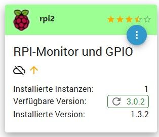

    Auch damit passiert genau so viel wie wenn ich das Update direkt in der GUI anstoße:
    pi@RaspberryPi4B:~ $ iob update
    Used repository: stable
    Adapter    "admin"        : 7.7.22   , installed 7.7.22
    Adapter    "backitup"     : 3.3.14   , installed 3.3.14
    Adapter    "email"        : 2.0.4    , installed 2.0.4
    Adapter    "fahrplan"     : 1.4.1    , installed 1.4.1
    Adapter    "feiertage"    : 1.3.0    , installed 1.3.0
    Adapter    "hm-rpc"       : 3.0.1    , installed 3.0.1
    Adapter    "ical"         : 1.20.0   , installed 1.20.0
    Adapter    "icons-addictive-flavour-png": 0.1.0, installed 0.1.0
    Adapter    "javascript"   : 9.0.18   , installed 9.0.18
    Controller "js-controller": 7.0.7    , installed 7.0.7
    Adapter    "kecontact"    : 3.6.0    , installed 3.6.0
    Adapter    "mobile"       : 1.0.1    , installed 1.0.1
    Adapter    "modbus"       : 8.0.3    , installed 8.0.3
    Adapter    "netatmo"      : 3.1.0    , installed 3.1.0
    Adapter    "ping"         : 1.7.9    , installed 1.7.9
    Adapter    "rest-api"     : 4.0.1    , installed 4.0.1
    Adapter    "rpi2"         : 3.0.2    , installed 1.3.2  [Updatable]
    Adapter    "shelly"       : 10.6.1   , installed 10.6.1
    Adapter    "sma-em"       : 1.3.1    , installed 1.3.1
    Adapter    "socketio"     : 7.0.8    , installed 7.1.3
    Adapter    "sonos"        : 3.0.0    , installed 3.0.0
    Adapter    "sql"          : 3.0.1    , installed 3.0.1
    Adapter    "vis-icontwo"  : 2.11.3   , installed 2.11.3
    Adapter    "vis-inventwo" : 3.3.5    , installed 3.3.5
    Adapter    "web"          : 8.0.0    , installed 8.0.0
    Adapter    "whatsapp-cmb" : 0.3.0    , installed 0.3.0
    Adapter    "ws"           : 4.0.0    , installed 4.0.0
    Adapter    "yamaha"       : 0.5.4    , installed 0.5.4
    pi@RaspberryPi4B:~ $ iob upgrade
    This upgrade of "rpi2" will at least introduce the following changes:
    -> 3.0.2:
    Check for required libgpiod-dev package version
    -> 3.0.1:
    Updated logo, workflows and documentation
    admin 7.6.17 and js-controller 6.0.11 (or later) are required
    -> 3.0.0:
    NodeJS 20.x (or newer) is required
    Updated opengpio to v2 (works on Debian trixie)
    -> 2.4.0:
    read the current state of GPIO outputs during adapter startup.
    re-read GPIO input, if set by the user (with ack=false).
    add an option to invert true/false mapping to 1/0.
    Allow multiple instances of this adapter per host.
    tried to improve initialization of GPIO inputs.
    -> 2.3.2:
    added support for NVMe temperature (needs additional configuration, see README)
    fixed inital values for outputs.
    -> 2.3.1:
    fixed: GPIO library failed to load after recent dependency update.
    -> 2.3.0:
    correct interpretation of start value setting. Output with initial value 0/1 will set GPIO accordingly during startup. Output without an initial state will not set GPIO at all.
    BE CAREFUL: THIS IS A MAJOR UPGRADE, WHICH WILL MOST LIKELY INTRODUCE BREAKING CHANGES!
    Would you like to upgrade rpi2 from @1.3.2 to @3.0.2 now? [(y)es, (n)o]: y
    Update rpi2 from @1.3.2 to @3.0.2
    NPM version: 10.9.7
    Installing iobroker.rpi2@3.0.2... (System call)
    Updating objects from io-package.json for adapter "rpi2" with version "1.3.2"
    upload [2] rpi2.admin /opt/iobroker/node_modules/iobroker.rpi2/admin/index_m.html index_m.html text/html
    upload [1] rpi2.admin /opt/iobroker/node_modules/iobroker.rpi2/admin/rpi.png rpi.png image/png
    upload [0] rpi2.admin /opt/iobroker/node_modules/iobroker.rpi2/admin/words.js words.js application/javascript
    Der Stand danach ist unverändert (Repo habe ich auch aktualisiert):

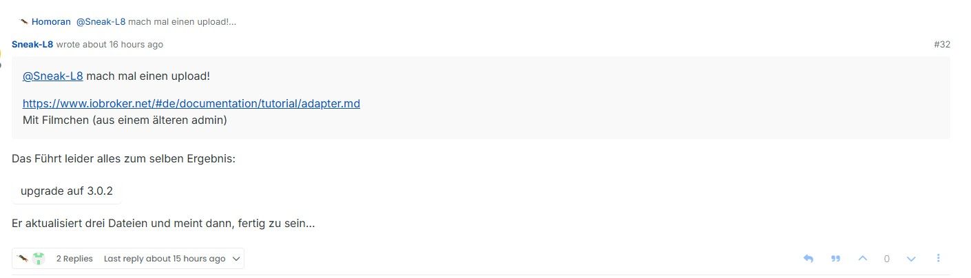

    • S Sneak-L8
      @Sneak-L8 mach mal einen upload!
      https://www.iobroker.net/#de/documentation/tutorial/adapter.md
      Mit Filmchen (aus einem älteren admin)
      Das Führt leider alles zum selben Ergebnis:
      NPM version: 10.9.7
      Er aktualisiert drei Dateien und meint dann, fertig zu sein...

                  Sorry, aber wenn du mit #32 das da meinst:
                  Da ist nicjht ein einziges LOGFILE dabei.
                  Unter log verstehe zumindest ich dass man (wenn möglich) den eingegebenen Befehl und allen Output sieht. Zumindest der komplette Output sollte da sein. In Beitrag #32 ist maximal eine Nacherzählung vorhanden, 'upgrade auf 3.0.2' kommt ziemlich sicher nie irgendwo als output.
                  P.S: Und UPLOAD ist keine Update/Upgrade Installation sondern aktualisisert nur die Anzeigedateien im Admin

                    #42
                    @mcm1957 sagte:
                    'upgrade auf 3.0.2'
                    Ist ein spoiler.
                    Darin ist der output, aber ohne --debug
