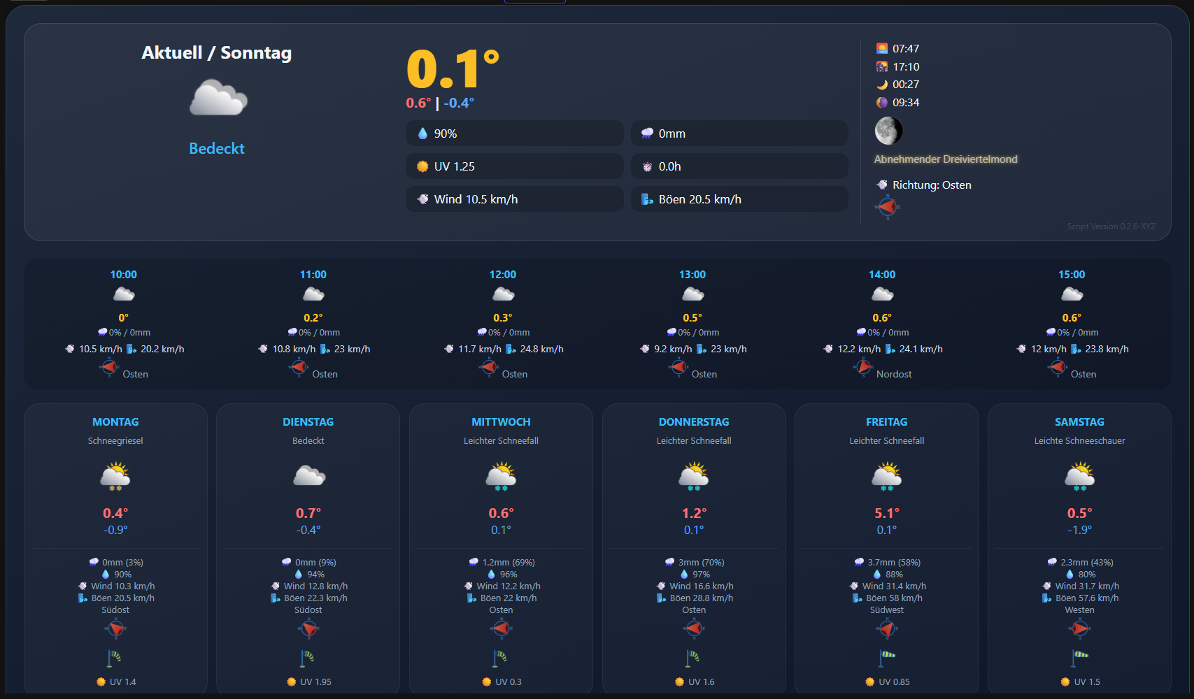

    hier mal das Script etwas korrigiert und mit den Winddaten.

        console.log("Weather widget: HTML successfully generated (v0.2.6).");
    // Trigger
    updateWeatherWidget();
    schedule("*/5 * * * *", updateWeatherWidget);
    on({id: dpBase + '.current.temperature_2m', change: 'any'}, updateWeatherWidget);
    on({id: forecast + '.hourly.next_hours.hour0.time', change: 'any'}, updateWeatherWidget);

      const fontSizeForecastDay = '0.75rem';
      const fontSizeForecastText = '0.65rem';
      const fontSizeForecastTempMax = '1rem';
      const fontSizeForecastTempMin = '0.85rem';
      const fontSizeForecastDetails = '0.65rem';
      const version = '0.2.6';
      const dpBase = 'open-meteo-weather.0.' + locationName + '.weather';
      const forecast = dpBase + '.forecast';
      const targetDP = '0_userdata.0.Wetter_Widget_HTML';
      // Sprach-Check
      let sysLang = 'de';
      try {
          const systemConfig = getObject("system.config");
          sysLang = systemConfig.common.language || 'de';
      } catch (e) { sysLang = 'de'; }
      const i18n = {
          de: { current: "Aktuell" },
          en: { current: "Current" }
      const lang = i18n[sysLang] || i18n['en'];
      // DP anlegen falls nicht vorhanden
      if (!existsState(targetDP)) {
          createState(targetDP, '', {
              name: 'Weather Widget for VIS2',
              type: 'string',
              role: 'html'
      // Hauptfunktion
      function updateWeatherWidget() {
          function getVal(id, unit = "") {
              let state = getState(id);
              if (!state || state.val === null || state.val === undefined) return "--" + unit;
              return state.val + unit;
          function getNum(id) {
              let s = getState(id);
              return (!s || s.val === null || s.val === undefined) ? null : Number(s.val);
          function getImg(id, size = "20px") {
              let url = getVal(id, "");
              if (url === "" || url === "--") return "";
              return `<img src="${url}" style="width:${size}; height:${size}; object-fit:contain;">`;
          function getSunHours(id) {
              let sec = getNum(id);
              if (sec === null) return "--h";
              return (sec / 3600).toFixed(1) + "h";
          // HTML Start
          let html = `
          <style>
              @keyframes moonGlow {
                  0% { filter: drop-shadow(0 0 2px #fbbf24); opacity: 0.85; }
                  50% { filter: drop-shadow(0 0 6px #fbbf24); opacity: 1; }
                  100% { filter: drop-shadow(0 0 2px #fbbf24); opacity: 0.85; }
              .moon-anim {
                  animation: moonGlow 3.5s ease-in-out infinite;
              .w-container {
                  font-family: 'Segoe UI', sans-serif;
                  background: linear-gradient(160deg, #1e293b 0%, #0f172a 100%);
                  color: #f1f5f9;
                  padding: 20px;
                  border-radius: 24px;
                  border: 1px solid #334155;
                  box-shadow: 0 10px 30px rgba(0,0,0,0.5);
              /* Mini-Verbesserung Z: Header optisch sauberer, gleiche Höhe */
              .w-header {
                  display: grid;
                  grid-template-columns: 1.2fr 1.5fr 1fr;
                  gap: 14px; /* vorher 15px */
                  background: rgba(255,255,255,0.05);
                  padding: 18px; /* vorher 20px, aber gleiche Höhe durch Innenstruktur */
                  border-radius: 20px;
                  margin-bottom: 20px;
                  border: 1px solid rgba(255,255,255,0.1);
              .w-temp-big { font-size: ${fontSizeTempBig}; font-weight: 900; color: #fbbf24; line-height: 1; }
              .w-desc { font-size: ${fontSizeDescription}; color: #38bdf8; font-weight: 600; }
              .w-info-grid { display: grid; grid-template-columns: 1fr 1fr; gap: 8px; font-size: ${fontSizeInfoGrid}; margin-top: 10px; }
              .w-info-item { background: rgba(0,0,0,0.2); padding: 6px 10px; border-radius: 10px; display: flex; align-items: center; gap: 5px; }
              .w-sun-moon { font-size: ${fontSizeSunMoon}; line-height: 1.6; border-left: 1px solid rgba(255,255,255,0.1); padding-left: 15px; }
              /* Mini-Verbesserung X: Stunden kompakter */
              .w-hourly {
                  display: grid;
                  grid-template-columns: repeat(6, 1fr);
                  gap: 8px;
                  margin-bottom: 16px; /* vorher 20px */
                  background: rgba(0,0,0,0.15);
                  padding: 10px;
                  border-radius: 15px;
              .w-h-item { text-align: center; font-size: ${fontSizeHourly}; }
              .w-h-time { font-weight: bold; color: #38bdf8; }
              .w-h-temp { font-weight: bold; color: #fbbf24; display: block; }
              .w-h-rain { font-size: ${fontSizeHourlyRain}; color: #94a3b8; }
              .w-forecast {
                  display: grid;
                  gap: 10px;
              .w-fc-day {
                  background: rgba(255,255,255,0.03);
                  padding: 12px 8px;
                  border-radius: 18px;
                  text-align: center;
                  border: 1px solid rgba(255,255,255,0.05);
                  display: flex;
                  flex-direction: column;
                  justify-content: space-between;
              .w-fc-name {
                  font-weight: bold;
                  color: #38bdf8;
                  font-size: ${fontSizeForecastDay};
                  text-transform: uppercase;
                  margin-bottom: 2px;
              /* Mini-Verbesserung X: Wettertext sauber zentriert */
              .w-fc-text {
                  font-size: ${fontSizeForecastText};
                  color: #94a3b8;
                  min-height: 2.2em;
                  display: flex;
                  justify-content: center;
                  text-align: center;
                  margin-bottom: 5px;
              /* Mini-Verbesserung X: Temperaturen zentriert */
              .w-fc-temp-max {
                  color: #f87171;
                  font-weight: bold;
                  font-size: ${fontSizeForecastTempMax};
                  display: block;
                  text-align: center;
              .w-fc-temp-min {
                  color: #60a5fa;
                  font-size: ${fontSizeForecastTempMin};
                  display: block;
                  margin-bottom: 5px;
                  text-align: center;
              /* Mini-Verbesserung Y: Icons perfekt vertikal ausgerichtet */
              .w-fc-day img {
                  margin: 2px 0 4px 0; /* optisch sauberer, gleiche Höhe */
              .w-fc-details {
                  font-size: ${fontSizeForecastDetails};
                  color: #94a3b8;
                  border-top: 1px solid rgba(255,255,255,0.05);
                  margin-top: 8px;
                  padding-top: 8px;
          </style>
          <div class="w-container">
              <div class="w-header">
                  <div style="text-align: center;">
                      <div style="font-size:${fontSizeCurrentLabel}; font-weight:bold;">
                          ${lang.current} / ${getVal(forecast + '.day0.name_day')}
                      </div>
                      ${getImg(dpBase + '.current.icon_url', "80px")}
                      <div class="w-desc">${getVal(dpBase + '.current.weather_text')}</div>
                  </div>
                  <div>
                      <div class="w-temp-big">${getVal(dpBase + '.current.temperature_2m', "°")}</div>
                      <div style="font-weight:bold; margin-bottom:10px;">
                          <span style="color:#f87171">${getVal(forecast + '.day0.temperature_2m_max', "°")}</span> |
                          <span style="color:#60a5fa">${getVal(forecast + '.day0.temperature_2m_min', "°")}</span>
                      </div>
                      <div class="w-info-grid">
                          <div class="w-info-item">💧 ${getVal(dpBase + '.current.relative_humidity_2m', "%")}</div>
                          <div class="w-info-item">🌧️ ${getVal(forecast + '.day0.precipitation_sum', "mm")}</div>
                          <div class="w-info-item">☀️ UV ${getVal(forecast + '.day0.uv_index_max')}</div>
                          <div class="w-info-item">⏱️ ${getSunHours(forecast + '.day0.sunshine_duration')}</div>
                          <div class="w-info-item">💨 Wind ${getVal(dpBase + '.current.wind_speed_10m', " km/h")}</div>
                          <div class="w-info-item">🌬️ Böen ${getVal(dpBase + '.current.wind_gusts_10m', " km/h")}</div>
                      </div>
                  </div>
                  <div class="w-sun-moon" style="position:relative;">
                      🌅 ${getVal(forecast + '.day0.sunrise')}<br>
                      🌇 ${getVal(forecast + '.day0.sunset')}<br>
                      🌙 ${getVal(forecast + '.day0.moonrise')}<br>
                      🌘 ${getVal(forecast + '.day0.moonset')}<br>
                      <div style="margin-top:6px;">
                          ${getImg(forecast + '.day0.moon_phase_icon', "34px")}
                          <div class="moon-anim" style="font-size:0.75rem; color:#cbd5e1;">
                              ${getVal(forecast + '.day0.moon_phase_text')}
                          </div>
                      </div>
                      <div style="margin-top:10px;">
                          💨 Richtung: ${getVal(dpBase + '.current.wind_direction_text')}<br>
                          ${getImg(dpBase + '.current.wind_direction_icon', "30px")}
                      </div>
                      <div style="position:absolute; bottom:-10px; right:0; font-size:0.6rem; color:#475569; opacity:0.8;">
                          Script Version ${version}
                      </div>
                  </div>
              </div>
              <div class="w-hourly">
          // Stunden – mit Wind + Mond
          for (let h = 0; h <= 5; h++) {
              let hPath = forecast + '.hourly.next_hours.hour' + h;
              let isNight = getNum(hPath + '.is_day') === 0;
              html += `
                  <div class="w-h-item">
                      <div class="w-h-time">${getVal(hPath + '.time')}</div>
                      ${getImg(hPath + '.icon_url', "30px")}
                      <span class="w-h-temp">${getVal(hPath + '.temperature_2m', "°")}</span>
                      <span class="w-h-rain">
                          🌧️${getVal(hPath + '.precipitation_probability', "%")} /
                          ${getVal(hPath + '.precipitation', "mm")}
                      </span>
                      <div style="margin-top:4px; font-size:0.7rem; color:#cbd5e1;">
                          💨 ${getVal(hPath + '.wind_speed_10m', " km/h")}
                          🌬️ ${getVal(hPath + '.wind_gusts_10m', " km/h")}
                      </div>
                      <div style="margin-top:2px;">
                          ${getImg(hPath + '.wind_direction_icon', "24px")}
                          <span style="font-size:0.7rem; color:#94a3b8;">
                              ${getVal(hPath + '.wind_direction_text')}
                          </span>
                      </div>
                          isNight
                          <div style="margin-top:4px;">
                              ${getImg(hPath + '.moon_phase_icon', "24px")}
                              <div style="font-size:0.65rem; color:#cbd5e1;">
                                  ${getVal(hPath + '.moon_phase_text')}
                              </div>
                          </div>
                  </div>
          html += `
              </div>
              <div class="w-forecast">
          // 6-Tage-Vorhersage
          for (let i = 1; i <= 6; i++) {
              let d = forecast + '.day' + i;
              html += `
              <div class="w-fc-day">
                  <div>
                      <div class="w-fc-name">${getVal(d + '.name_day')}</div>
                      <div class="w-fc-text">${getVal(d + '.weather_text')}</div>
                      ${getImg(d + '.icon_url', "45px")}
                      <span class="w-fc-temp-max">${getVal(d + '.temperature_2m_max', "°")}</span>
                      <span class="w-fc-temp-min">${getVal(d + '.temperature_2m_min', "°")}</span>
                  </div>
                  <div class="w-fc-details">
                      🌧️ ${getVal(d + '.precipitation_sum', "mm")} (${getVal(d + '.precipitation_probability_max', "%")})<br>
                      💧 ${getVal(d + '.relative_humidity_2m_mean', "%")}<br>
                      💨 Wind ${getVal(d + '.wind_speed_10m_max', " km/h")}<br>
                      🌬️ Böen ${getVal(d + '.wind_gusts_10m_max', " km/h")}<br>
                      ${getVal(d + '.wind_direction_text')}<br>
                      ${getImg(d + '.wind_direction_icon', "26px")}<br>
                      ${getImg(d + '.wind_gust_icon', "26px")}<br>
                      ☀️ UV ${getVal(d + '.uv_index_max')}
                  </div>
              </div>
          html += `</div></div>`;
          setState(targetDP, html, true);
      // Trigger
