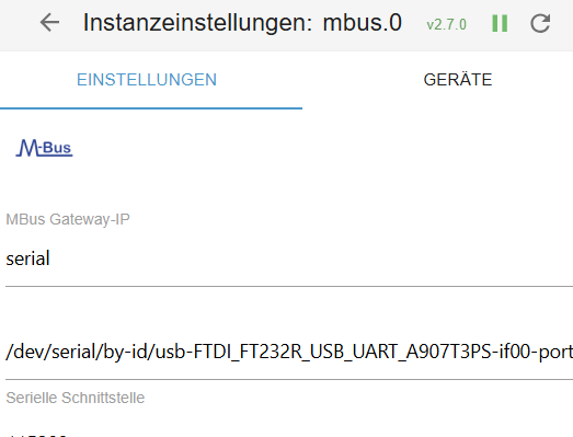

    @Homoran sagte in Update von node 20 auf 22: Verbindung cloud geht nicht mehr:
    nicht mit /dev/serial/by-id/?
    wie seit Jahren schon.
    Die Schnittstellen werden erkannt und vorgeschlagen und dann wählt man die richtige aus.
    Bei mir:
    @bahnuhr
    USB-Devices by-id:
    USB-Sticks - Avoid direct links to /dev/tty* in your adapter setups, please always prefer the links 'by-id':
    No Devices found 'by-id'

            USB-Devices by-id:
            /dev/serial/by-id/usb-FTDI_FT232R_USB_UART_A907T3PS-if00-port0
            /dev/serial/by-id/usb-FTDI_FT232R_USB_UART_AH06GH5Y-if00-port0

            2026-01-01 17:52:39.244  - info: smartmeter.1 (850) Received 10 values, 10 updated
            2026-01-01 17:55:13.647  - info: host.Pi-Strom-Wasser instance "system.adapter.proxmox.0" disabled via .alive
            2026-01-01 17:56:54.670  - info: host.Pi-Strom-Wasser "system.adapter.mbus.0" enabled
            2026-01-01 17:56:58.824  - info: host.Pi-Strom-Wasser instance system.adapter.mbus.0 in version "2.7.0" started with pid 894
            2026-01-01 17:57:01.590  - info: mbus.0 (894) starting. Version 2.7.0 in /opt/iobroker/node_modules/iobroker.mbus, node: v20.19.6, js-controller: 7.0.7
            2026-01-01 17:57:01.615  - info: mbus.0 (894) Default Update Interval: 900
            2026-01-01 17:57:01.616  - error: mbus.0 (894) Please specify serial port of M-Bus gateway
            2026-01-01 17:57:08.577  - info: mbus.0 (894) List of port: [{"path":"/dev/ttyUSB0","manufacturer":"FTDI","serialNumber":"AH06GH5Y","pnpId":"usb-FTDI_FT232R_USB_UART_AH06GH5Y-if00-port0","vendorId":"0403","productId":"6001"},{"path":"/dev/ttyUSB1","manufacturer":"FTDI","serialNumber":"A907T3PS","pnpId":"usb-FTDI_FT232R_USB_UART_A907T3PS-if00-port0","vendorId":"0403","productId":"6001"}]
            2026-01-01 17:57:39.875  - info: smartmeter.1 (850) Received 10 values, 3 updated
            2026-01-01 17:58:09.663  - info: host.Pi-Strom-Wasser stopInstance system.adapter.mbus.0 (force=false, process=true)
            2026-01-01 17:58:09.871  - info: host.Pi-Strom-Wasser stopInstance system.adapter.mbus.0 send kill signal

            2026-01-01 17:58:18.128  - info: mbus.0 (914) Initialize M-Bus Serial to /dev/serial/by-id/usb-FTDI_FT232R_USB_UART_A907T3PS-if00-port0 with 115200baud
            2026-01-01 17:58:18.141  - info: mbus.0 (914) Schedule initialization for M-Bus-ID 17834338B4090107 with update interval 900
            2026-01-01 18:02:40.380  - info: smartmeter.1 (850) Received 10 values, 3 updated
            2026-01-01 18:07:10.571  - info: mbus.0 (914) List of port: [{"path":"/dev/ttyUSB0","manufacturer":"FTDI","serialNumber":"AH06GH5Y","pnpId":"usb-FTDI_FT232R_USB_UART_AH06GH5Y-if00-port0","vendorId":"0403","productId":"6001"},{"path":"/dev/ttyUSB1","manufacturer":"FTDI","serialNumber":"A907T3PS","pnpId":"usb-FTDI_FT232R_USB_UART_A907T3PS-if00-port0","vendorId":"0403","productId":"6001"}]

              USB-Devices by-id:
              2026-01-01 17:58:09.872  - info: mbus.0 (894) Got terminate signal TERMINATE_YOURSELF
              2026-01-01 17:58:09.878  - info: mbus.0 (894) terminating
              2026-01-01 17:58:09.881  - info: mbus.0 (894) Terminated (ADAPTER_REQUESTED_TERMINATION): Without reason
              2026-01-01 17:58:10.384  - info: mbus.0 (894) terminating
              2026-01-01 17:58:10.787  - info: host.Pi-Strom-Wasser instance system.adapter.mbus.0 terminated with code 11 (ADAPTER_REQUESTED_TERMINATION)
              2026-01-01 17:58:15.453  - info: host.Pi-Strom-Wasser instance system.adapter.mbus.0 in version "2.7.0" started with pid 914
              2026-01-01 17:58:18.102  - info: mbus.0 (914) starting. Version 2.7.0 in /opt/iobroker/node_modules/iobroker.mbus, node: v20.19.6, js-controller: 7.0.7
              2026-01-01 17:58:18.127  - info: mbus.0 (914) Default Update Interval: 900
              2026-01-01 18:07:41.119  - info: smartmeter.1 (850) Received 10 values, 3 updated
              2026-01-01 18:12:42.190  - info: smartmeter.1 (850) Received 10 values, 3 updated
              iob diag has finished.

              • bahnuhrB Online
                bahnuhrB Online
                bahnuhr
                #25
                cloud läuft auf master
                mbus läuft auf slave
                Und ja, selbstverständlich habe ich beide downgegradet.
                Beide Instanzen liefen ja nicht mehr.
                Danke.
                • bahnuhrB Online
                  bahnuhrB Online
                  bahnuhr
                  #26
                  so, auch hier wieder auf 22.
                  Geholfen hat:
                  bei cloud sentry aus schalten.
                  Instanz ist wieder grün.
                  mfg
                  Danke.
