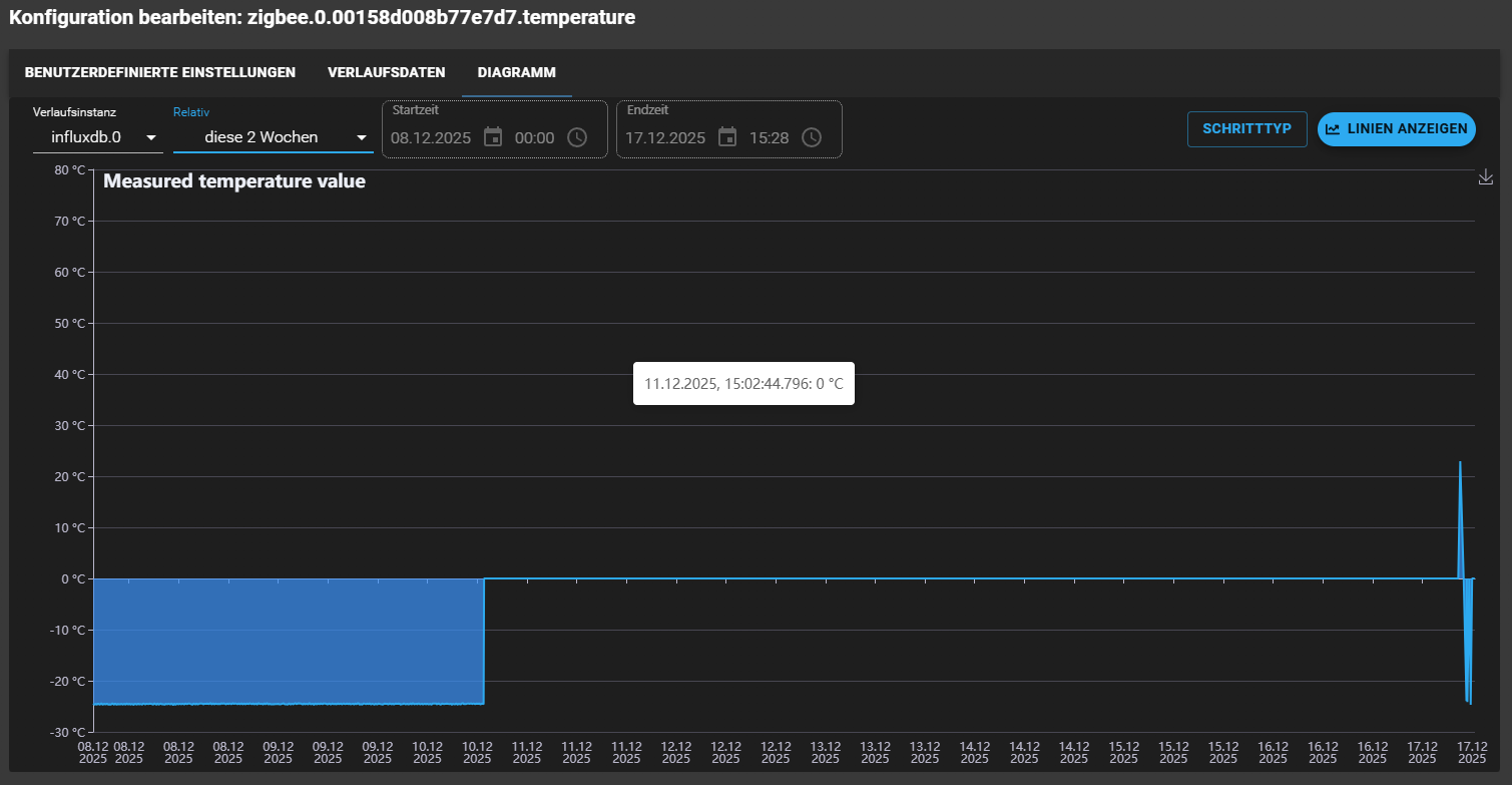

  4. Zigbee v3.3.0 Problem mit "min "0"" kleiner 0

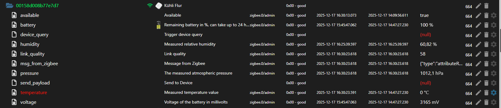

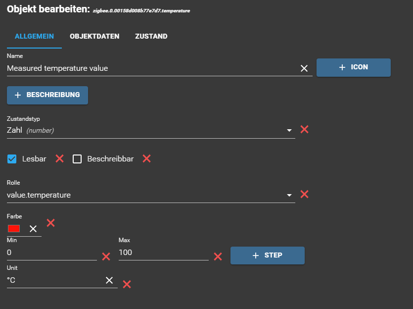

      @Homoran sagte in Zigbee v3.3.0 Problem mit "min "0"" kleiner 0:
      temperatur - Bleistift - Objektdaten
        "type": "state",
        "common": {
          "name": "Measured temperature value",
          "color": "#FF0000",
          "type": "number",
          "unit": "°C",
          "read": true,
          "write": false,
          "role": "value.temperature",
          "custom": {
            "history.0": {
              "enabled": true,
              "aliasId": "kühli_flur_c",
              "debounceTime": 0,
              "blockTime": 0,
              "changesOnly": true,
              "changesRelogInterval": 120,
              "changesMinDelta": "0",
              "ignoreBelowNumber": "",
              "disableSkippedValueLogging": false,
              "retention": "31536000",
              "customRetentionDuration": 365,
              "maxLength": "50",
              "enableDebugLogs": false,
              "debounce": "1000"
            "influxdb.0": {
              "enabled": true,
              "storageType": "",
              "debounceTime": 0,
              "blockTime": 0,
              "changesMinDelta": 0,
              "debounce": 1000
          "min": 0,
          "max": 100
        "native": {},
        "_id": "zigbee.0.00158d008b77e7d7.temperature",
        "acl": {
          "object": 1636,
          "state": 1636,
          "owner": "system.user.admin",
        "user": "system.user.admin",
        "ts": 1765986930225
      cu C-3po

                @Asgothian das müsste in #8 stehen

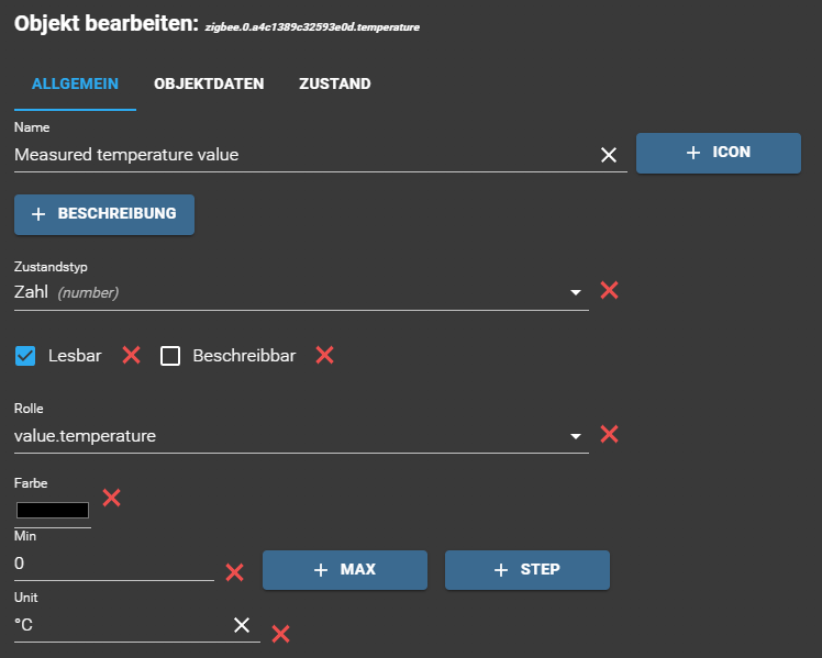

                  Das sind die anderen beiden
                    "type": "state",
                    "common": {
                      "color": null,
                      "type": "number",
                      "unit": "°C",
                      "read": true,
                      "write": false,
                      "min": 0
                    "native": {},
                    "_id": "zigbee.0.a4c1389c32593e0d.temperature",
                    "acl": {
                      "object": 1636,
                      "state": 1636,
                    "from": "system.adapter.zigbee.0",
                    "ts": 1765994418790
                    "type": "state",
                    "common": {
                      "type": "number",
                      "unit": "°C",
                      "read": true,
                      "write": false,
                      "custom": {
                        "history.0": {
                          "enabled": true,
                          "aliasId": "kühli_oben_c",
                          "debounceTime": 0,
                          "blockTime": 0,
                          "maxLength": "50",
                          "debounce": "1000"
                        "influxdb.0": {
                          "enabled": true,
                          "storageType": "",
                          "debounceTime": 0,
                          "blockTime": 0,
                          "debounce": 1000
                      "color": null,
                      "min": 0
                    "native": {},
                    "_id": "zigbee.0.a4c1386852d375d4.temperature",
                    "acl": {
                      "object": 1636,
                      "state": 1636,
                    "ts": 1765994613594
                  cu C-3po

                    Danke für die Info - damit lässt sich der Fehler deutlich eingrenzen.
                    Ich denke ich hab den gefunden und kann den fixen.
                    Es gibt jetzt 3 Optionen:
                    • du lebst mit dem problem bis ich die 3.1.1 ins Latest bringe (kann bis ins neue Jahr dauern)
                    • du patchst deinen Code (natürlich sage ich Dir genau wo, es ist ein trivialer Patch)
                    • du installierst eine alpha-Version von Github (die ich nach Rückmeldung bereistellen kann)
                    Lass mich wissen was für dich passt.
                    A.
                    Edit - info zur 'Patch' Option hinzugefügt
                    C 1 Antwort Letzte Antwort

                        Stress ist das nicht. Wie gesagt, ist trivial:
                        in der Datei /lib/exposes.js, ungefähr ab Zeile 50 steht:
                                case 'numeric':
                                    state = {
                                        prop: propName,
                                        icon: undefined,
                                        role: role || 'state',
                                        write: writable,
                                        read: true,
                                        type: 'number',
                                        min: expose.value_min || 0,
                                        max: expose.value_max,
                                        unit: expose.unit,
                        das bitte anpassen auf
                                case 'numeric':
                                    state = {
                                        prop: propName,
                                        icon: undefined,
                                        write: writable,
                                        read: true,
                                        type: 'number',
                                        min: expose.value_min,
                                        unit: expose.unit,
                        und dann den Adapter neu starten.

                          @Asgothian sagte in Zigbee v3.3.0 Problem mit "min "0"" kleiner 0:
                          gestatte mir die erfolgreiche Durchführung der Änderung zu bestätigen.
                          Top, die Werte sind wieder da, hat zwar ne weile gedauert, aber ich habe ja übertragung nur bei Änderung eingestellt. (oder 120 sec ?)
                          habe aber manuell den min Wert auf -30 gestellt, oder hätt ich den einfach nur löschen müssen, das der allein auftaucht. Egal deine Korrektur und meine Wertanpassung arbeiten zusammen.
                          Mega Danke nochmal.

                            • C Offline
                              C Offline
                              C-3po
                              schrieb am zuletzt editiert von C-3po
                              Oha, Danke für die Ausführliche Anleitung. Da muss ich erst mal drüber schlafen. :-)
                              cu C-3po
                              • AsgothianA Asgothian
                                        case 'numeric':
                                            state = {
                                                prop: propName,
                                                icon: undefined,
                                                write: writable,
                                                read: true,
                                                type: 'number',
                                                unit: expose.unit,
                                        case 'numeric':
                                            state = {
                                                prop: propName,
                                                icon: undefined,
                                                write: writable,
                                                read: true,
                                                type: 'number',
                                                unit: expose.unit,
                                A.

                                    Hallo @asgothian
                                    Ich habe zigbee.0 v3.3.2 und hatte nun das gleiche Problem. (Ebenfalls Aquara-Module)
                                    Die Datei lib/exposes.js ist in dieser Version offensichtlich bereits gefixxt, aber auch bei mir gab es seit einer Woche nur noch positive Werte:
                                    Ich habe nun die Werte für "Min" in den einzelnen Zigbee-Temperatur-Objekten wie oben von Euch beschrieben von 0 auf einen negativen Wert geändert.
                                    Nun klappt es auch wieder, seit ein paar Minuten sehe ich wieder erste negative Werte!
                                    Wie von @C-3po beschrieben, darf man sich die Werte nicht sofort erwarten sondern sollte Geduld mitbringen!
                                    Danke für die gute Anleitung!
