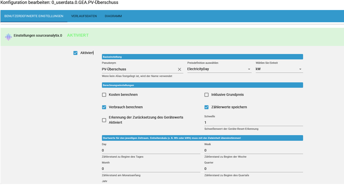

    Hallo
    Ich verstehe die Funktion noch nicht wirklich, insbesondere warum ich solche Fehler bekomme.
    sourceanalytix.0
    2025-11-05 11:49:28.126	warn	[Cannot enable SourceAnalytix for 0_userdata.0.GEA.PV-Überschuss, check settings and error messages
    sourceanalytix.0
    2025-11-05 11:49:28.126	error	Cannot handle calculations for 0_userdata.0.GEA.PV-Überschuss, check log messages and adjust settings!
    sourceanalytix.0
    2025-11-05 11:49:28.126	error	Troubleshoot Data 0_userdata.0.GEA.PV-Überschuss custom Data : {"common":{"name":"PV-Überschuss","desc":"Manuell erzeugt","role":"state","type":"number","unit":"kW","read":true,"write":true,"def":0,"color":"#34d115","custom":{"history.0":{"enabled":true,"aliasId":"PV-Überschuss","debounceTime":0,"blockTime":3000,"changesOnly":false,"changesRelogInterval":"0","changesMinDelta":"0","ignoreBelowNumber":"","disableSkippedValueLogging":false,"retention":"31536000","customRetentionDuration":365,"maxLength":"960","enableDebugLogs":false,"debounce":"1000","chartStep":""},"influxdb.0":{"enabled":true,"storageType":"","aliasId":"PV-Überschuss","debounceTime":0,"blockTime":0,"changesOnly":true,"changesRelogInterval":0,"changesMinDelta":0,"ignoreBelowNumber":"","disableSkippedValueLogging":false,"enableDebugLogs":false,"debounce":1000},"sourceanalytix.0":{"enabled":true,"selectedUnit":"kW","deviceResetLogicEnabled":false,"threshold":1,"start_day":0,"start_week":0,"start_month":0,"start_quarter":0,"start_year":0,"role":"value.power","alias":"PV-Überschuss","selectedPrice":"ElectricityDay","meter_values":true,"consumption":true}}},"type":"state","native":{},"_id":"0_userdata.0.GEA.PV-Überschuss","acl":{"object":1636,"state":1636,"owner":"system.user.admin","ownerGroup":"system.group.administrator"},"from":"system.adapter.admin.0","user":"system.user.admin","ts":1762339768120}
    sourceanalytix.0
    2025-11-05 11:49:28.126	error	Check settings for 0_userdata.0.GEA.PV-Überschuss ! Known valueAtDeviceReset : (null) > known cumulative value (-659.5707572222217) cannot proceed
    sourceanalytix.0
    2025-11-05 11:49:28.123	info	Enable SourceAnalytix for : 0_userdata.0.GEA.PV-Überschuss
    Gibt es eine Abhilfe, ohne den Datenpunkt aus sourceanalytix zu entfernen und dann wieder neu anzulegen. Es sind doch Einige mit diesem Fehler.

            Zeig mal das Raw von 0_userdata.0.GEA.PV-Überschuss
            Snopy_16
            @crunchip Ist das, was du sehen willst?

              @snopy_16 ja das wollt ich sehen, da ist kein device reset hinterlegt, weil
              @snopy_16 sagte in sourceanalytix Erkennung der Rücksetzung des Gerätes:
              Deine Unit nicht übereinstimmt
              KW ist nicht gleich KWh

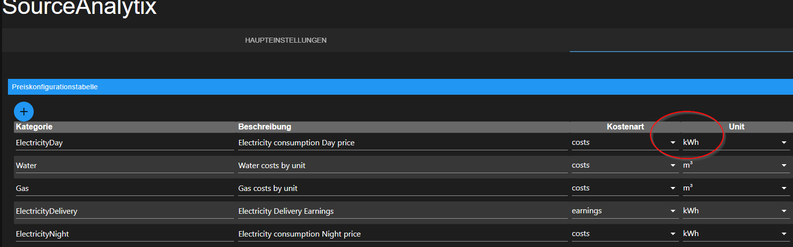

                    crunchip
                    @snopy_16 in der Preisdefinition wird die Unit und der Preis hinterlegt
                    z.b.
                    beim jeweiligen Datenpunkt(Zahnrad rechts) nimmst du die eigentliche Einstellung vor, die individuell gilt, also in deinem Fall KW
                    bei den Startwerten muss dann entsprechend der tatsächliche Zählerstand eingetragen werden. Wenn dein Datenpunkt z.b. 555KW hat, trägst du die 555 bei start day ein, den Rest lässt du auf 0. Diese füllen sich dann automatisch nach erreichen der Zeit.
                    Außer du weißt die Werte zum jeweiligen Zeitpunkt, dann kannst du diese auch direkt mit eintragen.
                    S 1 Antwort Letzte Antwort
