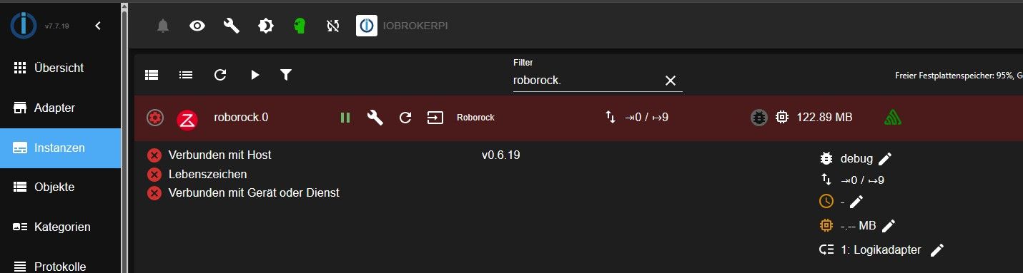

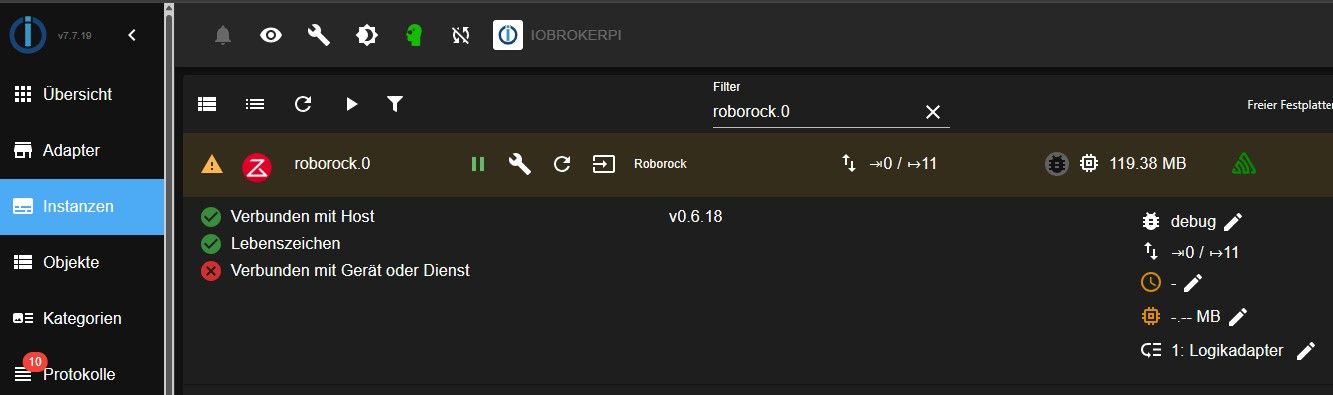

                            unter Roborock v 0.6.18 und Nodejs 20.x) ging bei mir der Adapter nicht mehr, war nur noch gelb.
                            folgende Fehler schmiss er ins Log
                            	2025-12-06 09:33:15.994	error	Failed to get home details: Error: loginApi is not initialized. at Roborock.initializeHomeDetails (/opt/iobroker/node_modules/iobroker.roborock/main.js:144:25) at Roborock.onReady (/opt/iobroker/node_modules/iobroker.roborock/main.js:67:14)
                            roborock.0
                            2025-12-06 09:33:15.288	error	Error retrieving or setting clientID: Error: Login returned empty userdata. at Roborock.getUserData (/opt/iobroker/node_modules/iobroker.roborock/main.js:236:11) at processTicksAndRejections (node:internal/process/task_queues:95:5) at Roborock.initializeRoborockApi (/opt/iobroker/node_modules/iobroker.roborock/main.js:103:21) at Roborock.onReady (/opt/iobroker/node_modules/iobroker.roborock/main.js:65:34)
                            roborock.0
                            2025-12-06 09:33:15.273	error	Error in getUserData: Login returned empty userdata.. This is most likely due to too many reconnects.
                            Nach dem update auf Nodejs 22.21.0 und Roborock v0.6.19, also die Konfiguration die bei Euch wohl läuft, hat sich immer noch nichts gebessert
                            	2025-12-06 13:46:31.042	error	Failed processing onReady on adapter (unknown): Error: Login returned empty userdata. at http_api.initializeRealApi (/opt/iobroker/node_modules/iobroker.roborock/src/lib/httpApi.ts:141:12) at processTicksAndRejections (node:internal/process/task_queues:105:5) at http_api.init (/opt/iobroker/node_modules/iobroker.roborock/src/lib/httpApi.ts:101:3) at Roborock.onReady (/opt/iobroker/node_modules/iobroker.roborock/src/main.ts:92:4)
                            roborock.0
                            2025-12-06 13:46:31.012	error	Failed to initialize adapter: Login returned empty userdata.
                            roborock.0
                            2025-12-06 13:46:30.999	error	Error in getUserData: Login returned empty userdata.. This is most likely due to too many reconnects. Emptying UserData & HomeData
                            nur die Fehler im Log haben sich ein wenig geändert
                            Hab ich irgendwas überlesen? Jmd. eine Idee, ws ich noch machen kann?

                                    #39
                                    vermutlich leidet unseren Saros R10 am gleichen Problem, er will sich ums verrecken nicht mit dem Roborock Adapter verbinden.
                                    Es funktioniert weder v0.6.18 noch der v0.6.19
                                    System Infos:
                                    Adapter Version
                                    v0.6.18
                                    JS-Controller Version
                                    7.0.7
                                    Node.js Version
                                    v22.21.0
                                    Operating System
                                    linux
                                    Firmware version of device
                                    V02.50.56
                                    Infos zum Problem unter v0.6.18:
                                    Debug Log Upload (Adapter v0.6.18)
                                    Debuglog - Saros 10R.txt
                                    Infos zum Problem unter v0.6.19:
                                    Debug Log Upload (Adapter v0.6.19)
                                    Debuglog v0.6.19 - Saros 10R.txt
                                    Ich hoffe ihr könnt weiterhelfen.
                                    vG
                                    kurzes Update:
                                    nach wiederholter installation der v0.6.19 über den Link aus Post #28 läuft der Adapter jetzt :)
