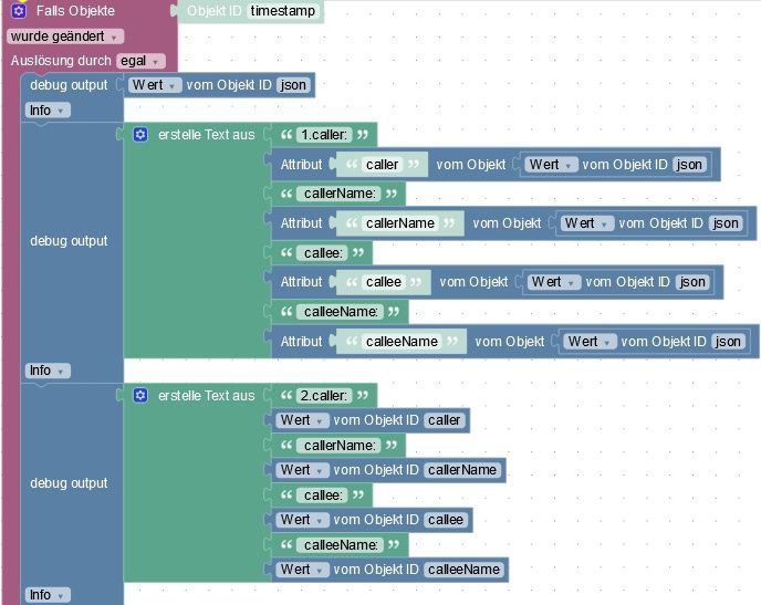

    Also habe ich ein paar Testausgaben ein Blockly eingefügt und den Debug Modus aktiviert.

    info: javascript.0 (2478949) script.js.Allgemein.Telefonanruf: {"caller":"xxxx187","callee":"xxxx395","timestamp":"06.10.24 14:53:51","id":2,"_type":"inbound","callerName":"Name187","calleeName":"Name395"}
    info: javascript.0 (2478949) script.js.Allgemein.Telefonanruf: 1.caller:xxxx187 callerName:Name187 callee:xxxx395 calleeName:Name395
    info: javascript.0 (2478949) script.js.Allgemein.Telefonanruf: 2.caller:xxxx945 callerName:Name187 callee:xxxx408 calleeName:Name395
    debug: tr-064.0 (349569) State changed: tr-064.0.callmonitor.inbound.callerName = {"val":"Name945","ack":true,"ts":1728222615906,"q":0,"from":"system.adapter.tr-064.0","user":"system.user.admin","lc":1728222615906}
    debug: tr-064.0 (349569) State changed: tr-064.0.callmonitor.inbound.calleeName = {"val":"Name408","ack":true,"ts":1728222615914,"q":0,"from":"system.adapter.tr-064.0","user":"system.user.admin","lc":1728222615914}

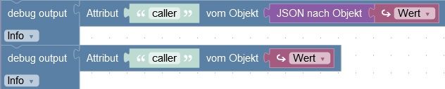

    hier meinen Blockly Routine:

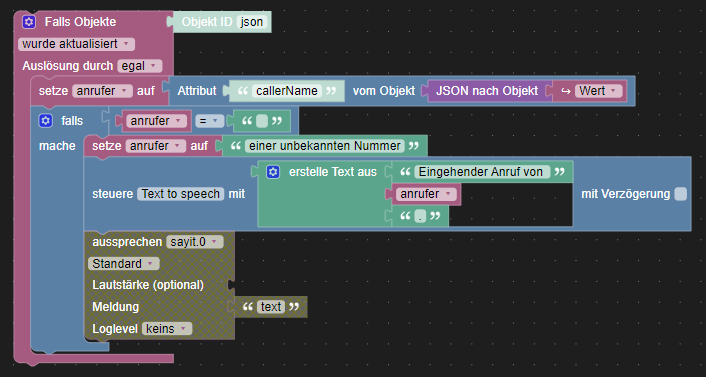

      @martinsu dann wird wohl etwas nicht aktualisiert, probier es mal so

      • crunchipC crunchip
          <variables>
            <variable id="|Ki#U=;*CZRBgsP2*B!5">anrufer</variable>
            <variable type="timeout" id="timeout">timeout</variable>
          </variables>
          <block type="on_ext" id="F9~zeBRs6tz5q:Ht93Or" x="563" y="-287">
            <value name="OID0">
              <shadow type="field_oid" id="/[_;+hh=i|q~/Y`N=1^y">
                <field name="oid">tr-064.0.callmonitor.inbound.json</field>
              </shadow>
            </value>
            <statement name="STATEMENT">
              <block type="variables_set" id="gOjGu;[.TT0$9D68QdX{">
                <field name="VAR" id="|Ki#U=;*CZRBgsP2*B!5">anrufer</field>
                <value name="VALUE">
                  <block type="get_attr" id="{%Z/8moDZd_rtoH:B-!Y">
                    <value name="PATH">
                      <shadow type="text" id="iNhHtrmgEX}gzy}ga%(G">
                        <field name="TEXT">callerName</field>
                      </shadow>
                    </value>
                    <value name="OBJECT">
                      <block type="convert_json2object" id="E(uM{8_#tE~SxF/Kz6]g">
                          <block type="on_source" id="dhc~79Vb[jQEZnv:q`OF">
                          </block>
                        </value>
                      </block>
                    </value>
                  </block>
                </value>
                <next>
                  <block type="controls_if" id="3%qt2$0iasqj*_stH1I#">
                    <value name="IF0">
                      <block type="logic_compare" id="9idq@6=`#bIJ]eNA!S4F">
                        <field name="OP">EQ</field>
                        <value name="A">
                          <block type="variables_get" id="eXgqKjErQ}c}P[_1lK((">
                          </block>
                        </value>
                        <value name="B">
                          <block type="text" id="R=DtAtOdm$#jmH0HE`}@">
                            <field name="TEXT"></field>
                          </block>
                        </value>
                      </block>
                    </value>
                    <statement name="DO0">
                      <block type="variables_set" id="Jz*YmVC)#=;r0+PP{g|v">
                          <block type="text" id="PU9|/E,*{`[]@j.J1-Mj">
                            <field name="TEXT">einer unbekannten Nummer</field>
                          </block>
                        </value>
                        <next>
                          <block type="control" id="c~9;G(V$qJ![VFcQ%$$U">
                            <field name="OID">sayit.0.tts.text</field>
                              <block type="text_join" id="Q9,yCef`[V:avNmyQ8u^">
                                <value name="ADD0">
                                  <block type="text" id="Q~Y^0O5nSq!)HrP+3`)m">
                                    <field name="TEXT">Eingehender Anruf von </field>
                                  </block>
                                </value>
                                <value name="ADD1">
                                  <block type="variables_get" id="lgmss1E,)+w|aR]aS_J_">
                                  </block>
                                </value>
                                <value name="ADD2">
                                  <block type="text" id="-1Ap2`~q40%J+XjrkM[3">
                                    <field name="TEXT">.</field>
                                  </block>
                                </value>
                              </block>
                            </value>
                            <next>
                              <block type="sayit" id="3s^4u:-w|%|AwWtHLtb+" disabled="true">
                                <field name="INSTANCE">.0</field>
                                <field name="LANGUAGE"></field>
                                <field name="LOG"></field>
                                <value name="MESSAGE">
                                  <shadow type="text" id="U1`E%Rrs7o#H#fGwSo{d">
                                  </shadow>
                                </value>
                              </block>
                            </next>
                          </block>
                        </next>
                      </block>
                    </statement>
                  </block>
                </next>
              </block>
            </statement>
          </block>

        @crunchip
        Ich hatte bei dem Falls Objekte auf den tr-064.0.callmonitor.inbound.timestamp getriggert.
        Aber es macht natürlich Sinn auf die Aktualisierung des json zu triggern, besonders weil man mit dem Übergabewert die frischen Werte von Anrufer und Angerufenen erhält.Wert.jpg
        Ich vermute, dass bei mir die tr-064.0.callmonitor.inbound.callee/calleeName/caller/callerName noch nicht schnell genug aktualisiert wurden.
        Wenn ich jetzt die Werte aus dem übergebenen json auslese, stimmen die Namen und Nummern des Anrufers und des Angerufenen.
        Komischerweise stimmen jetzt auch immer die Werte für tr-064.0.callmonitor.inbound.callee/calleeName/caller/callerName. Wurden die jetzt automatisch mit aktualisiert?
        Nur etwas verstehe ich nicht, warum Du den JSON nach Objekt einfügst?
        Ich sehe das gleiche Ergebnis für
        • MartinSUM MartinSU
          @crunchip

          @martinsu sagte in TR-064 falsche Anrufer Anzeige [gelöst]:
          Weils trigger Objekt ein json ist. Hatte es mal so aus dem Forum.
