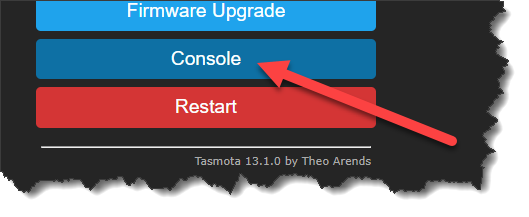

              @gluecksmann na auf deiner Tasmota oberfläche auf Konsole klicken

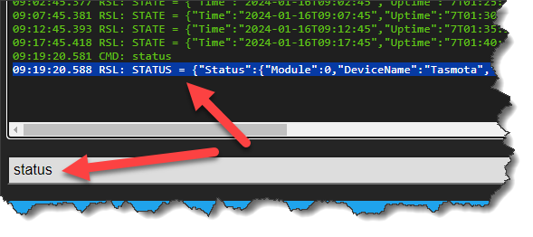

                Codierknecht
                @gluecksmann
                Dort "status" eingeben und die dann ausgegebene Zeile hier (in Code-Tags </>) posten.

                    @codierknecht sagte in Tasmota Steckdose zicken rum:
                    status
                    09:52:42.935 MQT: stat/tasmota1/STATUS = {"Status":{"Module":0,"DeviceName":"Tasmota1","FriendlyName":["Tasmota1"],"Topic":"tasmota1","ButtonTopic":"0","Power":1,"PowerOnState":3,"LedState":1,"LedMask":"FFFF","SaveData":1,"SaveState":1,"SwitchTopic":"0","SwitchMode":[0,0,0,0,0,0,0,0,0,0,0,0,0,0,0,0,0,0,0,0,0,0,0,0,0,0,0,0],"ButtonRetain":0,"SwitchRetain":0,"SensorRetain":0,"PowerRetain":0,"InfoRetain":0,"StateRetain":0,"StatusRetain":0}}
