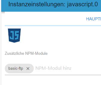

    wenn ich in der Instanz "basic-ftp" hinzufüge
    kommt im log:
    javascript.0
    2024-01-08 17:25:23.790	error	deprecated request@2.88.2: request has been deprecated, see https://github.com/request/request/issues/3142
    javascript.0
    2024-01-08 17:25:23.789	error	npm WARN
    javascript.0
    2024-01-08 17:25:23.714	error	WARN deprecated uuid@3.4.0: Please upgrade to version 7 or higher. Older versions may use Math.random() in certain circumstances, which is known to be problematic. See https://v8.dev/blog/math-random for details.
    javascript.0
    2024-01-08 17:25:23.713	error	npm
    javascript.0
    2024-01-08 17:25:23.640	error	WARN deprecated node-inspect@2.0.0: This module is part of Node.js core and does not need to be installed separately. It is now unmaintained.
    javascript.0
    2024-01-08 17:25:23.640	error	npm
    javascript.0
    2024-01-08 17:25:23.537	error	WARN deprecated har-validator@5.1.5: this library is no longer supported
    javascript.0
    2024-01-08 17:25:23.536	error	npm
    Ich lese das so, dass dieses modul Teil von node.js ist und nicht extra installiert werden muss.
    Nehme ich dies wieder raus, kam eben im log:
    javascript.0
    2024-01-08 17:18:44.078	error	at script.js.Scripte.System.Sicherung_iob_Dateien_loeschen:53:3
    javascript.0
    2024-01-08 17:18:44.078	error	at script.js.Scripte.System.Sicherung_iob_Dateien_loeschen:3:17
    javascript.0
    2024-01-08 17:18:44.078	error	at require (/opt/iobroker/node_modules/iobroker.javascript/lib/sandbox.js:528:32)
    javascript.0
    2024-01-08 17:18:44.078	error	at require (node:internal/modules/cjs/helpers:119:18)
    javascript.0
    2024-01-08 17:18:44.078	error	at Module.require (node:internal/modules/cjs/loader:1143:19)
    javascript.0
    2024-01-08 17:18:44.078	error	script.js.Scripte.System.Sicherung_iob_Dateien_loeschen: Error: Cannot find module 'basic-ftp'
    javascript.0
    2024-01-08 17:18:44.069	error	at Script.runInContext (node:vm:135:12)
    Dies habe ich nun nochmal probiert.
    Jetzt kam der Fehler "cannot find module "basic-ftp" nicht mehr.
    Komisch.
    Warum kam der Fehler "cannot find" und dann kommt kein Fehler mehr.
    Danke.
