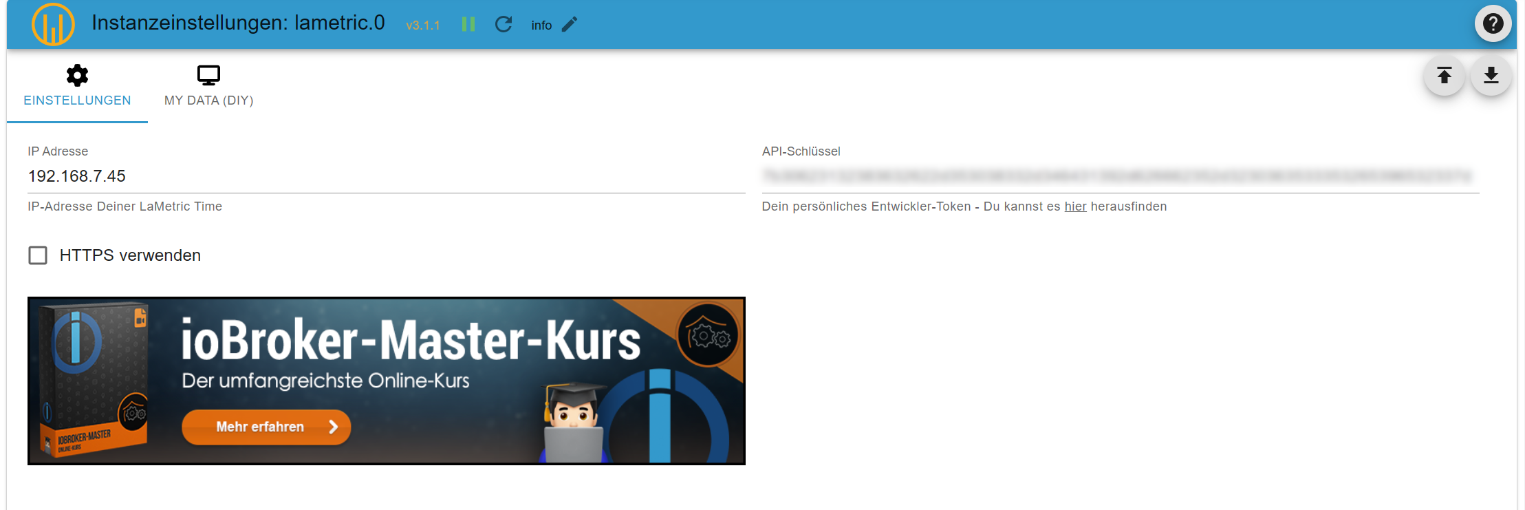

        Edit:
        Auch wenn "Verbunden mit Gerät oder Dienst" nicht geht werden die Meldungen auf der Lametix angezeigt...
        Muss mal schauen dass ich das dann noch bei github als issue aufmache...

                  Eben noch was im Log entdeckt.
                  lametric has an invalid jsonConfig: [{"instancePath":"","schemaPath":"#/additionalProperties","keyword":"additionalProperties","params":{"additionalProperty":"iconPosition"},"message":"must NOT have additional properties"}]

                      2023-12-27 07:38:02.282 - info: lametric.0 (1109) Got terminate signal TERMINATE_YOURSELF
                      2023-12-27 07:38:02.289 - debug: lametric.0 (1109) clearing refresh state timeout
                      2023-12-27 07:38:02.291 - debug: lametric.0 (1109) clearing refresh app timeout
                      2023-12-27 07:38:02.295 - info: lametric.0 (1109) terminating
                      2023-12-27 07:38:02.299 - debug: lametric.0 (1109) Plugin sentry destroyed
                      2023-12-27 07:38:02.304 - info: lametric.0 (1109) Terminated (ADAPTER_REQUESTED_TERMINATION): Without reason
                      2023-12-27 07:38:02.347 - info: host.iobroker stopInstance system.adapter.lametric.0 send kill signal
                      2023-12-27 07:38:02.808 - info: lametric.0 (1109) terminating
                      2023-12-27 07:38:02.904 - info: host.iobroker instance system.adapter.lametric.0 terminated with code 11 (ADAPTER_REQUESTED_TERMINATION)
                      2023-12-27 07:38:05.467 - info: host.iobroker instance system.adapter.lametric.0 started with pid 1125
                      2023-12-27 07:38:08.899 - debug: lametric.0 (1125) Redis Objects: Use Redis connection: 127.0.0.1:9001
                      2023-12-27 07:38:08.969 - debug: lametric.0 (1125) Objects client ready ... initialize now
                      2023-12-27 07:38:08.974 - debug: lametric.0 (1125) Objects create System PubSub Client
                      2023-12-27 07:38:08.977 - debug: lametric.0 (1125) Objects create User PubSub Client
                      2023-12-27 07:38:09.020 - debug: lametric.0 (1125) Objects client initialize lua scripts
                      2023-12-27 07:38:09.036 - debug: lametric.0 (1125) Objects connected to redis: 127.0.0.1:9001
                      2023-12-27 07:38:09.075 - debug: lametric.0 (1125) Redis States: Use Redis connection: 127.0.0.1:9000
                      2023-12-27 07:38:09.092 - debug: lametric.0 (1125) States create System PubSub Client
                      2023-12-27 07:38:09.094 - debug: lametric.0 (1125) States create User PubSub Client
                      2023-12-27 07:38:09.153 - debug: lametric.0 (1125) States connected to redis: 127.0.0.1:9000
                      2023-12-27 07:38:09.224 - debug: lametric.0 (1125) Plugin sentry Initialize Plugin (enabled=true)
                      2023-12-27 07:38:10.537 - info: lametric.0 (1125) starting. Version 3.1.1 in /opt/iobroker/node_modules/iobroker.lametric, node: v18.18.2, js-controller: 5.0.16
                      2023-12-27 07:38:10.620 - info: lametric.0 (1125) Starting - connecting to http://192.168.7.45:8080
                      2023-12-27 07:38:10.624 - debug: lametric.0 (1125) re-creating refresh state timeout
                      2023-12-27 07:38:10.629 - debug: lametric.0 (1125) sending "GET" request to "/api/v2/device" with http on port 8080 without data
                      2023-12-27 07:38:10.818 - debug: lametric.0 (1125) received 200 response from "http://192.168.7.45:8080/api/v2/device" with content: {"audio":{"available":true,"volume":46,"volume_limit":{"max":100,"min":0},"volume_range":{"max":100,"min":0}},"bluetooth":{"active":false,"address":"14:F5:F9:31:C3:63","available":true,"discoverable":true,"mac":"14:F5:F9:31:C3:63","name":"LM3161","pairable":false},"display":{"brightness":100,"brightness_limit":{"max":100,"min":2},"brightness_mode":"auto","brightness_range":{"max":100,"min":0},"height":8,"on":true,"screensaver":{"enabled":true,"modes":{"time_based":{"enabled":false},"when_dark":{"enabled":true}},"widget":"1_com.lametric.clock"},"type":"mixed","width":37},"id":"62745","mode":"auto","model":"sa8","name":"TIME","os_version":"3.0.21","serial_number":"SA830100316100W00BP9","wifi":{"active":true,"address":"14:F5:F9:30:B4:F3","available":true,"encryption":"WPA","essid":"Laubhaufen","ip":"192.168.7.45","mode":"dhcp","netmask":"255.255.255.0","strength":100}}
                      2023-12-27 07:38:10.848 - debug: lametric.0 (1125) API is online
                      2023-12-27 07:38:10.856 - debug: lametric.0 (1125) [apps] re-creating refresh timeout
                      2023-12-27 07:38:10.857 - debug: lametric.0 (1125) sending "GET" request to "/api/v2/device/apps" with http on port 8080 without data
                      2023-12-27 07:38:10.906 - debug: lametric.0 (1125) received 200 response from "http://192.168.7.45:8080/api/v2/device/apps" with content: {"com.lametric.clock":{"actions":{"clock.alarm":{"enabled":{"data_type":"bool","name":"enabled","required":false},"time":{"data_type":"string","format":"[0-9]{2}:[0-9]{2}(?::[0-9]{2})?","name":"time","required":false},"wake_with_radio":{"data_type":"bool","name":"wake_with_radio","required":false}},"clock.clockface":{"icon":{"data_type":"string","name":"icon","required":false},"type":{"data_type":"string","format":"weather|page_a_day|custom|none","name":"type","required":false}},"settings.dateFormats":{}},"package":"com.lametric.clock","title":"Clock","triggers":{"alarm":{"snooze":{"data_type":"bool","name":"snooze"}}},"vendor":"LaMetric","version":"2.8.3","version_code":"44","widgets":{"1_com.lametric.clock":{"index":0,"package":"com.lametric.clock","settings":{"_title":"Uhr"},"visible":false}}},"com.lametric.countdown":{"actions":{"countdown.configure":{"duration":{"data_type":"int","name":"duration","required":false},"start_now":{"data_type":"bool","name":"start_now","required":false}},"countdown.pause":{},"countdown.reset":{},"countdown.start":{}},"package":"com.lametric.countdown","title":"Timer","triggers":{"finished":{"duration":{"data_type":"int","name":"duration"}},"paused":{"duration":{"data_type":"int","name":"duration"}},"reset":{"duration":{"data_type":"int","name":"duration"}},"resumed":{"duration":{"data_type":"int","name":"duration"}},"started":{"duration":{"data_type":"int","name":"duration"}}},"vendor":"LaMetric","version":"1.2.1","version_code":"19","widgets":{"6_com.lametric.countdown":{"index":6,"package":"com.lametric.countdown","settings":{"_title":"Timer"},"visible":false}}},"com.lametric.custommessage":{"package":"com.lametric.custommessage","title":"Message Board","triggers":{},"vendor":"LaMetric","version":"1.2.8","version_code":"28","widgets":{"3_com.lametric.custommessage":{"index":3,"package":"com.lametric.custommessage","settings":{"_title":"Message Board"},"visible":false}}},"com.lametric.diy.devwidget":{"actions":{"status":{}},"package":"com.lametric.diy.devwidget","title":"My Data DIY","triggers":{},"vendor":"LaMetric","version":"2.0.2","version_code":"48","widgets":{"xxxxxxxxxxxxxxxxxxxxxxxxxxxxxxxx":{"index":2,"package":"com.lametric.diy.devwidget","settings":{"_title":"My Data DIY"},"visible":false}}},"com.lametric.radio":{"actions":{"radio.next":{},"radio.play":{},"radio.play.at":{"idx":{"data_type":"int","name":"idx","required":false}},"radio.prev":{},"radio.state":{},"radio.stop":{}},"package":"com.lametric.radio","title":"Radio","triggers":{},"vendor":"LaMetric","version":"1.4.20","version_code":"74","widgets":{"4_com.lametric.radio":{"index":4,"package":"com.lametric.radio","settings":{"_title":"Radio"},"visible":false}}},"com.lametric.stopwatch":{"actions":{"stopwatch.pause":{},"stopwatch.reset":{},"stopwatch.start":{}},"package":"com.lametric.stopwatch","title":"Stopwatch","triggers":{},"vendor":"LaMetric","version":"1.2.0","version_code":"16","widgets":{"5_com.lametric.stopwatch":{"index":5,"package":"com.lametric.stopwatch","settings":{"_title":"Stopwatch"},"visible":false}}},"com.lametric.weather":{"actions":{"weather.forecast":{},"weather.get.cc":{},"weather.setProduct":{}},"package":"com.lametric.weather","title":"Weather","triggers":{},"vendor":"LaMetric","version":"1.2.2","version_code":"32","widgets":{"2_com.lametric.weather":{"index":1,"package":"com.lametric.weather","settings":{"_title":"Wetter"},"visible":true}}}}
                      2023-12-27 07:38:10.933 - debug: lametric.0 (1125) [apps] found (keep): apps.1_com_lametric.clock
                      2023-12-27 07:38:11.044 - debug: lametric.0 (1125) [apps] found (keep): apps.6_com_lametric.countdown
                      2023-12-27 07:38:11.099 - debug: lametric.0 (1125) [apps] found (keep): apps.3_com_lametric.custommessage
                      2023-12-27 07:38:11.144 - debug: lametric.0 (1125) [apps] found (keep): apps.xxxxxxxxxxxxxxxxxxxxxxxxxxxxxxxx
                      2023-12-27 07:38:11.145 - debug: lametric.0 (1125) [mydatadiy] found app widget with uuid "xxxxxxxxxxxxxxxxxxxxxxxxxxxxxxxx"
                      2023-12-27 07:38:11.279 - debug: lametric.0 (1125) [apps] found (keep): apps.4_com_lametric.radio
                      2023-12-27 07:38:11.343 - debug: lametric.0 (1125) [apps] found (keep): apps.5_com_lametric.stopwatch
                      2023-12-27 07:38:11.394 - debug: lametric.0 (1125) [apps] found (keep): apps.2_com_lametric.weather
                      2023-12-27 07:38:11.504 - warn: lametric.0 (1125) (device) Unable to execute action: TypeError: Cannot read properties of undefined (reading 'active')
                      2023-12-27 07:38:11.507 - debug: lametric.0 (1125) [mydatadiy] collecting states
                      2023-12-27 07:38:11.508 - debug: lametric.0 (1125) [mydatadiy] found 0 dynamic states: []
                      2023-12-27 07:38:11.510 - debug: lametric.0 (1125) [mydatadiy] found foreign states: []
                      2023-12-27 07:38:11.511 - debug: lametric.0 (1125) [mydatadiy] refresh output state with config: [{"icon":"3983","text":"Meckii","hideif":"","duration":5},{"icon":"2867","text":"Lina","hideif":"","duration":5},{"icon":"7756","text":"Paul","hideif":"","duration":5}]
                      2023-12-27 07:38:11.513 - debug: lametric.0 (1125) [mydatadiy] completed - frame update to [{"text":"Meckii","duration":5000,"icon":"3983"},{"text":"Lina","duration":5000,"icon":"2867"},{"text":"Paul","duration":5000,"icon":"7756"}]
                      2023-12-27 07:38:11.541 - debug: lametric.0 (1125) [mydatadiy] pusing changes to device - app xxxxxxxxxxxxxxxxxxxxxxxxxxxxxxxx
                      2023-12-27 07:38:11.543 - debug: lametric.0 (1125) sending "POST" request to "/api/v2/widget/update/com.lametric.diy.devwidget/xxxxxxxxxxxxxxxxxxxxxxxxxxxxxxxx" with http on port 8080 with data: {"frames":[{"text":"Meckii","duration":5000,"icon":"3983"},{"text":"Lina","duration":5000,"icon":"2867"},{"text":"Paul","duration":5000,"icon":"7756"}]}
                      2023-12-27 07:38:11.720 - debug: lametric.0 (1125) API is offline
                      2023-12-27 07:38:11.750 - debug: lametric.0 (1125) received 200 response from "http://192.168.7.45:8080/api/v2/widget/update/com.lametric.diy.devwidget/xxxxxxxxxxxxxxxxxxxxxxxxxxxxxxxx" with content: ""

                            @meckii Danke, ist gelöst ab 3.1.2 - lag daran, dass die 2022er Modelle über die API scheinbar kein bluetooth low energy status ausliefern. Bitte schauen, ob Du die aktuellste Firmware 3.0.21 installiert hast (gibts erst ein paar Tage). Da sind wohl auch einige Bugfixes enthalten.

                                @meckii Bitte nie über GitHub installieren. Lieber über npm wenn Du die letzte klar definiere Version haben möchtest.

                                    @meckii Klar, der liegt seit heute morgen auf npm
                                      Meckii
                                      @haus-automatisierung
                                      Habe es jetzt wieder aus npm installiert - vielen Dank fürs fixen und die Tipps!
