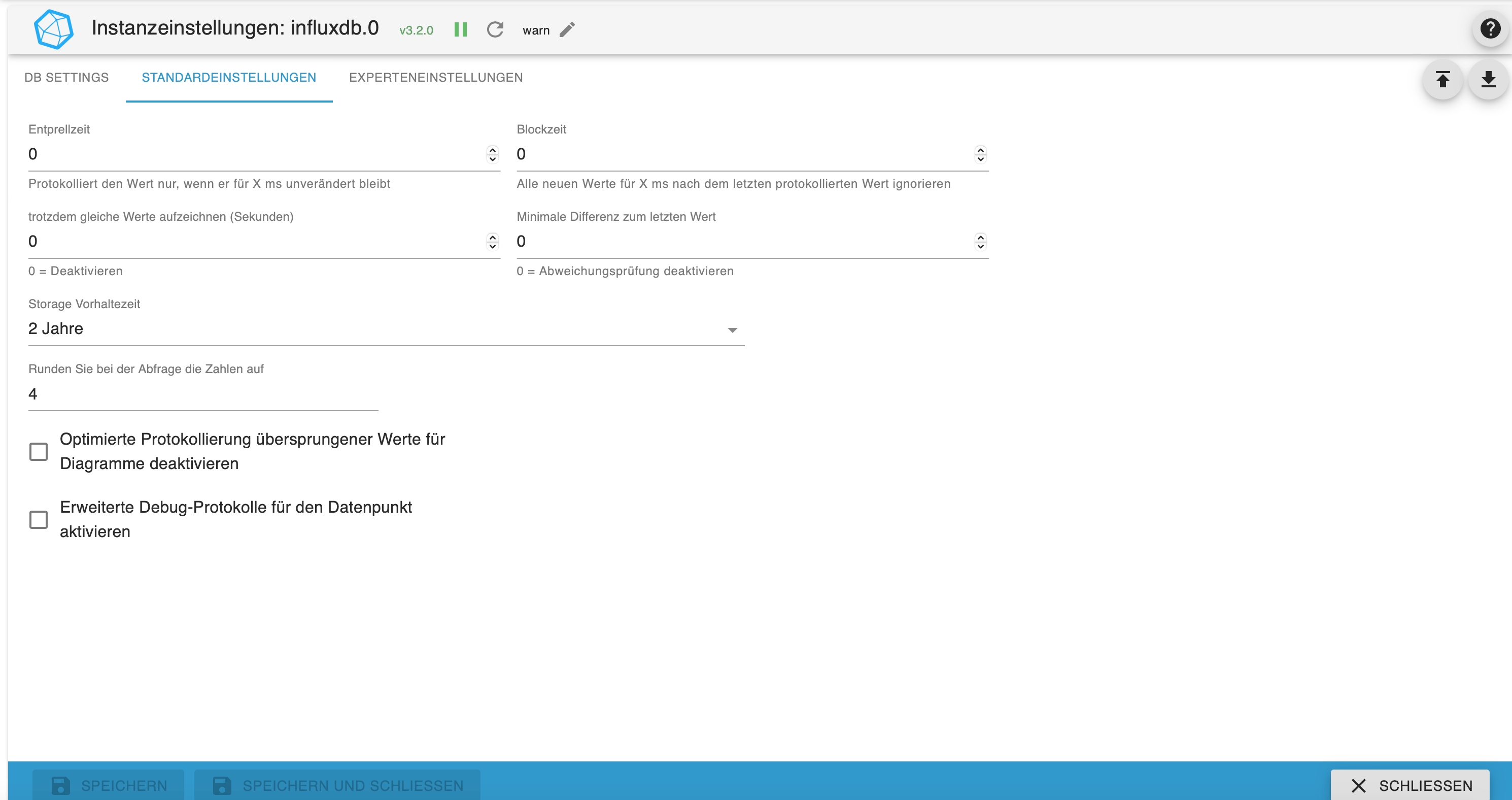

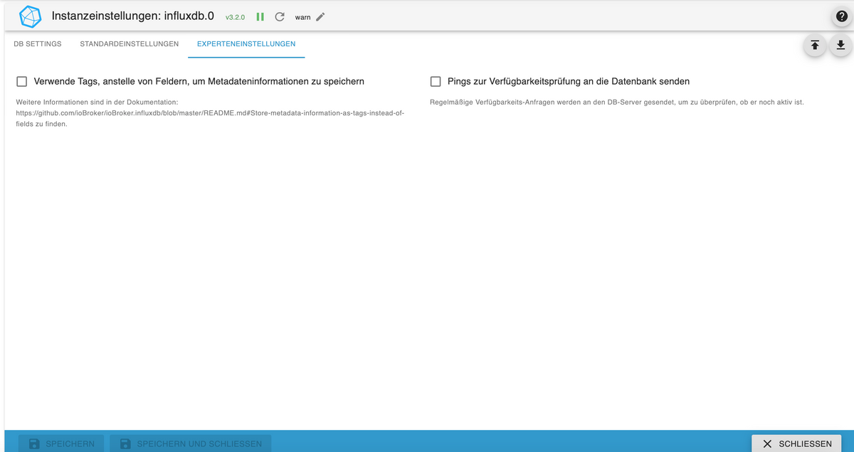

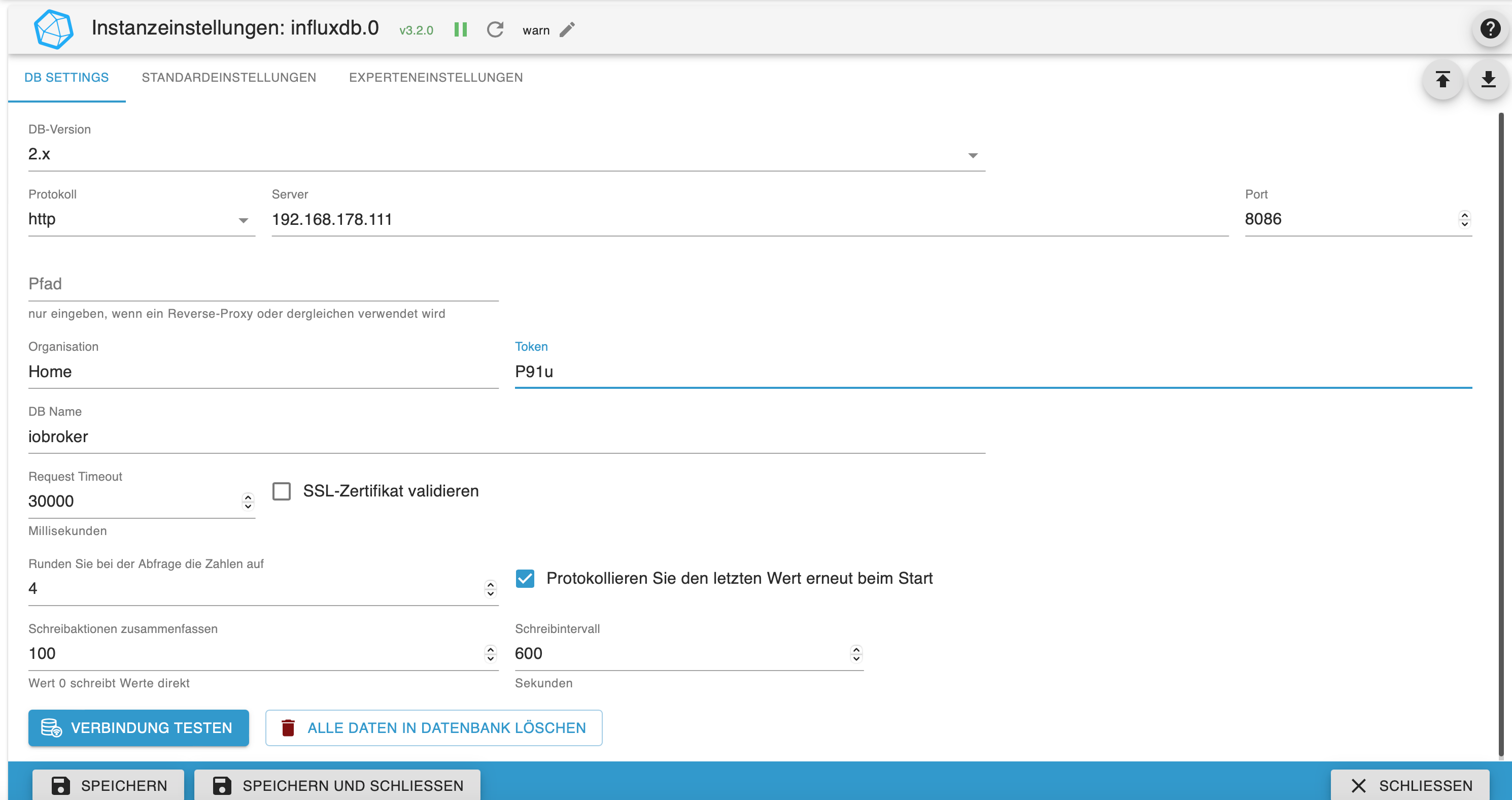

    Ich bekomme folgende Warnmeldung beim Start der Influxdb2:
    	2023-11-05 13:51:51.196	warn	influxdb has an invalid jsonConfig: [{"instancePath":"/items/advancedTab/items/usetags","schemaPath":"#/definitions/checkboxProps/additionalProperties","keyword":"additionalProperties","params":{"additionalProperty":"min"},"message":"must NOT have additional properties"},{"instancePath":"/items/advancedTab","schemaPath":"#/properties/items/patternProperties/%5E.%2B/allOf/8/if","keyword":"if","params":{"failingKeyword":"then"},"message":"must match \"then\" schema"}]
    Repo: Stable
    InflubDB 3.20
    Konfiguration:
    Kann mir hierzu jemand einen Tipp geben, welcher "Schalter" falsch gesetzt ist?
    Martin
