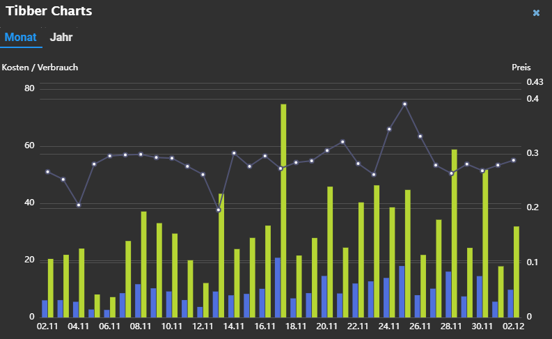

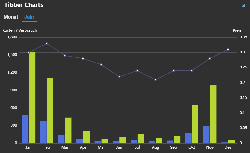

                        Hi, falls jemand Interesse hat hier mal zwei Diagramme zum Nachbauen für flexcharts
                        Kosten:
                        // TIBBER – Monats- & Jahresauswertung
                        // Durchschnittspreis aus unitPrice (verbrauchsgewichtet)
                        // =================== KONFIG ===================
                        // --- Monat (jsonDaily) ---
                        const jsonDP_Month      = 'tibberlink.0.Homes.8f8a4278-17b9-48fb-b725-b60bd1485ac6.Consumption.jsonDaily';
                        const resultCostDP      = '0_userdata.0.Tibber.SumUnitCostThisMonth';
                        const resultConsDP      = '0_userdata.0.Tibber.SumConsumptionThisMonth';
                        const resultPriceDP     = '0_userdata.0.Tibber.AvgUnitPriceThisMonth';
                        // --- Jahr (jsonMonthly + aktueller Monat aus jsonDaily) ---
                        const jsonDP_Year       = 'tibberlink.0.Homes.8f8a4278-17b9-48fb-b725-b60bd1485ac6.Consumption.jsonMonthly';
                        const resultCostYearDP  = '0_userdata.0.Tibber.SumUnitCostThisYear';
                        const resultConsYearDP  = '0_userdata.0.Tibber.SumConsumptionThisYear';
                        const resultPriceYearDP = '0_userdata.0.Tibber.AvgUnitPriceThisYear';
                        // =================== FUNKTION (MONAT) ===================
                        function calcMonthValues() {
                            try {
                                const raw = getState(jsonDP_Month)?.val;
                                if (!raw) return;
                                const data = JSON.parse(raw);
                                if (!Array.isArray(data)) return;
                                let sumCons  = 0;
                                let sumCost  = 0;
                                let sumPrice = 0; // unitPrice * consumption
                                const now = new Date();
                                const y = now.getFullYear();
                                const m = now.getMonth();
                                data.forEach(entry => {
                                    if (!entry.from) return;
                                    const d = new Date(entry.from);
                                    if (d.getFullYear() === y && d.getMonth() === m) {
                                        const cons  = Number(entry.consumption);
                                        const cost  = Number(entry.totalCost);
                                        const price = Number(entry.unitPrice);
                                        if (!isNaN(cons)) {
                                            sumCons += cons;
                                            if (!isNaN(price)) sumPrice += cons * price;
                                        if (!isNaN(cost)) sumCost += cost;
                                const avgUnitPrice = sumCons > 0 ? sumPrice / sumCons : 0;
                                setState(resultConsDP,  Number(sumCons.toFixed(3)), true);
                                setState(resultCostDP,  Number(sumCost.toFixed(4)), true);
                                setState(resultPriceDP, Number(avgUnitPrice.toFixed(4)), true);
                                log(`📅 Monat: ${sumCons.toFixed(3)} kWh | ${sumCost.toFixed(2)} € | Ø ${avgUnitPrice.toFixed(4)} €/kWh`, 'info');
                            } catch (e) {
                                log(`❌ Fehler Monatsberechnung: ${e}`, 'error');
                        // =================== FUNKTION (JAHR) ===================
                        function calcYearValues() {
                            try {
                                const rawYear  = getState(jsonDP_Year)?.val;
                                const rawMonth = getState(jsonDP_Month)?.val;
                                if (!rawYear) return;
                                const dataYear  = JSON.parse(rawYear);
                                const dataMonth = rawMonth ? JSON.parse(rawMonth) : [];
                                let sumCons  = 0;
                                let sumCost  = 0;
                                let sumPrice = 0;
                                // --- Monate aus jsonMonthly (ohne aktuellen Monat) ---
                                if (Array.isArray(dataYear)) {
                                    dataYear.forEach(entry => {
                                        if (d.getFullYear() === y && d.getMonth() !== m) {
                                            if (!isNaN(cons)) {
                                                sumCons += cons;
                                // --- Aktueller Monat aus jsonDaily ---
                                if (Array.isArray(dataMonth)) {
                                    dataMonth.forEach(entry => {
                                            if (!isNaN(cons)) {
                                                sumCons += cons;
                                setState(resultConsYearDP,  Number(sumCons.toFixed(3)), true);
                                setState(resultCostYearDP,  Number(sumCost.toFixed(4)), true);
                                setState(resultPriceYearDP, Number(avgUnitPrice.toFixed(4)), true);
                                log(`📆 Jahr ${y}: ${sumCons.toFixed(3)} kWh | ${sumCost.toFixed(2)} € | Ø ${avgUnitPrice.toFixed(4)} €/kWh`, 'info');
                            } catch (e) {
                                log(`❌ Fehler Jahresberechnung: ${e}`, 'error');
                        // =================== TRIGGER ===================
                        // beim Start
                        calcMonthValues();
                        calcYearValues();
                        // jsonDaily ändert sich
                        on({ id: jsonDP_Month, change: 'ne' }, () => {
                            calcMonthValues();
                            calcYearValues();   // wichtig!
                        // jsonMonthly ändert sich
                        on({ id: jsonDP_Year, change: 'ne' }, () => {
                            calcYearValues();
                        Jahr:
                        // Tibber Jahresübersicht + eCharts VIS-Widget
                        // - Erstellt 12 Datenpunkte für Kosten, Verbrauch, Preis
                        // - Liest tibber Monthly JSON aus
                        // - Ergänzt/überschreibt aktuellen Monat aus 0_userdata-Datenpunkten
                        // - Erstellt eCharts-Konfiguration für VIS
                        // - Tooltip mit 2 Nachkommastellen
                        const jsonMonthlyDP = 'tibberlink.0.Homes.xxxxxxxxxxxxx.Consumption.jsonMonthly';
                        const rootDP        = '0_userdata.0.Tibber.Jahreswerte';
                        const visDP         = `${rootDP}.eCharts_Monatsbalken`;
                        // Userdata aktuelle Monatswerte
                        const dpPriceThisMonth = '0_userdata.0.Tibber.AvgUnitPriceThisMonth';
                        const dpConsThisMonth  = '0_userdata.0.Tibber.SumConsumptionThisMonth';
                        const dpCostThisMonth  = '0_userdata.0.Tibber.SumUnitCostThisMonth';
                        // =================== 12 Monats-Datenpunkte erzeugen ===================
                        function createMonthDPs() {
                            for (let m = 1; m <= 12; m++) {
                                createState(`${rootDP}.Cost.M${m}`, 0,  { name: `Kosten Monat ${m}`,       type: 'number', unit: '€',     role: 'value' });
                                createState(`${rootDP}.Cons.M${m}`, 0,  { name: `Verbrauch Monat ${m}`,    type: 'number', unit: 'kWh',   role: 'value' });
                                createState(`${rootDP}.Price.M${m}`,0,  { name: `Durchschnittspreis M${m}`, type: 'number', unit: '€/kWh', role: 'value' });
                            createState(visDP, '', { name: 'eCharts Config Monatsbalken', type: 'string', role: 'text' });
                        createMonthDPs();
                        // =================== Hauptfunktion ===================
                        function updateYearValues() {
                            try {
                                const raw = getState(jsonMonthlyDP).val;
                                if (!raw) return log("Keine Monatsdaten vorhanden", "warn");
                                const currentYear  = new Date().getFullYear();
                                const currentMonth = new Date().getMonth() + 1;
                                let arrCost  = Array(12).fill(0);
                                let arrCons  = Array(12).fill(0);
                                let arrPrice = Array(12).fill(0);
                                // ========== JSON durchlaufen ==========
                                    const year  = d.getFullYear();
                                    const month = d.getMonth() + 1;
                                    if (year !== currentYear) return;
                                    const cost  = parseFloat(entry.totalCost)   || 0;
                                    const cons  = parseFloat(entry.consumption) || 0;
                                    const price = parseFloat(entry.unitPrice)   || 0;
                                    arrCost[month - 1]  = parseFloat(cost.toFixed(2));
                                    arrCons[month - 1]  = parseFloat(cons.toFixed(2));
                                    arrPrice[month - 1] = parseFloat(price.toFixed(2));
                                    setState(`${rootDP}.Cost.M${month}`,  cost,  true);
                                    setState(`${rootDP}.Cons.M${month}`,  cons,  true);
                                    setState(`${rootDP}.Price.M${month}`, price, true);
                                //  **AKTUELLEN MONAT MIT USERDATA ÜBERSCHREIBEN**
                                const uPrice = parseFloat(getState(dpPriceThisMonth).val) || 0;
                                const uCons  = parseFloat(getState(dpConsThisMonth).val)  || 0;
                                const uCost  = parseFloat(getState(dpCostThisMonth).val)  || 0;
                                arrCost[currentMonth - 1]  = parseFloat(uCost.toFixed(2));
                                arrCons[currentMonth - 1]  = parseFloat(uCons.toFixed(2));
                                arrPrice[currentMonth - 1] = parseFloat(uPrice.toFixed(2));
                                setState(`${rootDP}.Cost.M${currentMonth}`,  uCost,  true);
                                setState(`${rootDP}.Cons.M${currentMonth}`,  uCons,  true);
                                setState(`${rootDP}.Price.M${currentMonth}`, uPrice, true);
                                // eCharts VIS-Konfiguration
                                const option = {

                        Monat:
                        // Tibber Daily Übersicht für VIS eCharts
                        // - ALLE Daten aus Tibbers jsonDaily
                        // - Linke Achse: Kosten (€) + Verbrauch (kWh)
                        // - Rechte Achse: Preis (€/kWh)
                        // - Schriftfarbe X/Y weiß, Y-Hilfslinien #525252
                        // - Rechte Y-Achse Maximalwert auf 3 Nachkommastellen
                        // - Preislinie nicht geglättet
                        const jsonDailyDP = 'tibberlink.0.Homes.xxxxxxxxxxx.Consumption.jsonDaily';
                        const dpBase = '0_userdata.0.Tibber.Daily.';
                        const dpDates     = dpBase + 'Dates';
                        const dpCost      = dpBase + 'Cost';
                        const dpUsage     = dpBase + 'Usage';
                        const dpUnitPrice = dpBase + 'UnitPrice';
                        const dpEchart    = dpBase + 'EchartConfig';
                        // =================== Hilfsfunktion ===================
                        function ensureDP(id) {
                            if (!existsState(id)) createState(id, '', { type: 'string', read: true, write: true });
                        [dpDates, dpCost, dpUsage, dpUnitPrice, dpEchart].forEach(ensureDP);
                        // =================== Datum formatieren TT.MM. ===================
                        function formatDateTTMM(fromStr) {
                            const d = new Date(fromStr);
                            if (isNaN(d)) return '';
                            const day = ('0' + d.getDate()).slice(-2);
                            const month = ('0' + (d.getMonth() + 1)).slice(-2);
                            return `${day}.${month}`;
                        async function buildTibberDailyChart() {
                            const raw = await getStateAsync(jsonDailyDP);
                            if (!raw || !raw.val) {
                                log('⚠ jsonDaily leer oder nicht verfügbar', 'warn');
                                return;
                            let daily;
                            try {
                                daily = JSON.parse(raw.val);
                                if (!Array.isArray(daily)) {
                                    log('❌ JSON ist kein Array', 'error');
                                    return;
                            } catch (e) {
                                log('❌ Fehler beim Parsen von jsonDaily: ' + e, 'error');
                                return;
                            const dates = [];
                            const cost = [];
                            const usage = [];
                            const price = [];
                            daily.forEach(entry => {
                                dates.push(formatDateTTMM(entry.from));
                                cost.push(Number(entry.totalCost || 0).toFixed(2));
                                usage.push(Number(entry.consumption || 0).toFixed(2));
                                price.push(Number(entry.unitPrice || 0).toFixed(3));
                            // Datenpunkte aktualisieren
                            setState(dpDates, JSON.stringify(dates), true);
                            setState(dpCost, JSON.stringify(cost), true);
                            setState(dpUsage, JSON.stringify(usage), true);
                            setState(dpUnitPrice, JSON.stringify(price), true);
                            // Rechte Y-Achse Maximalwert für Preis berechnen (3 Nachkommastellen)
                            let maxPrice = Math.max(...price.map(p => Number(p))) * 1.1; // 10% Puffer
                            maxPrice = Number(maxPrice.toFixed(3));
                            // Linke Achse: Maximalwert für Kosten und Verbrauch
                            const maxLeft = Math.max(
                                ...cost.map(c => Number(c)),
                                ...usage.map(u => Number(u))
                            ) * 1.1;
                            const echartConfig = {
                                textStyle: { color: '#FFFFFF' },
                                tooltip: {
                                    trigger: 'axis',
                                    textStyle: { color: '#525252' },
                                    formatter: function(params) {
                                        const day = params[0].axisValue;
                                        const kosten = params.find(p => p.seriesName === 'Kosten (€)')?.value || 0;
                                        const verbrauch = params.find(p => p.seriesName === 'Verbrauch (kWh)')?.value || 0;
                                        const preis = params.find(p => p.seriesName === 'Preis (€/kWh)')?.value || 0;
                                        return `${day} → Kosten: ${Number(kosten).toFixed(2)} € | Verbrauch: ${Number(verbrauch).toFixed(2)} kWh | Preis: ${Number(preis).toFixed(3)} €/kWh`;
                                legend: { textStyle: { color: '#FFFFFF' }, data: ['Kosten (€)', 'Verbrauch (kWh)', 'Preis (€/kWh)'] },
                                xAxis: { type: 'category', data: dates, axisLabel: { color: '#FFFFFF' } },
                                yAxis: [
                                        type: 'value',
                                        name: 'Kosten / Verbrauch',
                                        min: 0,
                                        max: maxLeft,
                                        axisLabel: { color: '#FFFFFF' },
                                        nameTextStyle: { color: '#FFFFFF', align: 'center' }, // linksbündig
                                        splitLine: { show: true, lineStyle: { color: '#525252' } }
                                        type: 'value',
                                        position: 'right',
                                        min: 0,
                                        max: maxPrice,
                                        axisLabel: {
                                            color: '#FFFFFF',
                                            formatter: function(value) { return Number(value).toFixed(3) + ' €/kWh'; }
                                        nameTextStyle: { color: '#FFFFFF' },
                                series: [
                                    { name: 'Kosten (€)', type: 'bar', data: cost, yAxisIndex: 0 },
                                    { name: 'Verbrauch (kWh)', type: 'bar', data: usage, yAxisIndex: 0 },
                                    { name: 'Preis (€/kWh)', type: 'line', data: price, yAxisIndex: 1 } // nicht geglättet
                            setState(dpEchart, JSON.stringify(echartConfig), true);
                            log('✔ Tibber Daily für VIS aktualisiert – ' + daily.length + ' Einträge');
                        // =================== Trigger ===================
                        on({ id: jsonDailyDP, change: 'any' }, () => buildTibberDailyChart());
                        buildTibberDailyChart();

                        • L lesiflo
                          Kosten:
                              try {
                                  if (!raw) return;
                                  let sumCons  = 0;
                                  let sumCost  = 0;
                                          if (!isNaN(cons)) {
                                              sumCons += cons;
                              } catch (e) {
                              try {
                                  let sumCons  = 0;
                                  let sumCost  = 0;
                                  let sumPrice = 0;
                                              if (!isNaN(cons)) {
                                                  sumCons += cons;
                                              if (!isNaN(cons)) {
                                                  sumCons += cons;
                              } catch (e) {
                          // beim Start
                          calcMonthValues();
                          calcYearValues();
                              calcMonthValues();
                              calcYearValues();
                          Jahr:
                          createMonthDPs();
                              try {
                                  const option = {
                                      tooltip: {
                                          trigger: 'axis',
                                              return params.map(p => {
                                                  let unit = '€/kWh';
                                                  if (p.seriesName.includes('€')) unit = '€';
                                                  else if (p.seriesName.includes('kWh')) unit = 'kWh';
                                                  return `${p.seriesName}: ${p.value.toFixed(2)} ${unit}`;
                                              }).join('<br/>');
                                      legend: {
                                      xAxis: {
                                          type: 'category',
                                          data: ['Jan', 'Feb', 'Mär', 'Apr', 'Mai', 'Jun', 'Jul', 'Aug', 'Sep', 'Okt', 'Nov', 'Dez'],
                                      yAxis: [
                                              type: 'value',
                                              splitLine: { show: true, lineStyle: { color: '#525252' } },
                                              axisLine: { lineStyle: { color: '#ccc' } }
                                              type: 'value',
                                              position: 'right',
                                      series: [
                                          { name: 'Kosten (€)', type: 'bar', data: arrCost },
                                          { name: 'Verbrauch (kWh)', type: 'bar', data: arrCons },
                                          { name: 'Preis (€/kWh)', type: 'line', yAxisIndex: 1, data: arrPrice }
                                  setState(visDP, JSON.stringify(option), true);
                                  log("Jahreswerte + aktueller Monat + eCharts VIS aktualisiert", "info");
                              } catch (e) {
                                  log("Fehler JSON: " + e, "error");
                          updateYearValues();
                          on({ id: jsonMonthlyDP, change: 'any' }, () => updateYearValues());
                          on({ id: [dpPriceThisMonth, dpConsThisMonth, dpCostThisMonth], change: 'ne' }, () => updateYearValues());
                          Monat:
                                  return;
                              let daily;
                              try {
                                      return;
                              } catch (e) {
                                  return;
                              const dates = [];
                              const cost = [];
                              const usage = [];
                              const price = [];
                              ) * 1.1;
                                  tooltip: {
                                      trigger: 'axis',
                                  yAxis: [
                                          type: 'value',
                                          min: 0,
                                          max: maxLeft,
                                          type: 'value',
                                          position: 'right',
                                          min: 0,
                                          max: maxPrice,
                                          axisLabel: {
                                              color: '#FFFFFF',
                                  series: [
