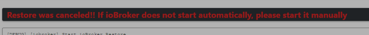

    #21
    @homoran sagte in BackItUp - Probleme mit wiederherstellung:
    Was wirklich war steht im log
    wo finde ich den log

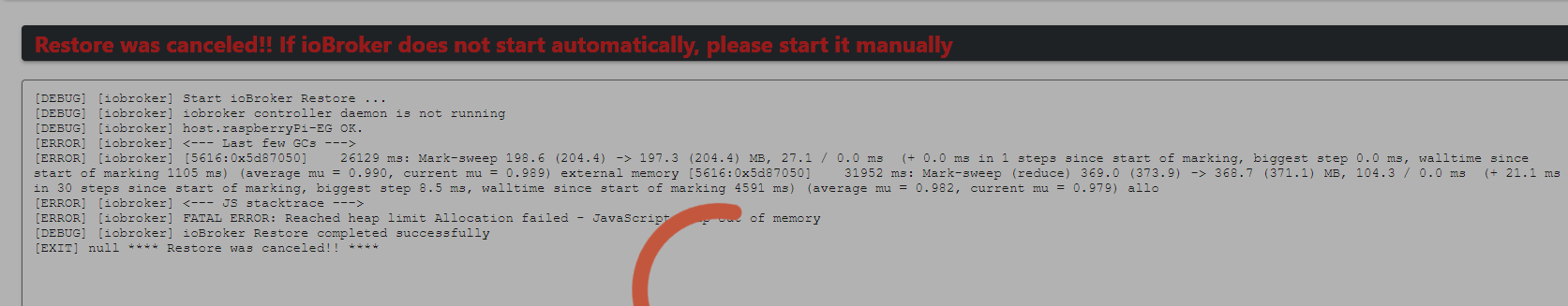

          LOG:
          2023-07-26 21:15:50.978 - info: host.raspberryPi-EG iobroker.js-controller version 4.0.24 js-controller starting
          2023-07-26 21:15:50.986 - info: host.raspberryPi-EG Copyright (c) 2014-2022 bluefox, 2014 hobbyquaker
          2023-07-26 21:15:50.988 - info: host.raspberryPi-EG hostname: raspberryPi-EG, node: v16.20.1
          2023-07-26 21:15:50.989 - info: host.raspberryPi-EG ip addresses: 192.168.0.69 fdf9:87b2:c3b6:40c6:7fc8:76c:6b00:a2e3 fe80::4e85:b5d8:5d31:7a89 192.168.0.71 fdf9:87b2:c3b6:40c6:e105:fdee:2365:338f fe80::6e6:2044:ded3:b232
          2023-07-26 21:15:51.418 - info: host.raspberryPi-EG connected to Objects and States
          2023-07-26 21:15:51.446 - info: host.raspberryPi-EG Node.js version has changed from unknown to 16.20.1
          2023-07-26 21:15:51.492 - info: host.raspberryPi-EG Successfully updated capabilities "cap_net_admin, cap_net_bind_service, cap_net_raw" for /usr/bin/node
          2023-07-26 21:15:51.510 - info: host.raspberryPi-EG added notifications configuration of host
          2023-07-26 21:15:52.071 - info: host.raspberryPi-EG 3 instances found
          2023-07-26 21:15:52.081 - info: host.raspberryPi-EG starting 3 instances
          2023-07-26 21:15:52.136 - info: host.raspberryPi-EG instance system.adapter.admin.0 started with pid 5276
          2023-07-26 21:15:54.652 - info: admin.0 (5276) starting. Version 6.3.5 in /opt/iobroker/node_modules/iobroker.admin, node: v16.20.1, js-controller: 4.0.24
          2023-07-26 21:15:54.701 - info: admin.0 (5276) requesting all states
          2023-07-26 21:15:54.702 - info: admin.0 (5276) requesting all objects
          2023-07-26 21:15:54.807 - info: admin.0 (5276) received all objects
          2023-07-26 21:15:55.042 - info: admin.0 (5276) http server listening on port 8081
          2023-07-26 21:15:55.043 - info: admin.0 (5276) Use link "http://localhost:8081" to configure.
          2023-07-26 21:15:55.051 - info: admin.0 (5276) socket.io server listening on port 8081
          2023-07-26 21:15:55.161 - warn: admin.0 (5276) Repository cannot be read: Active repo - stable
          2023-07-26 21:15:55.163 - warn: admin.0 (5276) Active repository "stable" cannot be read
          2023-07-26 21:15:56.110 - info: host.raspberryPi-EG instance system.adapter.discovery.0 started with pid 5299
          2023-07-26 21:15:58.260 - info: discovery.0 (5299) starting. Version 3.1.0 in /opt/iobroker/node_modules/iobroker.discovery, node: v16.20.1, js-controller: 4.0.24
          2023-07-26 21:16:00.103 - info: host.raspberryPi-EG instance system.adapter.backitup.0 started with pid 5318
          2023-07-26 21:16:02.283 - info: backitup.0 (5318) starting. Version 2.6.23 in /opt/iobroker/node_modules/iobroker.backitup, node: v16.20.1, js-controller: 4.0.24
          2023-07-26 21:16:02.410 - info: backitup.0 (5318) [iobroker] backup will be activated at 02:40 every 1 day(s)
          2023-07-26 21:16:24.567 - info: admin.0 (5276) ==> Connected system.user.admin from ::ffff:192.168.0.55
          2023-07-26 21:16:24.772 - info: host.raspberryPi-EG Updating repository "stable" under "http://download.iobroker.net/sources-dist.json"
          2023-07-26 21:28:13.976 - info: admin.0 (5276) ==> Connected system.user.admin from ::ffff:192.168.0.55
          2023-07-26 21:29:11.154 - info: admin.0 (5276) <== Disconnect system.user.admin from ::ffff:192.168.0.55
          2023-07-26 21:29:13.048 - info: admin.0 (5276) ==> Connected system.user.admin from ::ffff:192.168.0.55
          2023-07-26 21:29:38.675 - info: host.raspberryPi-EG stopInstance system.adapter.backitup.0 (force=false, process=true)
          2023-07-26 21:29:38.697 - info: backitup.0 (5318) Got terminate signal TERMINATE_YOURSELF
          2023-07-26 21:29:38.700 - info: backitup.0 (5318) cleaned everything up...
          2023-07-26 21:29:38.702 - info: backitup.0 (5318) terminating
          2023-07-26 21:29:38.703 - info: backitup.0 (5318) Terminated (ADAPTER_REQUESTED_TERMINATION): Without reason
          2023-07-26 21:29:38.734 - info: host.raspberryPi-EG stopInstance system.adapter.backitup.0 send kill signal
          2023-07-26 21:29:38.751 - info: admin.0 (5276) <== Disconnect system.user.admin from ::ffff:192.168.0.55
          2023-07-26 21:29:39.254 - info: host.raspberryPi-EG instance system.adapter.backitup.0 terminated with code 11 (ADAPTER_REQUESTED_TERMINATION)
          2023-07-26 21:29:41.774 - info: host.raspberryPi-EG instance system.adapter.backitup.0 started with pid 5445
          2023-07-26 21:29:43.980 - info: backitup.0 (5445) starting. Version 2.6.23 in /opt/iobroker/node_modules/iobroker.backitup, node: v16.20.1, js-controller: 4.0.24
          2023-07-26 21:29:44.092 - info: backitup.0 (5445) [iobroker] backup will be activated at 02:40 every 1 day(s)
          2023-07-26 21:29:45.886 - info: admin.0 (5276) ==> Connected system.user.admin from ::ffff:192.168.0.55
          2023-07-26 21:29:56.868 - info: admin.0 (5276) <== Disconnect system.user.admin from ::ffff:192.168.0.55
          2023-07-26 21:29:58.598 - info: admin.0 (5276) ==> Connected system.user.admin from ::ffff:192.168.0.55
          2023-07-26 21:30:46.595 - info: host.raspberryPi-EG stopInstance system.adapter.backitup.0 (force=false, process=true)
          2023-07-26 21:30:46.603 - info: backitup.0 (5445) Got terminate signal TERMINATE_YOURSELF
          2023-07-26 21:30:46.606 - info: backitup.0 (5445) cleaned everything up...
          2023-07-26 21:30:46.608 - info: backitup.0 (5445) terminating
          2023-07-26 21:30:46.610 - info: backitup.0 (5445) Terminated (ADAPTER_REQUESTED_TERMINATION): Without reason
          2023-07-26 21:30:46.642 - info: host.raspberryPi-EG stopInstance system.adapter.backitup.0 send kill signal
          2023-07-26 21:30:46.650 - info: admin.0 (5276) <== Disconnect system.user.admin from ::ffff:192.168.0.55
          2023-07-26 21:30:47.202 - info: host.raspberryPi-EG instance system.adapter.backitup.0 terminated with code 11 (ADAPTER_REQUESTED_TERMINATION)
          2023-07-26 21:30:49.687 - info: host.raspberryPi-EG instance system.adapter.backitup.0 started with pid 5493
          2023-07-26 21:30:51.991 - info: backitup.0 (5493) starting. Version 2.6.23 in /opt/iobroker/node_modules/iobroker.backitup, node: v16.20.1, js-controller: 4.0.24
          2023-07-26 21:30:52.104 - info: backitup.0 (5493) [iobroker] backup will be activated at 02:40 every 1 day(s)
          2023-07-26 21:31:02.369 - info: admin.0 (5276) ==> Connected system.user.admin from ::ffff:192.168.0.55
          2023-07-26 21:31:41.011 - info: host.raspberryPi-EG received SIGTERM
          2023-07-26 21:31:41.014 - info: backitup.0 (5493) cleaned everything up...
          2023-07-26 21:31:41.017 - info: admin.0 (5276) terminating http server on port 8081
          2023-07-26 21:31:41.013 - info: host.raspberryPi-EG stopInstance system.adapter.admin.0 (force=false, process=true)
          2023-07-26 21:31:41.013 - info: host.raspberryPi-EG stopInstance system.adapter.discovery.0 (force=false, process=true)
          2023-07-26 21:31:41.014 - info: host.raspberryPi-EG stopInstance system.adapter.backitup.0 (force=false, process=true)
          2023-07-26 21:31:41.029 - info: backitup.0 (5493) Got terminate signal TERMINATE_YOURSELF
          2023-07-26 21:31:41.032 - info: admin.0 (5276) Got terminate signal TERMINATE_YOURSELF
          2023-07-26 21:31:41.037 - info: host.raspberryPi-EG stopInstance system.adapter.admin.0 send kill signal
          2023-07-26 21:31:41.037 - info: backitup.0 (5493) Terminated (START_IMMEDIATELY_AFTER_STOP): Without reason
          2023-07-26 21:31:41.029 - info: discovery.0 (5299) Got terminate signal TERMINATE_YOURSELF
          2023-07-26 21:31:41.041 - info: host.raspberryPi-EG stopInstance system.adapter.discovery.0 send kill signal
          2023-07-26 21:31:41.042 - info: discovery.0 (5299) Terminated (START_IMMEDIATELY_AFTER_STOP): Without reason
          2023-07-26 21:31:41.042 - info: admin.0 (5276) Terminated (START_IMMEDIATELY_AFTER_STOP): Without reason
          2023-07-26 21:31:41.042 - info: host.raspberryPi-EG stopInstance system.adapter.backitup.0 send kill signal
          2023-07-26 21:31:41.605 - info: host.raspberryPi-EG instance system.adapter.backitup.0 terminated with code 156 (START_IMMEDIATELY_AFTER_STOP)
          2023-07-26 21:31:41.661 - info: host.raspberryPi-EG instance system.adapter.admin.0 terminated with code 156 (START_IMMEDIATELY_AFTER_STOP)
          2023-07-26 21:31:41.699 - info: host.raspberryPi-EG instance system.adapter.discovery.0 terminated with code 156 (START_IMMEDIATELY_AFTER_STOP)
          2023-07-26 21:31:41.700 - info: host.raspberryPi-EG All instances are stopped.
          2023-07-26 21:31:41.845 - info: host.raspberryPi-EG terminated
          2023-07-26 21:33:01.981 - info: host.raspberryPi-EG iobroker.js-controller version 4.0.24 js-controller starting
          2023-07-26 21:33:01.988 - info: host.raspberryPi-EG Copyright (c) 2014-2022 bluefox, 2014 hobbyquaker
          2023-07-26 21:33:01.988 - info: host.raspberryPi-EG hostname: raspberryPi-EG, node: v16.20.1
          2023-07-26 21:33:01.990 - info: host.raspberryPi-EG ip addresses: 192.168.0.69 fdf9:87b2:c3b6:40c6:7fc8:76c:6b00:a2e3 fe80::4e85:b5d8:5d31:7a89 192.168.0.71 fdf9:87b2:c3b6:40c6:e105:fdee:2365:338f fe80::6e6:2044:ded3:b232
          2023-07-26 21:33:02.759 - info: host.raspberryPi-EG connected to Objects and States
          2023-07-26 21:33:02.783 - info: host.raspberryPi-EG added notifications configuration of host
          2023-07-26 21:33:03.189 - info: host.raspberryPi-EG Delete host system.host.raspberryPi-EG
          2023-07-26 21:33:03.226 - info: host.raspberryPi-EG Delete state "system.host.raspberryPi-EG.versions.nodeCurrent"
          2023-07-26 21:33:03.232 - info: host.raspberryPi-EG 3 instances found
          2023-07-26 21:33:03.242 - info: host.raspberryPi-EG starting 2 instances
          2023-07-26 21:33:03.248 - warn: host.raspberryPi-EG startInstance cannot find adapter "discovery@3.1.0". Try to install it... 1 attempt
          2023-07-26 21:33:03.249 - info: host.raspberryPi-EG iobroker install discovery@3.1.0 using installedVersion
          2023-07-26 21:33:03.308 - info: host.raspberryPi-EG Delete state "system.host.raspberryPi-EG.versions.nodeNewest"
          2023-07-26 21:33:03.326 - info: host.raspberryPi-EG Delete state "system.host.raspberryPi-EG.versions.nodeNewestNext"
          2023-07-26 21:33:03.347 - info: host.raspberryPi-EG instance system.adapter.admin.0 started with pid 5737
          2023-07-26 21:33:03.361 - info: host.raspberryPi-EG Delete state "system.host.raspberryPi-EG.versions.npmCurrent"
          2023-07-26 21:33:03.379 - info: host.raspberryPi-EG Delete state "system.host.raspberryPi-EG.versions.npmNewest"
          2023-07-26 21:33:03.434 - info: host.raspberryPi-EG Delete state "system.host.raspberryPi-EG.versions.npmNewestNext"
          2023-07-26 21:33:03.447 - info: host.raspberryPi-EG Some obsolete host states deleted.
          2023-07-26 21:33:06.190 - info: admin.0 (5737) starting. Version 6.3.5 in /opt/iobroker/node_modules/iobroker.admin, node: v16.20.1, js-controller: 4.0.24
          2023-07-26 21:33:06.328 - info: admin.0 (5737) requesting all states
          2023-07-26 21:33:06.330 - info: admin.0 (5737) requesting all objects
          2023-07-26 21:33:07.102 - info: admin.0 (5737) received all objects
          2023-07-26 21:33:07.307 - info: host.raspberryPi-EG instance system.adapter.backitup.0 started with pid 5769
          2023-07-26 21:33:07.316 - info: admin.0 (5737) https server listening on port 8081
          2023-07-26 21:33:07.317 - info: admin.0 (5737) Use link "https://localhost:8081" to configure.
          2023-07-26 21:33:07.327 - info: admin.0 (5737) Secure socket.io server listening on port 8081
          2023-07-26 21:33:07.890 - info: host.raspberryPi-EG iobroker npm-install: NPM version: 8.19.4Installing iobroker.discovery@3.1.0... (System call)
          2023-07-26 21:33:10.200 - info: backitup.0 (5769) starting. Version 2.6.23 in /opt/iobroker/node_modules/iobroker.backitup, node: v16.20.1, js-controller: 4.0.24
          2023-07-26 21:33:10.412 - info: backitup.0 (5769) [iobroker] backup will be activated at 02:40 every 1 day(s)
          2023-07-26 21:33:19.509 - info: host.raspberryPi-EG iobroker npm-install:
          2023-07-26 21:33:19.511 - info: host.raspberryPi-EG iobroker npm-install: added 40 packages in 10s46 packages are looking for funding run `npm fund` for details
          2023-07-26 21:33:19.546 - info: host.raspberryPi-EG iobroker npm-install: host.raspberryPi-EG install adapter discovery@3.1.0
          2023-07-26 21:33:19.576 - info: host.raspberryPi-EG iobroker npm-install: upload [6] discovery.admin /opt/iobroker/node_modules/iobroker.discovery/admin/discovery.png discovery.png image/png

          • von.cartmanV von.cartman
            einem mageren GB an RAM
            das kann hinhauen.
            der BackUp ist aus einem 4GB RAM, und der Wiederherstellung TEST hat 1GB RAM
            Ich habe bereit 8GB RASPI bestellt, und versuche es dann noch mal.

              #26
              @von-cartman ich sehe nirgendwo den restore
              hat der neue Raspi den selben hostnamen und die selbe ip, wie der Spender?
              von.cartmanV 1 Antwort Letzte Antwort
                von.cartmanV Offline
                von.cartman
                #27
                nein, hat nicht
                  nein, hat nicht
                  #28
                  @von-cartman dann mach mal iobroker host this
                  was ist denn mit

                    @von-cartman sagte in BackItUp - Probleme mit wiederherstellung:
                    das kann hinhauen.
                    Moin,
                    wirklich Dein Ernst?
                    Versuchst Du auch ein Hefeweizen 0,5 Liter in ein Glas mit 0,1 Liter einzufüllen und Du wunderst Dich nicht, dass es überläuft?
                    VG
                    Bernd

                              ich mache noch ein neuen Versuch.
                              ich halte den laufenden ioBroker (Spender) an
                              dann versuche ich auf dem Emfänger den BackUp einzuspiellen und werde hier noch mal die LOGs presentieren

                                2023-07-27 11:55:15.891 - error: backitup.0 (6116) [ERROR] [iobroker] <--- Last few GCs --->
                                2023-07-27 11:55:15.892 - error: backitup.0 (6116) [ERROR] [iobroker] [6006:0x478e050] 29464 ms: Mark-sweep 199.9 (205.7) -> 198.7 (202.2) MB, 37.4 / 0.1 ms (+ 0.1 ms in 1 steps since start of marking, biggest step 0.1 ms, walltime since start of marking 5456 ms) (average mu = 0.994, current mu = 0.994) external memory [6006:0x478e050] 37010 ms: Mark-sweep (reduce) 369.0 (371.6) -> 368.6 (371.1) MB, 141.4 / 0.0 ms (+ 3.6 ms in 7 steps since start of marking, biggest step 0.9 ms, walltime since start of marking 5867 ms) (average mu = 0.985, current mu = 0.981) alloca
                                2023-07-27 11:55:15.892 - error: backitup.0 (6116) [ERROR] [iobroker] <--- JS stacktrace --->
                                2023-07-27 11:55:15.893 - error: backitup.0 (6116) [ERROR] [iobroker] FATAL ERROR: Reached heap limit Allocation failed - JavaScript heap out of memory
                                2023-07-27 11:55:16.022 - info: backitup.0 (6116) [iobroker] backup will be activated at 02:40 every 1 day(s)
                                2023-07-27 11:55:36.133  - info: admin.0 (6074) ==> Connected system.user.admin from ::ffff:192.168.0.55
                                2023-07-27 11:55:38.025  - info: admin.0 (6074) ==> Connected system.user.admin from ::ffff:192.168.0.55
                                2023-07-27 11:55:41.021  - info: admin.0 (6074) <== Disconnect system.user.admin from ::ffff:192.168.0.55
                                2023-07-27 11:56:48.790  - info: backitup.0 (6116) cleaned everything up...

                                    #37
                                    braucht's noch mehr?
                                    Dein RAM reicht nicht.
                                    zu viel Spülwasser im Glas!
                                    wie groß ist das Backup?
                                    Instanz von backitup auf debug stellen!
                                    da ist wieder nichts vom restore zu sehen
                                    von.cartmanV ? 4 Antworten Letzte Antwort

                                      Ok. Vielen DANK
                                      Dann muss ich wohl warten bis der 8GB ankommt.
                                        Ok. Vielen DANK
