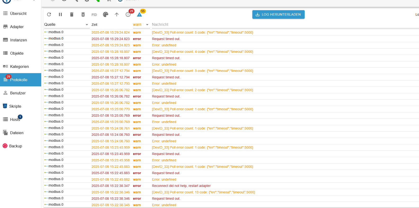

      @homoran Hi
      Auch wenn ich alias raus nehme ändert sich nichts
      Ich versuche nur gerade das register 30025 auszulesen da müsste ja dann ne 2 kommen
      modbus.0
      	2025-07-08 15:26:07.782	info	Disconnected from slave
      modbus.0
      	2025-07-08 15:26:06.782	warn	[DevID_33] Poll error count: 2 code: {"err":"timeout","timeout":5000}
      modbus.0
      	2025-07-08 15:26:06.782	error	Request timed out.
      modbus.0
      	2025-07-08 15:26:06.782	warn	Error: undefined
      modbus.0
      	2025-07-08 15:26:01.781	info	Connected to slave
      admin.0
      	2025-07-08 15:25:56.431	info	<== Disconnect system.user.admin from ::ffff:192.168.178.234 javascript
      admin.0
      	2025-07-08 15:25:56.345	info	==> Connected system.user.admin from ::ffff:192.168.178.234
      admin.0
      	2025-07-08 15:25:33.195	info	<== Disconnect system.user.admin from ::ffff:192.168.178.234 modbus
      wendy2702 1 Reply Last reply Reply Quote 0
      • wendy2702
        wendy2702 @Sascha Hartmann last edited by
        @sascha-hartmann stell das loggen mal auf Debug und zeige das eingetragene Register als screenshot.
        Sascha Hartmann 2 Replies Last reply Reply Quote 1

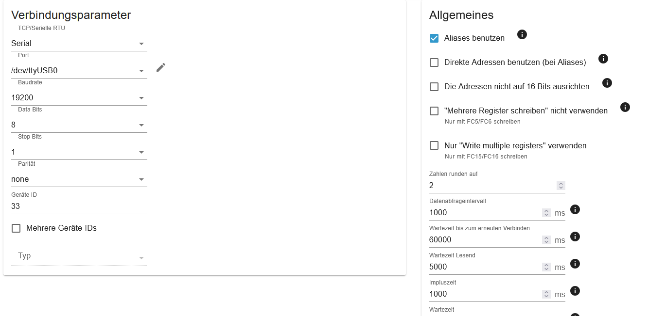

                      • Homoran
                        Homoran Global Moderator Administrators @Sascha Hartmann last edited by
                        @sascha-hartmann und der USB-Port stimmt?
                        wenn du dir nicht sicher bist, bitte doch die Langfassung von iob diag
                        Sascha Hartmann 3 Replies Last reply Reply Quote 0

                                      User that called 'iob diag':
                                      hartmann
                                      HOME=/home/hartmann
                                      GROUPS=hartmann adm dialout cdrom sudo audio video plugdev games users input render netdev lpadmin gpio i2c spi iobroker
                                      iobroker
                                      HOME=/home/iobroker
                                      *** DISPLAY-SERVER SETUP ***
                                      Display-Server: true
                                      Desktop:
                                      Terminal:       tty
                                      *** MEMORY ***
                                      Mem:            8.4G        1.2G        4.3G         29M        3.1G        7.2G
                                      Swap:           209M          0B        209M
                                      Total:          8.7G        1.2G        4.5G
                                      Active iob-Instances:   6
                                               8052 M total memory
                                               1142 M used memory
                                               2935 M active memory
                                                703 M inactive memory
                                               4095 M free memory
                                                134 M buffer memory
                                               2805 M swap cache
                                                199 M total swap
                                                  0 M used swap
                                                199 M free swap
                                      top - 06:51:07 up 14:40,  4 users,  load average: 0.77, 0.68, 0.51
                                      Tasks: 215 total,   1 running, 214 sleeping,   0 stopped,   0 zombie
                                      %Cpu(s): 33.3 us,  0.0 sy,  0.0 ni, 66.7 id,  0.0 wa,  0.0 hi,  0.0 si,  0.0 st
                                      MiB Mem :   8052.3 total,   4095.1 free,   1142.4 used,   2940.0 buff/cache
                                      MiB Swap:    200.0 total,    200.0 free,      0.0 used.   6909.9 avail Mem
                                      *** FAILED SERVICES ***
                                      0 loaded units listed.
                                      *** DMESG CRITICAL ERRORS ***
                                      No critical errors detected
                                      *** FILESYSTEM ***
                                      udev           devtmpfs  3.8G     0  3.8G   0% /dev
                                      tmpfs          tmpfs     806M  6.7M  799M   1% /run
                                      /dev/mmcblk0p2 ext4      113G   12G   96G  11% /
                                      tmpfs          tmpfs     4.0G  368K  4.0G   1% /dev/shm
                                      tmpfs          tmpfs     5.0M   48K  5.0M   1% /run/lock
                                      /dev/mmcblk0p1 vfat      510M   76M  435M  15% /boot/firmware
                                      tmpfs          tmpfs     806M  192K  806M   1% /run/user/1000
                                      [Tue Jul  8 16:10:49 2025] Kernel command line: reboot=w coherent_pool=1M 8250.nr_uarts=1 pci=pcie_bus_safe  smsc95xx.macaddr=2C:CF:67:9A:42:37 vc_mem.mem_base=0x3fc00000 vc_mem.mem_size=0x40000000  console=ttyAMA10,115200 console=tty1 root=PARTUUID=a827d94a-02 rootfstype=ext4 fsck.repair=yes rootwait quiet splash plymouth.ignore-serial-consoles cfg80211.ieee80211_regdom=DE
                                      [Tue Jul  8 16:10:50 2025] EXT4-fs (mmcblk0p2): mounted filesystem 5170097f-f1f6-42d8-a2ff-8938cbdfa7be ro with ordered data mode. Quota mode: none.
                                      [Tue Jul  8 16:10:51 2025] EXT4-fs (mmcblk0p2): re-mounted 5170097f-f1f6-42d8-a2ff-8938cbdfa7be r/w. Quota mode: none.
                                      Show mounted filesystems:
                                      TARGET               SOURCE         FSTYPE      OPTIONS
                                      /                    /dev/mmcblk0p2 ext4        rw,noatime
                                      |-/run/user/1000/doc portal         fuse.portal rw,nosuid,nodev,relatime,user_id=1000,group_id=1000
                                      `-/boot/firmware     /dev/mmcblk0p1 vfat        rw,relatime,fmask=0022,dmask=0022,codepage=437,iocharset=ascii,shortname=mixed,errors=remount-ro
                                      /var:
                                      5.1G    /var/
                                      4.0G    /var/log/journal/e60149e5b02640408b3f8e36879ec411
                                      4.0G    /var/log
                                      549M    /var/cache
                                      Archived and active journals take up 3.9G in the file system.
                                      /opt/iobroker/backups:
                                      1.8M    /opt/iobroker/backups/
                                      /opt/iobroker/iobroker-data:
                                      145M    /opt/iobroker/iobroker-data/
                                      125M    /opt/iobroker/iobroker-data/files
                                      47M     /opt/iobroker/iobroker-data/files/admin.admin
                                      46M     /opt/iobroker/iobroker-data/files/admin.admin/custom/assets
                                      24M     /opt/iobroker/iobroker-data/files/modbus.admin/static/js/main.6a71b34c.js.map
                                      9.3M    /opt/iobroker/iobroker-data/files/modbus.admin/static/js/main.6a71b34c.js
                                      8.1M    /opt/iobroker/iobroker-data/files/backitup.admin/assets/index-BFvcOIQE.js
                                      5.5M    /opt/iobroker/iobroker-data/objects.jsonl
                                      4.6M    /opt/iobroker/iobroker-data/files/javascript.admin/vs/language/typescript/tsWorker.js
                                      USB-Devices by-id:
                                      /dev/serial/by-id/usb-FTDI_USB_Serial_Converter_FTB6SPL3-if00-port0
                                      zigbee.X
                                      Extended Pan ID:
                                      *** MASKED ***
                                      Pan ID:
                                      *** MASKED ***
                                      Channel:
                                      *** MASKED ***
                                      Network Key:
                                      *** MASKED ***
                                      *** NodeJS-Installation ***
                                      /usr/bin/nodejs         v20.19.3
                                      /usr/bin/node           v20.19.3
                                      /usr/bin/npm            10.8.2
                                      /usr/bin/npx            10.8.2
                                      /usr/bin/corepack       0.32.0
                                      nodejs:
                                        Installed: 20.19.3-1nodesource1
                                        Candidate: 20.19.3-1nodesource1
                                        Version table:
                                       *** 20.19.3-1nodesource1 1001
                                              500 https://deb.nodesource.com/node_20.x nodistro/main arm64 Packages
                                              100 /var/lib/dpkg/status
                                           20.19.2-1nodesource1 1001
                                           20.19.1-1nodesource1 1001
                                           20.19.0-1nodesource1 1001
                                           20.18.3-1nodesource1 1001
                                           20.18.2-1nodesource1 1001
                                           20.18.1-1nodesource1 1001
                                           20.18.0-1nodesource1 1001
                                           20.17.0-1nodesource1 1001
                                           20.16.0-1nodesource1 1001
                                           20.15.1-1nodesource1 1001
                                           20.15.0-1nodesource1 1001
                                           20.14.0-1nodesource1 1001
                                           20.13.1-1nodesource1 1001
                                           20.13.0-1nodesource1 1001
                                           20.12.2-1nodesource1 1001
                                           20.12.1-1nodesource1 1001
                                           20.12.0-1nodesource1 1001
                                           20.11.1-1nodesource1 1001
                                           20.11.0-1nodesource1 1001
                                           20.10.0-1nodesource1 1001
                                           20.9.0-1nodesource1 1001
                                           20.8.1-1nodesource1 1001
                                           20.8.0-1nodesource1 1001
                                           20.7.0-1nodesource1 1001
                                           20.6.1-1nodesource1 1001
                                           20.6.0-1nodesource1 1001
                                           20.5.1-1nodesource1 1001
                                           20.5.0-1nodesource1 1001
                                           20.4.0-1nodesource1 1001
                                           20.3.1-1nodesource1 1001
                                           20.3.0-1nodesource1 1001
                                           20.2.0-1nodesource1 1001
                                           20.1.0-1nodesource1 1001
                                           20.0.0-1nodesource1 1001
                                           18.19.0+dfsg-6~deb12u2 500
                                              500 http://deb.debian.org/debian bookworm/main arm64 Packages
                                           18.19.0+dfsg-6~deb12u1 500
                                              500 http://deb.debian.org/debian-security bookworm-security/main arm64 Packages
                                      No problems detected
                                      Errors in npm tree: 0
                                      *** ioBroker-Installation ***
                                      ioBroker Status
                                      Objects type: jsonl
                                      States  type: jsonl
                                      Hosts:
                                      schopf              schopf (version: 7.0.6, hostname: schopf        , alive, uptime: 151)
                                      Core adapters versions
                                      js-controller:  7.0.6
                                      admin:          7.6.17
                                      javascript:     8.9.2
                                      nodejs modules from github:     0
                                      Adapter State
                                      + system.adapter.admin.0                  : admin                 : schopf                                   -  enabled, port: 8081, bind: 0.0.0.0, run as: admin
                                      + system.adapter.backitup.0               : backitup              : schopf                                   -  enabled
                                      + system.adapter.discovery.0              : discovery             : schopf                                   -  enabled
                                      + system.adapter.javascript.0             : javascript            : schopf                                   -  enabled
                                      + system.adapter.modbus.0                 : modbus                : schopf                                   -  enabled
                                      + instance is alive
                                      ioBroker-Repositories
                                      Active repo(s): stable
                                      Upgrade policy: none
                                      Installed ioBroker-Adapters
                                      Used repository: stable
                                      Adapter    "admin"        : 7.6.17   , installed 7.6.17
                                      Adapter    "backitup"     : 3.2.2    , installed 3.2.2
                                      Adapter    "javascript"   : 8.9.2    , installed 8.9.2
                                      Controller "js-controller": 7.0.6    , installed 7.0.6
                                      Adapter    "modbus"       : 6.3.2    , installed 6.3.2
                                      Objects and States
                                      Objects:        211
                                      States:         144
                                      W: GPG error: https://packages.twingate.com/apt  InRelease: The following signatures couldn't be verified because the public key is not available: NO_PUBKEY 5C363F09A9174A9E
                                      Hit:1 https://download.docker.com/linux/debian bookworm InRelease
                                      Hit:2 https://deb.nodesource.com/node_20.x nodistro InRelease
                                      Hit:3 http://archive.raspberrypi.com/debian bookworm InRelease
                                      Hit:4 http://deb.debian.org/debian bookworm InRelease
                                      Hit:5 http://deb.debian.org/debian-security bookworm-security InRelease
                                      Hit:6 http://deb.debian.org/debian bookworm-updates InRelease
                                      Hit:7 https://apt.grafana.com stable InRelease
                                      Get:8 https://packages.twingate.com/apt  InRelease [2043 B]
                                      Hit:9 https://apt.grafana.com beta InRelease
                                      Ign:8 https://packages.twingate.com/apt  InRelease
                                      Fetched 2043 B in 1s (2594 B/s)
                                      Reading package lists...
                                      Pending Updates: 259
                                      *** Listening Ports ***
                                      tcp        0      0 0.0.0.0:22              0.0.0.0:*               LISTEN      0          7893       820/sshd: /usr/sbin
                                      tcp        0      0 127.0.0.1:9000          0.0.0.0:*               LISTEN      1001       7718783    1732282/iobroker.js
                                      tcp        0      0 127.0.0.1:9001          0.0.0.0:*               LISTEN      1001       7718778    1732282/iobroker.js
                                      tcp        0      0 127.0.0.1:631           0.0.0.0:*               LISTEN      0          4133385    927897/cupsd
                                      tcp6       0      0 ::1:631                 :::*                    LISTEN      0          4133384    927897/cupsd
                                      tcp6       0      0 :::22                   :::*                    LISTEN      0          7895       820/sshd: /usr/sbin
                                      tcp6       0      0 :::3000                 :::*                    LISTEN      112        12242      1615/grafana
                                      tcp6       0      0 :::8081                 :::*                    LISTEN      1001       7719701    1732335/io.admin.0
                                      udp        0      0 0.0.0.0:59557           0.0.0.0:*                           104        7850       633/avahi-daemon: r
                                      udp        0      0 0.0.0.0:5353            0.0.0.0:*                           104        7848       633/avahi-daemon: r
                                      udp6       0      0 :::48959                :::*                                104        7851       633/avahi-daemon: r
                                      udp6       0      0 :::5353                 :::*                                104        7849       633/avahi-daemon: r
                                      2025-07-09 06:49:45.734  - debug: modbus.0 (1735032) Initialize Objects for coils: []
                                      2025-07-09 06:49:45.735  - debug: modbus.0 (1735032) Initialize Objects for inputRegs: []
                                      2025-07-09 06:49:45.735  - debug: modbus.0 (1735032) Initialize Objects for holdingRegs: [{"_address":"30025","name":"Kommunikation","description":"","unit":"","type":"uint16be","len":1,"factor":1,"offset":0,"formula":"","role":"value","room":"","poll":true,"wp":"","cw":"","isScale":"","address":30025,"deviceId":33,"id":"holdingRegisters._Kommunikation"}]
                                      2025-07-09 06:49:45.735  - debug: modbus.0 (1735032) Add holdingRegisters._Kommunikation: {"_id":"holdingRegisters._Kommunikation","type":"state","common":{"name":"","role":"value","type":"number","read":true,"write":true,"def":0,"unit":""},"native":{"regType":"holdingRegs","address":30025,"deviceId":33,"type":"uint16be","len":1,"offset":0,"factor":1,"poll":true}}
                                      2025-07-09 06:49:45.835  - debug: modbus.0 (1735032) connect to serial /dev/ttyUSB0 with 19200
                                      2025-07-09 06:49:45.845  - info: modbus.0 (1735032) Connected to slave
                                      2025-07-09 06:49:45.846  - debug: modbus.0 (1735032) [DevID_33] Poll start ---------------------
                                      2025-07-09 06:49:45.846  - debug: modbus.0 (1735032) Initialization of scale factors done!
                                      2025-07-09 06:49:45.847  - debug: modbus.0 (1735032) [DevID_33/holdingRegs] Poll address 30025 - 1 registers
                                      2025-07-09 06:49:50.848  - warn: modbus.0 (1735032) Error: undefined
                                      2025-07-09 06:49:50.848  - error: modbus.0 (1735032) Request timed out.
                                      2025-07-09 06:49:50.848  - warn: modbus.0 (1735032) [DevID_33] Poll error count: 1 code: {"err":"timeout","timeout":5000}
                                      2025-07-09 06:49:51.850  - info: modbus.0 (1735032) Disconnected from slave
                                      2025-07-09 06:49:51.853  - debug: modbus.0 (1735032) Clearing timeout of the current request.
                                      2025-07-09 06:49:51.854  - debug: modbus.0 (1735032) Cleaning up request fifo.
                                      2025-07-09 06:50:51.851  - debug: modbus.0 (1735032) connect to serial /dev/ttyUSB0 with 19200
                                      2025-07-09 06:50:51.861  - info: modbus.0 (1735032) Connected to slave
                                      2025-07-09 06:50:51.861  - debug: modbus.0 (1735032) [DevID_33] Poll start ---------------------
                                      2025-07-09 06:50:51.861  - debug: modbus.0 (1735032) [DevID_33/holdingRegs] Poll address 30025 - 1 registers
                                      2025-07-09 06:50:56.861  - warn: modbus.0 (1735032) Error: undefined
                                      2025-07-09 06:50:56.862  - error: modbus.0 (1735032) Request timed out.
                                      2025-07-09 06:50:56.862  - warn: modbus.0 (1735032) [DevID_33] Poll error count: 2 code: {"err":"timeout","timeout":5000}
                                      2025-07-09 06:50:57.862  - info: modbus.0 (1735032) Disconnected from slave
                                      2025-07-09 06:50:57.866  - debug: modbus.0 (1735032) Clearing timeout of the current request.
                                      2025-07-09 06:50:57.866  - debug: modbus.0 (1735032) Cleaning up request fifo.
                                      iob diag has finished.

                                            Sascha Hartmann @wendy2702 last edited by
                                            @wendy2702
                                            Hi Eigentlich dürfte das nicht sein
