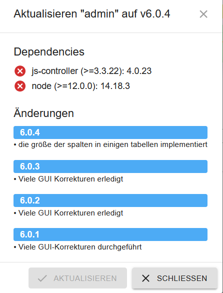

      mein iobroker sagt, ich könne admin updaten auf 6.0.4. Allerduings bleibt der Button ausgegraut, wohl wegen "Dependencies" - aber wenn ich es richtig sehe, sind doch die aktuellen Versionen höher als die erforderlichen. Alles andere habe ich aktualisiert.
      Was tun?

        • Thomas Braun
          Thomas Braun Most Active @wrod last edited by
          @wrod sagte in Admin Update Problem:
          Was tun?
          Die Kommandozeile bemühen.
          iobroker update
          iobroker upgrade
          W 2 Replies Last reply Reply Quote 0

                    • W
                      wrod @Thomas Braun last edited by
                      @thomas-braun
                      auf update:
                      Used repository: Beta (latest)
                      Adapter "admin" : 6.0.5 , installed 6.0.0 [Updatable]
                      Adapter "backitup" : 2.4.9 , installed 2.4.9
                      Adapter "ble" : 0.13.0 , installed 0.13.0
                      Adapter "bydbatt" : 1.0.7 , installed 1.0.7
                      Adapter "daswetter" : 3.1.3 , installed 3.1.3
                      Adapter "devices" : 1.0.12 , installed 1.0.12
                      Adapter "discovery" : 3.0.5 , installed 3.0.5
                      Adapter "ds18b20" : 1.6.0 , installed 1.6.0
                      Adapter "flot" : 1.11.0 , installed 1.11.0
                      Adapter "fritzdect" : 2.2.3 , installed 2.2.3
                      Adapter "hue" : 3.7.0 , installed 3.7.0
                      Adapter "influxdb" : 3.1.5 , installed 3.1.5
                      Adapter "info" : 1.9.19 , installed 1.9.19
                      Adapter "iqontrol" : 2.0.1 , installed 2.0.1
                      Adapter "javascript" : 5.7.0 , installed 5.7.0
                      Controller "js-controller": 4.0.23 , installed 4.0.23
                      Adapter "net-tools" : 0.2.0 , installed 0.2.0
                      Adapter "ping" : 1.5.3 , installed 1.5.3
                      Adapter "radar2" : 2.0.3 , installed 2.0.3
                      Adapter "rpi2" : 1.3.2 , installed 1.3.2
                      Adapter "shelly" : 5.3.2 , installed 5.3.2
                      Adapter "simple-api" : 2.7.0 , installed 2.7.0
                      Adapter "smartcontrol" : 1.2.1 , installed 1.2.1
                      Adapter "socketio" : 6.1.5 , installed 6.1.5
                      Adapter "sonoff" : 2.5.1 , installed 2.5.1
                      Adapter "sourceanalytix": 0.4.14 , installed 0.4.14
                      Adapter "synology" : 2.1.8 , installed 2.1.8
                      Adapter "tr-064" : 4.2.16 , installed 4.2.16
                      Adapter "web" : 5.2.2 , installed 5.2.2
                      Adapter "ws" : 2.1.1 , installed 2.1.1
                      Danach sudo iobroker fix
                      Your installation was fixed successfully
                      Run iobroker start to start ioBroker again!
                      sudo iobroker upgrade self:
                      Host "iobrokerpi" is up to date.
                      Glasfaser Thomas Braun 3 Replies Last reply Reply Quote 0

                        • Thomas Braun
                          Thomas Braun Most Active @wrod last edited by Thomas Braun
                          @wrod
                          Bitte in CodeTags </> setzen.
                          Und
                          iobroker upgrade
                          OHNE self!
                          macht was?
                          Und iobroker-Kommandos NIE NIE NIE mit sudo einleiten.
                          iobroker stop
                          iobroker fix
                          iobroker upgrade
                          iobroker start

                            • W
                              wrod @Glasfaser last edited by
                              @glasfaser OK; dann ohne Sudo (obwohl ich das mal so gelesen hatte):
                              iobroker upgrade fragt mich, ob ich von 6.0.0 auf (nun) 6.0.5 upgraden will. Mein Problem war doch aber gerade, dass die Dependendies eine viel niedrigere Versio verlangten, als ich schon hatte...
                              Thomas Braun Glasfaser 2 Replies Last reply Reply Quote 0
                              • Thomas Braun
                                @wrod
                                Dann bestätige das Upgrade auf 6.0.5.
                                Herzlichen Glückwunsch, sie haben die Macht der Kommandozeile entdeckt...
                                Die lügt nämlich nicht, im Gegensatz zu GUIs.
                                • Glasfaser
