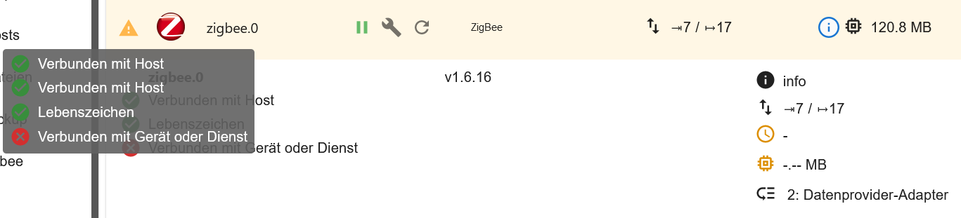

      bin mal auf debug gegangen..dann kommt das raus:
      zigbee.0
      	2022-05-28 21:29:09.255	info	Installed Version: iobroker.zigbee@1.6.16
      zigbee.0
      	2022-05-28 21:29:08.897	debug	Starting zigbee-herdsman...
      zigbee.0
      	2022-05-28 21:29:08.897	info	Starting Zigbee npm ...
      zigbee.0
      	2022-05-28 21:29:08.859	debug	Using zigbee-herdsman with settings: {"network":{"panID":6754,"extendedPanID":[221,221,221,221,221,221,221,221],"channelList":[11],"networkKey":[1,3,5,7,9,11,13,15,0,2,4,6,8,10,12,13]},"databasePath":"/opt/iobroker/iobroker-data/zigbee_0/shepherd.db","backupPath":"/opt/iobroker/iobroker-data/zigbee_0/nvbackup.json","serialPort":{"baudRate":115200,"rtscts":false,"path":"/dev/ttyZigbee","adapter":"zstack"},"adapter":{"forceStartWithInconsistentAdapterConfiguration":false}}
      zigbee.0
      	2022-05-28 21:29:08.824	info	starting. Version 1.6.16 in /opt/iobroker/node_modules/iobroker.zigbee, node: v14.19.1, js-controller: 4.0.23
      zigbee.0
      	2022-05-28 21:29:08.588	debug	Plugin sentry Initialize Plugin (enabled=true)

            getfacl /dev/ttyZigbee
            -bash: getfacl: command not found
            whats that !!!!
            jetzt gehts auf einmal wieder..nochmal neustart des containers gemacht ?????
            Kanns nicht nachvollziehen!!
            den befehl kann ich aber nicht ausführen Thomas
