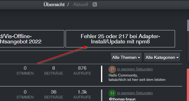

                                  • crunchip
                                    crunchip Forum Testing Most Active @headder9999 last edited by
                                    @headder9999 sagte in Fehler beim js-controller update:
                                    obroker.yamaha@0.5.3: 217
                                    H 1 Reply Last reply Reply Quote 0
                                    • H
                                      headder9999 @Thomas Braun last edited by
                                      @thomas-braun
                                      was heißt oben angepinnt?
                                      crunchip 1 Reply Last reply Reply Quote 0
                                      • crunchip
                                        • H
                                          headder9999 @crunchip last edited by
                                          @crunchip was heißt das nun für mich?
                                          • crunchip
                                            crunchip Forum Testing Most Active @headder9999 last edited by crunchip
                                            @headder9999 das machen was drin steht
                                            die Zeile ausführen
