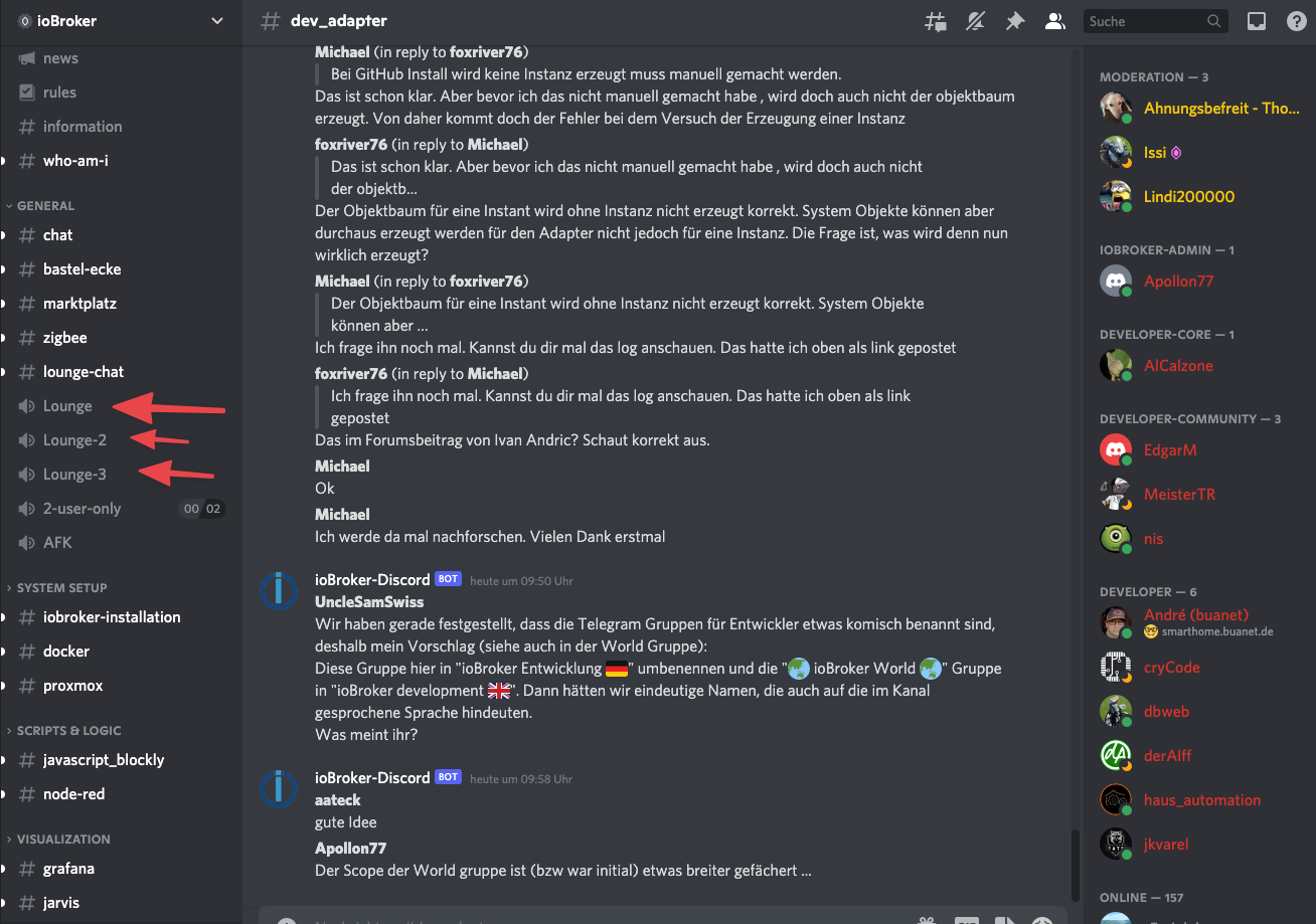

                                            Ben1983 @Issi last edited by
                                            @issi Wo muss ich da hin?
                                            Issi 1 Reply Last reply Reply Quote 0
