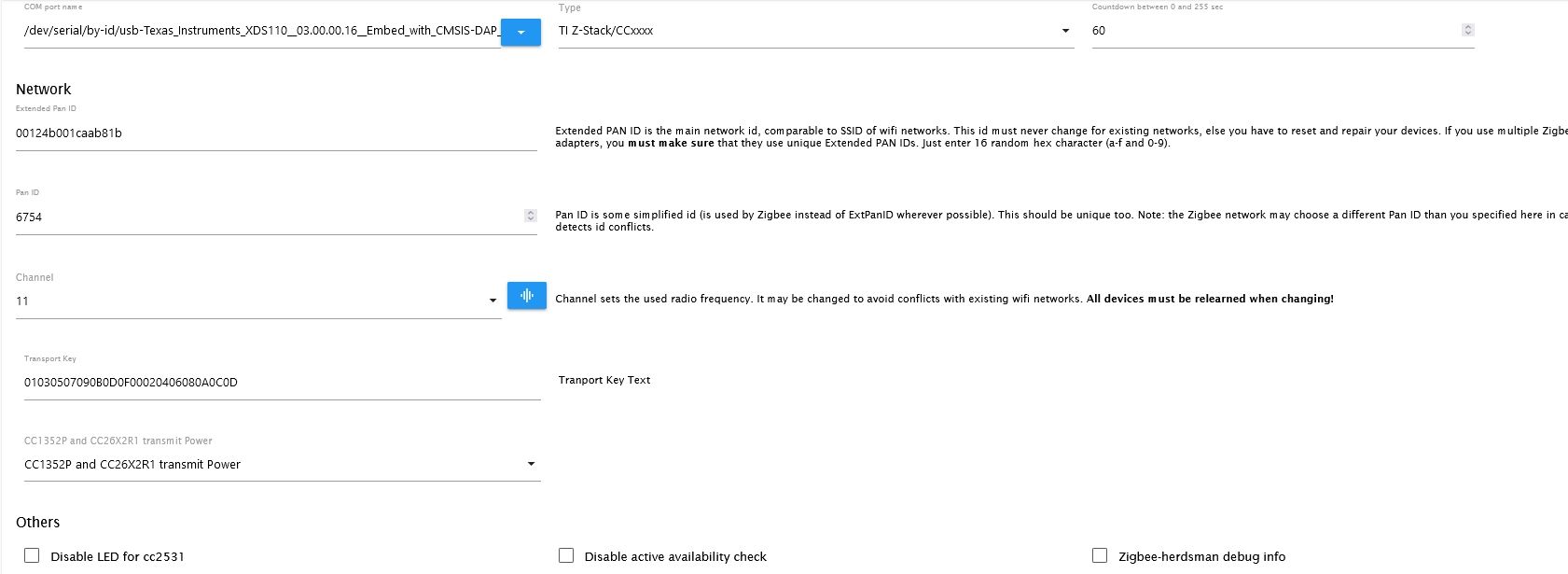

    Trage ich nun, wie in der bisherigen Installation (der Link zum CC26X2R1 wurde natürlich neu ausgelesen) die Daten ein startet die Instanz nicht mehr.
    zigbee.0	2021-08-19 16:02:00.762	error	Error herdsman start
    zigbee.0	2021-08-19 16:02:00.762	error	Failed to start Zigbee
    zigbee.0	2021-08-19 16:02:00.761	error	Starting zigbee-herdsman problem : "Error while opening serialport 'Error: Error Resource temporarily unavailable Cannot lock port'"
    zigbee.0	2021-08-19 16:01:50.492	error	Error herdsman start
    zigbee.0	2021-08-19 16:01:50.491	error	Failed to start Zigbee
    zigbee.0	2021-08-19 16:01:50.491	error	Starting zigbee-herdsman problem : "startup failed - configuration-adapter mismatch - see logs above for more information"
    zigbee.0	2021-08-19 16:01:50.490	error	Re-commissioning your network will require re-pairing of all devices!
    zigbee.0	2021-08-19 16:01:50.489	error	If you wish to re-commission your network, please remove coordinator backup at /opt/iobroker/iobroker-data/zigbee_0/nvbackup.json.
    zigbee.0	2021-08-19 16:01:50.489	error	Please update configuration to prevent further issues.
    zigbee.0	2021-08-19 16:01:50.488	error	- Channel List: configured=11, adapter=11
    zigbee.0	2021-08-19 16:01:50.488	error	- Network Key: configured=01030507090b0d0f00020404080a0a0d, adapter=01030507090b0d0f00020406080a0c0d
    zigbee.0	2021-08-19 16:01:50.487	error	- Extended PAN ID: configured=1bb8da1c004b1200, adapter=00124b001caab81b
    zigbee.0	2021-08-19 16:01:50.487	error	- PAN ID: configured=6755, adapter=6754
    zigbee.0	2021-08-19 16:01:50.486	error	Configuration is not consistent with adapter state/backup!
    zigbee.0	2021-08-19 15:54:55.258	error	Serial port not selected! Go to settings page.
    zigbee.0	2021-08-19 15:54:36.902	error	Serial port not selected! Go to settings page.
      Könnt ihr mir da bitte weiterhelfen?
      Vielen Dank und lG Stefan

      @stefan_nk sagte in Probleme mit Zigbee und CC26X2R1 nach Neuinstallation:
      Da steht doch die Lösung. Deine panID stimmt nicht,
      A.
        A.
        Stefan_NK
        schrieb am zuletzt editiert von Stefan_NK
        @asgothian Die ID habe ich schon geändert, leider hat das nicht wirklich etwas gebracht :-(
        2021-08-19 22:01:55.162 - info: zigbee.0 (2755) Try to reconnect. 1 attempts left
        2021-08-19 22:01:55.163 - info: zigbee.0 (2755) Starting Zigbee npm ...
        2021-08-19 22:01:55.189 - info: zigbee.0 (2755) Installed Version: iobroker.zigbee@1.5.6
        2021-08-19 22:01:55.415 - error: zigbee.0 (2755) Starting zigbee-herdsman problem : "Error while opening serialport 'Error: Error Resource temporarily unavailable Cannot lock port'"
        2021-08-19 22:01:55.416 - error: zigbee.0 (2755) Failed to start Zigbee
        2021-08-19 22:01:55.418 - error: zigbee.0 (2755) Error herdsman start
        2021-08-19 22:01:56.261 - info: host.SmartHome stopInstance system.adapter.zigbee.0 (force=false, process=true)
        2021-08-19 22:01:56.272 - info: zigbee.0 (2755) Got terminate signal TERMINATE_YOURSELF
        2021-08-19 22:01:56.272 - info: host.SmartHome stopInstance system.adapter.zigbee.0 send kill signal
        2021-08-19 22:01:56.276 - info: zigbee.0 (2755) cleaned everything up...
        2021-08-19 22:01:56.284 - info: zigbee.0 (2755) Zigbee: disabling joining new devices.
        2021-08-19 22:01:56.288 - warn: zigbee.0 (2755) Failed to stop zigbee during startup
        2021-08-19 22:01:56.290 - info: zigbee.0 (2755) terminating
        2021-08-19 22:01:56.292 - info: zigbee.0 (2755) Terminated (ADAPTER_REQUESTED_TERMINATION): Without reason
        2021-08-19 22:01:56.294 - error: zigbee.0 (2755) Unhandled promise rejection. This error originated either by throwing inside of an async function without a catch block, or by rejecting a promise which was not handled with .catch().
        2021-08-19 22:01:56.294 - error: zigbee.0 (2755) unhandled promise rejection: Cannot read property 'getEntries' of null
        2021-08-19 22:01:56.296 - error: zigbee.0 (2755) TypeError: Cannot read property 'getEntries' of null
        at Function.loadFromDatabaseIfNecessary (/opt/iobroker/node_modules/zigbee-herdsman/dist/controller/model/device.js:220:55)
        at Function.all (/opt/iobroker/node_modules/zigbee-herdsman/dist/controller/model/device.js:240:16)
        at Controller.getDevices (/opt/iobroker/node_modules/zigbee-herdsman/dist/controller/controller.js:303:31)
        at ZigbeeController.getClients (/opt/iobroker/node_modules/iobroker.zigbee/lib/zigbeecontroller.js:228:49)
        at DeviceAvailability.stop (/opt/iobroker/node_modules/iobroker.zigbee/lib/zbDeviceAvailability.js:222:43)
        at ZigbeeController.callExtensionMethod (/opt/iobroker/node_modules/iobroker.zigbee/lib/zigbeecontroller.js:214:42)
        at ZigbeeController.stop (/opt/iobroker/node_modules/iobroker.zigbee/lib/zigbeecontroller.js:385:20)
        at Zigbee.onUnload (/opt/iobroker/node_modules/iobroker.zigbee/main.js:696:41)
        at processTicksAndRejections (internal/process/task_queues.js:97:5)
        2021-08-19 22:01:56.297 - error: zigbee.0 (2755) Cannot read property 'getEntries' of null
        2021-08-19 22:01:56.866 - info: host.SmartHome instance system.adapter.zigbee.0 terminated with code 11 (ADAPTER_REQUESTED_TERMINATION)
        2021-08-19 22:01:59.315 - info: host.SmartHome instance system.adapter.zigbee.0 started with pid 2773
        2021-08-19 22:02:01.781 - info: zigbee.0 (2773) starting. Version 1.5.6 in /opt/iobroker/node_modules/iobroker.zigbee, node: v12.22.5, js-controller: 3.3.15
        2021-08-19 22:02:01.879 - info: zigbee.0 (2773) Starting Zigbee npm ...
        2021-08-19 22:02:02.168 - info: zigbee.0 (2773) Installed Version: iobroker.zigbee@1.5.6
        2021-08-19 22:02:03.958 - error: zigbee.0 (2773) Configuration is not consistent with adapter state/backup!
        2021-08-19 22:02:03.958 - error: zigbee.0 (2773) - PAN ID: configured=6755, adapter=6754
        2021-08-19 22:02:03.959 - error: zigbee.0 (2773) - Extended PAN ID: configured=1bb8ac1c004a1200, adapter=00124b001caab81b
        2021-08-19 22:02:03.960 - error: zigbee.0 (2773) - Network Key: configured=01030507090b0d0f0ff20406080a0c0d, adapter=01030507090b0d0f00020406080a0c0d
        2021-08-19 22:02:03.960 - error: zigbee.0 (2773) - Channel List: configured=11, adapter=11
        2021-08-19 22:02:03.961 - error: zigbee.0 (2773) Please update configuration to prevent further issues.

          arteckA Offline
          arteckA Offline
          arteck
          @stefan_nk lösche mal die nvbackup.json aus
          /opt/iobroker/iobroker-data/zugbee_0
          und starte adapter neu
          S 1 Antwort Letzte Antwort
          • arteckA arteck
            Stefan_NK
            @arteck Der Adapter ist jetzt grün, vielen Dank. Eine Warnung gibt es schon wieder wegen der PAN ID. Soll ich da was ändern? Werde am Wochenende dann mal die Sensoren anlernen.

                        @stefan_nk
                        Zeig mal die Einstellungen im entsprechenden Reiter des Adapters.
                        Stefan_NK
                        • S Stefan_NK

                              @stefan_nk
                              Hallo Stefan,
                              zwei Sachen sind mir aufgefallen.
                              Zum einen ist bei deiner Konfiguration keine Sendeleistung ausgewählt.
                              (Hat vermutlich nichts mit deinem aktuellen Problem zu tun, ist mir nur aufgefallen)
                              Was eher auf dein Problem mit dem Adapter zu tun haben könnte,
                              deine Firmeware des zigbee-sticks ist sehr neu
                              "revision":20210708
                              Vermutlich hat der zigbee-Adapter in der Version 1.5.6 damit Probleme.
                              Versuche den Adapter auf 1.6.0 zu aktuallisieren.

                                  Hallo Zusammen.... bin nun echt am Verzweifeln...
                                  Ich habe den kompletten Raspi nochmals neu installiert. Es ist nichts außer der aktuellen Version von Raspberry Pi OS Lite und dem aktuellen iobroker wie hier beschrieben installiert.
                                  Das Image des OS wurde auf den USB-Stick installiert, der in einem USB3 Anschluß steckt.
                                  Die cc26x2r1 wurde (mit verschiedenen Kabeln getestet) an einen USB2 Anschluß gesteckt. Genau die gleiche Konstellation war bisher in Verwendung und hat vor der Neuinstallation einwandfrei funktioniert.
                                  Aufgrund der Probleme habe ich lediglich die aktuelle FW des cc26x2r1 installiert
                                  Adapterseitig ist vom admin, backitup, discovery, javascript und zigbee jeweils eine Instanz installiert.
                                  Die zigbee-Adaptereinstellung wie folgt:
                                  COM-Anschlußname: /dev/serial/by-id/usb-Texas_Instruments_XDS110__03.00.00.16__Embed_with_CMSIS-DAP_L1100F8C-if00
                                  Tpy: TI Z-Stack&CCxxxx Timer: 60
                                  Erweiterte Pan ID: DDDDDDDDDDDDDDDD Pan ID: 6754
                                  Kanal 11
                                  Transportschlüssel: 01030507090B0D0F00020406080A0C0D
                                  Sendeleistung: high
                                  Ich bekomme den Adapter einfach nicht zum Laufen. Kann mir hier denn wirklich keiner helfen?

                                  @stefan_nk
                                  Ändere die.
                                    @stefan_nk
                                    Ändere die.
                                    Stefan_NK
                                    @thomas-braun
                                    Geändert in
                                    DCDDDDDADDDDDDDD
                                    leider kein Erfolg

                                    • S Stefan_NK
                                      @thomas-braun
                                      Geändert in
                                      DCDDDDDADDDDDDDD
                                      leider kein Erfolg

                                          @stefan_nk
                                          PAN ID: configured=6754, adapter=6754
                                          2021-08-22 23:40:14.466 - error: zigbee.0 (1986) - Extended PAN ID: configured=dddddddddadddddc, adapter=00124b001caab81b
                                          Richtige IDs eintragen
