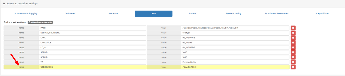

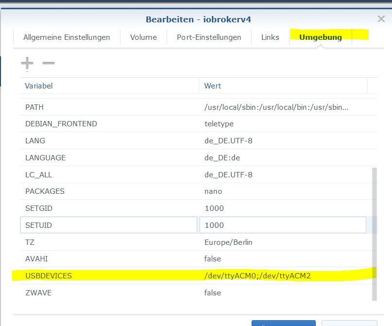

                      @glasfaser Ne, ich laufe noch auf DSM 6.2.4-25556
                      Den Stick hatte ich bisher tatsächlich nie als variable mit durchgereicht. Habe es jetzt mal gemacht, leider auch kein Erfolg

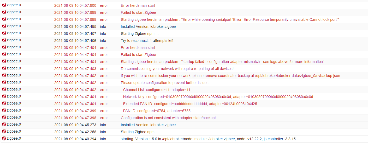

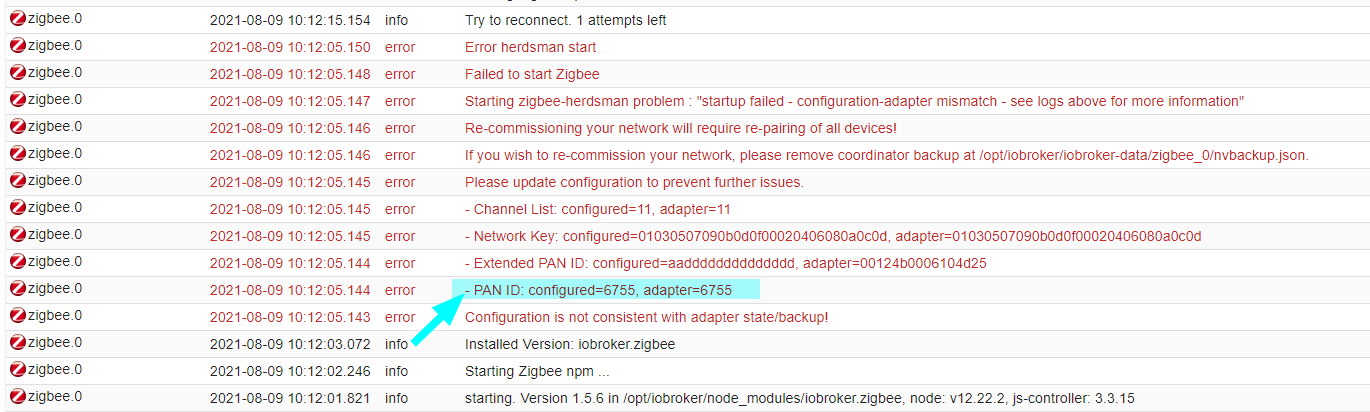

                          A Offline
                          A Offline
                          Asatru
                          @glasfaser zumindest die Fehlermeldung hat sich geändert ;)
                          zigbee.0 2021-08-09 08:58:40.912	error	Error herdsman start
                          zigbee.0 2021-08-09 08:58:40.912	error	Failed to start Zigbee
                          zigbee.0 2021-08-09 08:58:40.911	error	Starting zigbee-herdsman problem : "Error while opening serialport 'Error: Error Resource temporarily unavailable Cannot lock port'"
                          zigbee.0 2021-08-09 08:58:40.637	info	Installed Version: iobroker.zigbee
                          zigbee.0 2021-08-09 08:58:40.621	info	Starting Zigbee npm ...
                          zigbee.0 2021-08-09 08:58:40.620	info	Try to reconnect. 1 attempts left
                          zigbee.0 2021-08-09 08:58:30.618	error	Error herdsman start
                          zigbee.0 2021-08-09 08:58:30.616	error	Failed to start Zigbee
                          zigbee.0 2021-08-09 08:58:30.614	error	Starting zigbee-herdsman problem : "startup failed - configuration-adapter mismatch - see logs above for more information"
                          zigbee.0 2021-08-09 08:58:30.613	error	Re-commissioning your network will require re-pairing of all devices!
                          zigbee.0 2021-08-09 08:58:30.613	error	If you wish to re-commission your network, please remove coordinator backup at /opt/iobroker/iobroker-data/zigbee_0/nvbackup.json.
                          zigbee.0 2021-08-09 08:58:30.612	error	Please update configuration to prevent further issues.
                          zigbee.0 2021-08-09 08:58:30.612	error	- Channel List: configured=11, adapter=11
                          zigbee.0 2021-08-09 08:58:30.611	error	- Network Key: configured=01030507090b0d0f00020406080a0c0d, adapter=01030507090b0d0f00020406080a0c0d
                          zigbee.0 2021-08-09 08:58:30.610	error	- Extended PAN ID: configured=aadddddddddddddd, adapter=00124b0006104d25
                          zigbee.0 2021-08-09 08:58:30.610	error	- PAN ID: configured=6754, adapter=6755
                          zigbee.0 2021-08-09 08:58:30.608	error	Configuration is not consistent with adapter state/backup!
                          zigbee.0 2021-08-09 08:58:28.701	info	Installed Version: iobroker.zigbee
                          zigbee.0 2021-08-09 08:58:27.859	info	Starting Zigbee npm ...
                          zigbee.0 2021-08-09 08:58:27.518	info	starting. Version 1.5.6 in /opt/iobroker/node_modules/iobroker.zigbee, node: v12.22.2, js-controller: 3.3.15
                          zigbee.0 2021-08-09 08:58:15.118	error	Cannot read property 'getEntries' of null
                          zigbee.0 2021-08-09 08:58:15.118	error	TypeError: Cannot read property 'getEntries' of null at Function.loadFromDatabaseIfNecessary (/opt/iobroker/node_modules/iobroker.zigbee/node_modules/zigbee-herdsman/dist/controller/model/device.js:220:55) at Function.all (/opt/iobroker/node_modules/iobroker.zigbee/node_modules/zigbee-herdsman/dist/controller/model/device.js:240:16) at Controller.getDevices (/opt/iobroker/node_modules/iobroker.zigbee/node_modules/zigbee-herdsman/dist/controller/controller.js:303:31) at ZigbeeController.getClients (/opt/iobroker/node_modules/iobroker.zigbee/lib/zigbeecontroller.js:228:49) at DeviceAvailability.stop (/opt/iobroker/node_modules/iobroker.zigbee/lib/zbDeviceAvailability.js:222:43) at ZigbeeController.callExtensionMethod (/opt/iobroker/node_modules/iobroker.zigbee/lib/zigbeecontroller.js:214:42) at ZigbeeController.stop (/opt/iobroker/node_modules/iobroker.zigbee/lib/zigbeecontroller.js:385:20) at Zigbee.onUnload (/opt/iobroker/node_modules/iobroker.zigbee/main.js:696:41) at processTicksAndRejections (internal/process/task_queues.js:97:5)
                          zigbee.0 2021-08-09 08:58:15.117	error	unhandled promise rejection: Cannot read property 'getEntries' of null
                          zigbee.0 2021-08-09 08:58:15.116	error	Unhandled promise rejection. This error originated either by throwing inside of an async function without a catch block, or by rejecting a promise which was not handled with .catch().
                          zigbee.0 2021-08-09 08:58:15.115	info	Terminated (ADAPTER_REQUESTED_TERMINATION): Without reason
                          zigbee.0 2021-08-09 08:58:15.114	info	terminating
                          zigbee.0 2021-08-09 08:58:15.113	warn	Failed to stop zigbee during startup
                          zigbee.0 2021-08-09 08:58:15.112	info	Zigbee: disabling joining new devices.
                          zigbee.0 2021-08-09 08:58:15.109	info	cleaned everything up...
                          zigbee.0 2021-08-09 08:58:15.106	info	Got terminate signal TERMINATE_YOURSELF

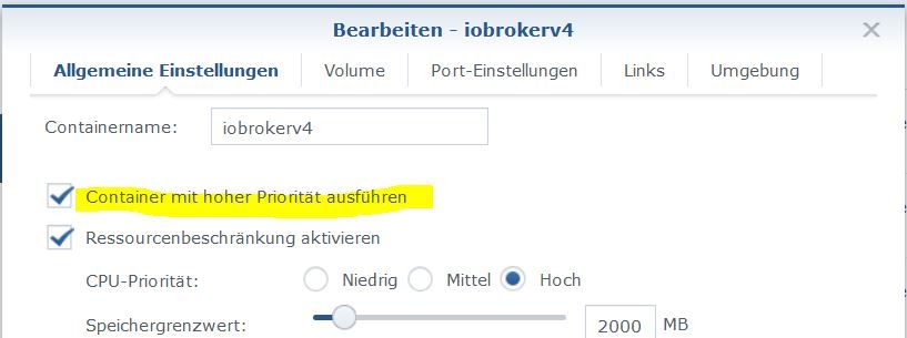

                                Hast du vorher schon mit Rechten im Container gearbeitet/gesetzt ?
                                Hast du hier den Haken :
                                A 1 Antwort Letzte Antwort
                                • GlasfaserG Glasfaser
                                  @asatru
                                  Was mich Wundert , das es ohne die Eintragung /dev/ttyACM0 in der Umgebung im Docker bei dir lief !?
                                  A Offline
                                  A Offline
                                  Asatru
                                  @glasfaser Ja, der Container läuft mit erhöhten Rechten. Ich verwende Portainer, da scheint es irgendwie ein Problem mit den ENV's zu geben. Ich schaue mal, ob es vielleicht doch daran liegt (Auch, wenn ich das vorher nie eingetragen hatte)

                                    Hast du den Stick richtig durchgereicht in der Umgebung .
                                    Du schreibst auch von Updates , hast du eventuell DSM 7 drauf ?
                                    A Offline
                                    A Offline
                                    Asatru
                                    @glasfaser hab die ENV variable jetzt über Docker in DSM gesetzt, so funktioniert es. Die Fehlermeldung bleibt leider die gleiche
                                    • A Asatru
                                      @asatru
                                      PAN-Id im Adapter angepasst?
                                        @asatru
                                        A Offline
                                        A Offline
                                        Asatru
                                        @thomas-braun Habe ich jetzt zum testen auch mal auf die im Log genannte angepasst, leider ebenfalls der gleiche Fehler (nur mit angepasster PAN ID)
                                        • A Asatru
                                          @asatru
                                          Die extended PAN-Id auch anpassen.
