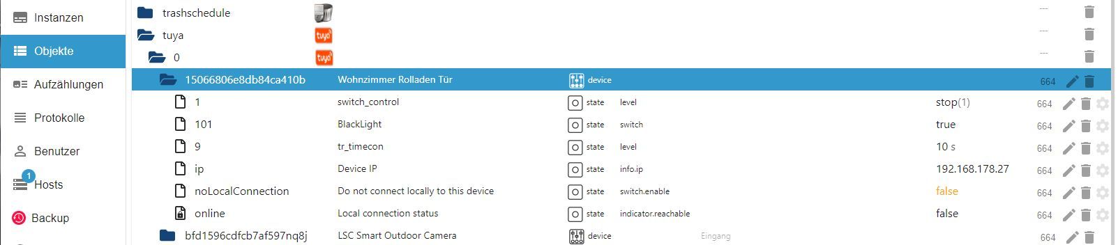

                                        wrote on last edited by
                                        #33
                                        1 Reply Last reply
