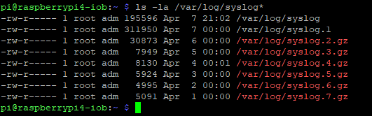

            crunchip

            • crunchipC crunchip
