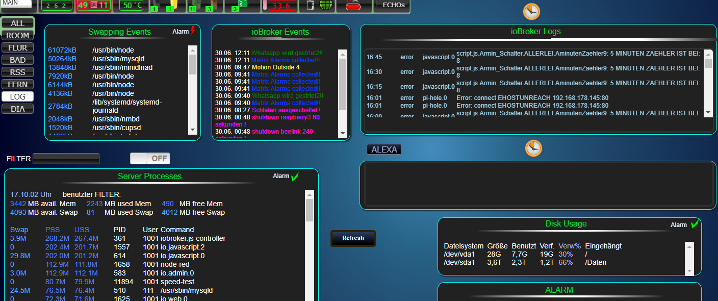

        (für mich) einfacher als in der vis alles wichtiges zu sehen , was meinem iobroker angeht (auch im bezug zu überblick verschaffen, wenn nicht daheim und nur handy vorhanden) war mein hintergedanke - habe ein tablet mit vis im flur stehen - kurzer blick darauf - kein rechner einschalten oder sowas
        letztlich kann man auch die angebotenen datenpunkte durch scripten so auswerten, das man sich mails oder telegram sendet

            @liv-in-sky Mit welchem Widget lasst du denn die json-Daten unter VIS anzeigen?
              liv-in-skyL Offline
              liv-in-skyL Offline
              liv-in-sky
              @Dr-Bakterius
              json-table
              [{"tpl":"tplTableBody","data":{"g_fixed":true,"g_visibility":false,"g_css_font_text":true,"g_css_background":true,"g_css_shadow_padding":true,"g_css_border":true,"g_gestures":false,"g_signals":false,"visibility-cond":"==","visibility-val":1,"visibility-groups-action":"hide","static_value":"","signals-cond-0":"==","signals-val-0":true,"signals-icon-0":"/vis.0/VIS/lowbattery.png","signals-icon-size-0":0,"signals-blink-0":false,"signals-horz-0":0,"signals-vert-0":0,"signals-hide-edit-0":false,"signals-cond-1":"==","signals-val-1":true,"signals-icon-1":"/vis.0/VIS/lowbattery.png","signals-icon-size-1":0,"signals-blink-1":false,"signals-horz-1":0,"signals-vert-1":0,"signals-hide-edit-1":false,"signals-cond-2":"==","signals-val-2":true,"signals-icon-2":"/vis.0/VIS/lowbattery.png","signals-icon-size-2":0,"signals-blink-2":false,"signals-horz-2":0,"signals-vert-2":0,"signals-hide-edit-2":false,"table_oid":"javascript.2.mylog.logErrorJSON","colName1":"Uhrzeit","colWidth1":"80px","colCount":"4","colWidth2":"50px","colWidth3":"50px","colWidth4":"580px","colWidth5":"40px","colWidth6":"40px","colName2":"Log-Eintrag","class":"mdui-table","show_scroll":true,"hide_header":true,"g_last_change":false,"lc-type":"last-change","lc-is-interval":true,"lc-is-moment":false,"lc-format":"","lc-position-vert":"top","lc-position-horz":"right","lc-offset-vert":0,"lc-offset-horz":0,"lc-font-size":"12px","lc-font-family":"","lc-font-style":"","lc-bkg-color":"","lc-color":"","lc-border-width":"0","lc-border-style":"","lc-border-color":"","lc-border-radius":10,"lc-zindex":0,"new_on_top":true,"max_rows":"2000","detailed_wid":"w00377","name":"System_Logs"},"style":{"left":"811px","top":"123px","width":"772px","height":"181px","text-align":"left","color":"#a5d5ee","background-color":"","font-family":"Arial, Helvetica, sans-serif","z-index":"20","background":"","box-shadow":"","border-radius":"10px","font-size":"14px","border-style":"solid","border-color":"#303030"},"widgetSet":"basic"}]

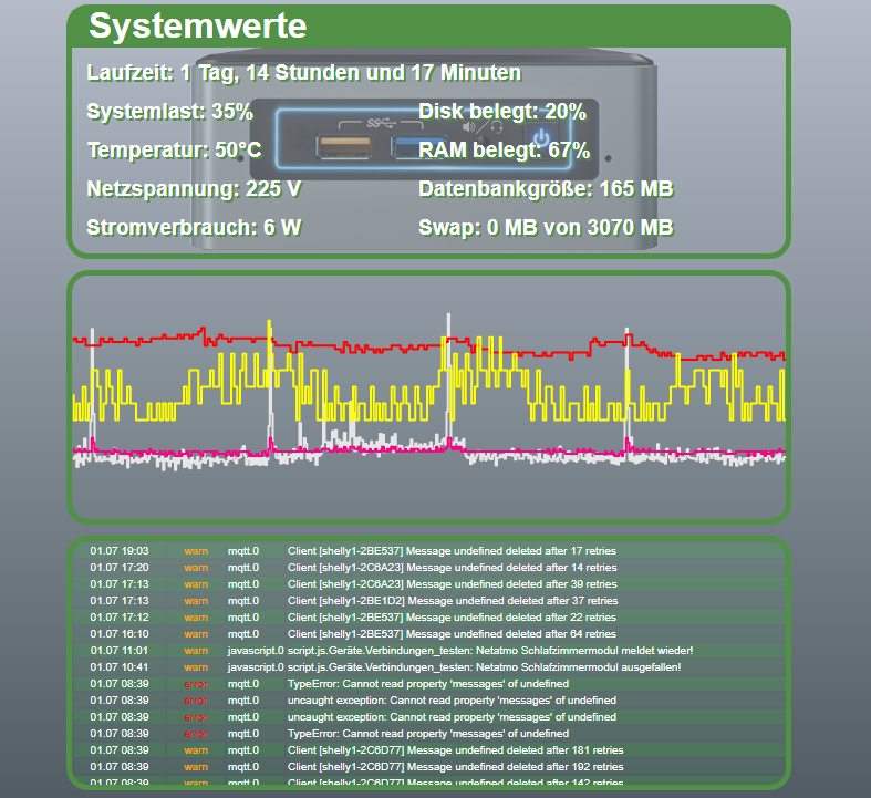

                  Ich bin zwar immer noch der Meinung, dass die Error-Meldung in diesem Fall ungerechtfertigt ist und es vielleicht überhaupt praktisch wäre Filter einrichten zu können, doch habe ich das Log nun doch in meine VIS-Oberfläche bei den Systemwerten integriert:

                    @Dr-Bakterius
                    wenn das nicht klasse und prof. aussieht !
