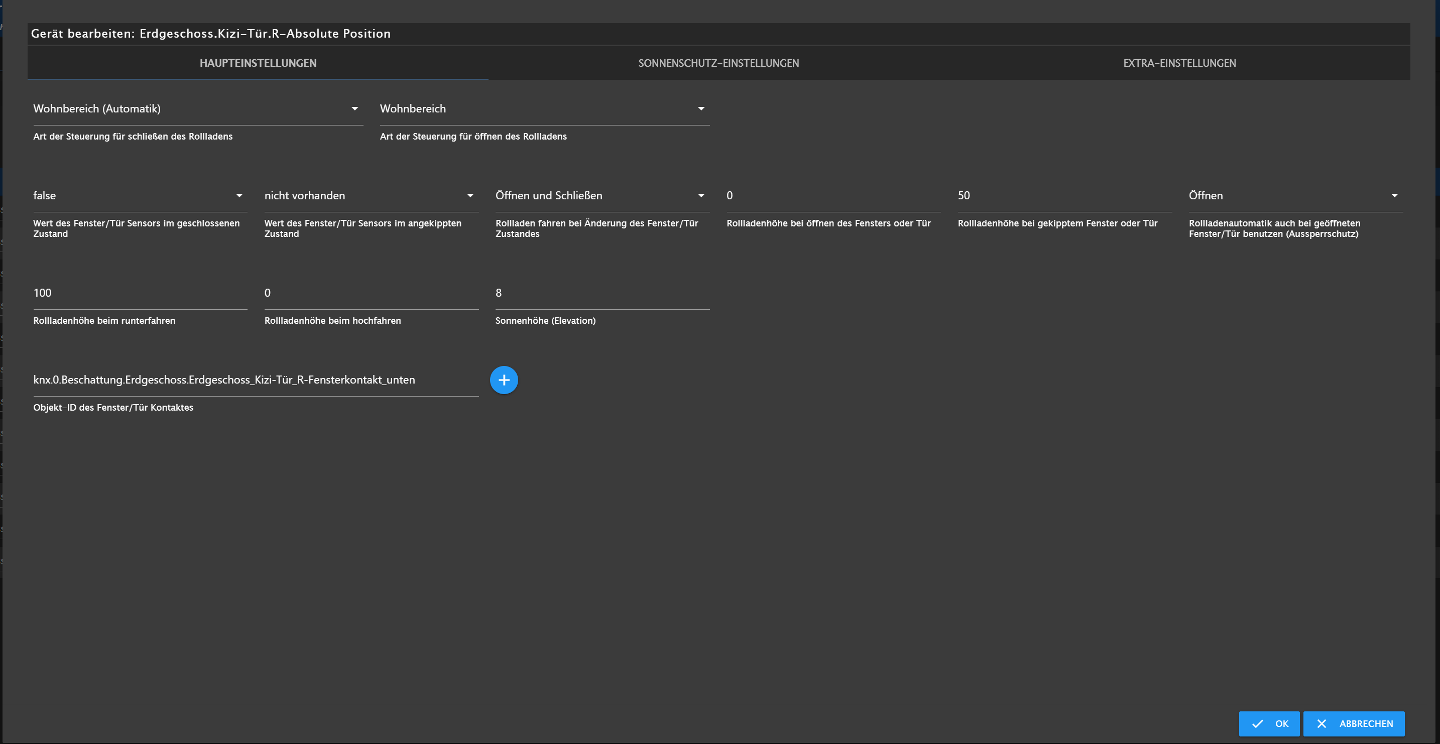

                        @homoran So, zurück zum Test. Die Jalousien Wohnzimmer Tür zur Terrasse und Schlafzimmer sind nicht herunter gefahren, obwohl kein Licht mehr ist:
                        shuttercontrol.0"	2024-08-09 21:40:27.473	debug	outsidetemperature changed: 0_userdata.0.Temperatur.Vorhersage_mit_Offset | Value: 22.4°C
                        shuttercontrol.2"	2024-08-09 21:40:27.473	debug	outsidetemperature changed: 0_userdata.0.Temperatur.Vorhersage_mit_Offset | Value: 22.4°C
                        shuttercontrol.2"	2024-08-09 21:40:00.004	debug	Sun Elevation: -8.3°
                        shuttercontrol.2"	2024-08-09 21:40:00.004	debug	Sun Azimut: 308.1°
                        shuttercontrol.2"	2024-08-09 21:40:00.004	debug	calculate astrodata ...
                        shuttercontrol.0"	2024-08-09 21:40:00.002	debug	Sun Elevation: -8.3°
                        shuttercontrol.0"	2024-08-09 21:40:00.002	debug	Sun Azimut: 308.1°
                        shuttercontrol.0"	2024-08-09 21:40:00.002	debug	calculate astrodata ...
                        shuttercontrol.2"	2024-08-09 21:38:23.296	debug	Brightness State Down is: true
                        shuttercontrol.0"	2024-08-09 21:38:23.296	debug	Brightness State Down is: true
                        shuttercontrol.0"	2024-08-09 21:38:13.296	debug	Brightness sensor value: 0
                        shuttercontrol.2"	2024-08-09 21:38:13.296	debug	Brightness sensor value: 0
                        shuttercontrol.0"	2024-08-09 21:36:53.705	debug	Lightsensor changed: 0_userdata.0.Helligkeit.Maximalwert_aus_allen_Sensoren | Value: 2.999853181190793lux
                        shuttercontrol.0"	2024-08-09 21:36:53.705	debug	Brightness State Down is: true
                        shuttercontrol.2"	2024-08-09 21:36:53.705	debug	Lightsensor changed: 0_userdata.0.Helligkeit.Maximalwert_aus_allen_Sensoren | Value: 2.999853181190793lux
                        shuttercontrol.2"	2024-08-09 21:36:53.705	debug	Brightness State Down is: true
                        shuttercontrol.2"	2024-08-09 21:36:43.706	debug	Brightness sensor value: 2.999853181190793
                        shuttercontrol.0"	2024-08-09 21:36:43.705	debug	Brightness sensor value: 2.999853181190793
                        shuttercontrol.0"	2024-08-09 21:35:00.006	debug	Sun Elevation: -7.7°
                        shuttercontrol.0"	2024-08-09 21:35:00.006	debug	Sun Azimut: 307.1°
                        shuttercontrol.0"	2024-08-09 21:35:00.006	debug	calculate astrodata ...
                        shuttercontrol.2"	2024-08-09 21:35:00.004	debug	Sun Elevation: -7.7°
                        shuttercontrol.2"	2024-08-09 21:35:00.004	debug	Sun Azimut: 307.1°
                        shuttercontrol.2"	2024-08-09 21:35:00.004	debug	calculate astrodata ...
                        shuttercontrol.2"	2024-08-09 21:30:33.803	debug	outsidetemperature changed: 0_userdata.0.Temperatur.Vorhersage_mit_Offset | Value: 22.7°C
                        shuttercontrol.0"	2024-08-09 21:30:33.803	debug	outsidetemperature changed: 0_userdata.0.Temperatur.Vorhersage_mit_Offset | Value: 22.7°C
                        shuttercontrol.0"	2024-08-09 21:30:00.012	debug	Sun Elevation: -7°
                        shuttercontrol.0"	2024-08-09 21:30:00.011	debug	Sun Azimut: 306°
                        shuttercontrol.0"	2024-08-09 21:30:00.011	debug	calculate astrodata ...
                        shuttercontrol.2"	2024-08-09 21:30:00.003	debug	Sun Elevation: -7°
                        shuttercontrol.2"	2024-08-09 21:30:00.003	debug	Sun Azimut: 306°
                        shuttercontrol.2"	2024-08-09 21:30:00.003	debug	calculate astrodata ...
                        shuttercontrol.2"	2024-08-09 21:28:33.628	debug	save back trigger action: up for device Wohnzimmer Tür zur Terrasse
                        shuttercontrol.2"	2024-08-09 21:28:33.628	debug	#1 shutter trigger released Wohnzimmer Tür zur Terrasse already in place: 100%
                        shuttercontrol.2"	2024-08-09 21:28:33.561	debug	Wohnzimmer Tür zur Terrasse - shutter trigger Change is: upDown
                        shuttercontrol.2"	2024-08-09 21:28:33.561	debug	Wohnzimmer Tür zur Terrasse - shutter trigger Action is: up
                        shuttercontrol.2"	2024-08-09 21:28:33.561	debug	Wohnzimmer Tür zur Terrasse - shutter trigger Height is: 100%
                        shuttercontrol.2"	2024-08-09 21:28:33.561	debug	Wohnzimmer Tür zur Terrasse - shutter current Height is: 100%
                        shuttercontrol.2"	2024-08-09 21:28:33.561	debug	Wohnzimmer Tür zur Terrasse - shutter current state.val is: 100%
                        shuttercontrol.2"	2024-08-09 21:28:33.513	debug	Wohnzimmer Tür zur Terrasse - shutter conversion is: false
                        shuttercontrol.2"	2024-08-09 21:28:33.502	debug	TriggerID changed: 0_userdata.0.Fenster.Wohnzimmer.Tür_zur_Terrasse.Kombination_der_Kontaktsensoren | Value: false
                        shuttercontrol.0"	2024-08-09 21:28:06.246	debug	Brightness State Down is: true
                        shuttercontrol.2"	2024-08-09 21:28:06.246	debug	Brightness State Down is: true
                        shuttercontrol.0"	2024-08-09 21:27:56.246	debug	Brightness sensor value: 0
                        shuttercontrol.2"	2024-08-09 21:27:56.246	debug	Brightness sensor value: 0
                        shuttercontrol.0"	2024-08-09 21:26:41.824	debug	Brightness State Down is: true
                        shuttercontrol.2"	2024-08-09 21:26:41.823	debug	Brightness State Down is: true
                        shuttercontrol.2"	2024-08-09 21:26:31.823	debug	Brightness sensor value: 2.999853181190793
                        shuttercontrol.0"	2024-08-09 21:26:31.823	debug	Brightness sensor value: 2.999853181190793
                        shuttercontrol.0"	2024-08-09 21:26:26.742	debug	Lightsensor changed: 0_userdata.0.Helligkeit.Maximalwert_aus_allen_Sensoren | Value: 1.9998618696327441lux
                        shuttercontrol.0"	2024-08-09 21:26:26.742	debug	Brightness State Down is: true
                        shuttercontrol.2"	2024-08-09 21:26:26.742	debug	Lightsensor changed: 0_userdata.0.Helligkeit.Maximalwert_aus_allen_Sensoren | Value: 1.9998618696327441lux
                        shuttercontrol.2"	2024-08-09 21:26:26.742	debug	Brightness State Down is: true
                        shuttercontrol.0"	2024-08-09 21:26:16.741	debug	Brightness sensor value: 1.9998618696327441
                        shuttercontrol.2"	2024-08-09 21:26:16.741	debug	Brightness sensor value: 1.9998618696327441
                        shuttercontrol.2"	2024-08-09 21:25:32.727	debug	#2 save trigger height: 100% for device: Wohnzimmer Tür zur Terrasse
                        shuttercontrol.2"	2024-08-09 21:25:32.727	debug	#2 save trigger action: up for device: Wohnzimmer Tür zur Terrasse
                        shuttercontrol.2"	2024-08-09 21:25:32.727	debug	Wohnzimmer Tür zur Terrasse - shutter trigger change is: upDown
                        shuttercontrol.2"	2024-08-09 21:25:32.726	debug	Wohnzimmer Tür zur Terrasse - shutter trigger drive-up is: 100%
                        shuttercontrol.2"	2024-08-09 21:25:32.726	debug	Wohnzimmer Tür zur Terrasse - shutter current state.val is: 100%
                        shuttercontrol.2"	2024-08-09 21:25:32.685	debug	Wohnzimmer Tür zur Terrasse - shutter conversion is: false
                        shuttercontrol.2"	2024-08-09 21:25:32.684	debug	TriggerID changed: 0_userdata.0.Fenster.Wohnzimmer.Tür_zur_Terrasse.Kombination_der_Kontaktsensoren | Value: true
                        shuttercontrol.2"	2024-08-09 21:25:32.585	debug	save back trigger action: up for device Wohnzimmer Tür zur Terrasse
                        shuttercontrol.2"	2024-08-09 21:25:32.585	debug	#1 shutter trigger released Wohnzimmer Tür zur Terrasse already in place: 100%
                        shuttercontrol.2"	2024-08-09 21:25:32.541	debug	Wohnzimmer Tür zur Terrasse - shutter trigger Change is: upDown
                        shuttercontrol.2"	2024-08-09 21:25:32.541	debug	Wohnzimmer Tür zur Terrasse - shutter trigger Action is: up
                        shuttercontrol.2"	2024-08-09 21:25:32.541	debug	Wohnzimmer Tür zur Terrasse - shutter trigger Height is: 100%
                        shuttercontrol.2"	2024-08-09 21:25:32.541	debug	Wohnzimmer Tür zur Terrasse - shutter current Height is: 100%
                        shuttercontrol.2"	2024-08-09 21:25:32.541	debug	Wohnzimmer Tür zur Terrasse - shutter current state.val is: 100%
                        shuttercontrol.2"	2024-08-09 21:25:32.499	debug	Wohnzimmer Tür zur Terrasse - shutter conversion is: false
                        shuttercontrol.2"	2024-08-09 21:25:32.498	debug	TriggerID changed: 0_userdata.0.Fenster.Wohnzimmer.Tür_zur_Terrasse.Kombination_der_Kontaktsensoren | Value: false
                        shuttercontrol.0"	2024-08-09 21:25:00.005	debug	Sun Elevation: -6.4°
                        shuttercontrol.0"	2024-08-09 21:25:00.001	debug	Sun Azimut: 305°
                        shuttercontrol.2"	2024-08-09 21:25:00.001	debug	Sun Elevation: -6.4°
                        shuttercontrol.2"	2024-08-09 21:25:00.001	debug	Sun Azimut: 305°
                        shuttercontrol.0"	2024-08-09 21:25:00.001	debug	calculate astrodata ...
                        shuttercontrol.2"	2024-08-09 21:25:00.001	debug	calculate astrodata ...

                                        • NegaleinN Negalein
                                          @simatec
                                          Hallo
                                          Ist folgendes Szenario möglich?
                                          • Rollo runter (Sonnenschutz) bei Aussentemperatur 25 °C (das funktioniert perfekt)
                                          • Rollo hoch (raus aus Sonnenschutz) bei Elevation 2° (das funktioniert auch)
                                          • Rollo ganz zu nach 30 Minuten nach Sonnenuntergang (oder 30 Minuten nach 2° Elevation) --> gewünscht
                                          Um 19:52:03.539 ist er heute aus dem Sonnenschutz gefahren (denke wegen Elevation 2°).
                                          Um 20:15:00.053 hat er dann das Rollo komplett geschlossen (Elevation Down #3 Set ID: Wintergarten.LEVEL value: 0%)

                                          G Offline
                                          G Offline
                                          guitardoc
                                          schrieb am zuletzt editiert von guitardoc
                                          #6860
                                          @simatec Hier ist wieder der Fehler wie gestern. Wohnzimmer Tür zur Terrasse stand die ganze Zeit auf, jetzt ist es stockdunkel, ich mache die Tür zu, und die Jalousie sollte eigentlich runterfahren. Macht sie aber nicht...
