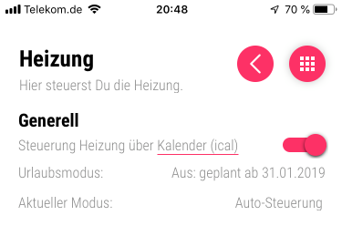

              Noch ein weiteres Feedback zu meinen Tests bezüglich Urlaub und zwischenzeitlicher Anwesenheit:
              Ich arbeite nun auch mit ical für die Urlaubsplanung (Urlaub_Abwesend). Hier wollte ich, dass im VIS angezeigt wird, ab wann, oder bis wann Urlaub_Abwesend geplant ist. Habe hierzu folgendes gemacht:
              1. Separate Instanz ical Adapter, damit keine anderen Termine angezeigt werden
              2. Folgendes Widget hinzugefügt:
              [{"tpl":"tplValueListHtml8","data":{"oid":"javascript.1.Heizung.Heizplan.GlobaleParameter.Urlaub_Abwesend","count":"1","value0":"Aus: geplant ab {ical.1.data.html}","value1":"An: bis {ical.1.data.html}","style0":"","style1":"color: #FD3166;","test_list":"0","name":"","value2":"auf","style2":"color: red","html_prepend":"","g_visibility":true,"visibility-cond":"==","visibility-val":"true","visibility-groups-action":"hide","g_last_change":false,"lc-type":"last-change","lc-is-interval":true,"lc-is-moment":false,"lc-format":"","lc-position-vert":"top","lc-position-horz":"right","lc-offset-vert":0,"lc-offset-horz":0,"lc-font-size":"12px","lc-font-family":"","lc-font-style":"","lc-bkg-color":"","lc-color":"","lc-border-width":"0","lc-border-style":"","lc-border-color":"","lc-border-radius":10,"lc-zindex":0,"g_signals":false,"signals-cond-0":"==","signals-val-0":true,"signals-icon-0":"/vis/signals/lowbattery.png","signals-icon-size-0":0,"signals-blink-0":false,"signals-horz-0":0,"signals-vert-0":0,"signals-hide-edit-0":false,"signals-cond-1":"==","signals-val-1":true,"signals-icon-1":"/vis/signals/lowbattery.png","signals-icon-size-1":0,"signals-blink-1":false,"signals-horz-1":0,"signals-vert-1":0,"signals-hide-edit-1":false,"signals-cond-2":"==","signals-val-2":true,"signals-icon-2":"/vis/signals/lowbattery.png","signals-icon-size-2":0,"signals-blink-2":false,"signals-horz-2":0,"signals-vert-2":0,"signals-hide-edit-2":false,"g_gestures":false,"g_css_shadow_padding":false,"g_css_border":false,"g_css_background":false,"visibility-oid":"javascript.1.Heizung.Heizplan.GlobaleParameter.ICAL-Events_Aktiv"},"style":{"left":"139px","top":"160px","z-index":"25","color":"","text-align":"right","width":"218px","height":"22px","line-height":"","font-size":"","font-weight":"normal","font-family":"","text-shadow":""},"widgetSet":"basic"}]
              Ergebnis - siehe Zeile "Urlaubsmodus" in den Screenshots:
              1.) Urlaub beginnt ab 31.01.2019:
               ![6940_ip_hz2.png](/assets/uploads/files/6940_ip_hz2.png)
              2.) Urlaub Abwesend ist aktuell im Kalender, geplant bis 29.01.2019:
               ![6940_ip3.jpg](/assets/uploads/files/6940_ip3.jpg)
              (Danke an @Hiltex - [https://forum.iobroker.net/viewtopic.php?f=30&t=20692](https://forum.iobroker.net/viewtopic.php?f=30&t=20692))
