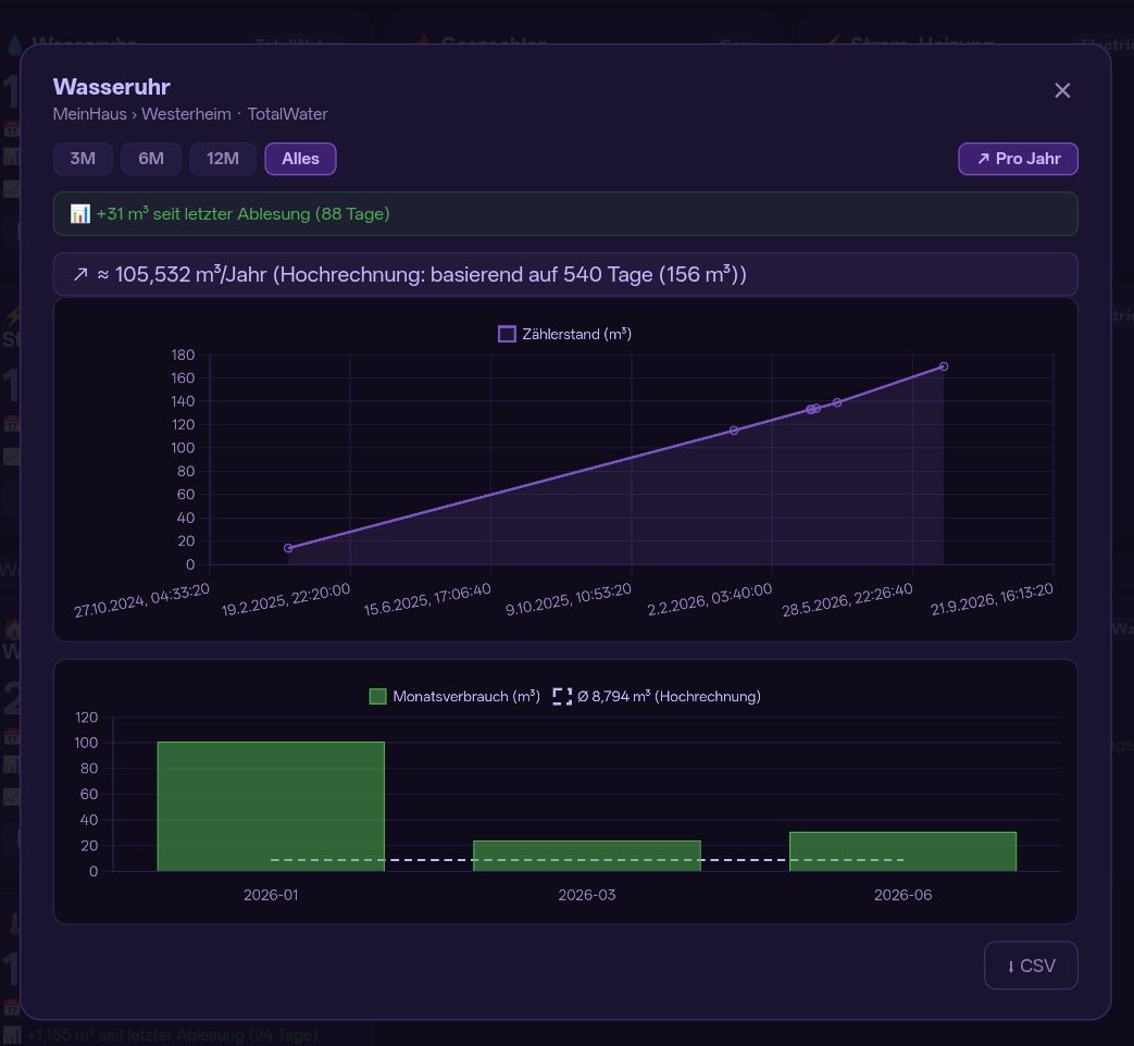

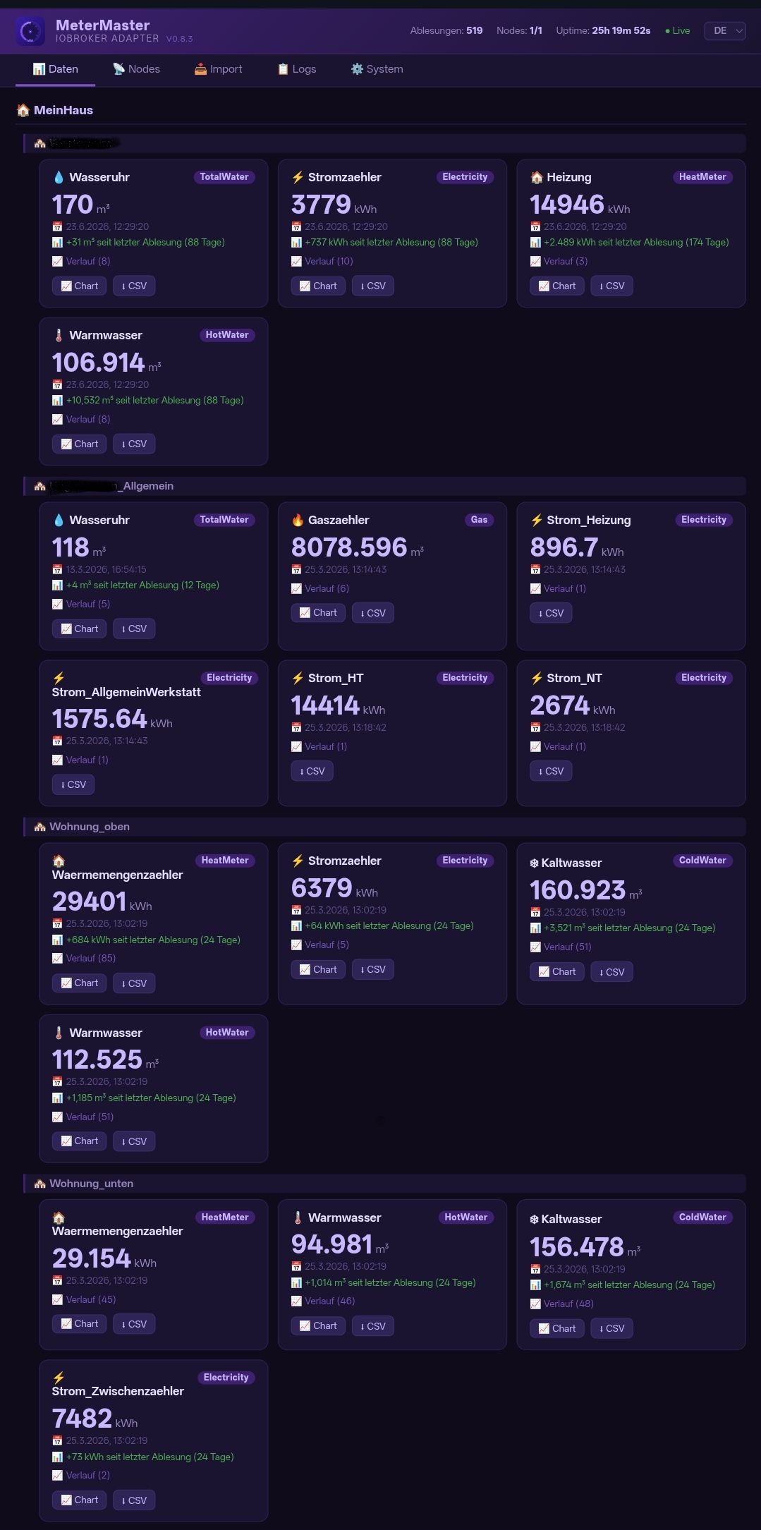

    • Eigene Web-UI unter http://<ioBroker-IP>:8089/ mit 5 Tabs:
      📊 Daten — Zählerkarten mit Verbrauchs-KPI, Verlauf, Chart & CSV-Export
      📈 Charts — Zählerstand (lineare Zeitachse) + Monatsverbrauch, optional Jahresverbrauch-Hochrechnung
      📡 Nodes — ESP32-OLED-Displays als Zähler-Anzeige
      📥 Import — App-Backup (JSON) per Drag & Drop
      ⚙️ System — Statistiken, GitHub-Versionscheck, Ein-Klick-Update

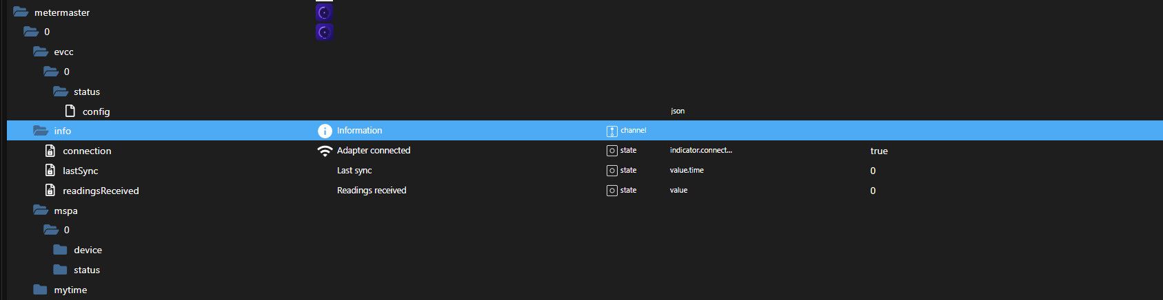

                  da musst du aber noch dran..
                  host.slave01 2026-08-02 12:09:09.861	info	instance system.adapter.metermaster.0 in version "0.9.3" (non-npm: MPunktBPunkt/iobroker.metermaster#9e3b3b780853c1115040c05a25017c18923174f9) started with pid 543723
                  metermaster.0 2026-08-02 12:09:14.238	warn	Object metermaster.0.mspa.0.device.wifiVersion is invalid: obj.type has to exist This will throw an error up from js-controller version 7.0.0!
                  metermaster.0 2026-08-02 12:09:14.257	warn	Object metermaster.0.mspa.0.device.mcuVersion is invalid: obj.type has to exist This will throw an error up from js-controller version 7.0.0!
                  metermaster.0 2026-08-02 12:09:14.270	warn	Object metermaster.0.mspa.0.status.trd_version is invalid: obj.type has to exist This will throw an error up from js-controller version 7.0.0!
                  metermaster.0 2026-08-02 12:09:14.278	warn	Object metermaster.0.mytime.0.Countdowns.kino.config is invalid: obj.type has to exist This will throw an error up from js-controller version 7.0.0!
                  metermaster.0 2026-08-02 12:09:14.295	warn	Object metermaster.0.mytime.0.Countdowns.gartenstrahler.config is invalid: obj.type has to exist This will throw an error up from js-controller version 7.0.0!
                  metermaster.0 2026-08-02 12:09:14.315	warn	Object metermaster.0.mytime.0.Countdowns.sprinkler.config is invalid: obj.type has to exist This will throw an error up from js-controller version 7.0.0!
                  metermaster.0 2026-08-02 12:09:14.326	warn	Object metermaster.0.mspa.0.status.mcu_version is invalid: obj.type has to exist This will throw an error up from js-controller version 7.0.0!
                  metermaster.0 2026-08-02 12:09:14.334	warn	Object metermaster.0.evcc.0.status.config is invalid: obj.type has to exist This will throw an error up from js-controller version 7.0.0!
                  metermaster.0 2026-08-02 12:09:14.350	warn	Object metermaster.0.mytime.0.Countdowns.druckerAus.config is invalid: obj.type has to exist This will throw an error up from js-controller version 7.0.0!
                  metermaster.0 2026-08-02 12:09:14.359	warn	Object metermaster.0.mytime.0.Countdowns.blumenGiessenTerrasse.config is invalid: obj.type has to exist This will throw an error up from js-controller version 7.0.0!
                  metermaster.0 2026-08-02 12:09:14.372	warn	Object metermaster.0.mspa.0.status.wifi_version is invalid: obj.type has to exist This will throw an error up from js-controller version 7.0.0!
                  host.slave01 2026-08-02 12:09:36.670	info	stopInstance system.adapter.metermaster.0 (force=false, process=true)
                  host.slave01 2026-08-02 12:09:36.680	info	stopInstance system.adapter.metermaster.0 send kill signal
                  dein adapter vermischt die DP ..aber sowas von .. was holt er den aus evcc und mspa und mytime.. und wiso ??
                  ahhhja
                  https://github.com/MPunktBPunkt/ioBroker.metermaster/blob/9e3b3b780853c1115040c05a25017c18923174f9/main.js#L586
                  ansonsten gute idee..
