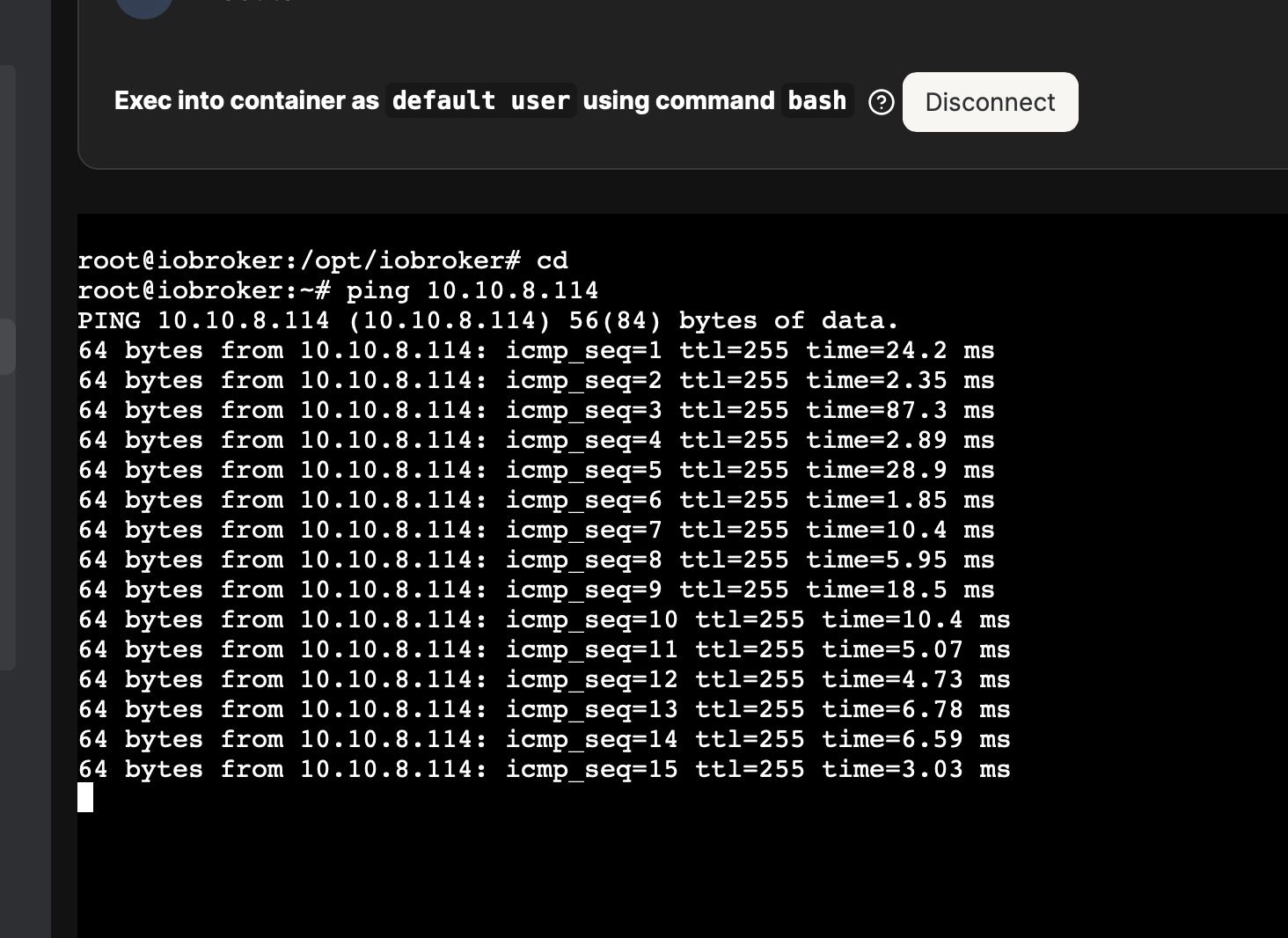

                      Adapter ist installiert und grün, aber ich bekomme keine Verbindung zur Anlage hin.
                      99+
                      Log-Größe: 202.5 KB
                      Zeit
                      worx.0
                      2026-06-07 09:38:01.203	debug	START UPDATE CHANGE
                      fujitsu-airstage.0
                      2026-06-07 09:37:47.422	warn	State "fujitsu-airstage.0.E8FB1CFF4D23.min_heat" has no existing object, this might lead to an error in future versions
                      fujitsu-airstage.0
                      2026-06-07 09:37:47.421	warn	State "fujitsu-airstage.0.E8FB1CFF4D23.wifi_led" has no existing object, this might lead to an error in future versions
                      fujitsu-airstage.0
                      2026-06-07 09:37:47.421	warn	State "fujitsu-airstage.0.E8FB1CFF4D23.outdoor_low_noise" has no existing object, this might lead to an error in future versions
                      fujitsu-airstage.0
                      2026-06-07 09:37:47.420	warn	State "fujitsu-airstage.0.E8FB1CFF4D23.human_detection_auto_save" has no existing object, this might lead to an error in future versions
                      fujitsu-airstage.0
                      2026-06-07 09:37:47.419	warn	State "fujitsu-airstage.0.E8FB1CFF4D23.human_detection" has no existing object, this might lead to an error in future versions
                      fujitsu-airstage.0
                      2026-06-07 09:37:47.418	warn	State "fujitsu-airstage.0.E8FB1CFF4D23.swing_horizontal" has no existing object, this might lead to an error in future versions
                      fujitsu-airstage.0
                      2026-06-07 09:37:47.417	warn	State "fujitsu-airstage.0.E8FB1CFF4D23.horizontal_direction" has no existing object, this might lead to an error in future versions
                      fujitsu-airstage.0
                      2026-06-07 09:37:47.416	warn	State "fujitsu-airstage.0.E8FB1CFF4D23.vertical_direction" has no existing object, this might lead to an error in future versions
                      fujitsu-airstage.0
                      2026-06-07 09:37:47.414	warn	State "fujitsu-airstage.0.E8FB1CFF4D23.vertical_increments" has no existing object, this might lead to an error in future versions
                      fujitsu-airstage.0
                      2026-06-07 09:37:47.414	warn	State "fujitsu-airstage.0.E8FB1CFF4D23.swing_vertical" has no existing object, this might lead to an error in future versions
                      fujitsu-airstage.0
                      2026-06-07 09:37:47.413	warn	State "fujitsu-airstage.0.E8FB1CFF4D23.power_consumption" has no existing object, this might lead to an error in future versions
                      fujitsu-airstage.0
                      2026-06-07 09:37:47.412	warn	State "fujitsu-airstage.0.E8FB1CFF4D23.outdoor_temperature" has no existing object, this might lead to an error in future versions
                      fujitsu-airstage.0
                      2026-06-07 09:37:47.411	warn	State "fujitsu-airstage.0.E8FB1CFF4D23.current_temperature" has no existing object, this might lead to an error in future versions
                      fujitsu-airstage.0
                      2026-06-07 09:37:47.410	warn	State "fujitsu-airstage.0.E8FB1CFF4D23.target_temperature" has no existing object, this might lead to an error in future versions
                      fujitsu-airstage.0
                      2026-06-07 09:37:47.409	warn	State "fujitsu-airstage.0.E8FB1CFF4D23.fan_ctrl" has no existing object, this might lead to an error in future versions
                      fujitsu-airstage.0
                      2026-06-07 09:37:47.408	warn	State "fujitsu-airstage.0.E8FB1CFF4D23.economy" has no existing object, this might lead to an error in future versions
                      fujitsu-airstage.0
                      2026-06-07 09:37:47.408	warn	State "fujitsu-airstage.0.E8FB1CFF4D23.powerful" has no existing object, this might lead to an error in future versions
                      fujitsu-airstage.0
                      2026-06-07 09:37:47.407	warn	State "fujitsu-airstage.0.E8FB1CFF4D23.fan_speed" has no existing object, this might lead to an error in future versions
                      fujitsu-airstage.0
                      2026-06-07 09:37:47.406	warn	State "fujitsu-airstage.0.E8FB1CFF4D23.mode" has no existing object, this might lead to an error in future versions
                      fujitsu-airstage.0
                      2026-06-07 09:37:47.405	warn	State "fujitsu-airstage.0.E8FB1CFF4D23.power" has no existing object, this might lead to an error in future versions
                      fujitsu-airstage.0
                      2026-06-07 09:37:47.404	warn	State "fujitsu-airstage.0.E8FB1CFF4D23.online" has no existing object, this might lead to an error in future versions
                      worx.0
                      2026-06-07 09:37:01.202	debug	START UPDATE CHANGE
                      fujitsu-airstage.0
                      2026-06-07 09:36:47.567	warn	State "fujitsu-airstage.0.E8FB1CFF4D23.min_heat" has no existing object, this might lead to an error in future versions
                      fujitsu-airstage.0
                      2026-06-07 09:36:47.566	warn	State "fujitsu-airstage.0.E8FB1CFF4D23.wifi_led" has no existing object, this might lead to an error in future versions
                      fujitsu-airstage.0
                      2026-06-07 09:36:47.565	warn	State "fujitsu-airstage.0.E8FB1CFF4D23.outdoor_low_noise" has no existing object, this might lead to an error in future versions
                      fujitsu-airstage.0
                      2026-06-07 09:36:47.564	warn	State "fujitsu-airstage.0.E8FB1CFF4D23.human_detection_auto_save" has no existing object, this might lead to an error in future versions
                      fujitsu-airstage.0
                      2026-06-07 09:36:47.563	warn	State "fujitsu-airstage.0.E8FB1CFF4D23.human_detection" has no existing object, this might lead to an error in future versions
                      fujitsu-airstage.0
                      2026-06-07 09:36:47.563	warn	State "fujitsu-airstage.0.E8FB1CFF4D23.swing_horizontal" has no existing object, this might lead to an error in future versions
                      fujitsu-airstage.0
                      2026-06-07 09:36:47.562	warn	State "fujitsu-airstage.0.E8FB1CFF4D23.horizontal_direction" has no existing object, this might lead to an error in future versions
                      fujitsu-airstage.0
                      2026-06-07 09:36:47.561	warn	State "fujitsu-airstage.0.E8FB1CFF4D23.vertical_direction" has no existing object, this might lead to an error in future versions
                      fujitsu-airstage.0
                      2026-06-07 09:36:47.560	warn	State "fujitsu-airstage.0.E8FB1CFF4D23.vertical_increments" has no existing object, this might lead to an error in future versions
                      fujitsu-airstage.0
                      2026-06-07 09:36:47.559	warn	State "fujitsu-airstage.0.E8FB1CFF4D23.swing_vertical" has no existing object, this might lead to an error in future versions
                      fujitsu-airstage.0
                      2026-06-07 09:36:47.559	warn	State "fujitsu-airstage.0.E8FB1CFF4D23.power_consumption" has no existing object, this might lead to an error in future versions
                      fujitsu-airstage.0
                      2026-06-07 09:36:47.557	warn	State "fujitsu-airstage.0.E8FB1CFF4D23.outdoor_temperature" has no existing object, this might lead to an error in future versions
                      fujitsu-airstage.0
                      2026-06-07 09:36:47.556	warn	State "fujitsu-airstage.0.E8FB1CFF4D23.current_temperature" has no existing object, this might lead to an error in future versions
                      fujitsu-airstage.0
                      2026-06-07 09:36:47.556	warn	State "fujitsu-airstage.0.E8FB1CFF4D23.target_temperature" has no existing object, this might lead to an error in future versions
                      fujitsu-airstage.0
                      2026-06-07 09:36:47.555	warn	State "fujitsu-airstage.0.E8FB1CFF4D23.fan_ctrl" has no existing object, this might lead to an error in future versions
                      fujitsu-airstage.0
                      2026-06-07 09:36:47.554	warn	State "fujitsu-airstage.0.E8FB1CFF4D23.economy" has no existing object, this might lead to an error in future versions
                      fujitsu-airstage.0
                      2026-06-07 09:36:47.553	warn	State "fujitsu-airstage.0.E8FB1CFF4D23.powerful" has no existing object, this might lead to an error in future versions
                      fujitsu-airstage.0
                      2026-06-07 09:36:47.552	warn	State "fujitsu-airstage.0.E8FB1CFF4D23.fan_speed" has no existing object, this might lead to an error in future versions
                      fujitsu-airstage.0
                      2026-06-07 09:36:47.552	warn	State "fujitsu-airstage.0.E8FB1CFF4D23.mode" has no existing object, this might lead to an error in future versions
                      fujitsu-airstage.0
                      2026-06-07 09:36:47.551	warn	State "fujitsu-airstage.0.E8FB1CFF4D23.power" has no existing object, this might lead to an error in future versions
                      fujitsu-airstage.0
                      2026-06-07 09:36:47.550	warn	State "fujitsu-airstage.0.E8FB1CFF4D23.online" has no existing object, this might lead to an error in future versions
                      Kann auch keine Werte über die Objekte setzen.
                      IP und MAC Adresse sind korrekt eingegeben.
                      Edit: Mein IoBroker läuft in einem Docker Container. Das vielleicht noch als Hinweis. Ring aus dem Container heraus zur Klima geht jedoch
