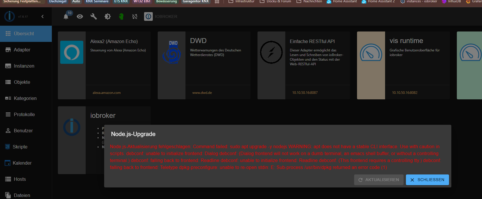

    Die deinem Problem zugrunde liegende Fehlermeldung ist folgende:
    error: host.iobroker iobroker npm error code EBADENGINEnpm error engine Unsupported enginenpm error engine Not compatible with your version of node/npm: @homebridge/ciao@1.2.0npm error notsup Not compatible with your version of node/npm: @homebridge/ciao@1.2.0npm error notsup Required: {"node":"^18 || ^20"}npm error notsup Actual: {"npm":"10.9.3","node":"v22.18.0"}npm error A complete log of this run can be found in: /home/iobroker/.npm/_logs/2025-08-22T13_13_53_260Z-debug-0.log
    2025-08-22 15:13:55.721 - error: host.iobroker iobroker host.iobroker Cannot install iobroker.myuplink@0.8.4: 1
    2025-08-22 15:13:56.732 - info: host.iobroker iobroker exit 25
    2025-08-22 15:14:49.833 - info: influxdb.0 (24581) Do not store value "{"Time":"2025-08-22T14:14:48","Haus":{"Tariflos":0.0000,"Energy":332,"Power_p1":23,"Power_p2":95,"Power_p3":214},"Heizung":{"Tariflos":10418.5469,"Energy":0,"Power_p1":0,"Power_p2":0,"Power_p3":0}}" for StromHaus because no number
    2025-08-22 15:14:50.069 - info: host.iobroker Updating repository "Stable (default)" under "http://download.iobroker.net/sources-dist.json"
    2025-08-22 15:14:58.547 - info: host.iobroker iobroker upgrade yahka@1.1.5 --debug
    2025-08-22 15:14:59.206 - info: host.iobroker iobroker Update yahka from @1.0.3 to @1.1.5
    2025-08-22 15:14:59.275 - info: host.iobroker iobroker NPM version: 10.9.3
    2025-08-22 15:14:59.275 - info: host.iobroker iobroker Installing iobroker.yahka@1.1.5... (System call)
    2025-08-22 15:15:05.132 - info: host.iobroker iobroker added 1 package, removed 1 package, and changed 19 packages in 6s408 packages are looking for funding run `npm fund` for details
    2025-08-22 15:15:06.399 - error: host.iobroker iobroker Cannot install "pam-devel": WARNING: apt does not have a stable CLI interface. Use with caution in scripts.E: Unable to locate package pam-devel
    2025-08-22 15:15:06.399 - error: host.iobroker iobroker The following apt packages could not be installed: pam-devel. Please install them manually.
    Oder extrahiert:
    Diese wird (oder wurde?) durch YAHKA in einer Version älter als 1.1.5 ausgelöst. Da du anscheinend zwischenzeitlich yahka auf 1.1.5 gebracht hast sollte sich das primäre Problem behoben haben.

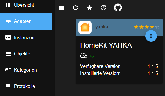

      mcm1957
      @marcel-drzal
      Zum Zeitpunkt der Fehlermeldung war yahka aber installiert.Bist du sicher, dass du den ADAPTER und nicht nur die INSTANZ gelöscht hast?
      EDIT:
      Lt iob diag in commentar https://forum.iobroker.net/topic/81995/js-controler-auf-7-07-geht-nicht-fehlermeldung-iob/12 hast du jetzt yahka 1.1.5 installiert - allerdings ohne aktive instanz.
      Du hast also offensichtlich nur die Instanz gelöscht :-)

          mcm1957
          @marcel-drzal
          Yep ist installiert. Wenn du ihn nicht mehr benutzt solltest du ihn deinstallieren.

                marcel-drzal
                schrieb am zuletzt editiert von marcel-drzal
                @mcm1957 Adapter habe ich gelöscht
