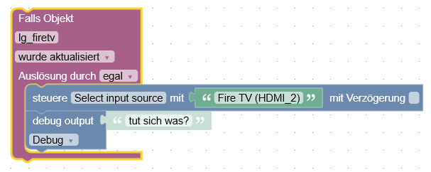

    4. Skript reagiert nicht mehr auf Aktualisierung von Objekt

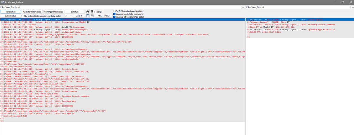

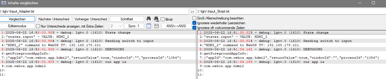

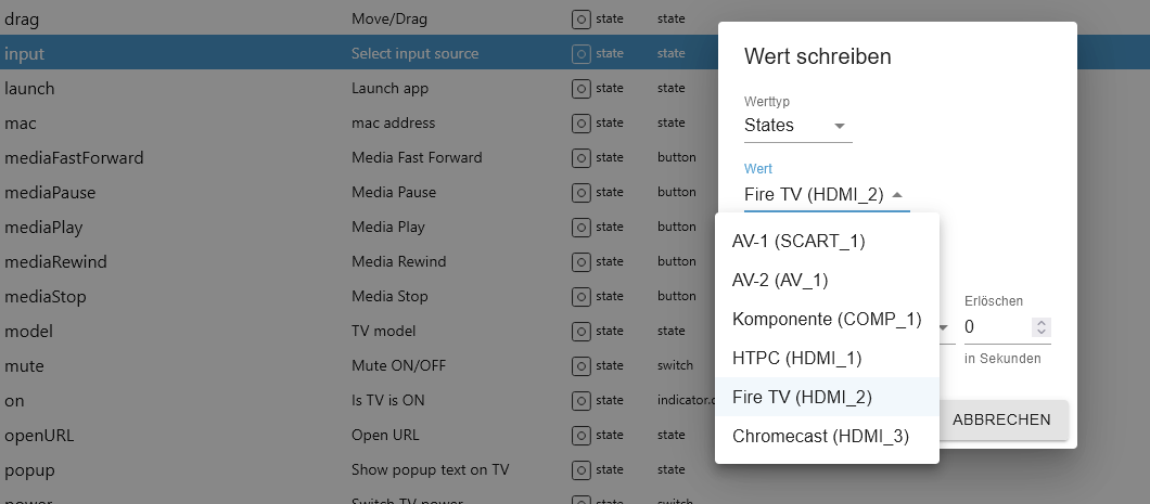

        App über Skript
        2025-06-22 16:50:05.608 - debug: lgtv.0 (1610) State change
        "states.launch" - VALUE: Fire TV
        2025-06-22 16:50:05.609 - debug: lgtv.0 (1610) Sending launch command
        Fire TV to WebOS TV: 192.168.178.221
        2025-06-22 16:50:05.609 - debug: lgtv.0 (1610) Opening app Fire TV on
        App über Adapterobjekt
        2025-06-22 16:47:55.329 - debug: lgtv.0 (1610) Connection closed: 1000
        2025-06-22 16:47:55.821 - debug: lgtv.0 (1610) Connecting to WebOS TV:
        wss://192.168.178.221:3001
        2025-06-22 16:47:55.960 - debug: lgtv.0 (1610) WebOS TV Connected
        2025-06-22 16:47:56.180 - debug: lgtv.0 (1610) audio/getSoundOutput: {}
        2025-06-22 16:47:56.184 - debug: lgtv.0 (1610) audio/getVolume:
        {"muted":false,"scenario":"mastervolume_tv_speaker","active":false,"action":"requested","volume":10,"returnValue":true,"subscribed":true,"changed":["muted","volume"]}
        2025-06-22 16:47:56.187 - debug: lgtv.0 (1610) DEBUGGING
        getForegroundAppInfo:
        {"appId":"com.webos.app.livetv","subscribed":true,"returnValue":true,"windowId":"","processId":"n-2205"}
        2025-06-22 16:47:56.188 - debug: lgtv.0 (1610) cur app is
        2025-06-22 16:47:56.196 - debug: lgtv.0 (1610) tv/getCurrentChannel:
        {"channelId":"3_49_2_0_1079_11110_1","signalChannelId":"1079_11110_1","channelModeId":1,"channelModeName":"Cable","channelTypeId":4,"channelTypeName":"Cable Digital TV","channelNumber":"2","channelName":"ZDF HD","physicalNumber":49,"isSkipped":false,"isLocked":false,"isDescrambled":false,"isScrambled":false,"isFineTuned":false,"isInvisible":false,"favoriteGroup":null,"hybridtvType":"HBBTV","dualChannel":{"dualChannelId":null,"dualChannelTypeId":null,"dualChannelTypeName":null,"dualChannelNumber":null},"returnValue":true}
        2025-06-22 16:47:56.225 - debug: lgtv.0 (1610) getCurrentSWInformation:
        {"returnValue":true,"product_name":"webOS","model_name":"HE_DTV_WT1M_AFAAABAA","sw_type":"FIRMWARE","major_ver":"05","minor_ver":"05.90","country":"DE","device_id":"3c:cd:93:68:dc:dc","auth_flag":"N","ignore_disable":"N","eco_info":"01","config_key":"00","language_code":"de-DE"}
        2025-06-22 16:47:56.227 - debug: lgtv.0 (1610) getSystemInfo:
        {"features":
        {"3d":true,"dvr":true},"receiverType":"dvb","modelName":"42LB730V-
        ZD","returnValue":true}
        2025-06-22 16:47:56.233 - debug: lgtv.0 (1610) Service list:
        {"services":[{"name":"api","version":1},{"name":"audio","version":1},
        {"name":"media.controls","version":1},
        {"name":"media.viewer","version":1},{"name":"pairing","version":1},
        {"name":"system","version":1},{"name":"system.launcher","version":1},
        {"name":"system.notifications","version":1},{"name":"tv","version":1},
        {"name":"webapp","version":2}],"returnValue":true}
        2025-06-22 16:47:59.219 - debug: lgtv.0 (1610) tv/getCurrentChannel:
        2025-06-22 16:48:00.840 - debug: lgtv.0 (1610) State change
        "states.launch" - VALUE: com.webos.app.hdmi2
        2025-06-22 16:48:00.840 - debug: lgtv.0 (1610) Sending launch command
        com.webos.app.hdmi2 to WebOS TV: 192.168.178.221
        2025-06-22 16:48:00.841 - debug: lgtv.0 (1610) Opening app
        com.webos.app.hdmi2 on WebOS TV: 192.168.178.221
        2025-06-22 16:48:01.186 - debug: lgtv.0 (1610) DEBUGGING
        {"appId":"com.webos.app.hdmi2","returnValue":true,"windowId":"","processId":"1054"}
        2025-06-22 16:48:01.186 - debug: lgtv.0 (1610) cur app is
        com.webos.app.hdmi2

                            danke .. Objekt scheint jetzt ok zu sein
                            @Homoran
                            "Quelle aktivieren" finde ich nicht .. aber es kommt nur was von iot.0

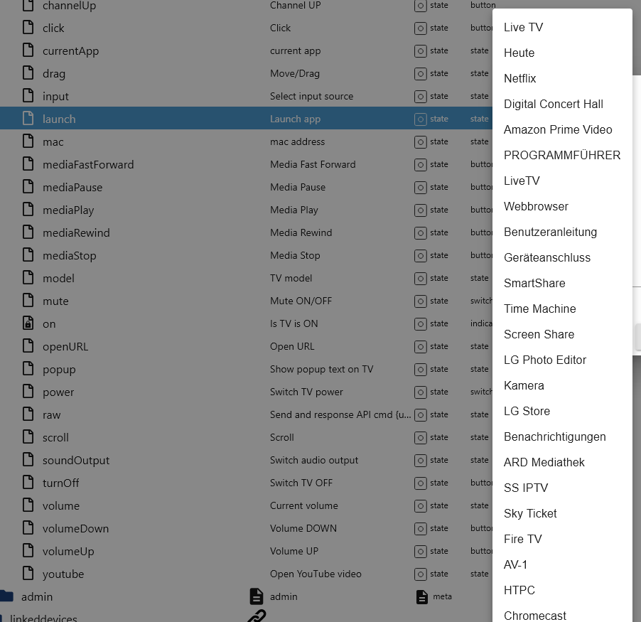

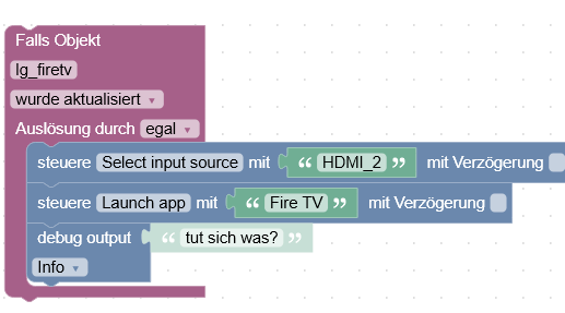

                            Input schalten funktioniert weiterhin auch per Skript. Launch app funktioniert weiterhin nur in den Objekten.
                            Für mein Seelenfrieden genügt die Umschaltung über Input .. aber technisch sollte auch das andere funktionieren.
