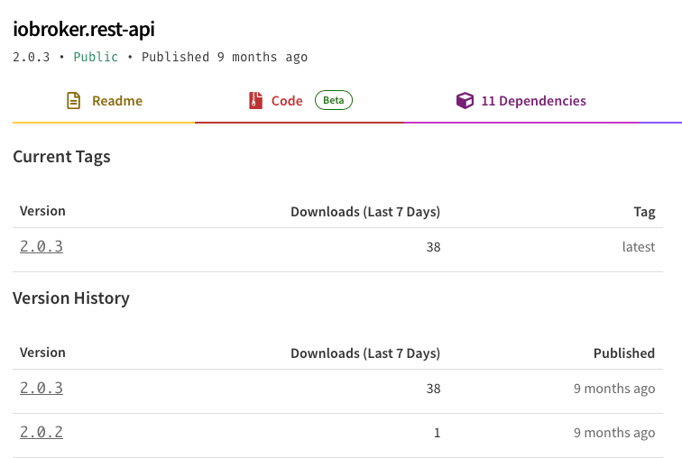

    Wollte gerade den Rest-API von 2.0.3 auf 2.1.0 updaten.
    Läuft normal durch, aber es bleibt bei 2.0.3 und das Update wird mir immer wieder vorgeschlagen.
    Selbes Spiel mit Sourceanalytix von 0.4.14 auf 0.4.15-alpha.
    $ iobroker upgrade rest-api@2.1.0 --debug
    Update rest-api from @2.0.3 to @2.1.0
    host.ioBroker Adapter "system.adapter.rest-api.0" is stopped.
    Installing iobroker.rest-api@2.1.0... (System call)
    npm error code ETARGET
    npm error notarget No matching version found for iobroker.rest-api@2.1.0.npm error notarget In most cases you or one of your dependencies are requestingnpm error notarget a package version that doesn't exist.
    npm error A complete log of this run can be found in: /home/iobroker/.npm/_logs/2025-04-24T08_59_50_444Z-debug-0.log
    Updating objects from io-package.json for adapter "rest-api" with version "2.0.3"
    upload [11] rest-api.admin /opt/iobroker/node_modules/iobroker.rest-api/admin/i18n/de/translations.json i18n/de/translations.json application/json
    upload [10] rest-api.admin /opt/iobroker/node_modules/iobroker.rest-api/admin/i18n/en/translations.json i18n/en/translations.json application/json
    upload [9] rest-api.admin /opt/iobroker/node_modules/iobroker.rest-api/admin/i18n/es/translations.json i18n/es/translations.json application/json
    upload [8] rest-api.admin /opt/iobroker/node_modules/iobroker.rest-api/admin/i18n/fr/translations.json i18n/fr/translations.json application/json
    upload [7] rest-api.admin /opt/iobroker/node_modules/iobroker.rest-api/admin/i18n/it/translations.json i18n/it/translations.json application/json
    upload [6] rest-api.admin /opt/iobroker/node_modules/iobroker.rest-api/admin/i18n/nl/translations.json i18n/nl/translations.json application/json
    upload [5] rest-api.admin /opt/iobroker/node_modules/iobroker.rest-api/admin/i18n/pl/translations.json i18n/pl/translations.json application/json
    upload [4] rest-api.admin /opt/iobroker/node_modules/iobroker.rest-api/admin/i18n/pt/translations.json i18n/pt/translations.json application/json
    upload [3] rest-api.admin /opt/iobroker/node_modules/iobroker.rest-api/admin/i18n/ru/translations.json i18n/ru/translations.json application/json
    upload [2] rest-api.admin /opt/iobroker/node_modules/iobroker.rest-api/admin/i18n/zh-cn/translations.json i18n/zh-cn/translations.json application/json
    upload [1] rest-api.admin /opt/iobroker/node_modules/iobroker.rest-api/admin/jsonConfig.json jsonConfig.json application/json
    upload [0] rest-api.admin /opt/iobroker/node_modules/iobroker.rest-api/admin/rest-api.png rest-api.png image/png
    host.ioBroker Adapter "system.adapter.rest-api.0" is started
    Process exited with code 0

      Hallo

      @negalein
      Die 2.1.0 ist laut npmjs auf NPM nicht veröffentlicht.
      Da würde mich interessieren was du als Kanal für Deine Update-Vorschläge eingestellt hast.
      A.
      NegaleinN 1 Reply Last reply

            Im Falle der rest-api ist die Deploy-Action nicht ausgeführt worden: https://github.com/ioBroker/ioBroker.rest-api/actions/runs/13568640534
            Das heißt, auf GitHub steht zwar 2.1.0, aber das Paket ist nie auf npm angekommen.
            FYI @mcm1957
