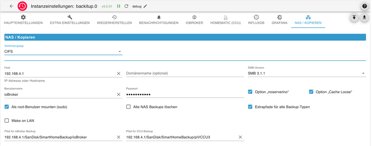

          @simatec sagte in Backup von InfluxDB scheitert:
          Über die Pfeiltasten oben rechts runterladen und hier posten...
          Wenn ich weiß, was genau zu tun ist, komme ich dem auch gerne nach.
            "minimalEnabled": true,
            "minimalTime": "03:40",
            "minimalEveryXDays": "1",
            "minimalDeleteAfter": 4,
            "minimalNameSuffix": "Gro",
            "redisMinimalEnabled": false,
            "mysqlMinimalEnabled": false,
            "mysqlQuick": false,
            "mysqlSingleTransaction": false,
            "ccuEnabled": true,
            "ccuTime": "04:30",
            "ccuEveryXDays": "4",
            "ccuDeleteAfter": 4,
            "ccuNameSuffix": "",
            "ccuHost": "192.168.4.91",
            "ccuUser": "ioBroker",
            "ccuPassword": "...passWord...",
            "webdavEnabled": false,
            "webdavUsername": "username",
            "webdavPassword": "",
            "webdavURL": "https://example.com/remote.php/dav/files/username/",
            "webdavDeleteOldBackup": false,
            "webdavOwnDir": false,
            "webdavMinimalDir": "/backupDir/iobroker",
            "webdavCcuDir": "/backupDir/ccu",
            "webdavDir": "/backupDir",
            "dropboxEnabled": false,
            "dropboxAccessToken": "",
            "dropboxDeleteOldBackup": false,
            "dropboxOwnDir": false,
            "dropboxMinimalDir": "/backupDir/iobroker",
            "dropboxCcuDir": "/backupDir/ccu",
            "dropboxDir": "/backupDir",
            "googledriveEnabled": false,
            "googledriveAccessJson": "",
            "googledriveDeleteOldBackup": false,
            "googledriveOwnDir": false,
            "googledriveMinimalDir": "/backupDir/iobroker",
            "googledriveCcuDir": "/backupDir/ccu",
            "googledriveDir": "/backupDir",
            "mySqlEnabled": false,
            "mySqlHost": "localhost",
            "mySqlPort": "3306",
            "mySqlName": "iobroker",
            "mySqlUser": "",
            "mySqlPassword": "",
            "mySqlDeleteAfter": 5,
            "mySqlDumpExe": "",
            "influxDBEnabled": true,
            "influxDBHost": "localhost",
            "influxDBPort": 8086,
            "influxDBName": "db_iobroker",
            "influxDBDumpExe": "",
            "influxDBDeleteAfter": 5,
            "influxDBType": "remote",
            "deleteOldDataBase": true,
            "grafanaEnabled": true,
            "grafanaHost": "192.168.4.72",
            "grafanaPort": "3000",
            "grafanaUsername": "admin",
            "grafanaPassword": "!Passwort",
            "grafanaApiKey": "...apiKey...",
            "pgSqlHost": "",
            "pgSqlPort": "5432",
            "pgSqlName": "",
            "pgSqlUser": "",
            "pgSqlPassword": "",
            "pgSqlDeleteAfter": 5,
            "pgSqlDumpExe": "",
            "pgSqlEnabled": false,
            "cifsEnabled": true,
            "cifsMount": "192.168.4.1",
            "cifsUser": "ioBroker",
            "cifsPassword": "...passWord...",
            "cifsOwnDir": true,
            "cifsDomain": "",
            "cifsDir": "fritz.nas/SanDisk/SmartHomeBackup",
            "cifsCcuDir": "192.168.4.1/SanDisk/SmartHomeBackup/piVCCU3",
            "cifsMinimalDir": "192.168.4.1/SanDisk/SmartHomeBackup/ioBroker",
            "cifsDeleteOldBackup": false,
            "connectType": "Copy",
            "smbType": "vers=3.1.1",
            "sudoMount": true,
            "noserverino": true,
            "wakeOnLAN": false,
            "macAd": "20:DE:20:DE:20:DE",
            "wolWait": "25",
            "ftpEnabled": false,
            "ftpHost": "",
            "ftpPort": "21",
            "ftpDir": "/backupDir",
            "ftpUser": "",
            "ftpPassword": "",
            "ftpOwnDir": false,
            "ftpCcuDir": "/backupDir/ccu",
            "ftpMinimalDir": "/backupDir/iobroker",
            "ftpDeleteOldBackup": false,
            "redisEnabled": false,
            "redisPath": "/var/lib/redis",
            "redisAOFactive": false,
            "historyEnabled": false,
            "historyPath": "media/usb/history",
            "javascriptsPath": "/media/usb/scripts",
            "javascriptsEnabled": true,
            "zigbeeEnabled": true,
            "jarvisEnabled": false,
            "notificationEnabled": true,
            "notificationsType": "Telegram",
            "telegramInstance": "telegram.0",
            "telegramNoticeType": "longTelegramNotice",
            "telegramUser": "allTelegramUsers",
            "telegramSilentNotice": false,
            "telegramOnlyError": false,
            "telegramWaitToSend": "0",
            "whatsappInstance": "",
            "whatsappNoticeType": "longWhatsappNotice",
            "whatsappOnlyError": false,
            "whatsappWaitToSend": "0",
            "pushoverInstance": "pushover.0",
            "pushoverNoticeType": "longPushoverNotice",
            "pushoverSilentNotice": false,
            "pushoverDeviceID": "",
            "pushoverOnlyError": false,
            "pushoverWaitToSend": "0",
            "emailReceiver": "xxx@xxx.com",
            "emailSender": "xxx@xxx.com",
            "emailInstance": "",
            "emailNoticeType": "longEmailNotice",
            "emailOnlyError": false,
            "emailWaitToSend": "0",
            "debugLevel": true,
            "sentry_enable": true,
            "historyEntriesNumber": 15,
            "restoreSource": "cifs",
            "startAllRestore": true,
            "ccuUsehttps": true,
            "grafanaProtocol": "http",
            "ccuMulti": false,
            "ccuEvents": [],
            "ccuSignedCertificates": true,
            "webdavSignedCertificates": true,
            "mySqlMulti": false,
            "mySqlEvents": [],
            "influxDBMulti": false,
            "influxDBEvents": [],
            "pgSqlMulti": false,
            "pgSqlEvents": [],
            "yahkaEnabled": true,
            "hostType": "Single",
            "slaveInstance": [],
            "slaveNameSuffix": "",
            "stopSlaveAfter": false,
            "influxDBToken": "...token...==",
            "influxDBVersion": "2.x",
            "influxDBProtocol": "http",
            "redisType": "local",
            "redisHost": "",
            "redisPort": "6379",
            "redisUser": "",
            "redisPassword": "",
            "ignoreErrors": false,
            "dropboxAccessJson": "",
            "dropboxTokenType": "custom",
            "dropboxCodeChallenge": "",
            "signalInstance": "",
            "signalNoticeType": "longSignalNotice",
            "signalOnlyError": false,
            "signalWaitToSend": "0",
            "googledriveAccessTokens": "",
            "grafanaSignedCertificates": true,
            "onedriveEnabled": false,
            "onedriveAccessJson": "",
            "onedriveDeleteOldBackup": false,
            "onedriveOwnDir": false,
            "onedriveMinimalDir": "backupDir/iobroker",
            "onedriveCcuDir": "backupDir/ccu",
            "onedriveDir": "backupDir",
            "ftpSecure": false,
            "matrixInstance": "",
            "matrixNoticeType": "longMatrixNotice",
            "matrixOnlyError": false,
            "matrixWaitToSend": "0",
            "restoreTab": true,
            "noderedEnabled": false,
            "sqliteEnabled": false,
            "sqlitePath": "/opt/sqlite/data.db",
            "sqliteDumpExe": "",
            "zigbee2mqttPath": "/opt/zigbee2mqtt/data",
            "zigbee2mqttEnabled": false,
            "fileSizeError": "512",
            "fileSizeWarning": "1024",
            "onedriveLastTokenRenew": "",
            "ftpSignedCertificates": true,
            "wolPort": "9",
            "discordInstance": "",
            "discordNoticeType": "longDiscordNotice",
            "discordOnlyError": false,
            "discordWaitToSend": "0",
            "discordTarget": "",
            "wolExtra": false,
            "cacheLoose": true,
            "esphomeEnabled": false,
            "gotifyInstance": "",
            "gotifyNoticeType": "longGotifyNotice",
            "gotifyOnlyError": false,
            "gotifyWaitToSend": "0",
            "ccuCron": false,
            "ccuCronJob": "00 36 01 */3 * *",
            "expertMount": "sudo mount -t cifs -o username=<username>,password=\"<password>\",noserverino,cache=loose,rw,uid=iobroker,gid=iobroker,file_mode=0777,dir_mode=0777,vers=3.1.1 //192.168.0.1/NAS/BACKUP /opt/iobroker/backups",
            "iobrokerCron": false,
            "iobrokerCronJob": "00 48 02 */1 * *",
            "advancedDelete": false,
            "dropboxDeleteAfter": 10,
            "ftpDeleteAfter": 10,
            "googledriveDeleteAfter": 10,
            "onedriveDeleteAfter": 10,
            "webdavDeleteAfter": 10,
            "_nonSupportDockerDB": false
          MOD-EDIT: private Daten unkenntlich gemqcht
              simatecS Offline
              simatecS Offline
              simatec
              wrote on last edited by
              #74
              @legro also deine Pfade passen alle nicht. Weder für das iobroker Backup noch für die CCU
              Da steht im jeden Pfad die IP am Anfang, was nicht korrekt ist. So kann Backitup nicht mounten

                • HomoranH Do not disturb
                  #76
                  So sollte es sein…
                  das hatte ich auch erwartet.
                  Aber laut Screenshot hier
                  https://forum.iobroker.net/post/1266370
                  müsste das doch stimmen wenn @legro 7n der Zwischenzeit nichts geändert hat. und die Pfade korrekt zusammengebaut werden
                  simatecS 1 Reply Last reply
                    So sollte es sein…
                    simatecS Offline
                    simatecS Offline
                    simatec
                    #77
                    @homoran die Config sagt was anderes… schaue mal drauf
                      ich weiss!

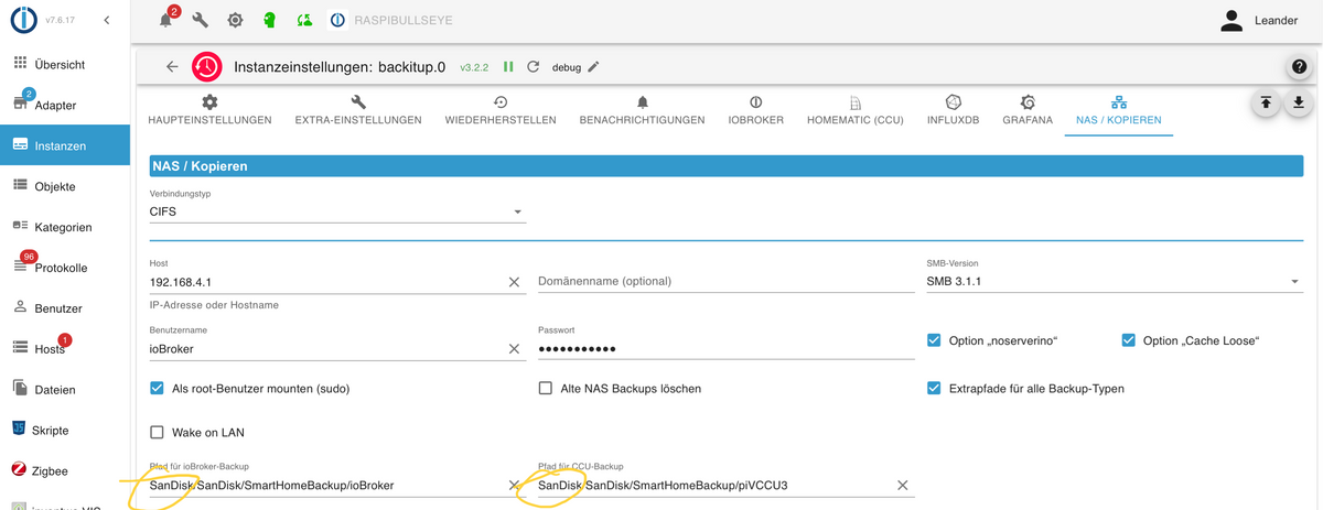

                          @legro was haben wir denn nicht gezeigt?
                          Die gespeicherte Konfiguration enthält andere (falsche) Pfade.
                          Anders als in dem Screenshot in dem von mir verlinkten Post von dir.

                              @legro sagte in Backup von InfluxDB scheitert:
                              Warum kein Klartext?
                              was fehlt denn um klar zu sein?
                              was bitte steht jetzt(!) in deiner Konfiguration?

                                @legro bitte ichts nachträglich ändern/hinzufügen!
                                Die in dem nachgelieferten Screenshot stehenden Einstellungen sind falsch!
                                die zuerst in diesem Post https://forum.iobroker.net/post/1266370 geposteten Einstellungen waren korrekt!
                                Warum hast du diese geändert ohne uns zu informieren.
                                Wir mussten die ganze Zeit davon ausgehen, dass du mit diesen Einstellungen arbeitest.
                                Die IP steht bereits da wo sie hingehört, unter "IP"
                                der Pfad zur Freigabe enthält bei der Fritzbox den Abschnitt fritz.nas.
                                der muss unten eingetragen werden, so wie @simatec es im modifizierten Konfigurations JSON gezeigt hat.
                                L 1 Reply Last reply

                                  Nun ust neine Verwirrung komplett.
                                  Habe ich das richtig verstanden: Ich soll fritz.nas anstelle der IP eintragen? Also so ..
                                  Dann passiert dasselbe, was ich in einem vorangegangenen Beitrag schon aufgezeigt habe ..
                                  21:53:34.274INFOguiBackup gestartet ...
                                  [DEBUG] [mount] start with {"mountType":"CIFS","type":"storage","source":"cifs","mount":"192.168.4.1","debugging":true,"fileDir":"/opt/iobroker/iobroker-data/backitup","wakeOnLAN":false,"macAd":"20:DE:20:DE:20:DE","wolTime":"25","wolPort":"9","wolExtra":false,"smb":"vers=3.1.1","sudo":true,"cifsDomain":"","clientInodes":true,"cacheLoose":true,"deleteOldBackup":false,"ownDir":true,"dir":"fritz.nas/SanDisk/SmartHomeBackup/piVCCU3","dirMinimal":"fritz.nas/SanDisk/SmartHomeBackup/ioBroker","user":"ioBroker","pass":"****","expertMount":"sudo mount -t cifs -o username=<username>,password=\"<password>\",noserverino,cache=loose,rw,uid=iobroker,gid=iobroker,file_mode=0777,dir_mode=0777,vers=3.1.1 //192.168.0.1/NAS/BACKUP /opt/iobroker/backups","ignoreErrors":false}
                                  21:53:44.420DEBUGmountcifs-mount command: "sudo mount -t cifs -o username=ioBroker,password=****,noserverino,cache=loose,rw,forceuid,uid=iobroker,forcegid,gid=iobroker,file_mode=0777,dir_mode=0777,vers=3.1.1 //192.168.4.1/fritz.nas/SanDisk/SmartHomeBackup/piVCCU3 /opt/iobroker/backups"
                                  21:53:44.453DEBUGmountfirst mount attempt with smb option failed. try next mount attempt without smb option ...
                                  21:53:44.460DEBUGmountcifs-mount command: "sudo mount -t cifs -o username=ioBroker,password=****,noserverino,cache=loose,rw,forceuid,uid=iobroker,forcegid,gid=iobroker,file_mode=0777,dir_mode=0777 //192.168.4.1/fritz.nas/SanDisk/SmartHomeBackup/piVCCU3 /opt/iobroker/backups"
                                  21:53:44.523DEBUGmountError: Command failed: sudo mount -t cifs -o username=ioBroker,password=****,noserverino,cache=loose,rw,forceuid,uid=iobroker,forcegid,gid=iobroker,file_mode=0777,dir_mode=0777 //192.168.4.1/fritz.nas/SanDisk/SmartHomeBackup/piVCCU3 /opt/iobroker/backups
                                  mount error(2): No such file or directory
                                  Refer to the mount.cifs(8) manual page (e.g. man mount.cifs) and kernel log messages (dmesg)
