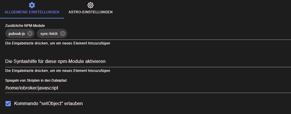

          @arteck Soweit war ich ja auch schon.
          Aber beim Starten des scripts mit den passenden Modulen in JS kommt gleich:
          javascript.0
          	2025-01-29 08:42:09.249	error	at processImmediate (node:internal/timers:485:21)
          javascript.0
          	2025-01-29 08:42:09.249	error	at Immediate._onImmediate (/opt/iobroker/node_modules/iobroker.javascript/main.js:1732:17)
          javascript.0
          	2025-01-29 08:42:09.249	error	at /opt/iobroker/node_modules/iobroker.javascript/main.js:2322:17
          javascript.0
          	2025-01-29 08:42:09.248	error	at prepareScript (/opt/iobroker/node_modules/iobroker.javascript/main.js:2224:37)
          javascript.0
          	2025-01-29 08:42:09.248	error	at createVM (/opt/iobroker/node_modules/iobroker.javascript/main.js:1956:21)
          javascript.0
          	2025-01-29 08:42:09.248	error	at new Script (node:vm:117:7)
          javascript.0
          	2025-01-29 08:42:09.248	error	SyntaxError: Cannot use import statement outside a module
          javascript.0
          	2025-01-29 08:42:09.248	error	^^^^^^
          javascript.0
          	2025-01-29 08:42:09.248	error	import PubSub from 'pubsub-js'
          javascript.0
          	2025-01-29 08:42:09.248	error	script.js.common.abrp_js compile failed: at script.js.common.abrp_js:27
          1 Reply Last reply
