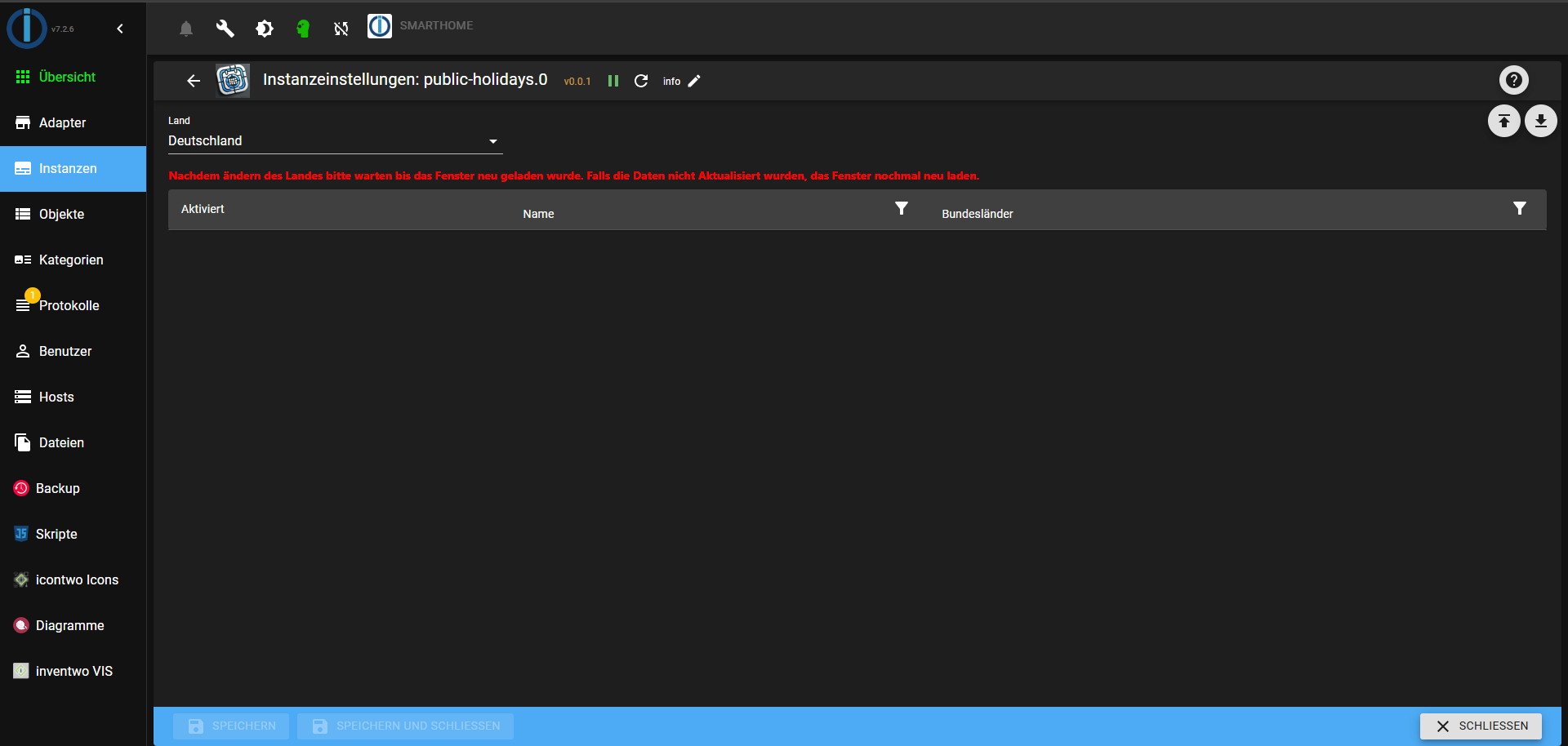

        sigi234S Online
        sigi234S Online
        sigi234
        @jey-cee
        Hallo, sollten da nicht Daten kommen?
        admin.0
        2024-10-24 19:23:09.134	warn	public-holidays has an invalid jsonConfig: [{"instancePath":"/items/_hitSave","schemaPath":"#/properties/items/patternProperties/%5E.%2B/allOf/37/then/additionalProperties","keyword":"additionalProperties","params":{"additionalProperty":"onChange"},"message":"must NOT have additional properties"},{"instancePath":"","schemaPath":"#/if","keyword":"if","params":{"failingKeyword":"else"},"message":"must match \"else\" schema"}]
        admin.0
        2024-10-24 19:23:06.331	info	==> Connected system.user.admin from ::1
        admin.0
        2024-10-24 19:23:06.094	info	<== Disconnect system.user.admin from ::1 admin
        host.SmartHome
        2024-10-24 19:23:00.707	info	instance system.adapter.public-holidays.0 terminated with code 0 (NO_ERROR)
        Edit:
        Betriebssystem:Windows
        RAM:15.9 GB
        Node.js:v20.18.0
        NPM:10.8.2
        Admin: 7.2.6
        JS-Controller: 7.0.1
        Immer Daten sichern!

          admin.0
          host.SmartHome
          Edit:
          RAM:15.9 GB
          Node.js:v20.18.0
          NPM:10.8.2
          Admin: 7.2.6
