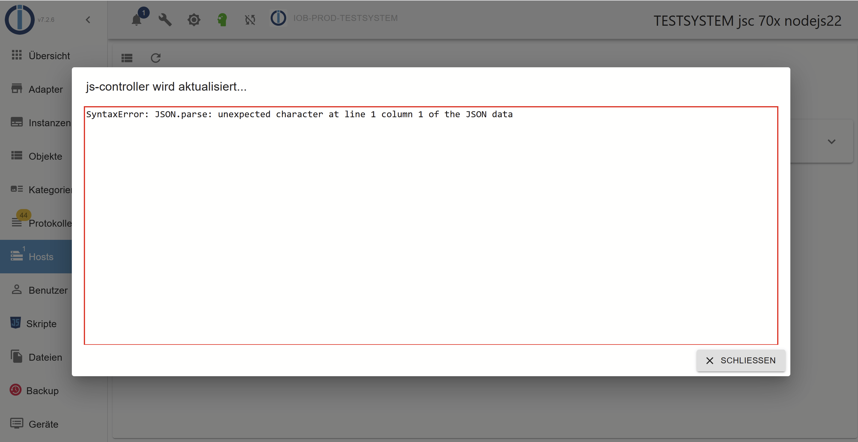

                @foxriver76 Das kommt bei mir, wenn ich per Admin GUI auf 7.0.1 aktualisieren möchte
                2024-10-21 20:49:20.372  - info: admin.0 (485) ==> Connected system.user.admin from ::ffff:192.168.178.128
                2024-10-21 20:50:18.176  - info: host.ioB-Prod-Testsystem Controller will upgrade itself to version 7.0.1
                2024-10-21 20:50:23.358  - info: host.ioB-Prod-Testsystem [CONTROLLER_AUTO_UPGRADE] Stopping controller
                2024-10-21 20:50:28.416  - info: host.ioB-Prod-Testsystem [CONTROLLER_AUTO_UPGRADE] Successfully stopped js-controller
                2024-10-21 20:50:28.481  - error: host.ioB-Prod-Testsystem [CONTROLLER_AUTO_UPGRADE] Uncaught Exception: Error: listen EADDRINUSE: address already in use :::8081
                    at Server.setupListenHandle [as _listen2] (node:net:1907:16)
                    at listenInCluster (node:net:1964:12)
                    at Server.listen (node:net:2066:7)
                    at UpgradeManager.startInsecureWebServer (file:///opt/iobroker/node_modules/iobroker.js-controller/src/lib/upgradeManager.ts:266:21)
                    at UpgradeManager.startWebServer (file:///opt/iobroker/node_modules/iobroker.js-controller/src/lib/upgradeManager.ts:198:18)
                    at main (file:///opt/iobroker/node_modules/iobroker.js-controller/src/lib/upgradeManager.ts:400:20)
                foxriver76 1 Reply Last reply Reply Quote 0

                    @foxriver76 sagte in js-controller Lucy (Version 7.0) jetzt im Beta Repository:
                    @feuersturm jedes Mal?
                    Beim zweiten Mal über die GUI angestartet und der gleiche Fehler.
                    Danach über die Konsole und das update war i.O.

                    2024-10-21 21:59:18.865  - error: host.ioB-Prod-Testsystem Caught by controller[0]:     '/opt/iobroker/node_modules/iobroker.echarts/main.js'
                    2024-10-21 21:59:18.873  - error: host.ioB-Prod-Testsystem Caught by controller[0]:   ]
                    2024-10-21 21:59:18.880  - error: host.ioB-Prod-Testsystem Caught by controller[0]: }
                    2024-10-21 21:59:18.887  - error: host.ioB-Prod-Testsystem Caught by controller[0]: Node.js v22.10.0
                    2024-10-21 21:59:18.902  - error: host.ioB-Prod-Testsystem instance system.adapter.echarts.0 terminated with code 1 (JS_CONTROLLER_STOPPED)
                    2024-10-21 21:59:18.909  - info: host.ioB-Prod-Testsystem Adapter system.adapter.echarts.0 needs rebuild and will be restarted afterwards.
                    2024-10-21 21:59:18.917  - info: host.ioB-Prod-Testsystem system.adapter.echarts.0 will be rebuilt
                    2024-10-21 21:59:19.302  - error: host.ioB-Prod-Testsystem Caught by controller[0]: node:internal/modules/cjs/loader:1252
                    2024-10-21 21:59:19.320  - error: host.ioB-Prod-Testsystem Caught by controller[0]:   throw err;
                    2024-10-21 21:59:19.334  - error: host.ioB-Prod-Testsystem Caught by controller[0]:   ^
                    2024-10-21 21:59:19.344  - error: host.ioB-Prod-Testsystem Caught by controller[0]: Error: Cannot find module '@iobroker/types'
                    2024-10-21 21:59:19.356  - error: host.ioB-Prod-Testsystem Caught by controller[0]: Require stack:
                    2024-10-21 21:59:19.366  - error: host.ioB-Prod-Testsystem Caught by controller[0]: - /opt/iobroker/node_modules/@iobroker/adapter-core/build/cjs/index.js
                    2024-10-21 21:59:19.375  - error: host.ioB-Prod-Testsystem Caught by controller[0]: - /opt/iobroker/node_modules/iobroker.radar-trap/build/main.js
                    2024-10-21 21:59:19.383  - error: host.ioB-Prod-Testsystem Caught by controller[0]:     at Function._resolveFilename (node:internal/modules/cjs/loader:1249:15)
                    2024-10-21 21:59:19.399  - error: host.ioB-Prod-Testsystem Caught by controller[0]:     at Function._load (node:internal/modules/cjs/loader:1075:27)
                    2024-10-21 21:59:19.404  - error: host.ioB-Prod-Testsystem Caught by controller[0]:     at TracingChannel.traceSync (node:diagnostics_channel:315:14)
                    2024-10-21 21:59:19.415  - error: host.ioB-Prod-Testsystem Caught by controller[0]:     at wrapModuleLoad (node:internal/modules/cjs/loader:218:24)
                    2024-10-21 21:59:19.420  - error: host.ioB-Prod-Testsystem Caught by controller[0]:     at Module.require (node:internal/modules/cjs/loader:1340:12)
                    2024-10-21 21:59:19.427  - error: host.ioB-Prod-Testsystem Caught by controller[0]:     at require (node:internal/modules/helpers:141:16)
                    2024-10-21 21:59:19.435  - error: host.ioB-Prod-Testsystem Caught by controller[0]:     at Object.<anonymous> (/opt/iobroker/node_modules/@iobroker/adapter-core/build/cjs/index.js:37:20)
                    2024-10-21 21:59:19.442  - error: host.ioB-Prod-Testsystem Caught by controller[0]:     at Module._compile (node:internal/modules/cjs/loader:1546:14)
                    2024-10-21 21:59:19.449  - error: host.ioB-Prod-Testsystem Caught by controller[0]:     at Object..js (node:internal/modules/cjs/loader:1689:10)
                    2024-10-21 21:59:19.456  - error: host.ioB-Prod-Testsystem Caught by controller[0]:     at Module.load (node:internal/modules/cjs/loader:1318:32) {
                    2024-10-21 21:59:19.462  - error: host.ioB-Prod-Testsystem Caught by controller[0]:   code: 'MODULE_NOT_FOUND',
                    2024-10-21 21:59:19.469  - error: host.ioB-Prod-Testsystem Caught by controller[0]:   requireStack: [
                    2024-10-21 21:59:19.478  - error: host.ioB-Prod-Testsystem Caught by controller[0]:     '/opt/iobroker/node_modules/@iobroker/adapter-core/build/cjs/index.js',
                    2024-10-21 21:59:19.488  - error: host.ioB-Prod-Testsystem Caught by controller[0]:     '/opt/iobroker/node_modules/iobroker.radar-trap/build/main.js'
                    2024-10-21 21:59:19.496  - error: host.ioB-Prod-Testsystem Caught by controller[0]:   ]
                    2024-10-21 21:59:19.510  - error: host.ioB-Prod-Testsystem Caught by controller[0]: }
                    2024-10-21 21:59:19.518  - error: host.ioB-Prod-Testsystem Caught by controller[0]: Node.js v22.10.0
                    2024-10-21 21:59:19.525  - error: host.ioB-Prod-Testsystem instance system.adapter.radar-trap.0 terminated with code 1 (JS_CONTROLLER_STOPPED)
                    2024-10-21 21:59:19.533  - info: host.ioB-Prod-Testsystem Adapter system.adapter.radar-trap.0 needs rebuild and will be restarted afterwards.
                    2024-10-21 21:59:19.546  - info: host.ioB-Prod-Testsystem system.adapter.radar-trap.0 will be rebuilt
                    2024-10-21 21:59:20.526  - info: host.ioB-Prod-Testsystem instance system.adapter.ical.5 terminated with code 0 (NO_ERROR)
                    2024-10-21 21:59:20.539  - info: dwd.0 (27090) starting. Version 2.8.5 in /opt/iobroker/node_modules/iobroker.dwd, node: v22.10.0, js-controller: 7.0.1
                    2024-10-21 21:59:22.261  - info: esphome.0 (27153) Try to connect to 192.168.178.91
                    2024-10-21 21:59:22.317  - info: esphome.0 (27153) Native Integration of ESPHome Dashboard enabled
                    2024-10-21 21:59:24.274  - info: host.ioB-Prod-Testsystem iobroker npm-rebuild: Rebuilding native modules ...
                    2024-10-21 21:59:24.320  - info: ws.0 (27177) starting. Version 2.6.2 in /opt/iobroker/node_modules/iobroker.ws, node: v22.10.0, js-controller: 7.0.1
                    2024-10-21 21:59:24.519  - info: ws.0 (27177) socket.io server listening on port 8084
                    2024-10-21 21:59:24.711  - info: fully-tablet-control.0 (27184) starting. Version 0.3.8 in /opt/iobroker/node_modules/iobroker.fully-tablet-control, node: v22.10.0, js-controller: 7.0.1
                    2024-10-21 21:59:25.003  - info: fullcalendar.0 (27210) starting. Version 2.4.5 in /opt/iobroker/node_modules/iobroker.fullcalendar, node: v22.10.0, js-controller: 7.0.1
                    2024-10-21 21:59:25.202  - info: trashschedule.0 (27101) starting. Version 3.3.0 in /opt/iobroker/node_modules/iobroker.trashschedule, node: v22.10.0, js-controller: 7.0.1
                    2024-10-21 21:59:25.455  - error: esphome.0 (27153) Client 192.168.178.91 unreachable !
                    2024-10-21 21:59:25.998  - info: web.1 (27195) starting. Version 6.3.1 in /opt/iobroker/node_modules/iobroker.web, node: v22.10.0, js-controller: 7.0.1
                    2024-10-21 21:59:27.343  - info: esphome.0 (27153) Bonjour service started, new  devices  will  be detected automatically
                    2024-10-21 21:59:27.646  - info: web.1 (27195) http server listening on port 8089
                    Feuersturm 1 Reply Last reply Reply Quote 0
                    • Feuersturm
                      Feuersturm @Feuersturm last edited by
                      @foxriver76 nach einem erneuten iob stop und iob start gab es keine Fehler mehr im Log
                      • foxriver76
                        foxriver76 Developer @Feuersturm last edited by
                        @feuersturm hm jedenfalls komisch dass das UI Upgrade nicht geklappt hat, vorallem damit der Meldung dass Admin noch lief.
                        Diginix 1 Reply Last reply Reply Quote 0
                        • Diginix
                          Diginix @foxriver76 last edited by
                          @foxriver76 Bei mir hat das Update von 7.0.0 auf 7.0.1 über Admin webUI erfolgreich geklappt.
                          • Dr. Bakterius
                            Dr. Bakterius Most Active @foxriver76 last edited by
                            @foxriver76 Ich erhalte über GUI auch den Fehler SyntaxError: Unexpected token '<', "<!doctype "... is not valid JSON
                            Im Log steht dann:
                            2024-10-22 09:43:03.567 - error: host.iobroker [CONTROLLER_AUTO_UPGRADE] Uncaught Exception: Error: listen EADDRINUSE: address already in use :::8081
                            at Server.setupListenHandle [as _listen2] (node:net:1904:16)
                            at listenInCluster (node:net:1961:12)
                            at Server.listen (node:net:2063:7)
                            Ich habe es 2x versucht. Admin v7.1.5.
                            • foxriver76
                              foxriver76 Developer @Dr. Bakterius last edited by foxriver76
                              @dr-bakterius Okay, es scheint wohl eine Änderung im Fixer sowie Installer gegeben zu haben die das UI Upgrade zerstört. Also je nachdem wann zuletzt der Fixer ausgeführt wurde geht es nicht. Ingo bereitet einen Fix vor.
                              Feuersturm 1 Reply Last reply Reply Quote 1
                              • Feuersturm
                                Feuersturm @foxriver76 last edited by
                                @foxriver76 ich hab den fixer kurz vorher ausprobiert um den neuen Stand zu testen bzgl. root, multiuser.target etc.
                                Dann warte ich Mal auf eine neue Version
                                • foxriver76
                                  @feuersturm Fixer ist aktualisiert, bei mir läuft es wieder nach Ausführen des neuen Fixers
                                  Dr. Bakterius 1 Reply Last reply Reply Quote 0
                                  • Dr. Bakterius
                                    @foxriver76 Ja, nach dem Start des aktuellen Fixers funktioniert das Update. Danke!
