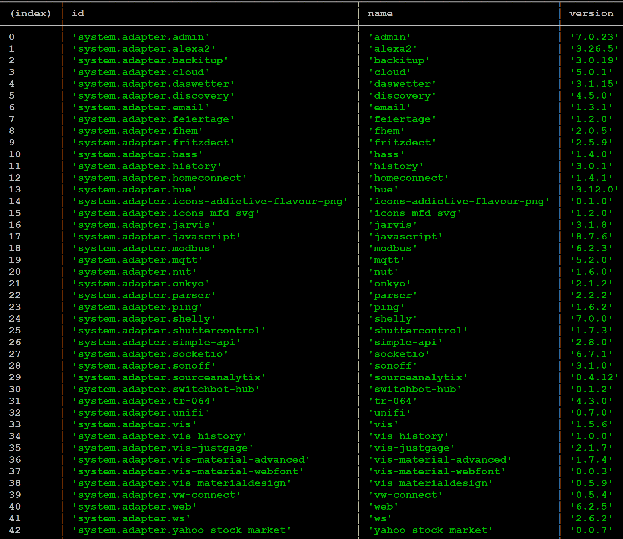

        @thomas-braun
        Hi, nein, das habe ich noch nicht gemacht.
        Hier die Ergebnisse:
        # npm audit report
        @75lb/deep-merge  <=1.1.1
        Severity: high
        @75lb/deep-merge Prototype Pollution vulnerability - https://github.com/advisori                                                                                             es/GHSA-28mc-g557-92m7
        fix available via `npm audit fix`
        node_modules/@75lb/deep-merge
        axios  0.8.1 - 0.27.2 || 1.0.0 - 1.7.3
        Severity: high
        Axios Cross-Site Request Forgery Vulnerability - https://github.com/advisories/G                                                                                             HSA-wf5p-g6vw-rhxx
        Server-Side Request Forgery in axios - https://github.com/advisories/GHSA-8hc4-v                                                                                             h64-cxmj
        fix available via `npm audit fix --force`
        Will install iobroker.unifi@0.6.3, which is a breaking change
        node_modules/@alcalzone/pak/node_modules/axios
        node_modules/axios
        node_modules/iobroker.daswetter/node_modules/axios
        node_modules/iobroker.javascript/node_modules/axios
        node_modules/iobroker.parser/node_modules/axios
        node_modules/iobroker.socketio/node_modules/axios
        node_modules/iobroker.switchbot-hub/node_modules/axios
        node_modules/iobroker.ws/node_modules/axios
        node_modules/node-hue-api/node_modules/axios
        node_modules/node-ical/node_modules/axios
        node_modules/node-unifi/node_modules/axios
          @alcalzone/pak  0.3.0 - 0.10.0
          Depends on vulnerable versions of axios
            @iobroker/js-controller-adapter  *
            Depends on vulnerable versions of @alcalzone/pak
            Depends on vulnerable versions of @iobroker/db-objects-file
            Depends on vulnerable versions of @iobroker/db-objects-jsonl
            Depends on vulnerable versions of @iobroker/db-objects-redis
            Depends on vulnerable versions of @iobroker/db-states-file
            Depends on vulnerable versions of @iobroker/db-states-jsonl
            Depends on vulnerable versions of @iobroker/db-states-redis
            Depends on vulnerable versions of @iobroker/js-controller-common
            Depends on vulnerable versions of @iobroker/js-controller-common-db
            node_modules/@iobroker/js-controller-adapter
              iobroker.js-controller  >=4.0.0-alpha.1-20210830-d9828cd3
              Depends on vulnerable versions of @iobroker/js-controller-adapter
              Depends on vulnerable versions of @iobroker/js-controller-cli
              node_modules/iobroker.js-controller
            @iobroker/js-controller-common-db  >=6.0.1-alpha.0-20240522-6037ce8ae
            node_modules/@iobroker/js-controller-common-db
              @iobroker/db-base  >=6.0.1-alpha.0-20240522-6037ce8ae
              node_modules/@iobroker/db-base
                @iobroker/db-objects-file  >=6.0.1-alpha.0-20240522-6037ce8ae
                Depends on vulnerable versions of @iobroker/db-base
                node_modules/@iobroker/db-objects-file
                @iobroker/db-objects-jsonl  >=6.0.1-alpha.0-20240522-6037ce8ae
                node_modules/@iobroker/db-objects-jsonl
                @iobroker/db-objects-redis  >=6.0.1-alpha.0-20240522-6037ce8ae
                node_modules/@iobroker/db-objects-redis
                @iobroker/db-states-file  >=6.0.1-alpha.0-20240522-6037ce8ae
                node_modules/@iobroker/db-states-file
                @iobroker/db-states-jsonl  >=6.0.1-alpha.0-20240522-6037ce8ae
                node_modules/@iobroker/db-states-jsonl
                @iobroker/db-states-redis  >=6.0.1-alpha.0-20240522-6037ce8ae
                node_modules/@iobroker/db-states-redis
              @iobroker/js-controller-cli  >=6.0.1-alpha.0-20240522-6037ce8ae
              node_modules/@iobroker/js-controller-cli
              @iobroker/js-controller-common  >=6.0.1-alpha.0-20240522-6037ce8ae
          iobroker.switchbot-hub  *
          iobroker.unifi  >=0.6.4
          Depends on vulnerable versions of node-unifi
          node_modules/iobroker.unifi
          node-hue-api  2.0.0-RC1 - 5.0.0-alpha.2
            iobroker.hue  >=0.6.2
            Depends on vulnerable versions of node-hue-api
            node_modules/iobroker.hue
          node-ical  0.15.3 - 0.16.1
            iobroker.jarvis  >=3.0.0
            Depends on vulnerable versions of ip
            Depends on vulnerable versions of node-ical
            Depends on vulnerable versions of semver
            node_modules/iobroker.jarvis
          node-unifi  >=2.3.0
        braces  <3.0.3
        Severity: high
        Uncontrolled resource consumption in braces - https://github.com/advisories/GHSA                                                                                             -grv7-fg5c-xmjg
        node_modules/braces
        debug  <=2.6.8 || 4.0.0 - 4.3.0
        Severity: high
        debug Inefficient Regular Expression Complexity vulnerability - https://github.c                                                                                             om/advisories/GHSA-9vvw-cc9w-f27h
        Regular Expression Denial of Service in debug - https://github.com/advisories/GH                                                                                             SA-gxpj-cx7g-858c
        Depends on vulnerable versions of ms
        Will install iobroker.tr-064@0.0.8, which is a breaking change
        node_modules/engine.io-client/node_modules/debug
        node_modules/iobroker.socketio/node_modules/debug
        node_modules/iobroker.web/node_modules/debug
        node_modules/mdns-discovery/node_modules/debug
        node_modules/socket.io-client/node_modules/debug
        node_modules/socket.io-parser/node_modules/debug
          engine.io  0.7.8 - 0.7.9 || 3.4.0 - 6.5.4
          Depends on vulnerable versions of debug
          Depends on vulnerable versions of ws
          node_modules/iobroker.socketio/node_modules/engine.io
          node_modules/iobroker.web/node_modules/engine.io
            socket.io  2.2.0 - 3.0.4
            Depends on vulnerable versions of engine.io
            Depends on vulnerable versions of socket.io-parser
            node_modules/iobroker.socketio/node_modules/socket.io
            node_modules/iobroker.web/node_modules/socket.io
              iobroker.socketio  3.0.0 - 3.0.13 || 3.1.3 - 3.1.5 || 4.1.0 - 5.0.2 || 6.1                                                                                             .0 - 6.5.7 || >=6.6.0
              node_modules/iobroker.web/node_modules/iobroker.socketio
                iobroker.web  4.2.1 - 4.3.0 || >=5.2.3
                Depends on vulnerable versions of iobroker.socketio
          engine.io-client  <=3.1.1 || 3.5.0 - 3.5.3 || 4.0.0-alpha.0 - 5.2.0
          Depends on vulnerable versions of parsejson
          node_modules/iobroker.web/node_modules/engine.io-client
            socket.io-client  1.0.0-pre - 2.1.1
            Depends on vulnerable versions of engine.io-client
              iobroker.cloud  <=2.4.6 || 2.8.0 - 3.0.2 || >=4.0.11
              Depends on vulnerable versions of socket.io-client
              node_modules/iobroker.cloud
