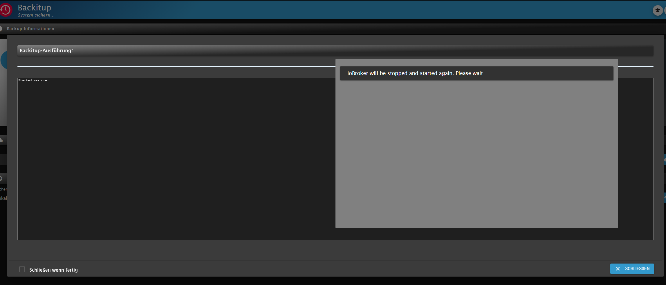

    ich möchte mit backitup auf eine neue VM übersiedeln, jedoch bekomme ich immer den selben Fehler. Könnt ihr mir weiterhelfen?
    Log:
    2024-07-29 07:54:00.446 - info: admin.0 (9680) ==> Connected system.user.admin from 192.168.1.27
    2024-07-29 07:54:14.227 - error: backitup.0 (8432) Unhandled promise rejection. This error originated either by throwing inside of an async function without a catch block, or by rejecting a promise which was not handled with .catch().
    2024-07-29 07:54:14.230 - error: backitup.0 (8432) unhandled promise rejection: spawn EINVAL
    2024-07-29 07:54:14.233 - error: backitup.0 (8432) Error: spawn EINVAL
    at ChildProcess.spawn (node:internal/child_process:421:11)
    at spawn (node:child_process:761:9)
    at startDetachedRestore (C:\ioBroker\node_modules\iobroker.backitup\lib\restore.js:74:17)
    at C:\ioBroker\node_modules\iobroker.backitup\lib\restore.js:168:21
    at getFile (C:\ioBroker\node_modules\iobroker.backitup\lib\restore.js:49:9)
    at Object.restore (C:\ioBroker\node_modules\iobroker.backitup\lib\restore.js:125:9)
    at AdapterClass. (C:\ioBroker\node_modules\iobroker.backitup\main.js:259:34)
    2024-07-29 07:54:14.233 - error: backitup.0 (8432) Exception-Code: EINVAL: spawn EINVAL
    2024-07-29 07:54:14.241 - info: backitup.0 (8432) cleaned everything up...
    2024-07-29 07:54:14.241 - info: backitup.0 (8432) terminating
    2024-07-29 07:54:14.241 - warn: backitup.0 (8432) Terminated (UNCAUGHT_EXCEPTION): Without reason
    2024-07-29 07:54:14.746 - info: backitup.0 (8432) terminating
    2024-07-29 07:54:14.765 - error: host.Microserver Caught by controller[0]: This error originated either by throwing inside of an async function without a catch block, or by rejecting a promise which was not handled with .catch(). The promise rejected with the reason:
    2024-07-29 07:54:14.766 - error: host.Microserver Caught by controller[1]: Error: spawn EINVAL
    2024-07-29 07:54:14.766 - error: host.Microserver Caught by controller[1]: at ChildProcess.spawn (node:internal/child_process:421:11)
    2024-07-29 07:54:14.766 - error: host.Microserver Caught by controller[1]: at spawn (node:child_process:761:9)
    2024-07-29 07:54:14.766 - error: host.Microserver Caught by controller[1]: at startDetachedRestore (C:\ioBroker\node_modules\iobroker.backitup\lib\restore.js:74:17)
    2024-07-29 07:54:14.766 - error: host.Microserver Caught by controller[1]: at C:\ioBroker\node_modules\iobroker.backitup\lib\restore.js:168:21
    2024-07-29 07:54:14.766 - error: host.Microserver Caught by controller[1]: at getFile (C:\ioBroker\node_modules\iobroker.backitup\lib\restore.js:49:9)
    2024-07-29 07:54:14.766 - error: host.Microserver Caught by controller[1]: at Object.restore (C:\ioBroker\node_modules\iobroker.backitup\lib\restore.js:125:9)
    2024-07-29 07:54:14.766 - error: host.Microserver Caught by controller[1]: at AdapterClass. (C:\ioBroker\node_modules\iobroker.backitup\main.js:259:34)
    2024-07-29 07:54:14.766 - error: host.Microserver instance system.adapter.backitup.0 terminated with code 6 (UNCAUGHT_EXCEPTION)
    2024-07-29 07:54:14.766 - info: host.Microserver Restart adapter system.adapter.backitup.0 because enabled
    2024-07-29 07:54:34.296 - info: admin.0 (9680) <== Disconnect system.user.admin from 192.168.1.27
    2024-07-29 07:54:44.787 - info: host.Microserver instance system.adapter.backitup.0 started with pid 9348
    2024-07-29 07:54:45.403 - info: backitup.0 (9348) starting. Version 2.10.7 in C:/ioBroker/node_modules/iobroker.backitup, node: v20.16.0, js-controller: 5.0.19
    2024-07-29 07:54:45.426 - info: backitup.0 (9348) [iobroker] backup will be activated at 02:48 every 1 day(s)
    MOD-EDIT: Bitte Log in Code-Tags posten!

    • arteckA Offline
      arteckA Offline
      arteck
      wrote on last edited by arteck
      LOG im Code tag bitte
      und dann
      @elektrobau sagte in IoBroker umsiedeln:
      ich denke du willst auf eine VM.. und dann nimmst du windows dafür ?
      E 1 Reply Last reply
