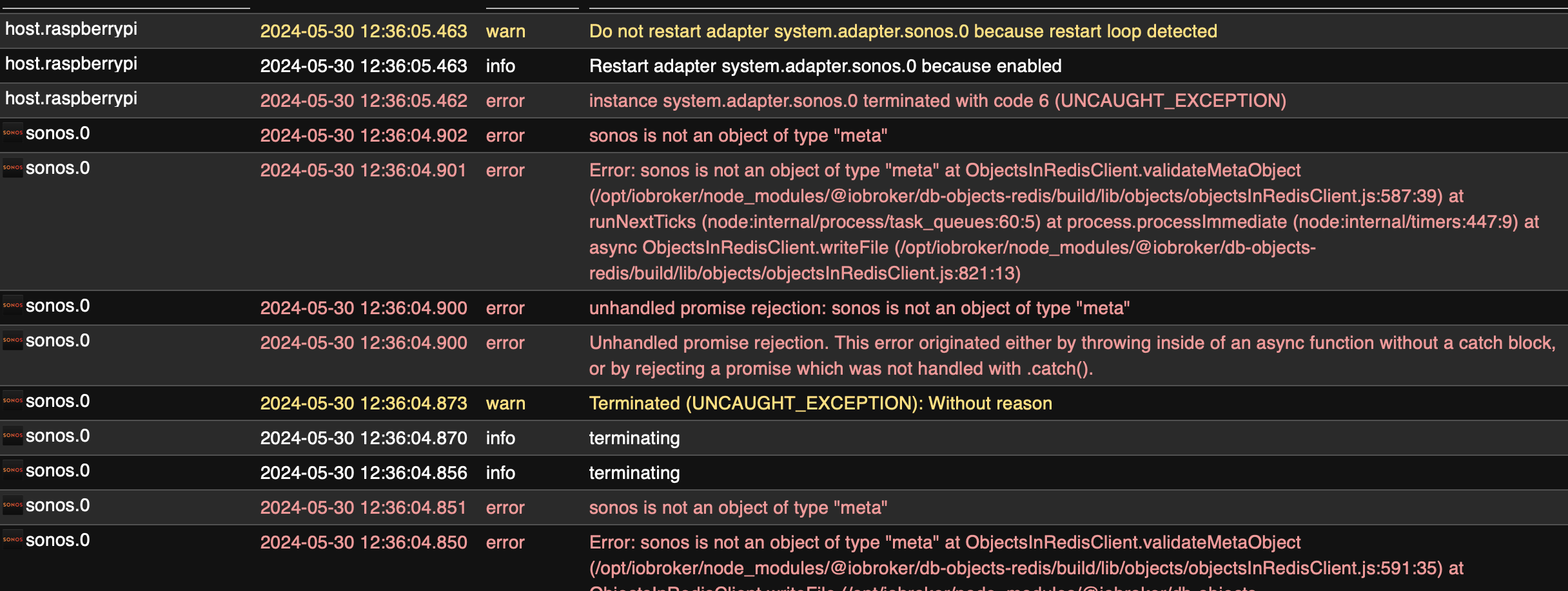

    ich habe seit ein paar Tagen Probleme mit meinem Sonos Adapter und weis nicht wie ich das Problem lösen soll. viellecht hat hier jemand eine Idee was hinter dem Fehler steckt. Bildschirmfoto 2024-05-30 um 12.36.29.png

        Dominik_neu
        schrieb am zuletzt editiert von Dominik_neu
        2024-05-30 14:19:47.130 - info: host.raspberrypi instance system.adapter.sonos.0 started with pid 6092
        2024-05-30 14:19:49.125 - info: sonos.0 (6092) starting. Version 3.0.0 in /opt/iobroker/node_modules/iobroker.sonos, node: v18.14.2, js-controller: 5.0.19
        2024-05-30 14:19:49.931 - error: sonos.0 (6092) Cannot write file coverImage/192_168_20_12.png: sonos is not an object of type "meta"
        2024-05-30 14:19:49.946 - error: sonos.0 (6092) Unhandled promise rejection. This error originated either by throwing inside of an async function without a catch block, or by rejecting a promise which was not handled with .catch().
        2024-05-30 14:19:49.946 - error: sonos.0 (6092) unhandled promise rejection: sonos is not an object of type "meta"
        2024-05-30 14:19:49.948 - error: sonos.0 (6092) Error: sonos is not an object of type "meta"
        at ObjectsInRedisClient.validateMetaObject (/opt/iobroker/node_modules/@iobroker/db-objects-redis/build/lib/objects/objectsInRedisClient.js:587:39)
        at runNextTicks (node:internal/process/task_queues:60:5)
        at process.processImmediate (node:internal/timers:447:9)
        at async ObjectsInRedisClient.writeFile (/opt/iobroker/node_modules/@iobroker/db-objects-redis/build/lib/objects/objectsInRedisClient.js:821:13)
        2024-05-30 14:19:49.949 - error: sonos.0 (6092) sonos is not an object of type "meta"
        2024-05-30 14:19:49.952 - error: sonos.0 (6092) Cannot write file coverImage/192_168_20_10.png: sonos is not an object of type "meta"
        2024-05-30 14:19:49.956 - info: sonos.0 (6092) terminating
        2024-05-30 14:19:49.966 - info: sonos.0 (6092) terminating
        2024-05-30 14:19:49.968 - warn: sonos.0 (6092) Terminated (UNCAUGHT_EXCEPTION): Without reason
        2024-05-30 14:19:49.989 - error: sonos.0 (6092) Unhandled promise rejection. This error originated either by throwing inside of an async function without a catch block, or by rejecting a promise which was not handled with .catch().
        2024-05-30 14:19:49.991 - error: sonos.0 (6092) unhandled promise rejection: sonos is not an object of type "meta"
        2024-05-30 14:19:49.992 - error: sonos.0 (6092) Error: sonos is not an object of type "meta"
        2024-05-30 14:19:49.992 - error: sonos.0 (6092) sonos is not an object of type "meta"
        2024-05-30 14:19:50.470 - info: sonos.0 (6092) terminating
        2024-05-30 14:19:50.533 - error: host.raspberrypi instance system.adapter.sonos.0 terminated with code 6 (UNCAUGHT_EXCEPTION)
        2024-05-30 14:19:50.533 - info: host.raspberrypi Restart adapter system.adapter.sonos.0 because enabled
        2024-05-30 14:20:20.597 - info: host.raspberrypi instance system.adapter.sonos.0 started with pid 6108
        2024-05-30 14:20:22.958 - info: sonos.0 (6108) starting. Version 3.0.0 in /opt/iobroker/node_modules/iobroker.sonos, node: v18.14.2, js-controller: 5.0.19
        2024-05-30 14:20:24.038 - error: sonos.0 (6108) Cannot write file coverImage/192_168_20_11.png: sonos is not an object of type "meta"
        2024-05-30 14:20:24.056 - error: sonos.0 (6108) Unhandled promise rejection. This error originated either by throwing inside of an async function without a catch block, or by rejecting a promise which was not handled with .catch().
        2024-05-30 14:20:24.057 - error: sonos.0 (6108) unhandled promise rejection: sonos is not an object of type "meta"
        2024-05-30 14:20:24.059 - error: sonos.0 (6108) Error: sonos is not an object of type "meta"
        2024-05-30 14:20:24.060 - error: sonos.0 (6108) sonos is not an object of type "meta"
        2024-05-30 14:20:24.062 - error: sonos.0 (6108) Cannot write file coverImage/192_168_20_10.png: sonos is not an object of type "meta"
        2024-05-30 14:20:24.064 - error: sonos.0 (6108) Cannot write file coverImage/192_168_20_12.png: sonos is not an object of type "meta"
        2024-05-30 14:20:24.068 - info: sonos.0 (6108) terminating
        2024-05-30 14:20:24.077 - info: sonos.0 (6108) terminating
        2024-05-30 14:20:24.078 - warn: sonos.0 (6108) Terminated (UNCAUGHT_EXCEPTION): Without reason
        2024-05-30 14:20:24.094 - error: sonos.0 (6108) Unhandled promise rejection. This error originated either by throwing inside of an async function without a catch block, or by rejecting a promise which was not handled with .catch().
        2024-05-30 14:20:24.096 - error: sonos.0 (6108) unhandled promise rejection: sonos is not an object of type "meta"
        2024-05-30 14:20:24.096 - error: sonos.0 (6108) Error: sonos is not an object of type "meta"
        2024-05-30 14:20:24.097 - error: sonos.0 (6108) sonos is not an object of type "meta"
        2024-05-30 14:20:24.103 - error: sonos.0 (6108) Unhandled promise rejection. This error originated either by throwing inside of an async function without a catch block, or by rejecting a promise which was not handled with .catch().
        2024-05-30 14:20:24.103 - error: sonos.0 (6108) unhandled promise rejection: sonos is not an object of type "meta"
        2024-05-30 14:20:24.106 - error: sonos.0 (6108) Error: sonos is not an object of type "meta"
        2024-05-30 14:20:24.106 - error: sonos.0 (6108) sonos is not an object of type "meta"
        2024-05-30 14:20:24.580 - info: sonos.0 (6108) terminating
        2024-05-30 14:20:24.650 - error: host.raspberrypi instance system.adapter.sonos.0 terminated with code 6 (UNCAUGHT_EXCEPTION)
        2024-05-30 14:20:24.651 - info: host.raspberrypi Restart adapter system.adapter.sonos.0 because enabled
        2024-05-30 14:20:54.766 - info: host.raspberrypi instance system.adapter.sonos.0 started with pid 6123
        2024-05-30 14:20:57.156 - info: sonos.0 (6123) starting. Version 3.0.0 in /opt/iobroker/node_modules/iobroker.sonos, node: v18.14.2, js-controller: 5.0.19
        2024-05-30 14:20:58.345 - error: sonos.0 (6123) Cannot write file coverImage/192_168_20_11.png: sonos is not an object of type "meta"
        2024-05-30 14:20:58.355 - error: sonos.0 (6123) Cannot write file coverImage/192_168_20_12.png: sonos is not an object of type "meta"
        2024-05-30 14:20:58.373 - error: sonos.0 (6123) Unhandled promise rejection. This error originated either by throwing inside of an async function without a catch block, or by rejecting a promise which was not handled with .catch().
        2024-05-30 14:20:58.375 - error: sonos.0 (6123) unhandled promise rejection: sonos is not an object of type "meta"
        2024-05-30 14:20:58.377 - error: sonos.0 (6123) Error: sonos is not an object of type "meta"
        2024-05-30 14:20:58.378 - error: sonos.0 (6123) sonos is not an object of type "meta"
        2024-05-30 14:20:58.384 - error: sonos.0 (6123) Cannot write file coverImage/192_168_20_10.png: sonos is not an object of type "meta"
        2024-05-30 14:20:58.388 - error: sonos.0 (6123) Unhandled promise rejection. This error originated either by throwing inside of an async function without a catch block, or by rejecting a promise which was not handled with .catch().
        2024-05-30 14:20:58.390 - error: sonos.0 (6123) unhandled promise rejection: sonos is not an object of type "meta"
        2024-05-30 14:20:58.394 - error: sonos.0 (6123) Error: sonos is not an object of type "meta"
        at ObjectsInRedisClient.validateMetaObject (/opt/iobroker/node_modules/@iobroker/db-objects-redis/build/lib/objects/objectsInRedisClient.js:591:35)
        at ObjectsInRedisClient.writeFile (/opt/iobroker/node_modules/@iobroker/db-objects-redis/build/lib/objects/objectsInRedisClient.js:821:24)
        at AdapterClass.writeFile (/opt/iobroker/node_modules/@iobroker/js-controller-adapter/build/lib/adapter/adapter.js:4816:73)
        at /opt/iobroker/node_modules/@iobroker/js-controller-common/build/lib/common/tools.js:2022:16
        at new Promise ()
        at AdapterClass.writeFileAsync (/opt/iobroker/node_modules/@iobroker/js-controller-common/build/lib/common/tools.js:2021:16)
        at takeSonosState (/opt/iobroker/node_modules/iobroker.sonos/main.js:1456:31)
        at processSonosEvents (/opt/iobroker/node_modules/iobroker.sonos/main.js:1693:17)
        at SonosSystem. (/opt/iobroker/node_modules/iobroker.sonos/main.js:2105:13)
        at SonosSystem.emit (node:events:513:28)
        2024-05-30 14:20:58.395 - error: sonos.0 (6123) sonos is not an object of type "meta"
        2024-05-30 14:20:58.399 - info: sonos.0 (6123) terminating
        2024-05-30 14:20:58.412 - info: sonos.0 (6123) terminating
        2024-05-30 14:20:58.413 - warn: sonos.0 (6123) Terminated (UNCAUGHT_EXCEPTION): Without reason
        2024-05-30 14:20:58.437 - error: sonos.0 (6123) Unhandled promise rejection. This error originated either by throwing inside of an async function without a catch block, or by rejecting a promise which was not handled with .catch().
        2024-05-30 14:20:58.437 - error: sonos.0 (6123) unhandled promise rejection: sonos is not an object of type "meta"
        2024-05-30 14:20:58.438 - error: sonos.0 (6123) Error: sonos is not an object of type "meta"
        2024-05-30 14:20:58.439 - error: sonos.0 (6123) sonos is not an object of type "meta"
        2024-05-30 14:20:58.916 - info: sonos.0 (6123) terminating
        2024-05-30 14:20:58.993 - error: host.raspberrypi instance system.adapter.sonos.0 terminated with code 6 (UNCAUGHT_EXCEPTION)
        2024-05-30 14:20:58.994 - info: host.raspberrypi Restart adapter system.adapter.sonos.0 because enabled
        2024-05-30 14:20:58.994 - warn: host.raspberrypi Do not restart adapter system.adapter.sonos.0 because restart loop detected
        2024-05-30 14:25:18.683 - warn: admin.0 (5545) sonos has an invalid jsonConfig: [{"instancePath":"/items/devicesTab/items/_sendto","schemaPath":"#/definitions/sendToProps/additionalProperties","keyword":"additionalProperties","params":{"additionalProperty":"timeout"},"message":"must NOT have additional properties"},{"instancePath":"/items/devicesTab","schemaPath":"#/properties/items/patternProperties/%5E.%2B/allOf/8/if","keyword":"if","params":{"failingKeyword":"then"},"message":"must match \"then\" schema"},{"instancePath":"","schemaPath":"#/if","keyword":"if","params":{"failingKeyword":"then"},"message":"must match \"then\" schema"}]
        2024-05-30 14:25:25.881 - info: admin.0 (5545) ==> Connected system.user.admin from ::ffff:192.168.50.50
        2024-05-30 14:26:19.956 - info: admin.0 (5545) <== Disconnect system.user.admin from ::ffff:192.168.50.50 javascript

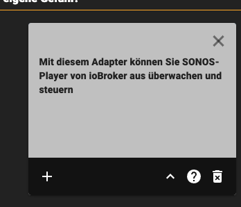

          @dominik_neu Hänge mich hier mal ran. Habe den Sonos Adapter neu installiert da ich immer viele Warnungen/Abstürze von dem Adapter erhalten habe. Jetzt geht aber leider gar nichts mehr und die Instanz geht auf rot.
          Habe auch die Meldung "Restart loop detected". Ein iob stop und iob fix haben nichts gebracht.

          2024-06-02 11:48:12.037  - error: host.ioBroker2 instance system.adapter.sonos.0 terminated with code 6 (UNCAUGHT_EXCEPTION)
          2024-06-02 11:48:12.038  - info: host.ioBroker2 Restart adapter system.adapter.sonos.0 because enabled
          2024-06-02 11:48:34.343  - info: connector-local-control.0 (1194295) receive server message from 192.168.178.56: 32100: {"msgType":"Heartbeat","mac":"f008d179f228","deviceType":"02000001","token":"37412C478E0FBEAB","data":{"currentState":1,"numberOfDevices":1,"RSSI":-43}}
          2024-06-02 11:48:34.345  - info: connector-local-control.0 (1194295) Heartbeat
          2024-06-02 11:48:42.260  - info: host.ioBroker2 instance system.adapter.sonos.0 started with pid 1196660
          2024-06-02 11:48:45.467  - info: sonos.0 (1196660) starting. Version 3.0.0 in /opt/iobroker/node_modules/iobroker.sonos, node: v18.20.2, js-controller: 5.0.19
          2024-06-02 11:48:46.671  - error: sonos.0 (1196660) Unhandled promise rejection. This error originated either by throwing inside of an async function without a catch block, or by rejecting a promise which was not handled with .catch().
          2024-06-02 11:48:46.672  - error: sonos.0 (1196660) unhandled promise rejection: Cannot read properties of undefined (reading 'id')
          2024-06-02 11:48:46.675  - error: sonos.0 (1196660) TypeError: Cannot read properties of undefined (reading 'id')
              at syncConfig (/opt/iobroker/node_modules/iobroker.sonos/main.js:2029:71)
          2024-06-02 11:48:46.677  - error: sonos.0 (1196660) Cannot read properties of undefined (reading 'id')
          2024-06-02 11:48:46.692  - info: sonos.0 (1196660) terminating
          2024-06-02 11:48:46.693  - info: sonos.0 (1196660) terminating
          2024-06-02 11:48:46.695  - warn: sonos.0 (1196660) Terminated (UNCAUGHT_EXCEPTION): Without reason
          2024-06-02 11:48:47.199  - info: sonos.0 (1196660) terminating
          2024-06-02 11:48:47.402  - error: host.ioBroker2 instance system.adapter.sonos.0 terminated with code 6 (UNCAUGHT_EXCEPTION)
          2024-06-02 11:48:47.402  - info: host.ioBroker2 Restart adapter system.adapter.sonos.0 because enabled
          2024-06-02 11:49:17.682  - info: host.ioBroker2 instance system.adapter.sonos.0 started with pid 1196804
          2024-06-02 11:49:20.994  - info: sonos.0 (1196804) starting. Version 3.0.0 in /opt/iobroker/node_modules/iobroker.sonos, node: v18.20.2, js-controller: 5.0.19
          2024-06-02 11:49:22.232  - error: sonos.0 (1196804) Unhandled promise rejection. This error originated either by throwing inside of an async function without a catch block, or by rejecting a promise which was not handled with .catch().
          2024-06-02 11:49:22.234  - error: sonos.0 (1196804) unhandled promise rejection: Cannot read properties of undefined (reading 'id')
          2024-06-02 11:49:22.238  - error: sonos.0 (1196804) TypeError: Cannot read properties of undefined (reading 'id')
          2024-06-02 11:49:22.240  - error: sonos.0 (1196804) Cannot read properties of undefined (reading 'id')
          2024-06-02 11:49:22.254  - info: sonos.0 (1196804) terminating
          2024-06-02 11:49:22.256  - info: sonos.0 (1196804) terminating
          2024-06-02 11:49:22.259  - warn: sonos.0 (1196804) Terminated (UNCAUGHT_EXCEPTION): Without reason
          2024-06-02 11:49:22.764  - info: sonos.0 (1196804) terminating
          2024-06-02 11:49:23.034  - error: host.ioBroker2 instance system.adapter.sonos.0 terminated with code 6 (UNCAUGHT_EXCEPTION)
          2024-06-02 11:49:23.035  - info: host.ioBroker2 Restart adapter system.adapter.sonos.0 because enabled
          2024-06-02 11:49:23.035  - warn: host.ioBroker2 Do not restart adapter system.adapter.sonos.0 because restart loop detected```
          • S SmartHomie
            2024-06-02 11:45:05.138  - warn: admin.0 (1193178) sonos has an invalid jsonConfig: [{"instancePath":"/items/devicesTab/items/_sendto","schemaPath":"#/definitions/sendToProps/additionalProperties","keyword":"additionalProperties","params":{"additionalProperty":"timeout"},"message":"must NOT have additional properties"},{"instancePath":"/items/devicesTab","schemaPath":"#/properties/items/patternProperties/%5E.%2B/allOf/8/if","keyword":"if","params":{"failingKeyword":"then"},"message":"must match \"then\" schema"},{"instancePath":"","schemaPath":"#/if","keyword":"if","params":{"failingKeyword":"then"},"message":"must match \"then\" schema"}]
            2024-06-02 11:48:06.599  - info: host.ioBroker2 instance system.adapter.sonos.0 started with pid 1196483
            2024-06-02 11:48:09.964  - info: sonos.0 (1196483) starting. Version 3.0.0 in /opt/iobroker/node_modules/iobroker.sonos, node: v18.20.2, js-controller: 5.0.19
            2024-06-02 11:48:11.252  - error: sonos.0 (1196483) Unhandled promise rejection. This error originated either by throwing inside of an async function without a catch block, or by rejecting a promise which was not handled with .catch().
            2024-06-02 11:48:11.255  - error: sonos.0 (1196483) unhandled promise rejection: Cannot read properties of undefined (reading 'id')
            2024-06-02 11:48:11.259  - error: sonos.0 (1196483) TypeError: Cannot read properties of undefined (reading 'id')
            2024-06-02 11:48:11.261  - error: sonos.0 (1196483) Cannot read properties of undefined (reading 'id')
            2024-06-02 11:48:11.276  - info: sonos.0 (1196483) terminating
            2024-06-02 11:48:11.279  - info: sonos.0 (1196483) terminating
            2024-06-02 11:48:11.281  - warn: sonos.0 (1196483) Terminated (UNCAUGHT_EXCEPTION): Without reason
            2024-06-02 11:48:11.787  - info: sonos.0 (1196483) terminating

                mameier1234
                Ich hatte die selben Meldungen ..
                Lösung: Instanz UND Adapter löschen und neu einrichten. Nur die Instanz löschen und wieder anlegen hat es nicht gebracht.
                Grüße,
                Martin

                      • M mameier1234
                        SmartHomie
                        @mameier1234 DANKKEEE. Das hat bei mir jetzt auch funktioniert. 👍

                          sonos.0
                          2024-06-30 12:10:15.884	debug	Redis States: Use Redis connection: 127.0.0.1:9000
                          sonos.0
                          2024-06-30 12:10:15.826	debug	Objects connected to redis: 127.0.0.1:9001
                          sonos.0
                          2024-06-30 12:10:15.822	debug	Objects client initialize lua scripts
                          sonos.0
                          2024-06-30 12:10:15.722	debug	Objects create User PubSub Client
                          sonos.0
                          2024-06-30 12:10:15.722	debug	Objects create System PubSub Client
                          sonos.0
                          2024-06-30 12:10:15.720	debug	Objects client ready ... initialize now
                          sonos.0
                          2024-06-30 12:10:15.671	debug	Redis Objects: Use Redis connection: 127.0.0.1:9001
                          S 1 Antwort Letzte Antwort

                                    • M mameier1234
                                      mpa9
                                      @mameier1234 hab das selbe Problem und steh gerade auf dem Schlauch. Instanz neu installieren ist mir klar. Aber was meinst du mit Adapter neu installieren?
                                      • M mpa9
                                        mameier1234
                                        schrieb am zuletzt editiert von mameier1234
                                        @mpa9 Nunja..
                                        Wie gesagt, unter Instanz.. die Instanz löschen, dann unter Adapter den Adapter deinstallieren / löschen... Dann wieder neu installieren..
                                        Hier auf den Mülleimer klicken...
                                        Grüße,
                                        Martin
                                        • M mameier1234
                                          @mpa9 Nunja..
                                          mpa9
                                          @mameier1234 Nunja.. Problem besteht weiterhin, Lösungsansatz scheint nicht mehr zu funktionieren.
