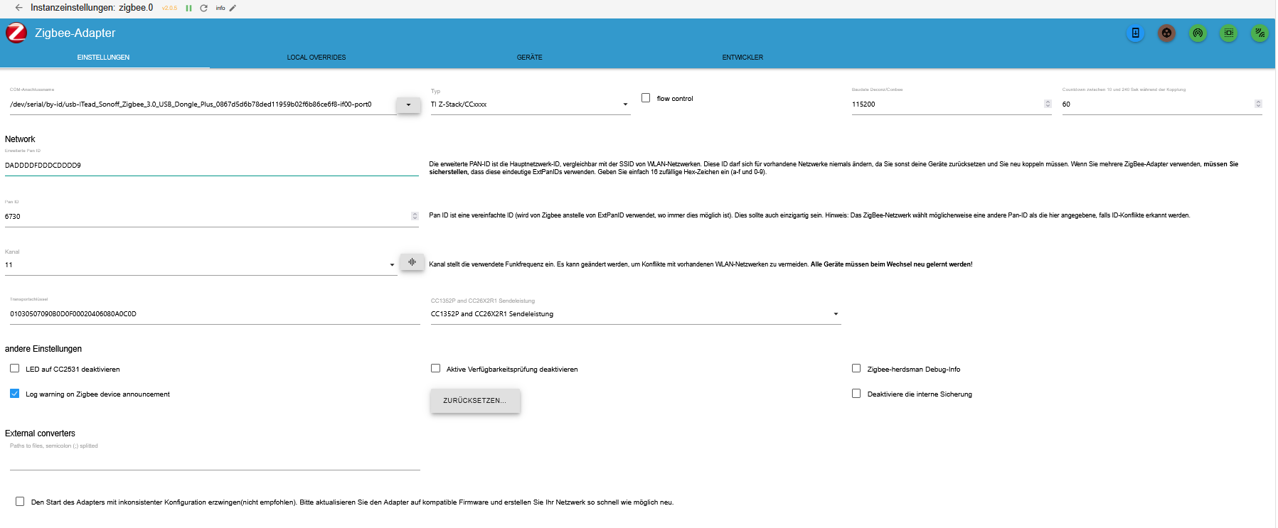

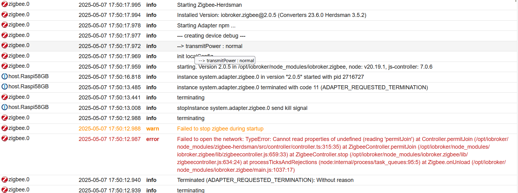

        Ok, das habe ich missverstanden!
        Der Koordinator ist im Raspi 5 und der Zigbee Adapter installiert.
        Hier das Protokoll:
        und hier das iob diag:

        2025-05-07 17:50:12.936  - info: zigbee.0 (2716711) cleaned everything up...
        2025-05-07 17:50:12.937  - info: zigbee.0 (2716711) local config saved
        2025-05-07 17:50:12.938  - info: zigbee.0 (2716711) Saved local configuration data
        2025-05-07 17:50:12.939  - info: zigbee.0 (2716711) terminating
        2025-05-07 17:50:12.940  - info: zigbee.0 (2716711) Terminated (ADAPTER_REQUESTED_TERMINATION): Without reason
        2025-05-07 17:50:12.987  - error: zigbee.0 (2716711) Failed to open the network: TypeError: Cannot read properties of undefined (reading 'permitJoin')
            at Controller.permitJoin (/opt/iobroker/node_modules/zigbee-herdsman/src/controller/controller.ts:315:35)
            at ZigbeeController.permitJoin (/opt/iobroker/node_modules/iobroker.zigbee/lib/zigbeecontroller.js:659:33)
            at ZigbeeController.stop (/opt/iobroker/node_modules/iobroker.zigbee/lib/zigbeecontroller.js:634:24)
            at processTicksAndRejections (node:internal/process/task_queues:95:5)
            at Zigbee.onUnload (/opt/iobroker/node_modules/iobroker.zigbee/main.js:1037:17)
        2025-05-07 17:50:12.988  - warn: zigbee.0 (2716711) Failed to stop zigbee during startup
        2025-05-07 17:50:12.988  - info: zigbee.0 (2716711) terminating
        2025-05-07 17:50:13.008  - info: host.Raspi58GB stopInstance system.adapter.zigbee.0 send kill signal
        2025-05-07 17:50:13.441  - info: zigbee.0 (2716711) terminating
        2025-05-07 17:50:13.485  - info: host.Raspi58GB instance system.adapter.zigbee.0 terminated with code 11 (ADAPTER_REQUESTED_TERMINATION)
        2025-05-07 17:50:16.818  - info: host.Raspi58GB instance system.adapter.zigbee.0 in version "2.0.5" started with pid 2716727
        2025-05-07 17:50:17.959  - info: zigbee.0 (2716727) starting. Version 2.0.5 in /opt/iobroker/node_modules/iobroker.zigbee, node: v20.19.1, js-controller: 7.0.6
        2025-05-07 17:50:17.969  - info: zigbee.0 (2716727) init localConfig
        2025-05-07 17:50:17.972  - info: zigbee.0 (2716727)   --> transmitPower : normal
        2025-05-07 17:50:17.977  - info: zigbee.0 (2716727) --- creating device debug ---
        2025-05-07 17:50:17.978  - info: zigbee.0 (2716727) Starting Adapter npm ...
        2025-05-07 17:50:17.994  - info: zigbee.0 (2716727) Installed Version: iobroker.zigbee@2.0.5 (Converters 23.6.0 Herdsman 3.5.2)
        2025-05-07 17:50:17.995  - info: zigbee.0 (2716727) Starting Zigbee-Herdsman
        2025-05-07 17:53:36.342  - info: smartmeter.0 (2716443) Received 13 values, 6 updated
          Hier das Protokoll:
          #39
          @searcher57 sagte in FritzBox Zigbee Antenne in ioBroker einbinden?:
          Hier das Protokoll:
          bitte keinen Screenshot!
          als Text in code-tags posten.
          S 1 Antwort Letzte Antwort
            Hier das Protokoll:
            searcher57
            #40
            @homoran said in FritzBox Zigbee Antenne in ioBroker einbinden?:
            Hier das Protokoll:
            Bitte erkläre das!
            HomoranH S 2 Antworten Letzte Antwort
            • S searcher57
              Hier das Protokoll:
              Bitte erkläre das!
              #41
              Bitte erkläre das!
              Jetzt bin ich überfordert, was genau bedarf zusätzlicher Erklärung?

                host.Raspi58GB
                	2025-05-07 17:50:13.485	info	instance system.adapter.zigbee.0 terminated with code 11 (ADAPTER_REQUESTED_TERMINATION)
                zigbee.0
                	2025-05-07 17:50:13.441	info	terminating
                host.Raspi58GB
                	2025-05-07 17:50:13.008	info	stopInstance system.adapter.zigbee.0 send kill signal
                zigbee.0
                	2025-05-07 17:50:12.988	info	terminating
                zigbee.0
                	2025-05-07 17:50:12.988	warn	Failed to stop zigbee during startup
                zigbee.0
                	2025-05-07 17:50:12.987	error	Failed to open the network: TypeError: Cannot read properties of undefined (reading 'permitJoin') at Controller.permitJoin (/opt/iobroker/node_modules/zigbee-herdsman/src/controller/controller.ts:315:35) at ZigbeeController.permitJoin (/opt/iobroker/node_modules/iobroker.zigbee/lib/zigbeecontroller.js:659:33) at ZigbeeController.stop (/opt/iobroker/node_modules/iobroker.zigbee/lib/zigbeecontroller.js:634:24) at processTicksAndRejections (node:internal/process/task_queues:95:5) at Zigbee.onUnload (/opt/iobroker/node_modules/iobroker.zigbee/main.js:1037:17)
                zigbee.0
                	2025-05-07 17:50:12.940	info	Terminated (ADAPTER_REQUESTED_TERMINATION): Without reason

                • S searcher57
                  @searcher57 said in FritzBox Zigbee Antenne in ioBroker einbinden?:
                  Hier das Protokoll:
                  Bitte erkläre das!

                  zigbee.0
                  	2025-05-07 17:50:17.995	info	Starting Zigbee-Herdsman
                  zigbee.0
                  	2025-05-07 17:50:17.994	info	Installed Version: iobroker.zigbee@2.0.5 (Converters 23.6.0 Herdsman 3.5.2)
                  zigbee.0
                  	2025-05-07 17:50:17.978	info	Starting Adapter npm ...
                  zigbee.0
                  	2025-05-07 17:50:17.977	info	--- creating device debug ---
                  zigbee.0
                  	2025-05-07 17:50:17.972	info	--> transmitPower : normal
                  zigbee.0
                  	2025-05-07 17:50:17.969	info	init localConfig
                  zigbee.0
                  	2025-05-07 17:50:17.959	info	starting. Version 2.0.5 in /opt/iobroker/node_modules/iobroker.zigbee, node: v20.19.1, js-controller: 7.0.6
                  host.Raspi58GB
                  	2025-05-07 17:50:16.818	info	instance system.adapter.zigbee.0 in version "2.0.5" started with pid 2716727
                  host.Raspi58GB
                  zigbee.0
                  host.Raspi58GB
                  zigbee.0
                  zigbee.0
                  zigbee.0
                  zigbee.0
                  zigbee.0
                  	2025-05-07 17:50:12.939	info	terminating
                  zigbee.0
                  	2025-05-07 17:50:12.938	info	Saved local configuration data
                  zigbee.0
                  	2025-05-07 17:50:12.937	info	local config saved
                  zigbee.0
                  	2025-05-07 17:50:12.936	info	cleaned everything up...
                  zigbee.0
                  	2025-05-07 17:50:12.935	info	Got terminate signal TERMINATE_YOURSELF
                  host.Raspi58GB
                  	2025-05-07 17:50:12.932	info	stopInstance system.adapter.zigbee.0 (force=false, process=true)
                  zigbee.0
                  	2025-05-07 17:50:07.445	info	Starting Zigbee-Herdsman
                  zigbee.0
                  	2025-05-07 17:50:07.444	info	Installed Version: iobroker.zigbee@2.0.5 (Converters 23.6.0 Herdsman 3.5.2)
                  zigbee.0
                  	2025-05-07 17:50:07.428	info	Starting Adapter npm ...
                  zigbee.0
                  	2025-05-07 17:50:07.427	info	--- creating device debug ---
                  zigbee.0
                  	2025-05-07 17:50:07.422	info	--> transmitPower : normal
                  zigbee.0
                  	2025-05-07 17:50:07.419	info	init localConfig
                  zigbee.0
                  	2025-05-07 17:50:07.409	info	starting. Version 2.0.5 in /opt/iobroker/node_modules/iobroker.zigbee, node: v20.19.1, js-controller: 7.0.6
                  host.Raspi58GB
                  	2025-05-07 17:50:06.159	info	instance system.adapter.zigbee.0 in version "2.0.5" started with pid 2716711
                  admin.0
                  	2025-05-07 17:49:59.324	info	<== Disconnect system.user.admin from ::ffff:192.168.178.120
                  host.Raspi58GB
                  	2025-05-07 17:49:35.710	info	Restart adapter system.adapter.zigbee.0 because enabled
                  host.Raspi58GB
                  	2025-05-07 17:49:35.710	error	instance system.adapter.zigbee.0 terminated with code 6 (UNCAUGHT_EXCEPTION)
                  host.Raspi58GB
                  	2025-05-07 17:49:35.710	error	Caught by controller[1]: at processImmediate (node:internal/timers:483:21)
                  host.Raspi58GB
                  	2025-05-07 17:49:35.710	error	Caught by controller[1]: at Immediate.<anonymous> (file:///opt/iobroker/node_modules/@iobroker/db-states-redis/src/lib/states/statesInRedisClient.ts:368:37)
                  host.Raspi58GB
                  	2025-05-07 17:49:35.710	error	Caught by controller[1]: at change (/opt/iobroker/node_modules/@iobroker/js-controller-adapter/src/lib/adapter/adapter.ts:10953:34)
                  host.Raspi58GB
                  	2025-05-07 17:49:35.710	error	Caught by controller[1]: at Zigbee.emit (node:domain:489:12)
                  host.Raspi58GB
                  	2025-05-07 17:49:35.710	error	Caught by controller[1]: at Zigbee.emit (node:events:536:35)
                  host.Raspi58GB
                  	2025-05-07 17:49:35.710	error	Caught by controller[1]: at Zigbee.<anonymous> (/opt/iobroker/node_modules/iobroker.zigbee/lib/commands.js:20:48)
                  host.Raspi58GB
                  	2025-05-07 17:49:35.710	error	Caught by controller[1]: at Commands.onMessage (/opt/iobroker/node_modules/iobroker.zigbee/lib/commands.js:155:97)
                  host.Raspi58GB
                  	2025-05-07 17:49:35.710	error	Caught by controller[1]: TypeError: Cannot read properties of undefined (reading 'CleanupRequired')
                  host.Raspi58GB
                  	2025-05-07 17:49:35.710	error	Caught by controller[0]: This error originated either by throwing inside of an async function without a catch block, or by rejecting a promise which was not handled with .catch(). The promise rejected with the reason:
                  zigbee.0
                  	2025-05-07 17:49:35.667	info	terminating
                  zigbee.0
                  	2025-05-07 17:49:35.191	info	terminating
                  zigbee.0
                  	2025-05-07 17:49:35.191	warn	Failed to stop zigbee during startup
                  zigbee.0
                  	2025-05-07 17:49:35.187	error	Failed to open the network: TypeError: Cannot read properties of undefined (reading 'permitJoin') at Controller.permitJoin (/opt/iobroker/node_modules/zigbee-herdsman/src/controller/controller.ts:315:35) at ZigbeeController.permitJoin (/opt/iobroker/node_modules/iobroker.zigbee/lib/zigbeecontroller.js:659:33) at ZigbeeController.stop (/opt/iobroker/node_modules/iobroker.zigbee/lib/zigbeecontroller.js:634:24) at processTicksAndRejections (node:internal/process/task_queues:95:5) at Zigbee.onUnload (/opt/iobroker/node_modules/iobroker.zigbee/main.js:1037:17)
                  zigbee.0
                  	2025-05-07 17:49:35.167	warn	Terminated (UNCAUGHT_EXCEPTION): Without reason
                  zigbee.0
                  	2025-05-07 17:49:35.167	info	terminating
                  zigbee.0
                  	2025-05-07 17:49:35.166	info	Saved local configuration data
                  zigbee.0
                  	2025-05-07 17:49:35.165	info	local config saved
                  zigbee.0
                  	2025-05-07 17:49:35.165	info	cleaned everything up...
                  zigbee.0
                  	2025-05-07 17:49:35.151	error	Cannot read properties of undefined (reading 'CleanupRequired')
                  zigbee.0
                  	2025-05-07 17:49:35.150	error	TypeError: Cannot read properties of undefined (reading 'CleanupRequired') at Commands.onMessage (/opt/iobroker/node_modules/iobroker.zigbee/lib/commands.js:155:97) at Zigbee.<anonymous> (/opt/iobroker/node_modules/iobroker.zigbee/lib/commands.js:20:48) at Zigbee.emit (node:events:536:35) at Zigbee.emit (node:domain:489:12) at change (/opt/iobroker/node_modules/@iobroker/js-controller-adapter/src/lib/adapter/adapter.ts:10953:34) at Immediate.<anonymous> (file:///opt/iobroker/node_modules/@iobroker/db-states-redis/src/lib/states/statesInRedisClient.ts:368:37) at processImmediate (node:internal/timers:483:21)
                  zigbee.0
                  	2025-05-07 17:49:35.031	error	unhandled promise rejection: Cannot read properties of undefined (reading 'CleanupRequired')
                  zigbee.0
                  	2025-05-07 17:49:35.031	error	Unhandled promise rejection. This error originated either by throwing inside of an async function without a catch block, or by rejecting a promise which was not handled with .catch().

                  @searcher57 Dein Log zeigt das du den Adapter angehalten hast bevor das Zigbee-Subsystem vollständig gestartet war. Besagter Start kann insbesondere bei einem ersten Start mit 'neuer' Konifiguration bis zu 5 Minuten dauern.
                  Bitte folgendes machen:
                  • Zigbee Adapter anhalten.
                  • 60 s Warten
                  • Log löschen
                  • Zigbee Adapter starten
                  • Umschalten auf die Log-Ansicht
                  • Abwarten bis einer von 2 Events eintritt:
                    -- Fehlermeldung das der Adapter nicht gestartet werden kann
                    -- Meldung das der Adapter erfolgreich gestartet wurde.
                  Besagte Meldungen dann hier posten.
                  A.

                    Ich hoffe, dass ich nicht wieder zu ungeduldig war!
                    admin.0
                    	2025-05-07 19:33:41.984	info	==> Connected system.user.admin from ::ffff:192.168.178.120
                    admin.0
                    	2025-05-07 19:33:41.530	info	<== Disconnect system.user.admin from ::ffff:192.168.178.120 admin
                    admin.0
                    	2025-05-07 19:33:41.525	info	==> Connected system.user.admin from ::ffff:192.168.178.120
                    admin.0
                    	2025-05-07 19:33:41.483	info	<== Disconnect system.user.admin from ::ffff:192.168.178.120 admin
                    smartmeter.0
                    	2025-05-07 19:29:29.882	info	Received 13 values, 4 updated
                    smartmeter.0
                    	2025-05-07 19:24:25.886	info	Received 13 values, 6 updated
                    host.Raspi58GB
                    	2025-05-07 19:22:42.280	error	cannot call visUtils: Not exists
                    admin.0
                    	2025-05-07 19:22:42.049	info	==> Connected system.user.admin from ::ffff:192.168.178.120
                    admin.0
                    	2025-05-07 19:22:41.610	info	<== Disconnect system.user.admin from ::ffff:192.168.178.120 admin
                    admin.0
                    	2025-05-07 19:22:41.602	info	==> Connected system.user.admin from ::ffff:192.168.178.120
                    admin.0
                    	2025-05-07 19:22:41.549	info	<== Disconnect system.user.admin from ::ffff:192.168.178.120 admin
                    smartmeter.0
                    	2025-05-07 19:19:25.076	info	Received 13 values, 6 updated
                    admin.0
                    	2025-05-07 19:18:55.025	info	<== Disconnect system.user.admin from ::ffff:192.168.178.120 javascript
                    admin.0
                    	2025-05-07 19:18:53.355	info	==> Connected system.user.admin from ::ffff:192.168.178.120
                    host.Raspi58GB
                    	2025-05-07 19:16:51.969	info	instance system.adapter.openweathermap.0 having pid 2721694 terminated with code 0 (NO_ERROR)
                    openweathermap.0
                    	2025-05-07 19:16:51.460	info	Terminated (NO_ERROR): Without reason
                    openweathermap.0
                    	2025-05-07 19:16:43.034	info	starting. Version 1.1.2 in /opt/iobroker/node_modules/iobroker.openweathermap, node: v20.19.1, js-controller: 7.0.6
                    host.Raspi58GB
                    	2025-05-07 19:16:42.019	info	instance system.adapter.openweathermap.0 in version "1.1.2" started with pid 2721694
                    smartmeter.0
                    	2025-05-07 19:14:21.120	info	Received 13 values, 4 updated
                    zigbee.0
                    	2025-05-07 19:12:59.441	info	Starting Zigbee-Herdsman
                    zigbee.0
                    	2025-05-07 19:12:59.440	info	Installed Version: iobroker.zigbee@2.0.5 (Converters 23.6.0 Herdsman 3.5.2)
                    zigbee.0
                    	2025-05-07 19:12:59.424	info	Starting Adapter npm ...
                    zigbee.0
                    	2025-05-07 19:12:59.423	info	--- creating device debug ---
                    zigbee.0
                    	2025-05-07 19:12:59.418	info	--> transmitPower : normal
                    zigbee.0
                    	2025-05-07 19:12:59.415	info	init localConfig
                    zigbee.0
                    	2025-05-07 19:12:59.405	info	starting. Version 2.0.5 in /opt/iobroker/node_modules/iobroker.zigbee, node: v20.19.1, js-controller: 7.0.6
                    host.Raspi58GB
                    	2025-05-07 19:12:58.274	info	instance system.adapter.zigbee.0 in version "2.0.5" started with pid 2721587

                      @searcher57 Im Log steht nichts drin. Bitte mal die Einstellungen des Zigbee Adapters zeigen.
                      Anscheinend wird versucht den Herdsman zu starten, aber der kommt nicht zurück.
                      A.

                        Zigbee-Adapter
                            Einstellungen
                            Local Overrides
                            Geräte
                            Entwickler
                        COM-Anschlussname
                        arrow_drop_down
                        Typ
                        Baudate Deconz/Conbee
                        Countdown zwischen 10 und 240 Sek während der Kopplung
                        Network
                        Erweiterte Pan ID
                        Die erweiterte PAN-ID ist die Hauptnetzwerk-ID, vergleichbar mit der SSID von WLAN-Netzwerken. Diese ID darf sich für vorhandene Netzwerke niemals ändern, da Sie sonst deine Geräte zurücksetzen und Sie neu koppeln müssen. Wenn Sie mehrere ZigBee-Adapter verwenden, müssen Sie sicherstellen, dass diese eindeutige ExtPanIDs verwenden. Geben Sie einfach 16 zufällige Hex-Zeichen ein (a-f und 0-9).
                        Pan ID
                        Pan ID ist eine vereinfachte ID (wird von Zigbee anstelle von ExtPanID verwendet, wo immer dies möglich ist). Dies sollte auch einzigartig sein. Hinweis: Das ZigBee-Netzwerk wählt möglicherweise eine andere Pan-ID als die hier angegebene, falls ID-Konflikte erkannt werden.
                        Kanal
                        graphic_eq
                        Kanal stellt die verwendete Funkfrequenz ein. Es kann geändert werden, um Konflikte mit vorhandenen WLAN-Netzwerken zu vermeiden. Alle Geräte müssen beim Wechsel neu gelernt werden!
                        Transportschlüssel
                        CC1352P and CC26X2R1 Sendeleistung
                        andere Einstellungen
                        External converters
                        Paths to files, semicolon (;) splitted
                        save
                        Speichern
                        save
                        close
                        Speichern und schließen
                        close
                        Schließen
