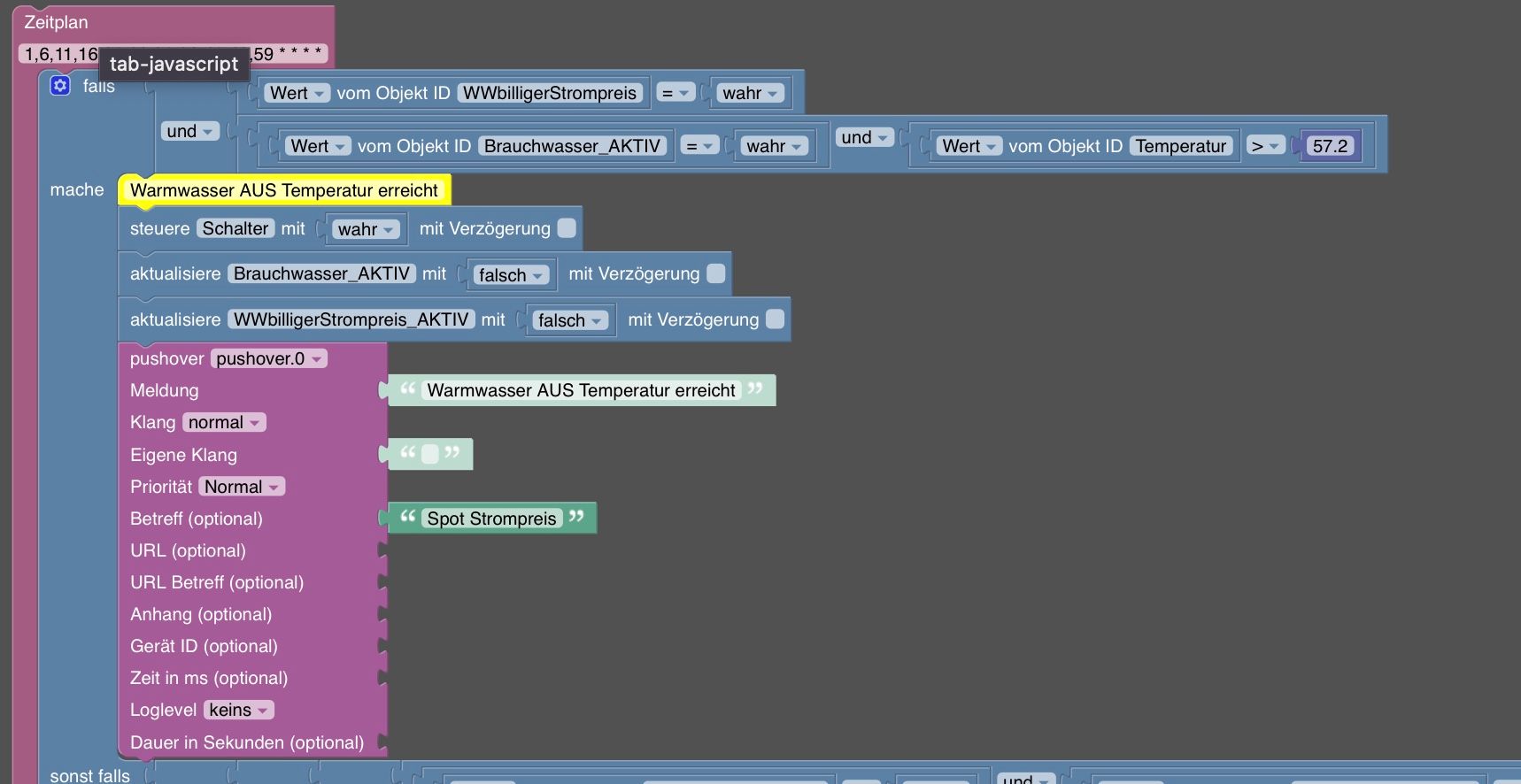

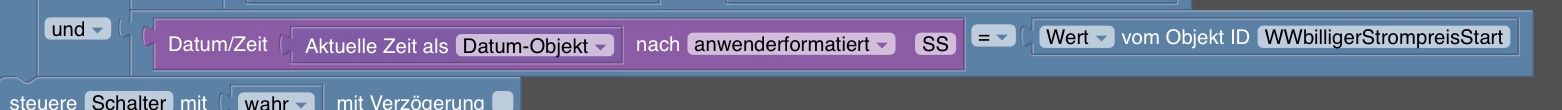

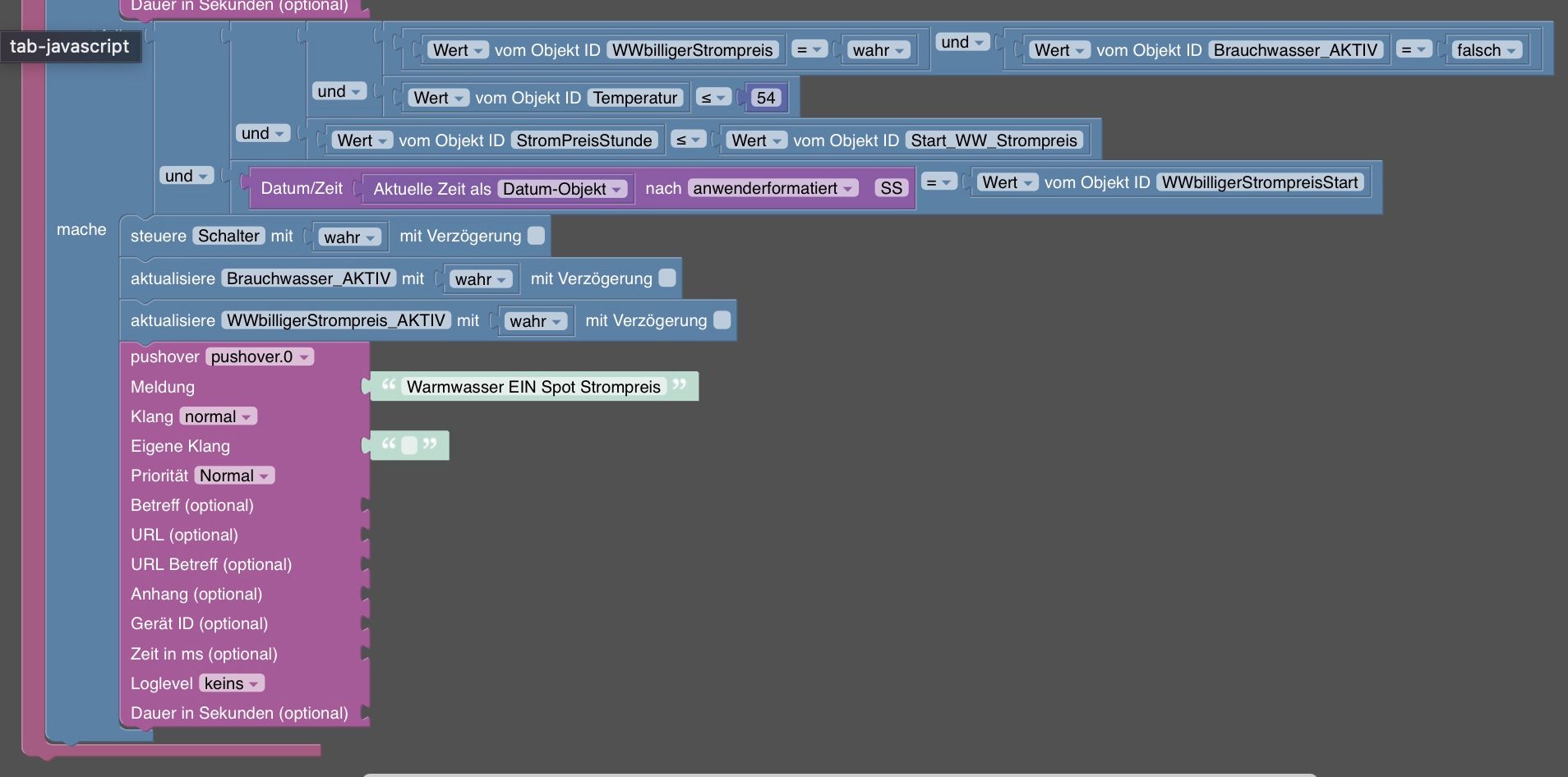

                        @codierknecht so sieht es aus. Wahrscheinlich nicht perfekt wie ich es gemacht habe 😊 . Aber es funktioniert.
                          <block type="schedule" id="{,VRQB`ND9!QV3ith@C`" x="-412" y="88">
                            <field name="SCHEDULE">1,6,11,16,21,26,31,36,41,46,59 * * * *</field>
                            <statement name="STATEMENT">
                              <block type="controls_if" id="t{p,Rg7~Y:wj:/cDSIQT">
                                <value name="IF0">
                                  <block type="logic_operation" id="y-+yCFY9!H1,$xi)()Dg" inline="false">
                                    <field name="OP">AND</field>
                                    <value name="A">
                                      <block type="logic_compare" id="^{:UliR#/uh2HXMcv6}d">
                                        <field name="OP">EQ</field>
                                        <value name="A">
                                          <block type="get_value" id="5%j)[,.4*q|xLHH^H)yN">
                                            <field name="OID">0_userdata.0.Blockly.WWbilligerStrompreis</field>
                                          </block>
                                        </value>
                                        <value name="B">
                                          <block type="logic_boolean" id="yv#6{:.WW7yn88z^p~2v">
                                          </block>
                                        </value>
                                      </block>
                                    </value>
                                    <value name="B">
                                      <block type="logic_operation" id="1vz^Z}6]Q(I(%b8`F(kM">
                                        <value name="A">
                                          <block type="logic_compare" id="T(KQY6N-[2iu8P3v~]$A">
                                            <value name="A">
                                              <block type="get_value" id="oX4}ykCbL0:H)z=YUpXS">
                                                <field name="OID">0_userdata.0.Blockly.Brauchwasser_AKTIV</field>
                                              </block>
                                            </value>
                                            <value name="B">
                                              <block type="logic_boolean" id="Gyj1q|vMM=70?Qc7dx,4">
                                              </block>
                                            </value>
                                          </block>
                                        </value>
                                        <value name="B">
                                          <block type="logic_compare" id="@8XIbDd2Go7|1R7inW.i">
                                            <field name="OP">GT</field>
                                            <value name="A">
                                              <block type="get_value" id="qQapD$$36AJfj5^uusis">
                                                <field name="OID">shelly.0.shellyplus1#0cdc7ef6fa04#1.Ext.temperature100C</field>
                                              </block>
                                            </value>
                                            <value name="B">
                                              <block type="math_number" id="GG.LMmK2~*yO#N%aW*YY">
                                                <field name="NUM">57.2</field>
                                              </block>
                                            </value>
                                          </block>
                                        </value>
                                      </block>
                                    </value>
                                  </block>
                                </value>
                                <statement name="DO0">
                                  <block type="comment" id="Za:p]T;0mSn,l,YgM{-/">
                                    <field name="COMMENT">Warmwasser AUS Temperatur erreicht</field>
                                    <next>
                                      <block type="control" id="i,nI,[q,z}$4?zn{vSL,">
                                        <field name="OID">shelly.0.SHSW-1#349454791026#1.Relay0.Switch</field>
                                        <value name="VALUE">
                                          <block type="logic_boolean" id="=t^S1g+j1*`-V`(gcMhF">
                                          </block>
                                        </value>
                                        <next>
                                          <block type="update" id="jUQV.$PuG7k:I{z)0gEe">
                                              <block type="logic_boolean" id="NBY8Xkrevc80xB:Fmu]%">
                                              </block>
                                            </value>
                                            <next>
                                              <block type="update" id="RC~?L,16jKb;,@9gybqC">
                                                <field name="OID">0_userdata.0.Blockly.WWbilligerStrompreis_AKTIV</field>
                                                  <block type="logic_boolean" id="_T3%f-FLYVrP)k|_pXp`">
                                                  </block>
                                                </value>
                                                <next>
                                                  <block type="pushover" id="$UMpoqnM~`t(a;49avX9">
                                                    <field name="INSTANCE">.0</field>
                                                    <field name="SOUND"></field>
                                                    <field name="PRIORITY">0</field>
                                                    <field name="LOG"></field>
                                                    <value name="MESSAGE">
                                                      <shadow type="text" id="oAW]9EF2S_Hq0q9Re$^s">
                                                        <field name="TEXT">Warmwasser AUS Temperatur erreicht</field>
                                                      </shadow>
                                                    </value>
                                                    <value name="SOUND_CUSTOM">
                                                      <shadow type="text" id="[9GdUOfQYkt|Al{8db~4">
                                                        <field name="TEXT"></field>
                                                      </shadow>
                                                    </value>
                                                    <value name="TITLE">
                                                      <block type="text" id=";ZcUTCkLoVwJ|,ppy]jL">
                                                        <field name="TEXT">Spot Strompreis</field>
                                                      </block>
                                                    </value>
                                                  </block>
                                                </next>
                                              </block>
                                            </next>
                                          </block>
                                        </next>
                                      </block>
                                    </next>
                                  </block>
                                </statement>
                                <value name="IF1">
                                  <block type="logic_operation" id="|pE#$IE0A+h7M+A;H`::" inline="false">
                                    <value name="A">
                                      <block type="logic_operation" id="kWQBMk:s^UPN_r+}^P,t" inline="false">
                                        <value name="A">
                                          <block type="logic_operation" id="L=wK.4TmqFlP=F3,{+u+" inline="false">
                                            <value name="A">
                                              <block type="logic_operation" id="G=PX]on~RAIsD!sY=DP;">
                                                <value name="A">
                                                  <block type="logic_compare" id="IPpzUa6RO`#u{a94xk*?">
                                                    <value name="A">
                                                      <block type="get_value" id="E#0w|SA3_:$ASd/}C_.T">
                                                      </block>
                                                    </value>
                                                    <value name="B">
                                                      <block type="logic_boolean" id="+bQ.8RnRB67OxJJD(N53">
                                                      </block>
                                                    </value>
                                                  </block>
                                                </value>
                                                <value name="B">
                                                  <block type="logic_compare" id="BEl[!7a1,70|!mq.W)+%">
                                                    <value name="A">
                                                      <block type="get_value" id="qEFcg~pq}^xXPs~d)dv,">
                                                      </block>
                                                    </value>
                                                    <value name="B">
                                                      <block type="logic_boolean" id="B;9TGNYscj%c$So)?*6)">
                                                      </block>
                                                    </value>
                                                  </block>
                                                </value>
                                              </block>
                                            </value>
                                            <value name="B">
                                              <block type="logic_compare" id="MwKNZKL*xAmwM6Fk##s-">
                                                <field name="OP">LTE</field>
                                                <value name="A">
                                                  <block type="get_value" id="o~SIULpr!_98sGxtiWHn">
                                                  </block>
                                                </value>
                                                <value name="B">
                                                  <block type="math_number" id="_K+RW^__m,.LKUt~*~9Z">
                                                    <field name="NUM">54</field>
                                                  </block>
                                                </value>
                                              </block>
                                            </value>
                                          </block>
                                        </value>
                                        <value name="B">
                                          <block type="logic_compare" id="McyM`]]AQ}ekgE98QrJ6">
                                            <value name="A">
                                              <block type="get_value" id=".|RZ5FL9fG7$Ad.]e/GE">
                                                <field name="OID">0_userdata.0.Blockly.StromPreisStunde</field>
                                              </block>
                                            </value>
                                            <value name="B">
                                              <block type="get_value" id="qZs-)MD,bPX^9$W9Diu*">
                                                <field name="OID">0_userdata.0.Blockly.Start_WW_Strompreis</field>
                                              </block>
                                            </value>
                                          </block>
                                        </value>
                                      </block>
                                    </value>
                                    <value name="B">
                                      <block type="logic_compare" id="p@,H_{*1)crKQUup4`mU">
                                        <value name="A">
                                          <block type="convert_from_date" id="YQ;5GRH8W]=_,#FdK3Ee">
                                            <mutation xmlns="http://www.w3.org/1999/xhtml" format="true" language="false"></mutation>
                                            <field name="OPTION">custom</field>
                                            <field name="FORMAT">SS</field>

                        • P Peter666666

                          DJMarc75D Offline
                          DJMarc75D Offline
                          DJMarc75
                          @peter666666 bitte auch nicht nur Code vom Blockly hier zeigen sondern Screenshots !
                          Nicht jeder kann den Code einfügen da u.U. nicht Deine Adapter installiert sind.
                          Lehrling seit 1975 !!!

                          • P Peter666666
                            Habe es dank dem Video hinbekommen. Ich starte die Warmwasseraufbereitung mit dem günstigen Spotpreis, möchte aber wenn der Preis über ein paar Stunden gleich bleibt natürlich die letzt mögliche Stunde nehmen was ich in dem DP von 0-23 einstelle über meine Visualisierung (1-24 oben war natürlich falsch).
                            @peter666666 sagte: was ich in dem DP von 0-23 einstelle über meine Visualisierung
                            Bei diesem Vergleich muss der DP einen String mit einer führenden 0 vor 10 Uhr enthalten. Vergleiche besser so:
                            P 1 Antwort Letzte Antwort
                            • DJMarc75D DJMarc75
                              P Offline
                              P Offline
                              Peter666666
                              @djmarc75
                              LG Peter
                                P Offline
                                P Offline
                                Peter666666
                                @paul53 ok danke. Stell ich um!
