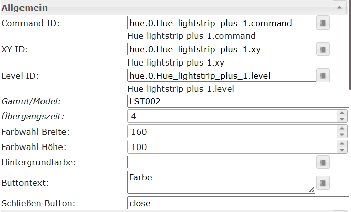

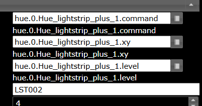

              @oliverio danke das du da mal schaust.
              Hier das Widget für HUE Steuerung. VIS 1 mit 1.2.0 geht. 2.0.3 nicht mehr.
              Hier das exportierte Widget 2.0.3.
              [{"tpl":"tplHUEjscolor","data":{"g_fixed":false,"g_visibility":false,"g_css_font_text":true,"g_css_background":false,"g_css_shadow_padding":true,"g_css_border":false,"g_gestures":false,"g_signals":false,"g_last_change":false,"visibility-cond":"==","visibility-val":1,"visibility-groups-action":"hide","transitionTime":"4","pickerWidth":"160","pickerHeight":"100","buttonName":"Farbe","closeButton":"close","divisor":"1","decimal":"0","signals-cond-0":"==","signals-val-0":true,"signals-icon-0":"/vis/signals/lowbattery.png","signals-icon-size-0":0,"signals-blink-0":false,"signals-horz-0":0,"signals-vert-0":0,"signals-hide-edit-0":false,"signals-cond-1":"==","signals-val-1":true,"signals-icon-1":"/vis/signals/lowbattery.png","signals-icon-size-1":0,"signals-blink-1":false,"signals-horz-1":0,"signals-vert-1":0,"signals-hide-edit-1":false,"signals-cond-2":"==","signals-val-2":true,"signals-icon-2":"/vis/signals/lowbattery.png","signals-icon-size-2":0,"signals-blink-2":false,"signals-horz-2":0,"signals-vert-2":0,"signals-hide-edit-2":false,"lc-type":"last-change","lc-is-interval":true,"lc-is-moment":false,"lc-format":"","lc-position-vert":"top","lc-position-horz":"right","lc-offset-vert":0,"lc-offset-horz":0,"lc-font-size":"12px","lc-font-family":"","lc-font-style":"","lc-bkg-color":"","lc-color":"","lc-border-width":"0","lc-border-style":"","lc-border-color":"","lc-border-radius":10,"lc-zindex":0,"command-oid":"hue.0.Hue_lightstrip_plus_1.command","xy-oid":"hue.0.Hue_lightstrip_plus_1.xy","level-oid":"hue.0.Hue_lightstrip_plus_1.level","gamut":"LST002"},"style":{"left":"90px","top":"557px","width":"150px","height":"30px","z-index":"5","font-family":"RobotoCondensed-Regular","font-style":"normal","font-variant":"normal","font-weight":"lighter","font-size":"large","text-shadow":"3px 3px 4px #000","color":"","box-shadow":"3px 3px 8px 1px rgba(255, 255, 255, 0.65)"},"widgetSet":"colorpicker"}]
              Danke.
              Ro75.

                  @oliverio
                  command
                    "transitiontime": 4,
                    "xy": "0.3602075471698113,0.27",
                    "level": 37
                    "_id": "hue.0.Hue_lightstrip_plus_1.command",
                    "type": "state",
                    "common": {
                      "type": "string",
                      "name": "Hue lightstrip plus 1.command",
                      "read": true,
                      "write": true,
                      "role": "command",
                      "def": "{}"
                    "native": {
                      "id": "1"
                    "from": "system.adapter.hue.0",
                    "user": "system.user.admin",
                    "ts": 1762029965217,
                    "acl": {
                      "object": 1636,
                      "state": 1636,
                      "owner": "system.user.admin",
                  xy
                  0.4431,0.4061
                    "_id": "hue.0.Hue_lightstrip_plus_1.xy",
                    "type": "state",
                    "common": {
                      "type": "string",
                      "name": "Hue lightstrip plus 1.xy",
                      "read": true,
                      "write": true,
                      "role": "level.color.xy",
                      "def": "[0.3599,0.2874]"
                    "native": {
                      "id": "1"
                    "ts": 1762029965198,
                    "acl": {
                      "object": 1636,
                      "state": 1636,
                  level
                  43
                    "_id": "hue.0.Hue_lightstrip_plus_1.level",
                    "type": "state",
                    "common": {
                      "type": "number",
                      "name": "Hue lightstrip plus 1.level",
                      "read": true,
                      "write": true,
                      "role": "level.dimmer",
                      "min": 0,
                      "max": 100,
                      "def": 0
                    "native": {
                      "id": "1"
                    "ts": 1762029965219,
                    "acl": {
                      "object": 1636,
                      "state": 1636,
                  Ro75.
                  NACHTRAG command kann auch {} sein oder wird nicht mit aktualisert zu level und xy. Keine Ahnung warum das so ist.

                    @ro75
                    also der fix scheint zu funktionieren
                    es kommt auf jeden fall keine fehler mehr.
                    jetzt mal noch auf die anderen warten, bevor der fix eingereicht wird.
