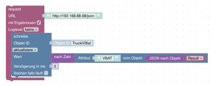

    ich habe mir im Forum einige Tips zum auslesen von JSON angesehen, aber irgendwie wollen die nich auf den Inhalt greifen den ich haben.
    Anbei der Inhalt der bei mir angezeigt wird wenn ich die URL eingeben:
    {"UPTIME":"00d 00:45:26","RSSI":96,"VERSION":"1.10 04.05.2023 06:16","DEVICENAME":"T2SG8BBF6C","STATICIP":"192.168.88.68","STATICGW":"192.168.88.1","STATICSN":"255.255.255.0","VGRID":236.8,"VBAT":25.6,"SETACPOWER":700,"TEMP":42,"DAC":23637,"CALSTEP":0,"MAXPOWER":"700","POWERLIMIT":700,"VBATCUTOFF":24,"VBATREBOOT":24.5,"SUN2IP":"","SUN3IP":"","SUN2ROUNDTRIP":"0","SUN2SETPOINT":0,"SUN2POWERLIMIT":0,"SUN3ROUNDTRIP":"0","SUN3SETPOINT":0,"SUN3POWERLIMIT":0,"METERURL":"http://192.168.88.57/status","METER_USER":"admin","METER_PASS":"","JSONKEYS":"total_power","METERINTERVAL":"500","METERREADOUT":142,"ZEPCTARGET":"15","ZEPCAVERAGE":"20","MQTT_SERVER":"","MQTT_PORT":"1883","MQTT_USER":"","MQTT_PASS":"","HADISCOVERY":0,"MQTT_ACSETPOINTOVR_NAME":"T2SG8BBF6C/ACSETPOINTOVR","MQTT_ACSETPOINTOVR_VALUE":"","MQTT_DACOVR_NAME":"T2SG8BBF6C/DACOVR","MQTT_DACOVR_VALUE":"","MQTT_CALSTEPOVR_NAME":"T2SG8BBF6C/CALSTEPOVR","MQTT_CALSTEPOVR_VALUE":"","MQTT_METEROVR_NAME":"T2SG8BBF6C/METEROVR","MQTT_METEROVR_VALUE":"","MQTT_MAXPOWEROVR_NAME":"T2SG8BBF6C/MAXPOWEROVR","MQTT_MAXPOWEROVR_VALUE":"","MQTT_TARGETOVR_NAME":"T2SG8BBF6C/TARGETOVR","MQTT_TARGETOVR_VALUE":"","MQTT_ACSETPOINT_NAME":"T2SG8BBF6C/ACSETPOINT","MQTT_ACSETPOINT_VALUE":7000,"MQTT_ACDISPLAY_NAME":"T2SG8BBF6C/ACDISPLAY","MQTT_ACDISPLAY_VALUE":7211,"MQTT_VGRID_NAME":"T2SG8BBF6C/VGRID","MQTT_VGRID_VALUE":2368,"MQTT_VBAT_NAME":"T2SG8BBF6C/VBAT","MQTT_VBAT_VALUE":256,"MQTT_DAC_NAME":"T2SG8BBF6C/DAC","MQTT_DAC_VALUE":23637,"MQTT_CALSTEP_NAME":"T2SG8BBF6C/CALSTEP","MQTT_CALSTEP_VALUE":0,"MQTT_TEMPERATURE_NAME":"T2SG8BBF6C/TEMPERATURE","MQTT_TEMPERATURE_VALUE":42,"MQTT_METER_NAME":"T2SG8BBF6C/METER","MQTT_METER_VALUE":"2963.35","MQTT":"not set","ACPOWER":"721.10 W","ACPOWERSUN2":"not set","ACPOWERSUN3":"not set","METERPOWER":"2963.35 W","ZEPCPOWER":"2083.90 W"}
    Ich möchte nur den Wert "VBAT" in einem Datenpunkt anzeigen lassen. Aber irgendwie klappt das nicht. Bei alles anderen Beispielen sehen die JSON Inhalte so sortiert aus, bei mir halt nur so wie oben zusehen.
    Ich habe ein Blockly dazu gebaut, so wie ich meinte, dass es richtig wäre:
    Vielleicht hat ja jemand die passende Idee für mich. Ich dafür sehr dankbar.
    Andreas

        @ankubo es muss result heißen

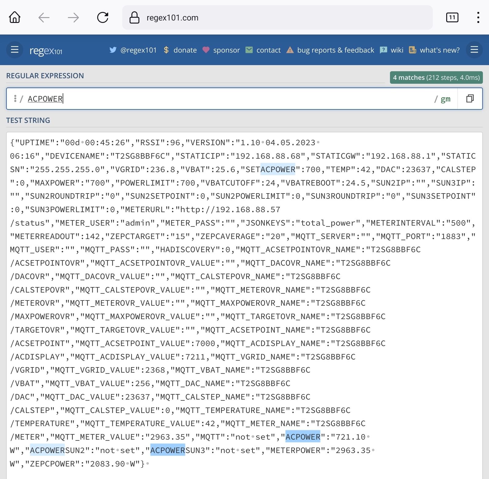

            @oliverio Kannst Du mir sagen wie ich den "ACPOWER" herausbekomme? Habe einfach versucht das VBAT mit ACPOWER zu ersetzen, doch das geht scheinbar nicht. Liegt es daran, dass da noch eine Leerzeile ist und dann W kommt?
            Verstehe leider die Zeichenfolge nicht.

              @ankubo sagte in JSON Inhalt von Website auslesen:
              welches?
              Die Meter Werte ACPOWER":"([\d.]+) und oben bei SETACPOWER ACPOWER":([\d.]+)

                @homoran Nur ACPOWER, ohne Sun oder ähnliches dahinter. Der Wert mit den 721.20
                • A ankubo
                  gibt es hinter VAC als SETACPOWER mit 700 und unten als MQTT Meter mit 712.20
                  (siehe letzten Post)

                    @homoran said in JSON Inhalt von Website auslesen:
                    Wie schon darüber geschrieben ist das, das ACPOWER mit den 721.20 W
                      welches?
                      wie noch, noch darüber geschrieben

                        @ankubo
                        Hier wird der Begriff deine Suche genau an deinem Beispiel erklärt
                        https://regex101.com/r/Kc7FYA/1
                        Aber zugegeben regex ist für viele erst einmal eine harte Nuss, da es doch sehr kryptisch wirkt. Im endeffekt ist es die erweiterte Form von den Dateisuchpattern * und ?, aber mit unheimlich viel mehr Möglichkeiten
