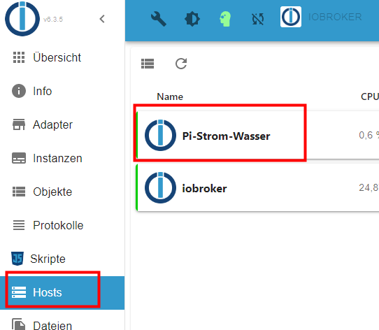

            @horst-böttcher sagte in multihost ???:
            Slave nicht auch zu sehen sein ???
            Ja klar.
            Beim Master unter host:
            Danke.

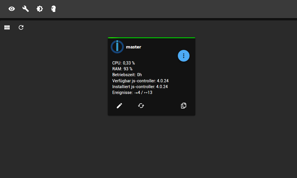

                    ok ich weiss echt nicht weiter
                    pi@master:~ $ iobroker setup custom
                    Current configuration:
                    - Objects database:
                      - Type: jsonl
                      - Host/Unix Socket: 0.0.0.0
                      - Port: 9001
                    - States database:
                      - Type: jsonl
                      - Port: 9000
                    - Data Directory: ../../iobroker-data/
                    Type of objects DB [(j)sonl, (f)ile, (r)edis, ...], default [jsonl]:
                    Host / Unix Socket of objects DB(jsonl), default[0.0.0.0]:
                    Port of objects DB(jsonl), default[9001]:
                    Type of states DB [(j)sonl, (f)file, (r)edis, ...], default [jsonl]:
                    Host / Unix Socket of states DB (jsonl), default[0.0.0.0]:
                    Port of states DB (jsonl), default[9000]:
                    Data directory (file), default[../../iobroker-data/]:
                    Host name of this machine [master]:
                    updating conf/iobroker.json
                    pi@master:~ $ iobroker multihost enable
                    Discovery authentication activated.
                    Enter secret phrase for connection:
                    Repeat secret phrase for connection:
                    Please check the binding of the configured jsonl server to allow remote connections.
                    Please restart ioBroker for the changes to take effect: "iobroker restart"
                    Multihost discovery server: enabled
                    Discovery authentication:   enabled
                    Persistent activation:      disabled
                    Objects:                    jsonl on 0.0.0.0
                    States:                     jsonl on 0.0.0.0
                    pi@master:~ $ iobroker restart
                    slave
                    Last login: Sat Mar 11 10:57:36 2023 from 192.168.178.6
                    - Objects database:
                      - Type: jsonl
                      - Port: 9001
                    - States database:
                      - Type: jsonl
                      - Port: 9000
                    Host / Unix Socket of objects DB(jsonl), default[0.0.0.0]: 192.168.178.199
                    Host / Unix Socket of states DB (jsonl), default[192.168.178.199]: 192.168.178.199
                    pi@master:~ $ iobroker multihost connect
                    1 |     192.168.178.199 |  host |     192.168.178.199 | "authentication required"
                    Please select host [1]: 1
                    Enter secret phrase for connection: *********
                    Config ok. Please restart ioBroker: "iobroker restart"
                    komischer weise ist auf der ip moaster das gleiche system ereichbar wie beim Slave
                    ioBroker auf Proxmox (Debian) auf LENOVO PC Thinkcentre als Produktivsystem
