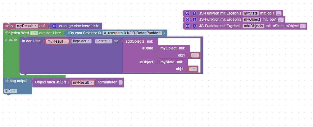

      @warhammer73 bin mir nicht sicher, ob ich dich richtig verstanden habe
      aber als beispiel mal, wie du ein json (object) bekommst von einer datenstruktur:

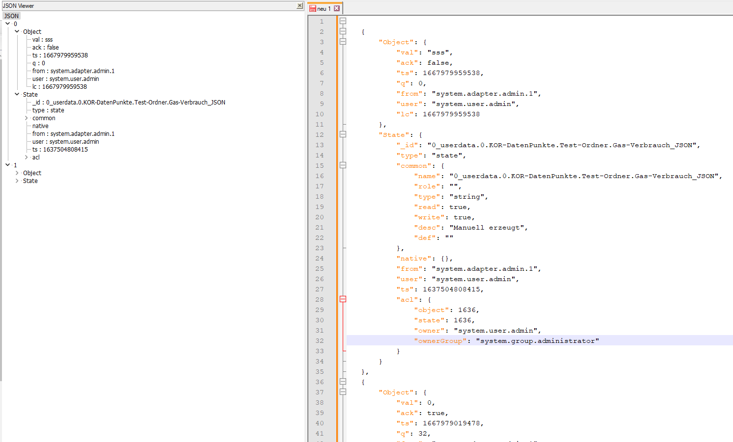

      schaut dann so aus und kann wiederum in einen dp gespeichert werden:
         	"Object": {
         		"val": "sss",
         		"ack": false,
         		"ts": 1667979959538,
         		"q": 0,
         		"from": "system.adapter.admin.1",
         		"user": "system.user.admin",
         		"lc": 1667979959538
         	"State": {
         		"_id": "0_userdata.0.KOR-DatenPunkte.Test-Ordner.Gas-Verbrauch_JSON",
         		"type": "state",
         		"common": {
         			"name": "0_userdata.0.KOR-DatenPunkte.Test-Ordner.Gas-Verbrauch_JSON",
         			"role": "",
         			"type": "string",
         			"read": true,
         			"write": true,
         			"desc": "Manuell erzeugt",
         			"def": ""
         		"native": {},
         		"ts": 1637504808415,
         		"acl": {
         			"object": 1636,
         			"state": 1636,
         			"owner": "system.user.admin",
         	"Object": {
         		"val": 0,
         		"ack": true,
         		"ts": 1667979019478,
         		"q": 32,
         		"lc": 1667979019478
         	"State": {
         		"common": {
         			"name": "number",
         			"role": "state",
         			"type": "number",
         			"read": true,
         			"write": true,
         			"def": 0
         		"type": "state",
         		"native": {},
         		"ts": 1667979019468,
         		"_id": "0_userdata.0.KOR-DatenPunkte.Test-Ordner2.number",
         		"acl": {
         			"object": 1636,
         			"state": 1636,
           	"Object": {
           		"val": "sss",
           		"ack": false,
           		"q": 0,
           		"lc": 1667979959538
           	"State": {
           		"type": "state",
           		"common": {
           			"role": "",
           			"type": "string",
           			"read": true,
           			"write": true,
           			"def": ""
           		"native": {},
           		"acl": {
           			"object": 1636,
           			"state": 1636,
           	"Object": {
           		"val": 0,
           		"ack": true,
           		"q": 32,
           		"lc": 1667979019478
           	"State": {
           		"common": {
           			"name": "number",
           			"role": "state",
           			"type": "number",
           			"read": true,
           			"write": true,
           			"def": 0
           		"type": "state",
           		"native": {},
           		"acl": {
           			"object": 1636,
           			"state": 1636,
